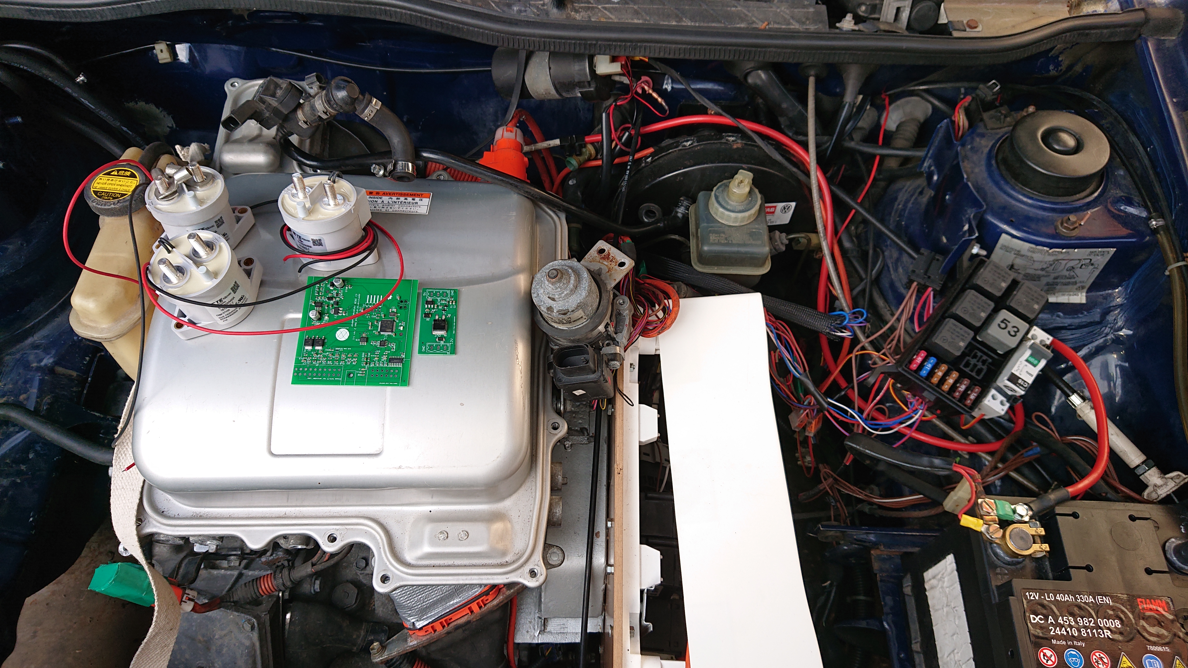

Been a while since an update. We now capable to recharge the High Voltage battery from MG1 out puts in the Inverter!
Been testing the last few days, and hope to write up this part of the process for our wiki once further testing is complete.
Next up, will install cooling and brake booster assistance.

So charging is up and running from inverter and MG1 thanks to Johannes and community. Need to tidy up wiring.
The original prius battery will remain in use for further testing.

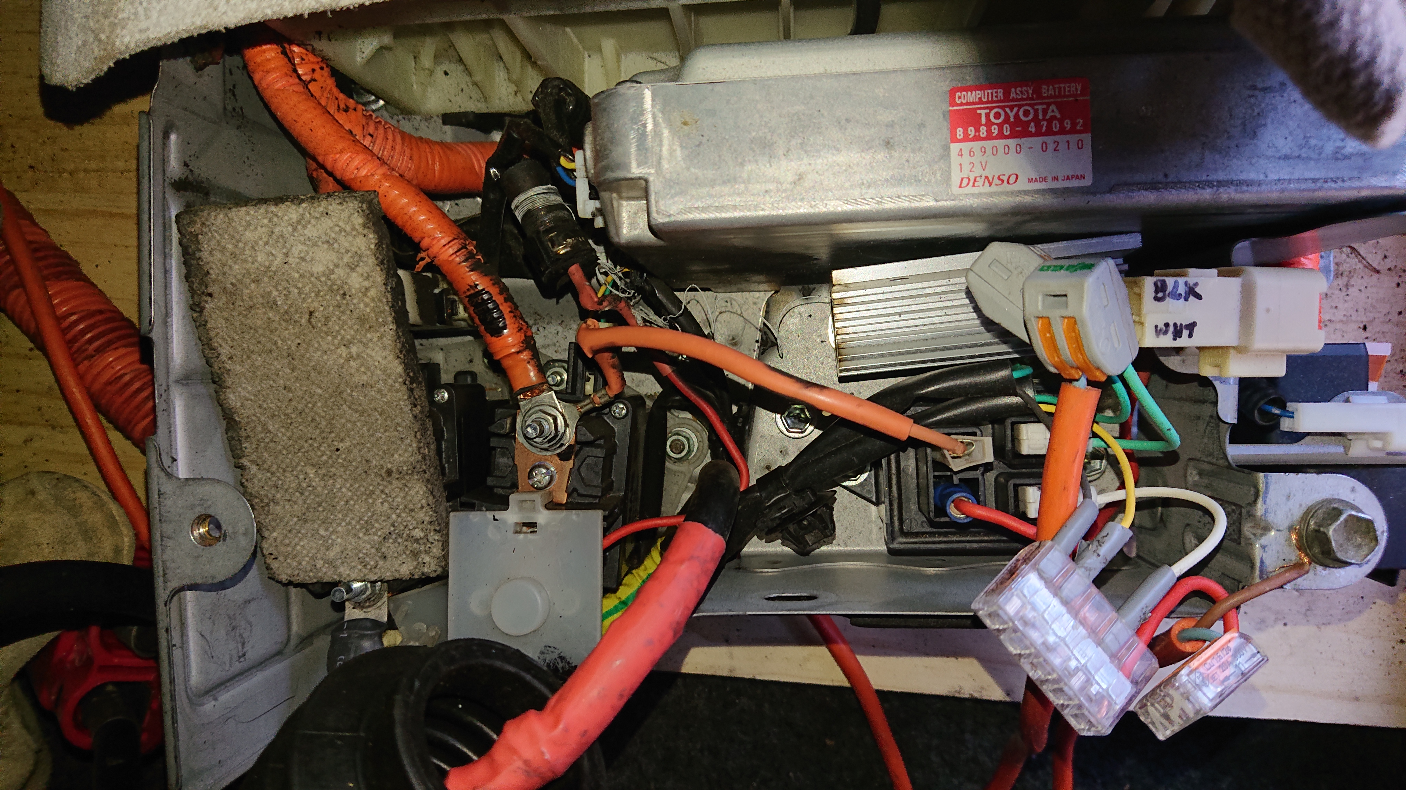

Thanks zookeeper and company, wired up C5 and dc-dc up and running. I used dcsw to activate pins 1&3 on a relay.
Will figure out a 'pull to ground' for pin 4 at a later stage - basically to shut down if voltage exceeds 15v.

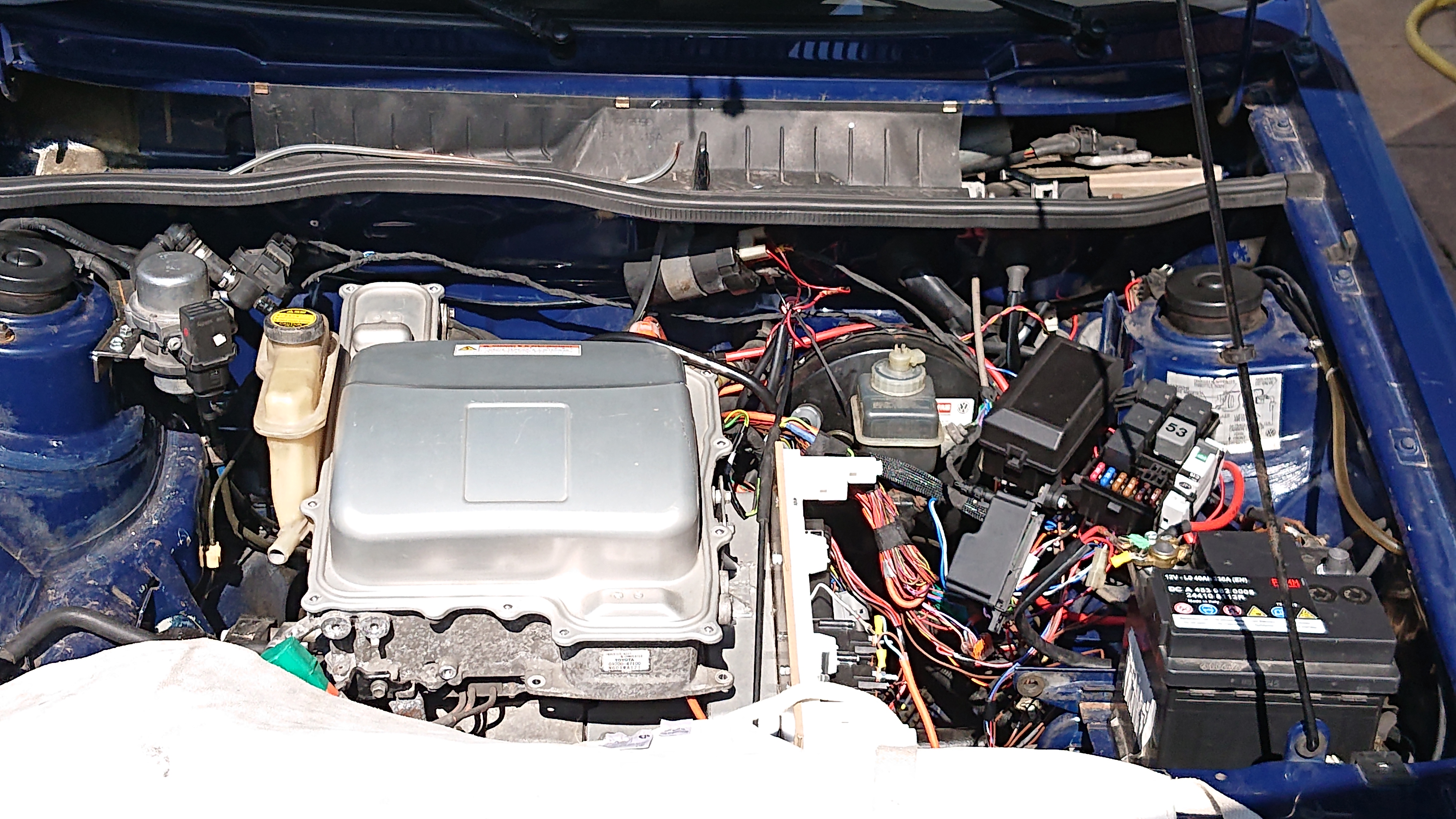

So finally got my brake vacuum setup fitted and wired in. Starting to get lots of wires, so fuse and relay boxes installed to tidy up a little. Pump switches on and off (like when they do a pre flight test of the planes wings.)
Will look into it next, but can start to check out why there's no power - flat lines around 30km/h. One thing for sure is original prius pack @225v is not going to get very far.

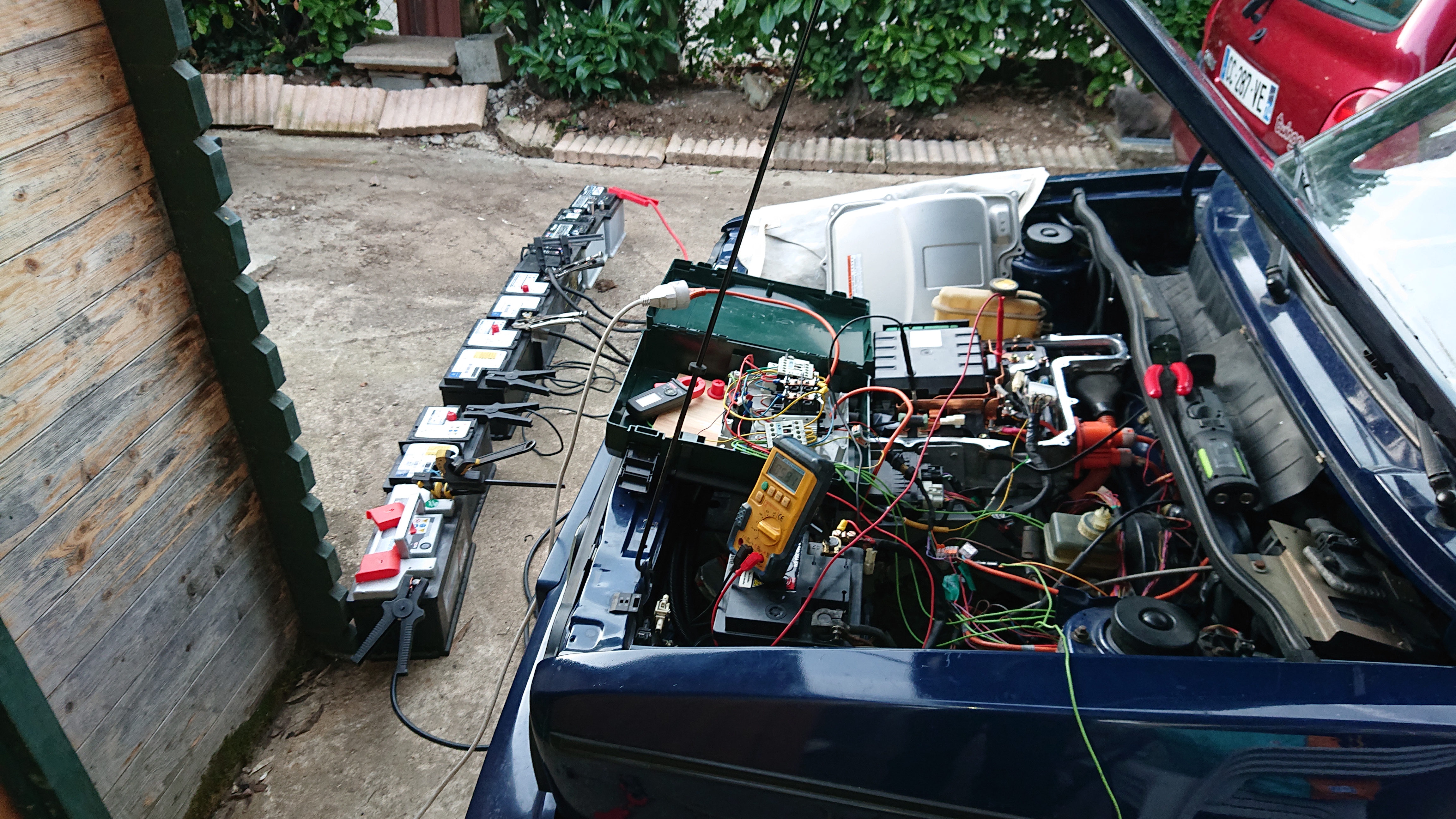

So decided to go back to the start... sort of.
I thought, Damien had his gen3 prius transaxle running pretty smooth during his video with Johu. Albeit without load.
So went to remove any doubts or 'I assume that I got it right'.
Went back to check resolver feedback - nothing happening when carrying out the test sequence.
Did some changes as per Damiens table and resolved the resolver problem.... I'm pretty sure it was fine before, but not going there.
So back to checking stage 2 and homing in on our famous 'syncoffs' value.
At syncoffs = 10000 & manualid =50A, I let out the black smoke.
Seems in manual mode, my setup switched main contacter off and was on via precharge relay. The resistor did not like that and poof. Could have been worse. Pretty freaky when you don't know what popped, and why.
Back to drawing board again

Re: Golf 1 / Prius Gen 2
Yes in less recent software precharge is left on without main dc contactor in manual run mode,
more recent software all relays are off in manual run, to use manual I have to switch on to precharge the inverter then bridge the main dc contactor with jump leads before switching to manual run,
What syncadv are you running, if the default 10 I really recommend updating software to the latest and testing with syncadv lowered to 6

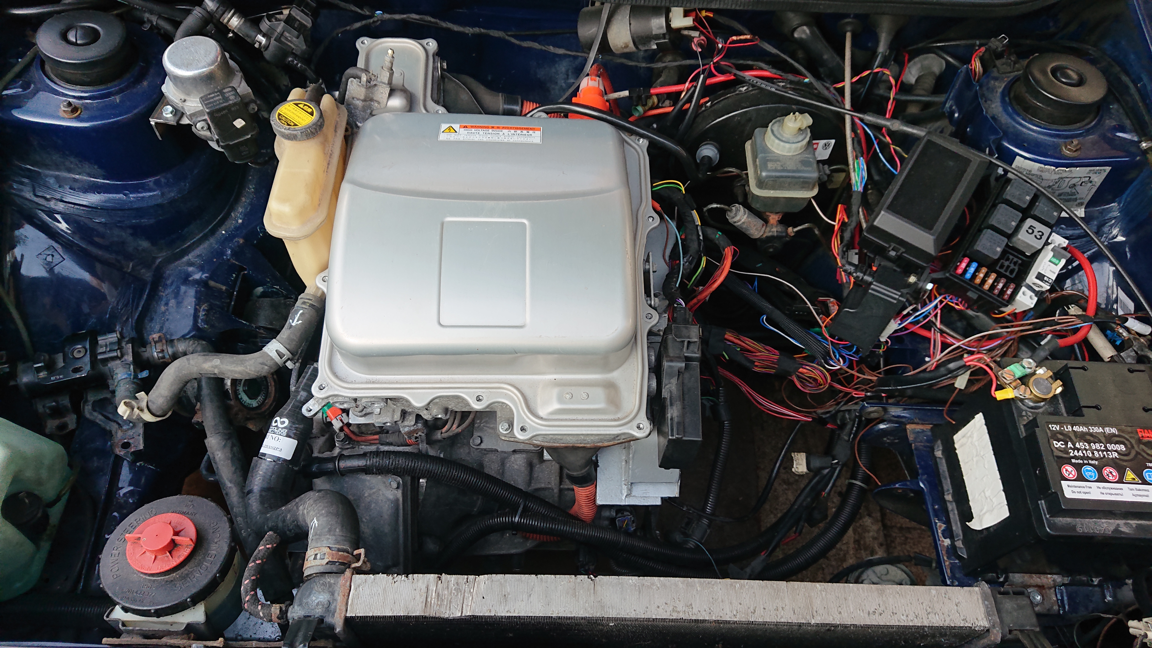

Unlike @catphish, going real slow at the moment. Getting some cooling hooked up to original radiator to do some more testing.
Mg1 been insulated and will not be used for now.
I also removed the 'poor man's charger' and will clean up wiring. Too untidy for my liking.
Charger relays will be more of a briefcase style that I'll plug in for charging.

Yup, I set up 30% for now and will see how to setup 3 levels later on. I'm trying to figure out the next step, as the original prius pack @220vdc is not enough (OK for testing).
In the meantime I'm putting in cooling and correct prius transaxle oil, along with cleaning up wiring.
