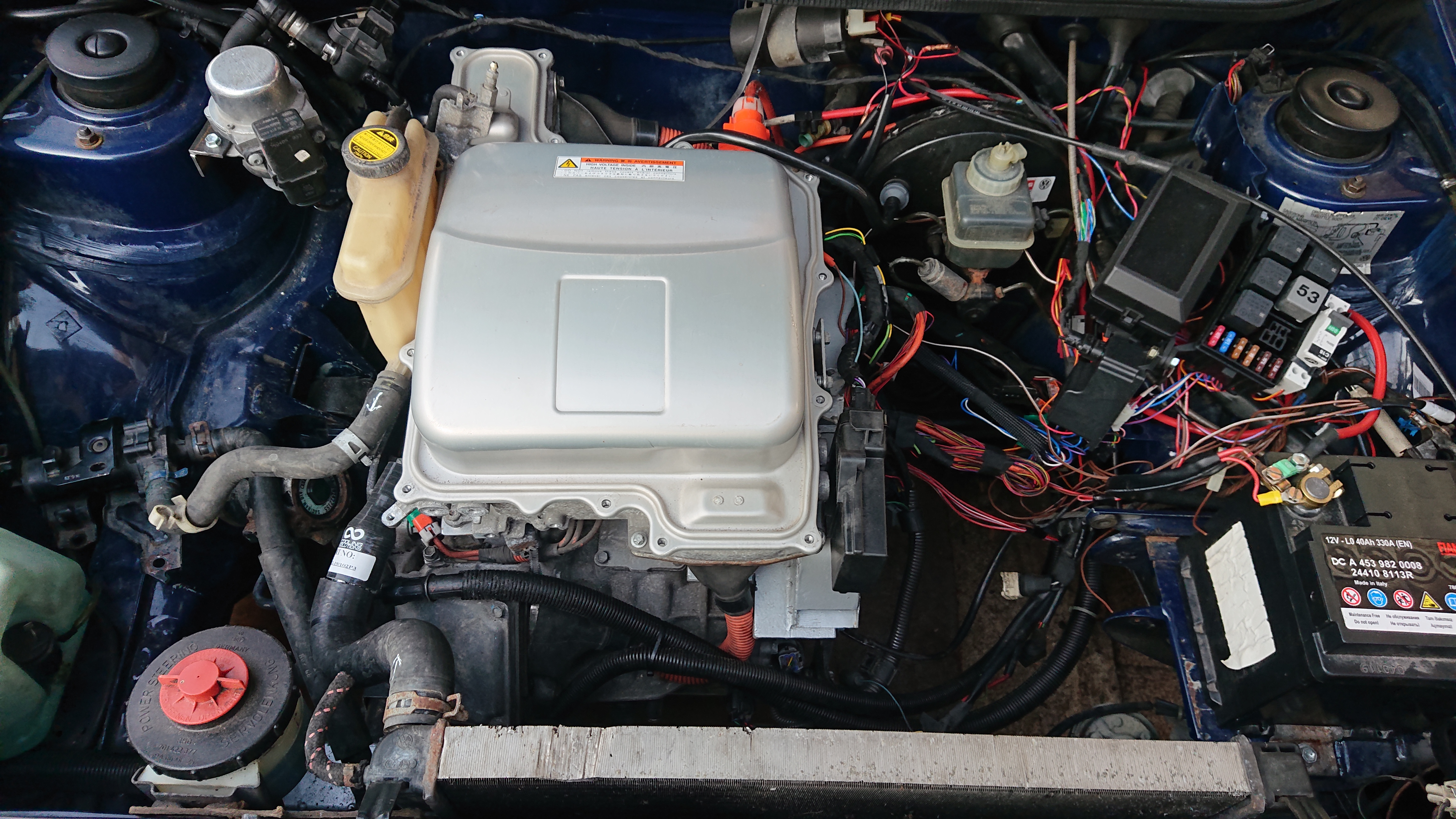

Been a while since an update. We now capable to recharge the High Voltage battery from MG1 out puts in the Inverter!
Been testing the last few days, and hope to write up this part of the process for our wiki once further testing is complete.
Next up, will install cooling and brake booster assistance.
Primitive battery connections are not advised

So charging is up and running from inverter and MG1 thanks to Johannes and community. Need to tidy up wiring.
The original prius battery will remain in use for further testing.
Now to get some vacuum brakes working (as I believe there has been some regen issues causing acceleration

Thanks zookeeper and company, wired up C5 and dc-dc up and running. I used dcsw to activate pins 1&3 on a relay.
Will figure out a 'pull to ground' for pin 4 at a later stage - basically to shut down if voltage exceeds 15v.

Progress very slow since I got charger side of inverter working. I would like to road test, but I don't live in an area where it is easily possible.... So getting provision number plates (for prototype testing).
In other news, I'm attempting to secure as much wiring as possible, and get brake assistance working before going onto the street.
The second board and contactors are to run MG1 (and disconnect it when charging).
All necessary before getting out rolling.

So finally got my brake vacuum setup fitted and wired in. Starting to get lots of wires, so fuse and relay boxes installed to tidy up a little. Pump switches on and off (like when they do a pre flight test of the planes wings.)
Will look into it next, but can start to check out why there's no power - flat lines around 30km/h. One thing for sure is original prius pack @225v is not going to get very far.

So the jumper cable bypassing the converter didn't do anything. I'll start digging into posts before playing with values I don't properly understand.
Re: Golf 1 / Prius Gen 2
Pretty sure these motors need a different field weakening strategy then what is currently offered by current software, hopefully as more people get their projects rolling there will be more testing of different ideas, there is some good reading and theories around the forum

So decided to go back to the start... sort of.
I thought, Damien had his gen3 prius transaxle running pretty smooth during his video with Johu. Albeit without load.
So went to remove any doubts or 'I assume that I got it right'.
Went back to check resolver feedback - nothing happening when carrying out the test sequence.
Did some changes as per Damiens table and resolved the resolver problem.... I'm pretty sure it was fine before, but not going there.
So back to checking stage 2 and homing in on our famous 'syncoffs' value.
At syncoffs = 10000 & manualid =50A, I let out the black smoke.
Seems in manual mode, my setup switched main contacter off and was on via precharge relay. The resistor did not like that and poof. Could have been worse. Pretty freaky when you don't know what popped, and why.
Back to drawing board again
Yes in less recent software precharge is left on without main dc contactor in manual run mode,
more recent software all relays are off in manual run, to use manual I have to switch on to precharge the inverter then bridge the main dc contactor with jump leads before switching to manual run,
What syncadv are you running, if the default 10 I really recommend updating software to the latest and testing with syncadv lowered to 6

I am running the latest version 5.18 Foc. Will get everything cleaned up and check that the relays are not welded closed. Then onto some kind of jumper system with cooking element...
I'm going to try and make a test setup outside my vehicle, I almost had everything go up in smoke....

MG1 is along for the ride at the moment, but have a 2nd board and bits and pieces to get it hooked up. The planetary gear set has been locked up too.
I am trying to see what performance I can get out of MG2 first and might remove MG1 and fit a blank off plate. But I would like to get the 2 motors running in this setup.
I have replaced my precharge relay and rewired things for easier access in case of emergency.
I have noticed that I am in reverse when I am going forward, so 'sycnoffs' @10300 runs the motor really smooth, but limits to about 30km/h, and goes in 'wrong' direction.
I know @geduxaz has a similar problem and mentioned value around 41000, so I''ll get my mains contact bypass setup again and try to find the same value in 'manualid' with cooker element in series.
I also selected motor temp to 'Gen2' which has helped temp value.
Il1 and Il2 read 80A when I am at full throttle, and not more. If i change throttle amp value to 2 I get overcurrent almost straight away.
'syncadv' is set to 6.
I also get Overcurrent after about 30m of testing , so still lots to iron out.

Unlike @catphish, going real slow at the moment. Getting some cooling hooked up to original radiator to do some more testing.
Mg1 been insulated and will not be used for now.
I also removed the 'poor man's charger' and will clean up wiring. Too untidy for my liking.
Charger relays will be more of a briefcase style that I'll plug in for charging.

Yup, I set up 30% for now and will see how to setup 3 levels later on. I'm trying to figure out the next step, as the original prius pack @220vdc is not enough (OK for testing).
In the meantime I'm putting in cooling and correct prius transaxle oil, along with cleaning up wiring.
