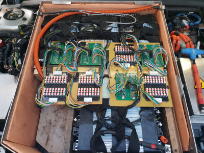

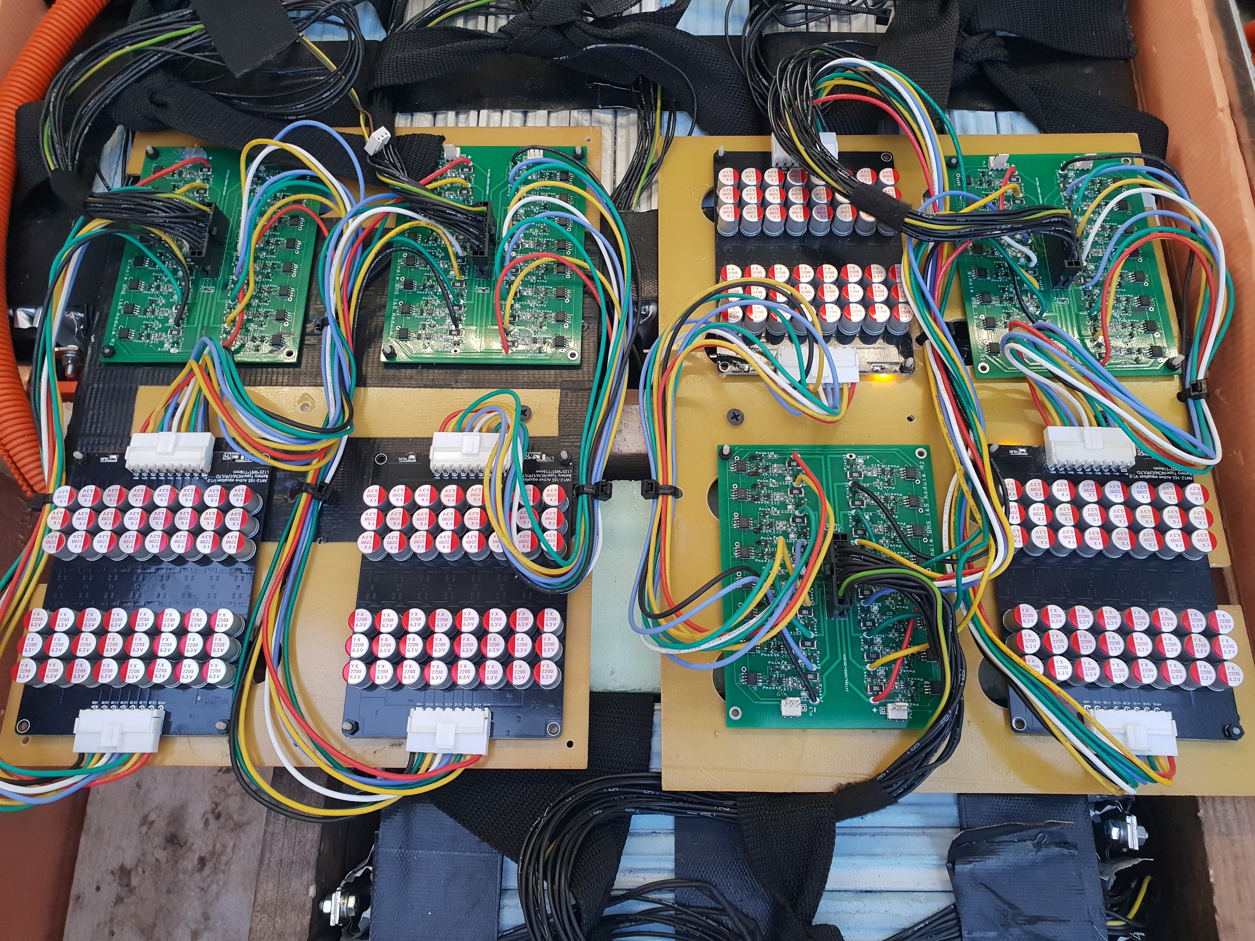

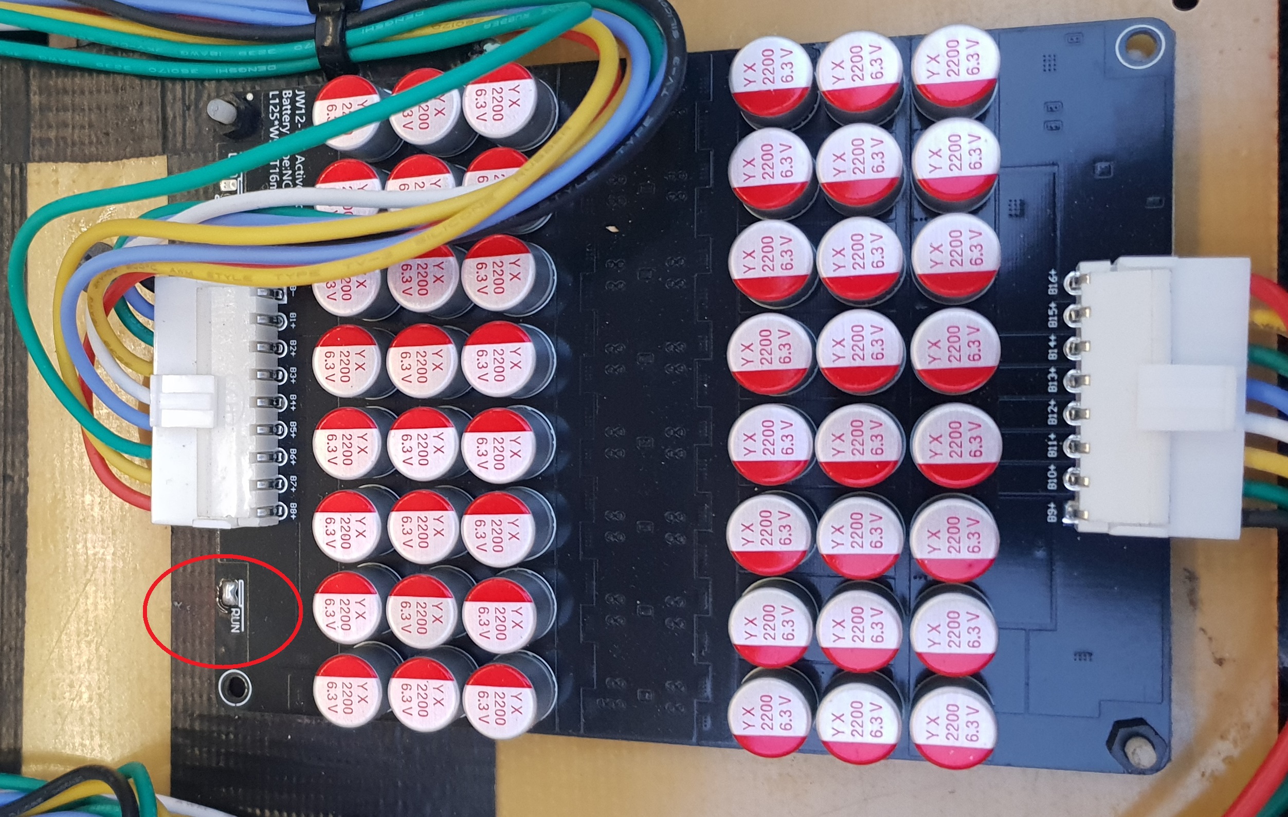

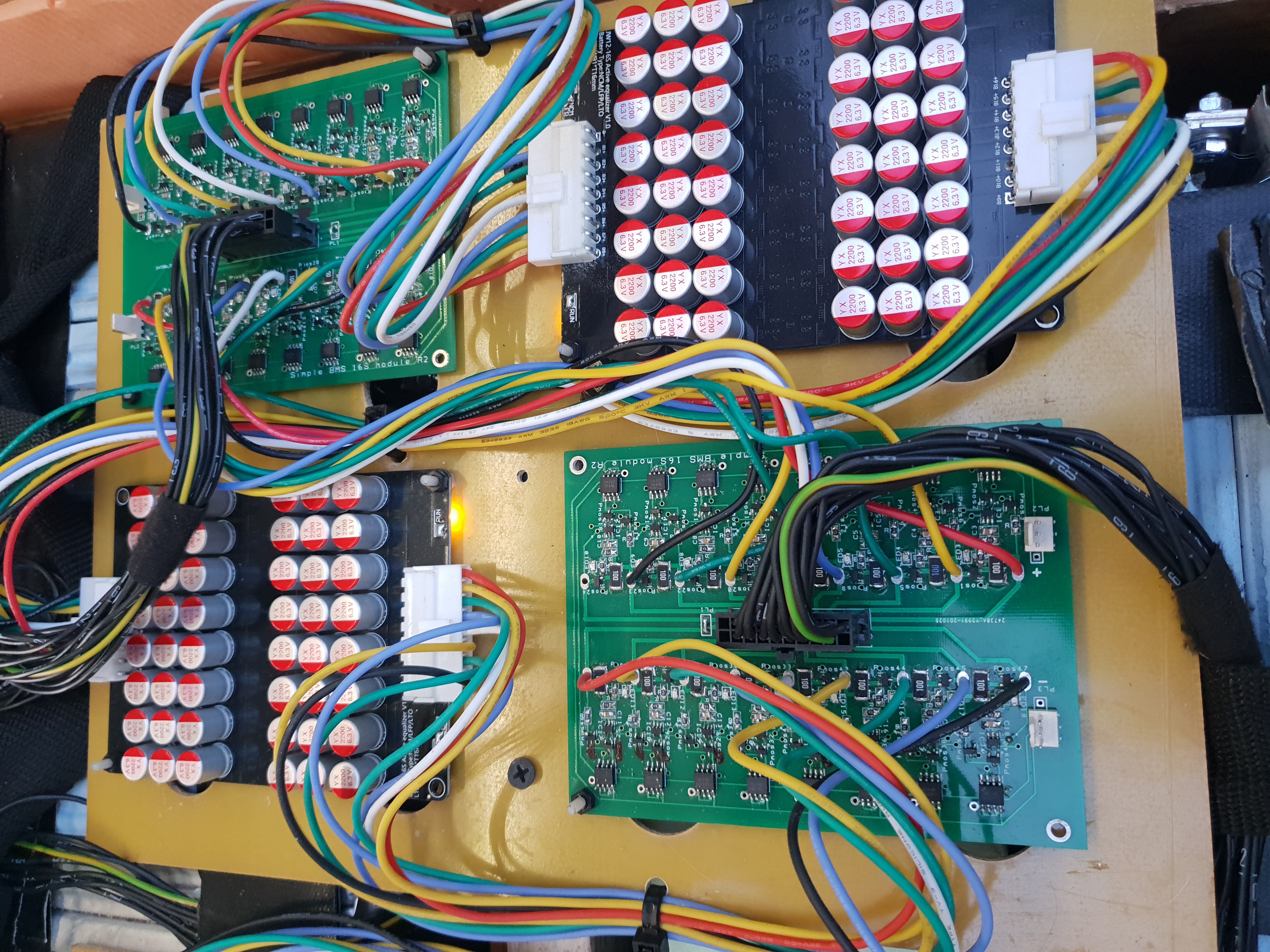

I got those remaining 5 boards from Aliexpress. That was fast shipping.
For now i reconfigured my existing BMS so it is connected to active balancers by 16S connection. I left 1.6mm holes for testing and measuring cell voltages and they accepted the new balancer cables.
I didnt want to shorten the cables so i kept the lenght and i sorted them out along the circuit.
What i found out when i measured my cells was the small but consistent drag from those balancers. In the pack that was connected to the first 16S balancer couple of weeks before i noticed voltage 4.02V per cell in all cells! While others were varying at 4.02 to 4.08...
I think rest of cells will come in line when they accept balancers.
So for me those capacitive active balancers are a real deal!
The only think left to experiment with is the small pads on the balancers which are soldered by default. If i cut ithis connection balancer stops. I am thinking of connecting those pads with opto couplers and a signal from my BMS. This will operate balancers only above certain voltage where Ri is high enough that balancing (charg or drain) actually matters.

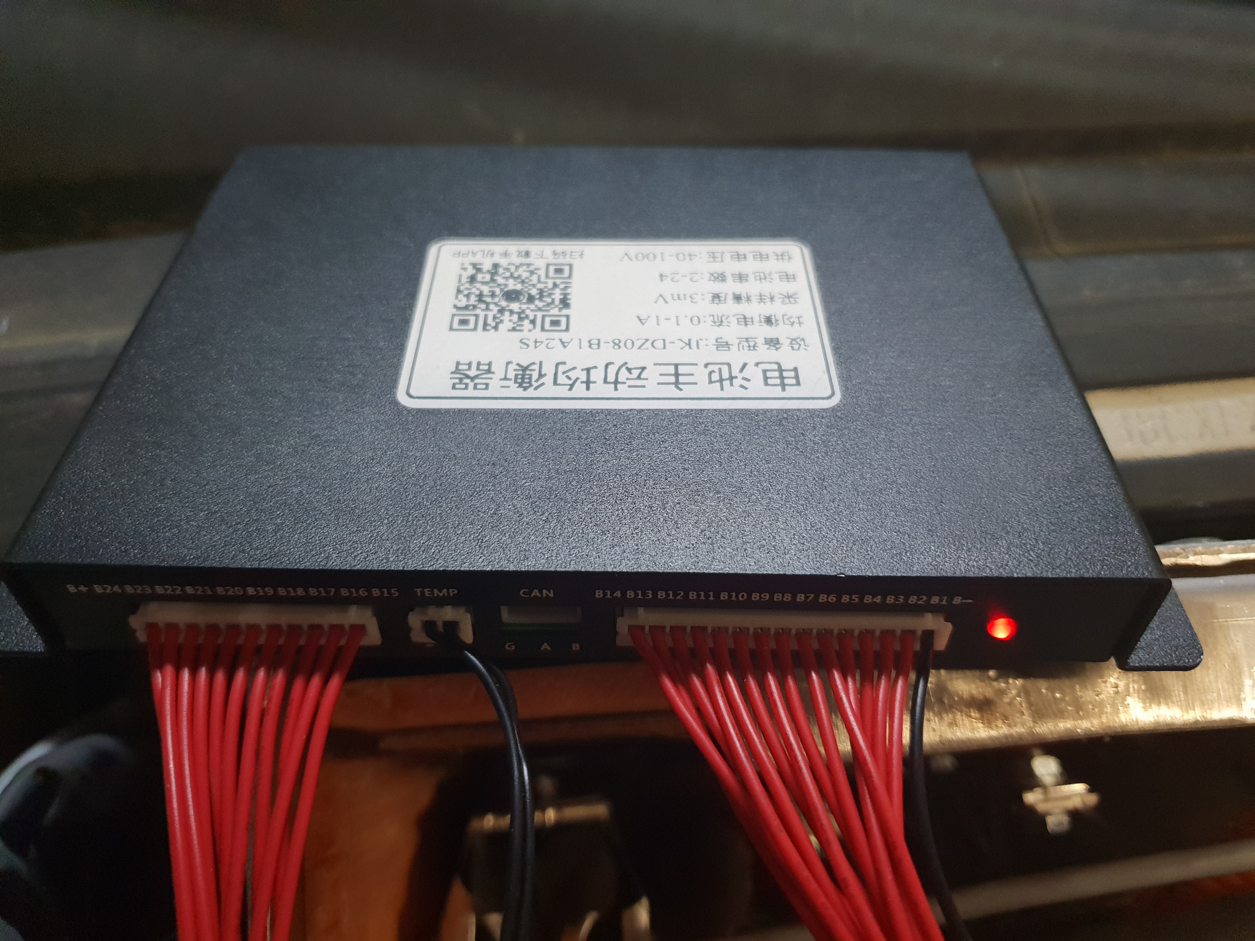

I have found another active BMS/Balancer system. I couldnt help myself and i ordered it for testing.
https://www.aliexpress.com/item/1005002 ... 4c4dNpYkyI
This is a 24S active balancer with 1A balancing capability and voltage measurement. And the difference from previous balancers it can pass power directly to the cell which is low. In theory this should balance really fast. It works using supercap to store energy before passing it on.
It works with various ways of communication bluetooth, CAN or RS485. Multiple instances of 24S can be connected with CAN or RS485 option. Address is determined by DIP switches on the back.
I decided on CAN communication since i got to know it better than RS485.
CAN system operates with 250kbaud. There would be an option for 500kbaud but one would need to order at least 100 pieces 8-).
Protocol is described in the file attached.

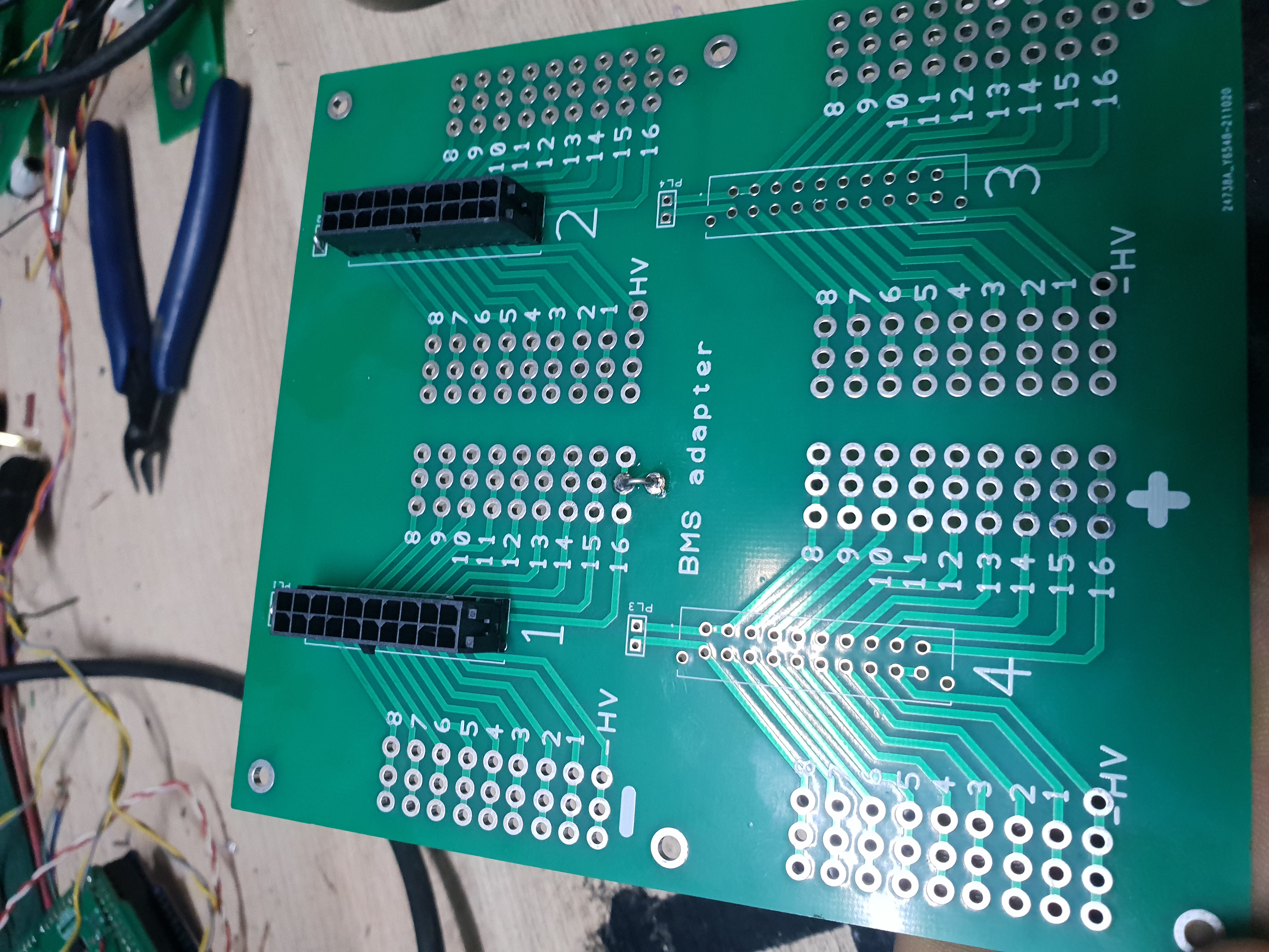

I also made some testing boards for 4x 16S cells to connect my pack to the balancers.
Will keep you updated...

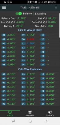

OK... I connected the new balancer and connect it to the first battery from negative side inside the pack.
I had some trouble connecting to the CAN. It should be 250kbd, but i just cant get it to run...
Next i searched for bluetooth signal and lo and behold i got it immediately!
I set the cell numbers and watched the values. I could select balance command and it would start.
It is a nice UI. I just need to get the CAN to work. Will get back...

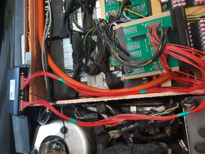

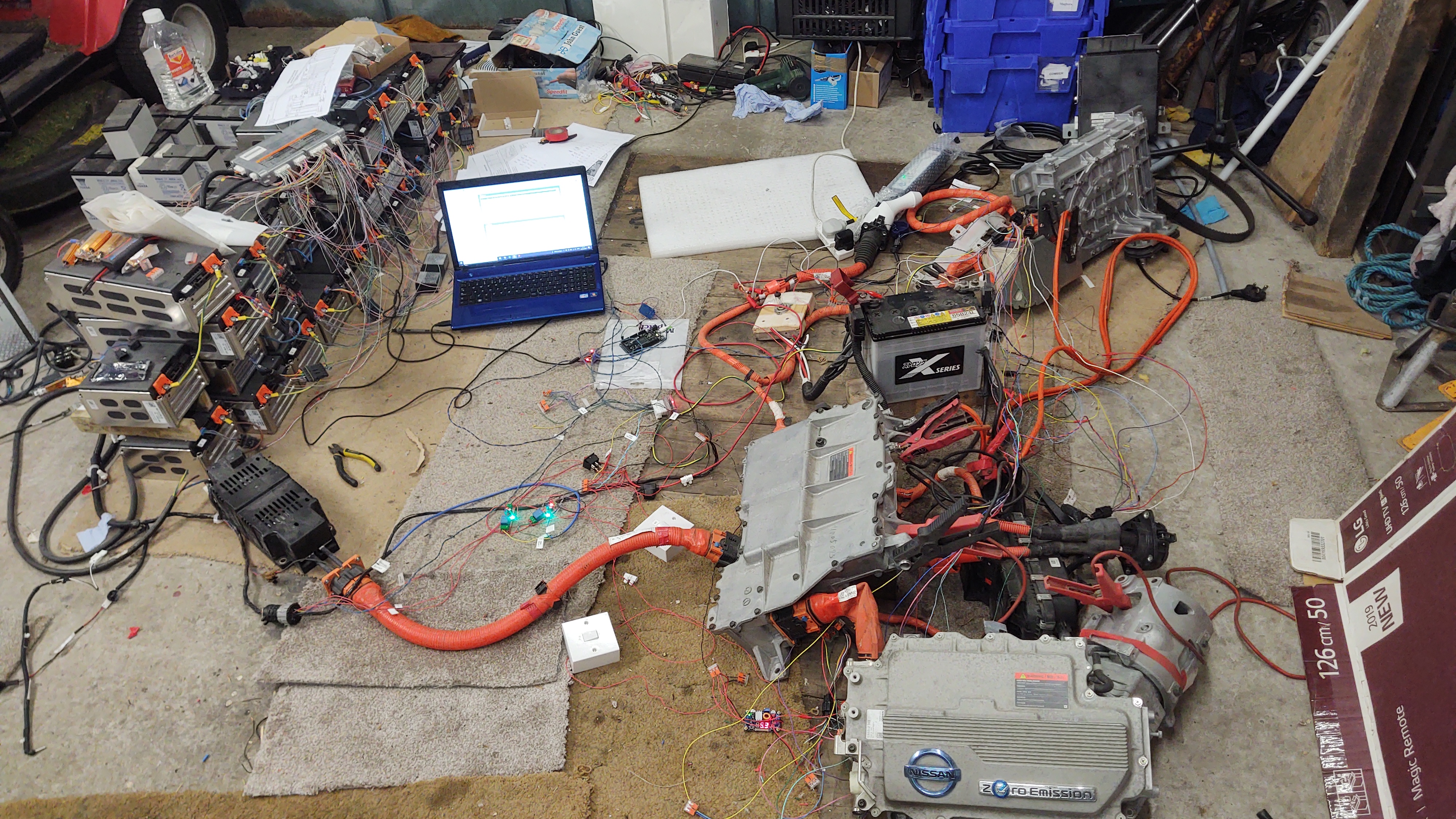

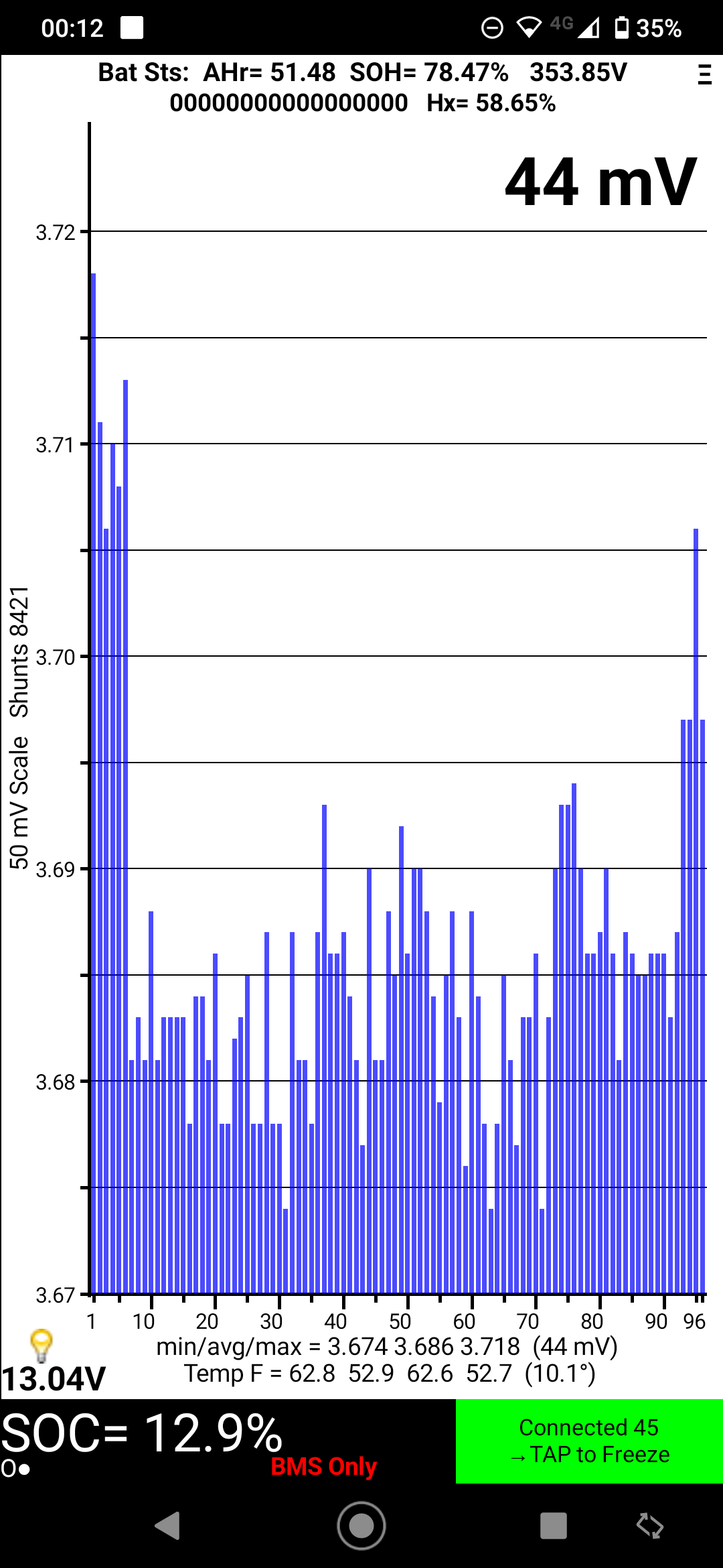

After a lot of time spent adapting wiring looms and faffing about I managed to get my Leaf BMS working with the eGolf modules.
This is the setup at the moment as I'm trying to get the charger working but the BMS only needs 12V and CAN connections for the OBD2 port, Getting the DC-DC working was very simple in the end.
This is the output on Leafspy
It seems to be trying to balance the pack but it's a very slow process. When I get it charging and discharging I'll know better if it's going to be able to balance these cells but at least it is showing their voltage.

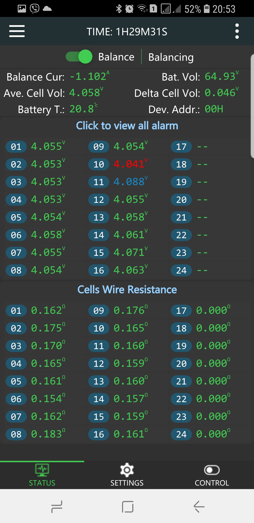

I have fiddled some with my batteries and its balancer modules.
I took my 65V 16S charger and clip it to individual packs to correct them a bit according to 4V per cell reference on other modules.
FYI inside balancer app settings menu i found ADC position which declared voltage of a complete module. It is a setting to smooth differences with ADC sensing.
If i first measured complete module voltage with my multimeter i got 95.8V and 3.99 on individual cell modules. That module in particular was showing 94.8. When i corrected the value of complete module i immediately got correct value for individual cells.
Just saying there is more to the UI app than first impression shows.

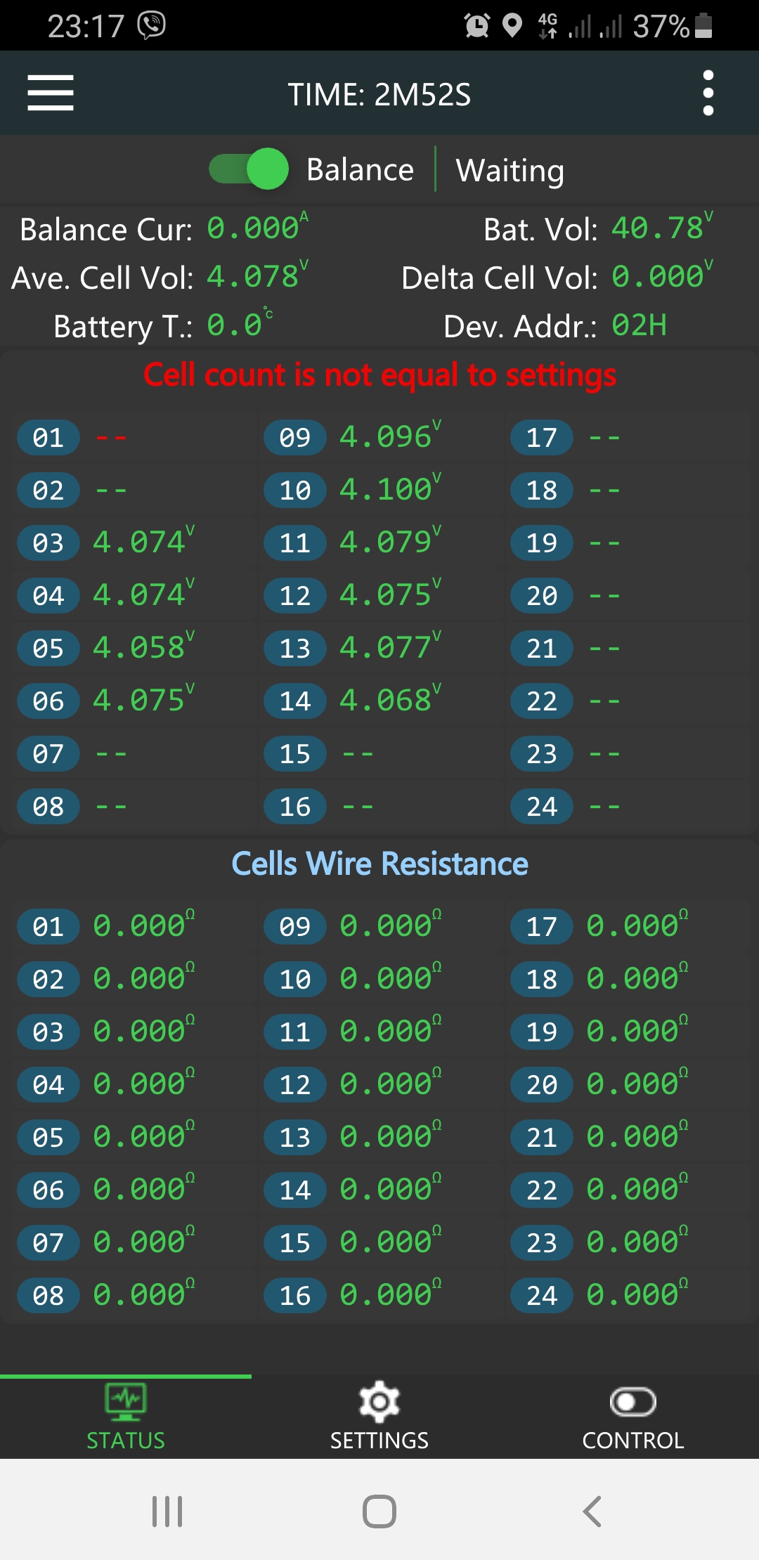

Well now... i have discovered the first bad side of those JK 24S active balancers.
Inside the circuit there are small 0603 resistors of 0.01R value. They are somewhere at 500mW value and seem too small for 1A declared balancing.
I use those balancers actively for about a year.
This weekend i found one module in error! Bluetooth screen showed gaps between cells.
When i measured cells for error i couldnt find any. All were sitting at 3.80V.
I inspected the electronics board for obvious errors. I found several resistors burned.
I went on and contacted Hankzor BMS rep on Aliexpress. They were really forthcomming and helpfull with instructions even though i had a feeling of language barrier.
In the end they advised replacing all R01 resistors with new ones.
As i didnt have them in stock i went and soldered some thin silver wire in their place, just to try if rest of circuit was ok.
I got good contact with BT and CAN! Looks like BMS is alive.
EDIT: To clarify, BMS was not faulty from the long term use of balancing at 1A the cell fuses burned up. They are fairly easy to replace even with hand soldering. I think i will see more failed fuses in future and i intend to replace them. Another preventive measure would be to limit balancing to two scenarios:
1. When any cell would be higher than 3.90V
2. When the biggest voltage differential allowed would happen. Value would be set pragmatically.
