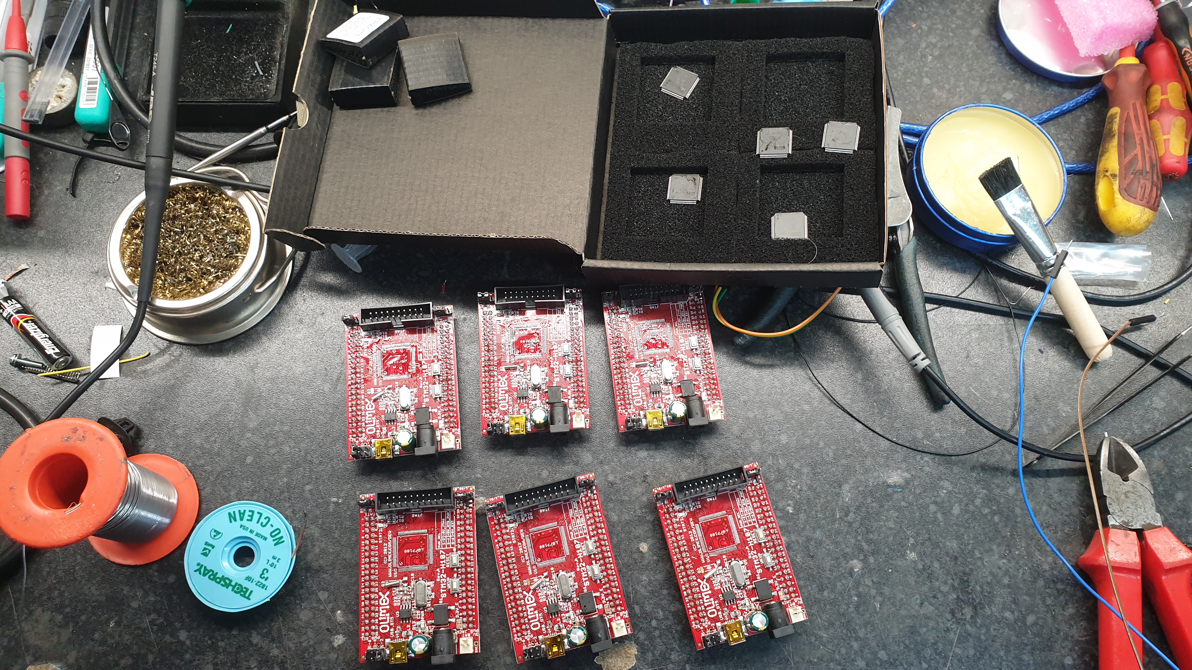

Reckon I'll buy 10 of these and pull off the mcus :
https://www.olimex.com/Products/ARM/ST/STM32-H107/

Posts: 4007
Been thanked: 1138 times
Re: STM32 woes
Operation Harvest is a go:)
Been thanked: 1918 times
Re: STM32 woes
That's how desperate the situation is
