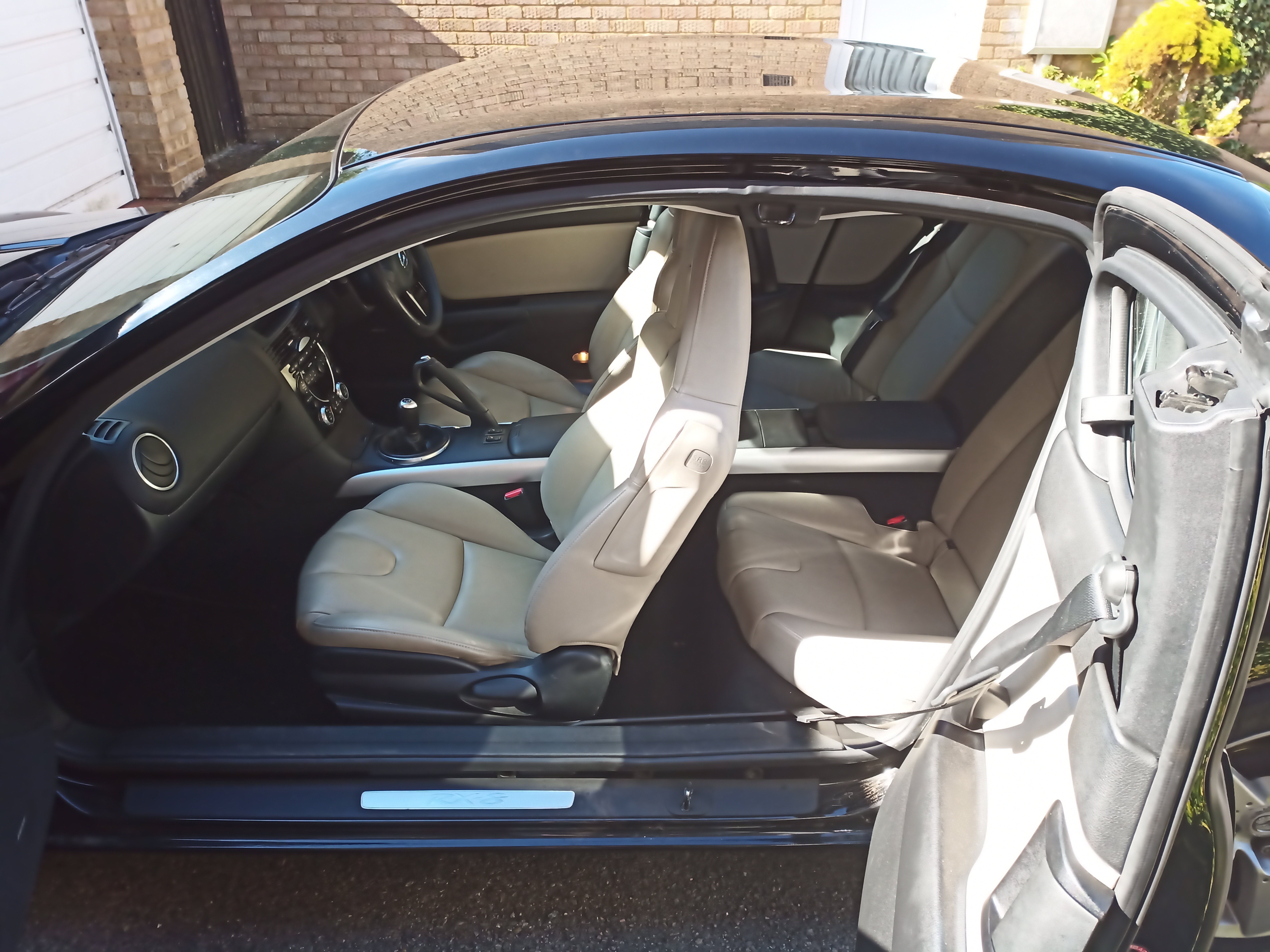

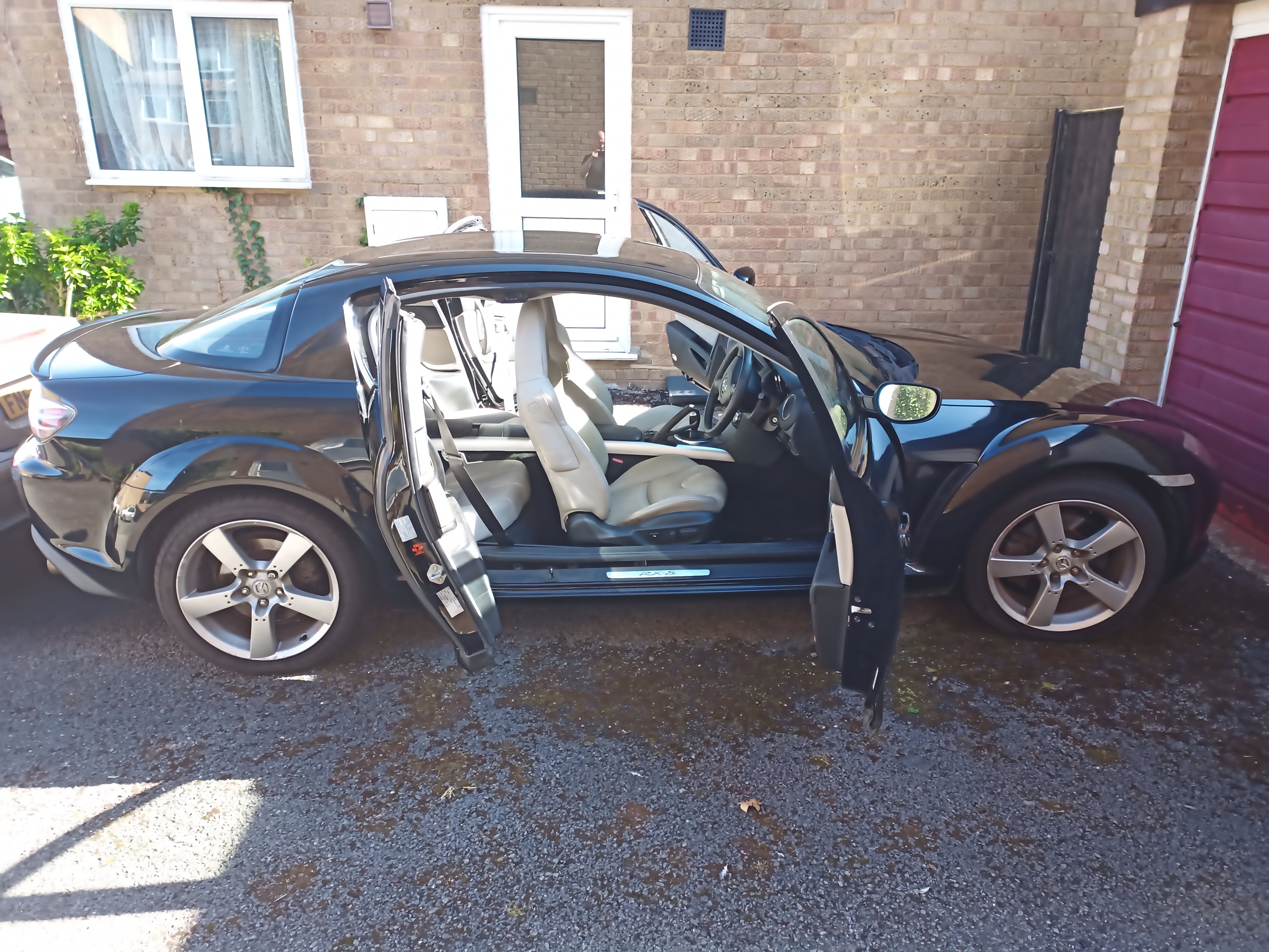

I think the RX8 will be an excellent platform for the Nissan Leaf donor gear to go into.
The car itself is very well balanced and only let down by the reliability of the engine.
The Leaf motor is probably pretty similar in size to the rotary so shouldn't upset the balance.
The RX8 was disregarded because it didn't live up to the FD RX7's legacy.
For this reason they are very common and very cheap to get hold of currently.
But only for a while until they become "the last rotary" and start to command classic prices.
I'm considering picking one up with a manual transmission and ruined engine to mess around with.
So I'm interested very much in your progress.

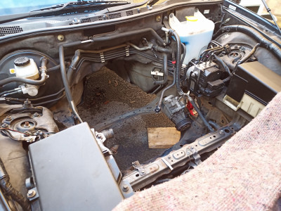

Well I finally have a big hole to fill. Rotary is seriously heavy for it's size.
Still need to remove the fuel tank and diff, but I can move it into my garage now.

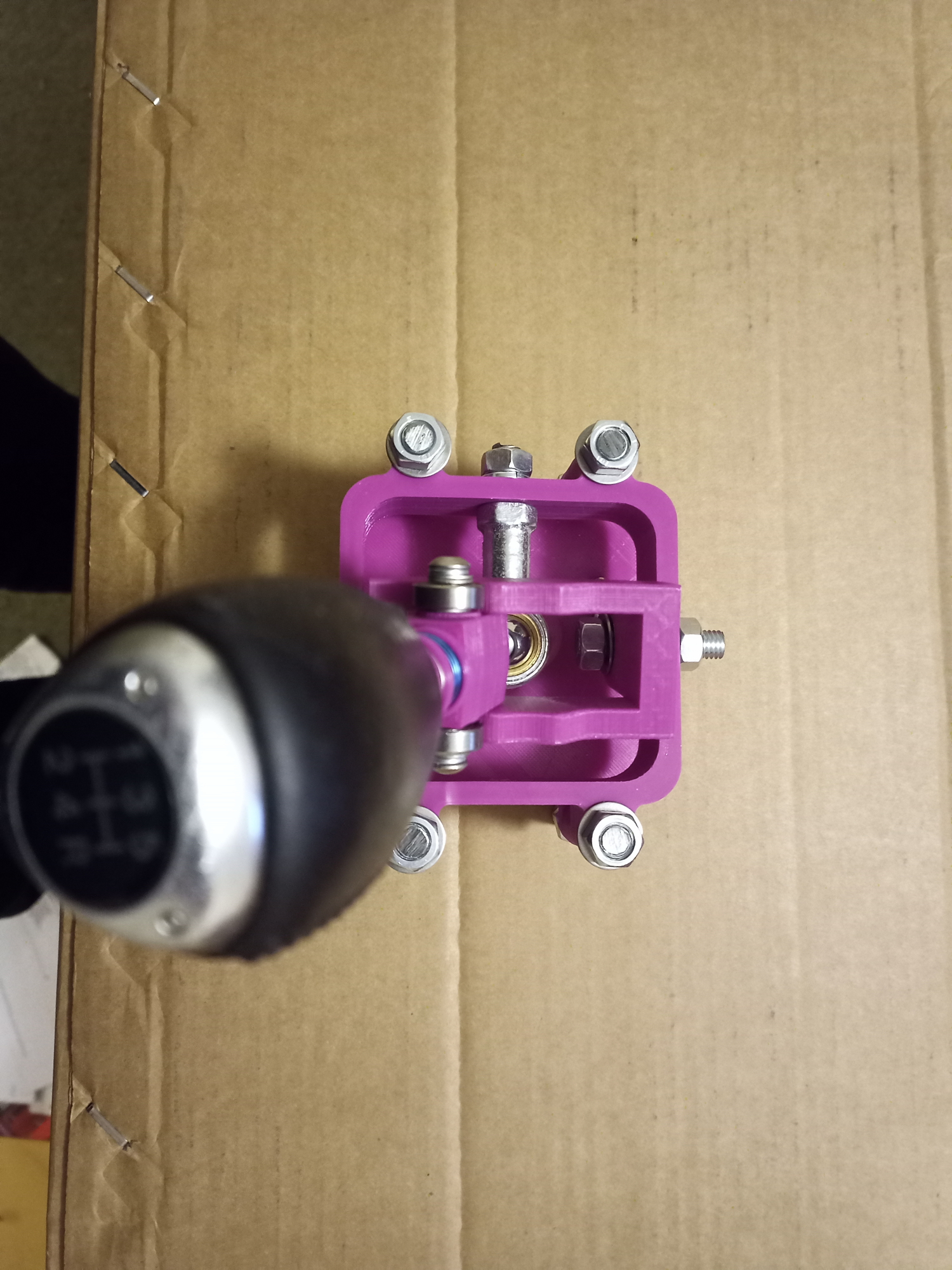

It's been a while since I did an update. I had some space problems in my garage, but they have just been cured with a set of wheel dollies, so more work on the car coming soon.
Off the car I got an instrument cluster and now have the ability to drive all aspects of it. I'll be making a custom VCU to drive the instrument cluster and intercepting some of the signals from the main VCU (vehicle speed for example) to pass on with some modified data for other things in the same CAN message.
I also wanted to retain the original gear knob for selection of forward and reverse and I've modified a sim racing gear selector available on thingiverse to both be more positive and take the RX8s gear knob which is quite heavy. I'll print the final version in PETG. Once I'm completely happy with it I'll put the files up on thingiverse.
Prototype printed in PLA:

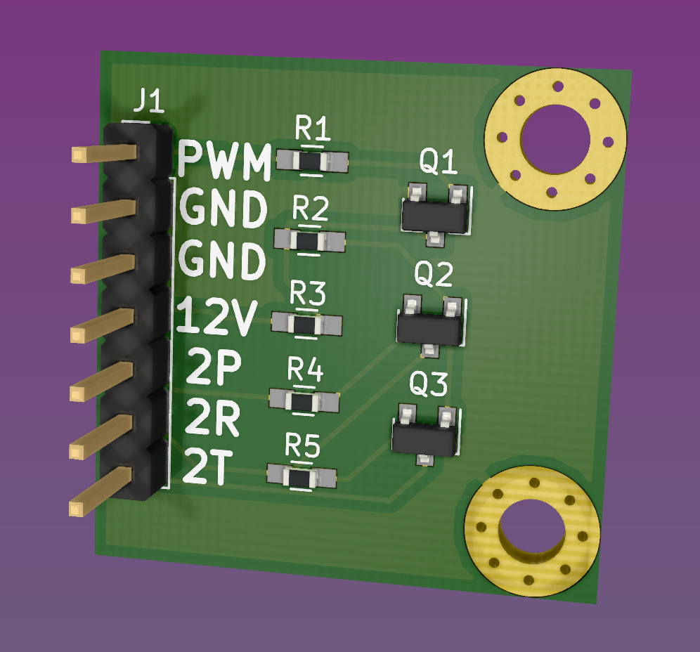

On a more positive note I can drive the fuel gauge from PWM now (thanks to someone on another forum giving me the idea). Boards arrived today from JLCPCB and I built one to test, looks like the original sensor resistors were logarithmic so I need to do some maths, but after increasing the arduino's PWM frequency I can set the fuel level with a pot
The board is very simple, transistor, 2 mosfets and some resistors. If I'd thought to add the capability to use a low pass filter I probably wouldn't have needed to change the PWM frequency, but no real loss. Once I'm satisfied it's working properly I'll put the hardware design and a simple arduino driver for it up on github. I've also printed a forward/neutral/reverse gear selector based on a sim racing design from thingiverse so I can keep the original gear knob for that original look. I had to change the design a little as the knob is so heavy and I don't want it slipping out under acceleration. It's pretty firm to select now, so hopefully it'll be OK, if not I know how to modify it further.
