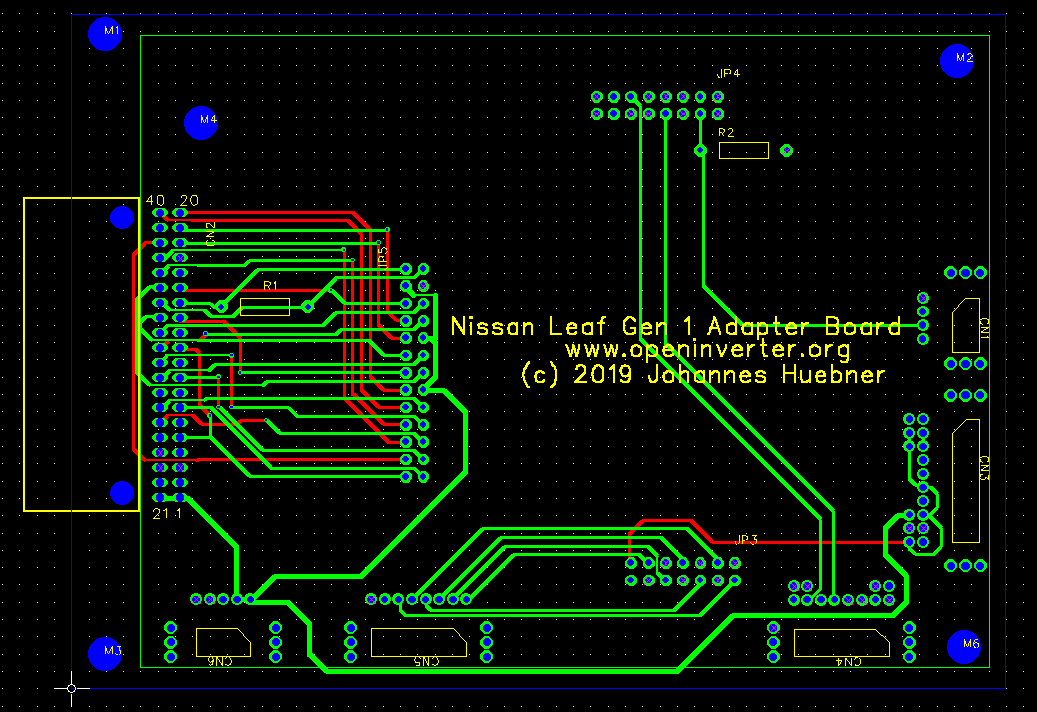

Now, back to the leaf board some questions arose:
1. Where is the bus voltage?
2. What is CN1?
3. Are there 3 current sensors?
4. What is the "good" level of the fault signals on CN3? Can I just have them on a common 5V pull up (wired-AND) and fault out if one goes low?
5. Do you know any of the other signals on CN3?
6. Pin pitch of CN2?
7. Where is the motor temp sensor connected? Is it the same as in Leaf2?
2. What is CN1?

Re: Leaf Gen 1 board
johu wrote: ↑Fri Jul 26, 2019 5:04 pm Yeah I'd definitely vote for KiCAD. Just doing the first steps in it and it seems really intuitive and I could easily find answers to beginners questions on the web (good user base).
1. Where is the bus voltage? If you mean 12V+ then they are on pin 39,40.
2. What is CN1? Temperature sensor on pin 1 and 3
3. Are there 3 current sensors? Yes, they are on CN4 and are three in total.
4. What is the "good" level of the fault signals on CN3? Can I just have them on a common 5V pull up (wired-AND) and fault out if one goes low? Check the schematics I sent you on email before, maybe they have the answear
6. Pin pitch of CN2? 2.2 mm is the pitch.
7. Where is the motor temp sensor connected? Is it the same as in Leaf2? It's the same connector on the motor, the tempsensor comes in on pin 15 on CN2.
Cool, thanks
1. no I mean a signal that represents the high voltage level
4. Yes they are all pulled up to 5V, does that mean 5V=good?
7. The temp sensor must have 2 pins, what is the other one connected to?
johu wrote: ↑Fri Jul 26, 2019 7:33 pm Cool, thanks
1. no I mean a signal that represents the high voltage level.
That's over my paygrade to figure out
Sounds reasonable but maybe someone else on the forum have better knowledge
Pin 14 on CN2 is GND for tempsensor

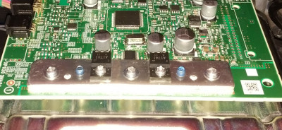

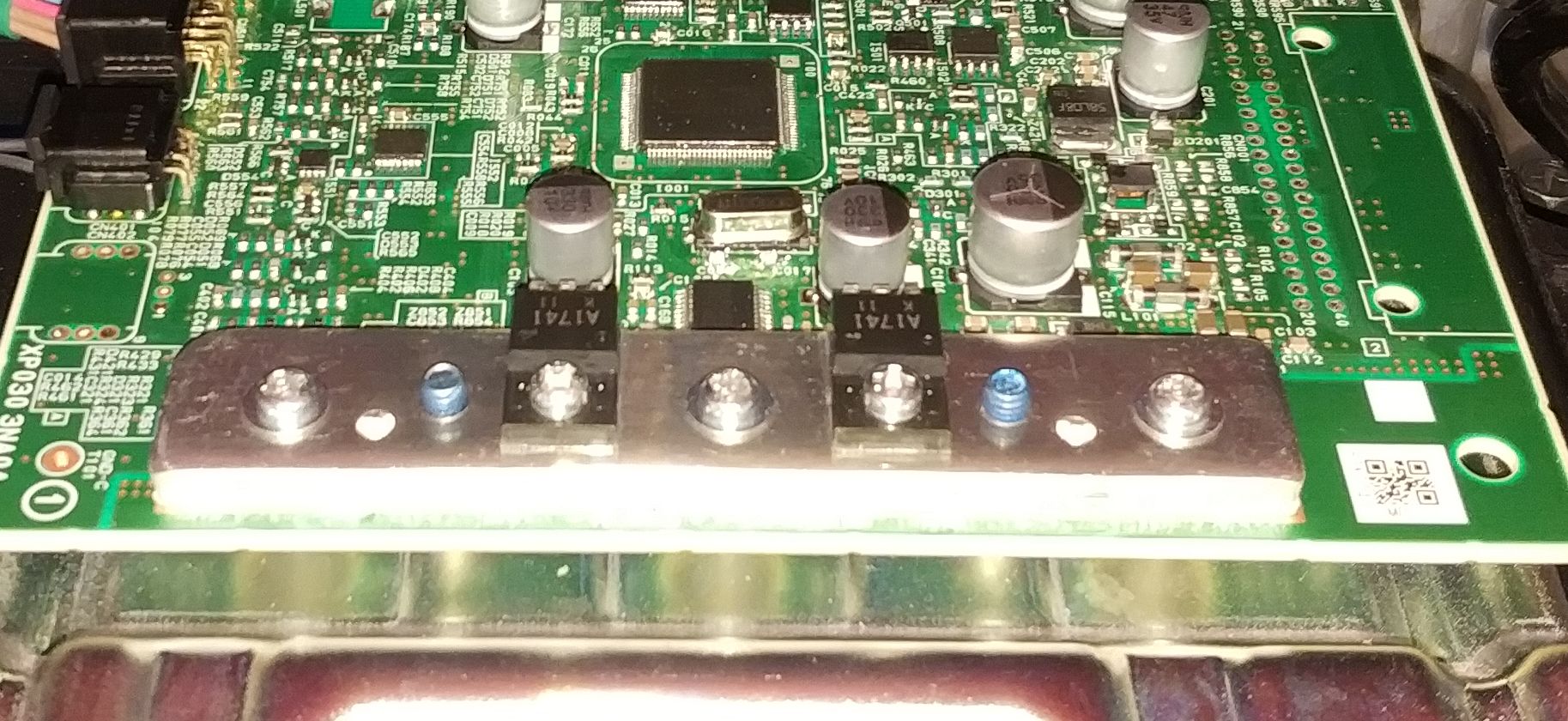

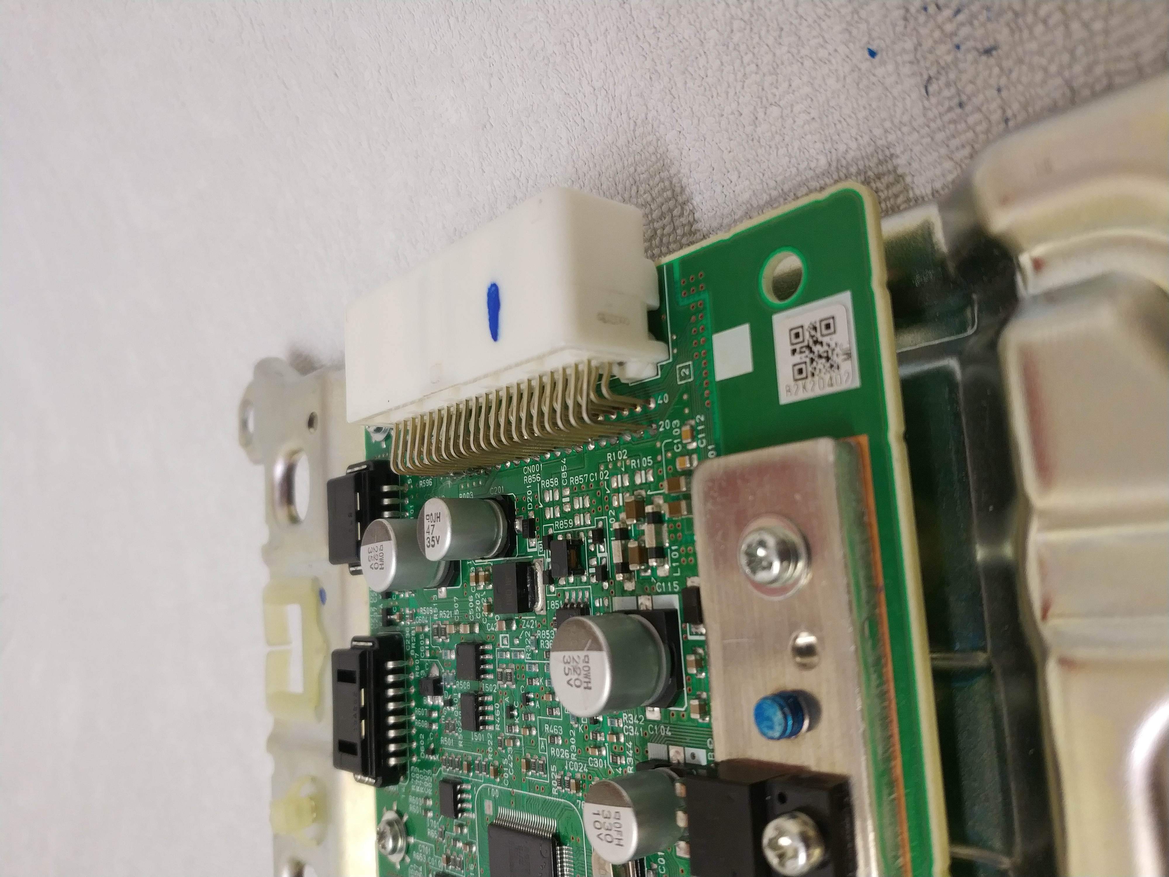

BTW does anyone know what the large PNP power trannies are used for on Nissan original boards?
- Teknomadix
- Posts: 27
- Joined: Sun Jul 14, 2019 7:37 am
- Location: Cascadia
- Been thanked: 1918 times
Right. If it were a PNP/NPN pair I would have said resolver excitation. But two PNP...
kiwifiat
- Posts: 101
- Location: Vancouver, Canada
- Been thanked: 12 times
Pure speculation, precharge and charge relay drivers for the battery pack. At least that was my thoughts when I saw a similar pair on the gen2 board.
- Posts: 4006
- Been thanked: 1135 times
No they dont use the inverter for contactor control.

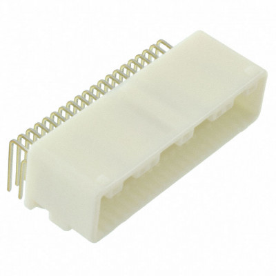

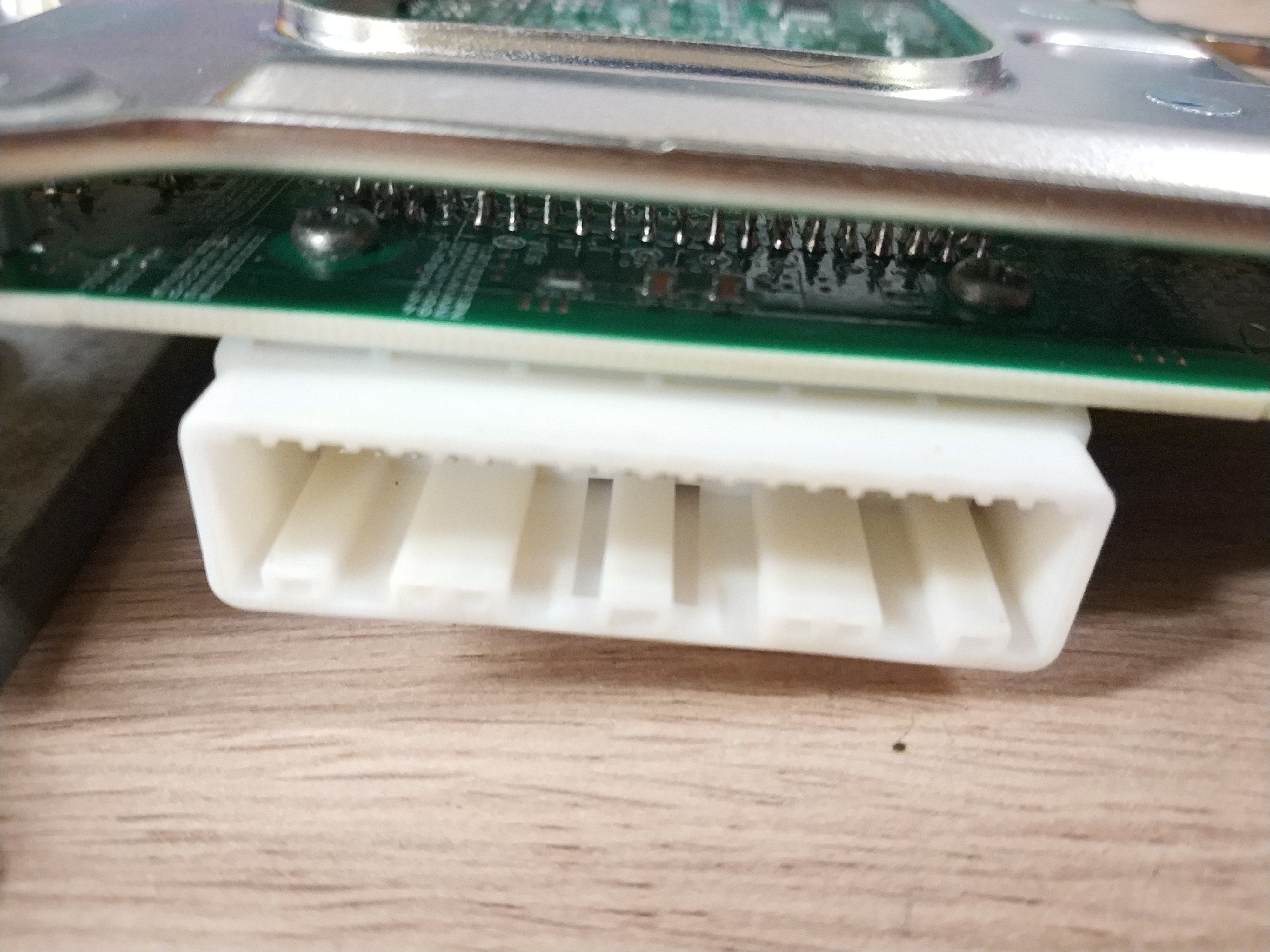

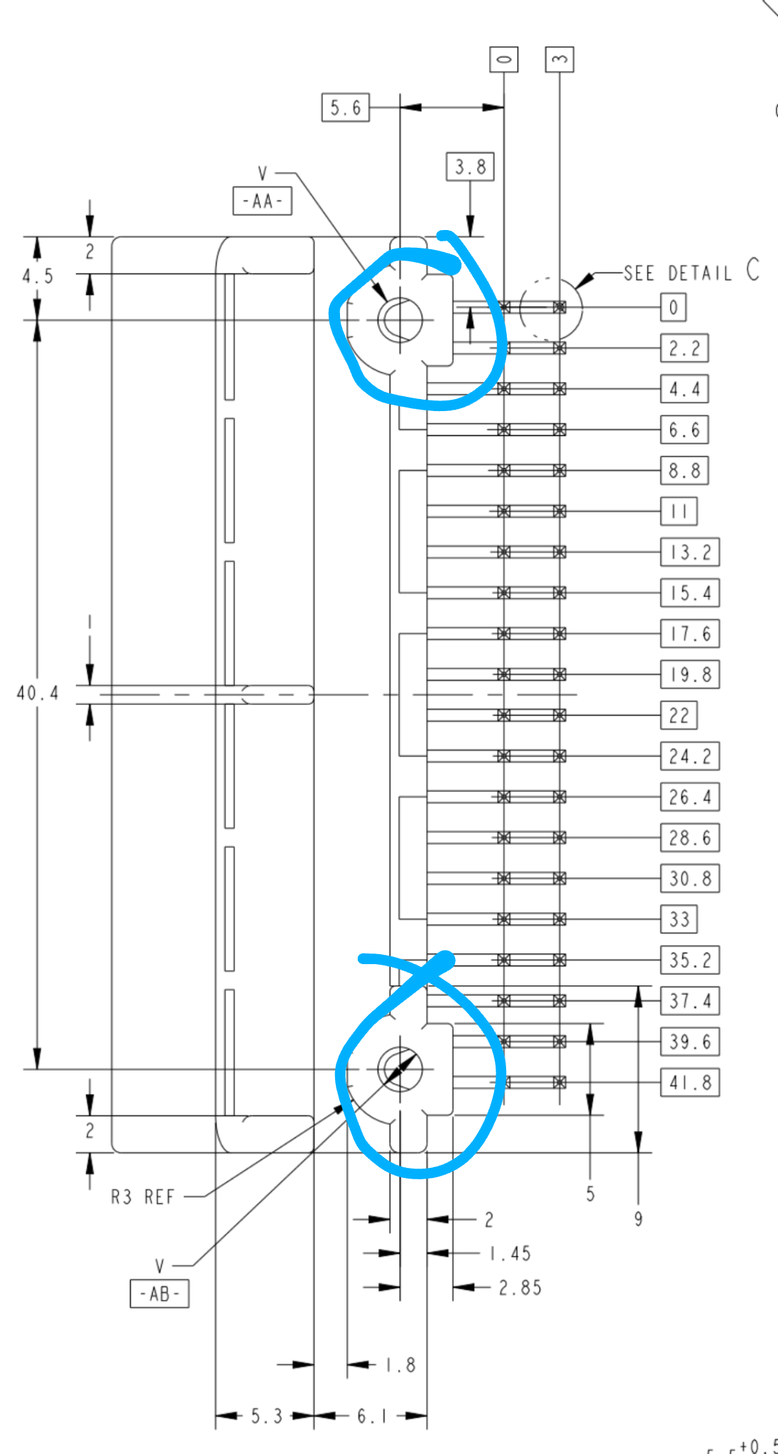

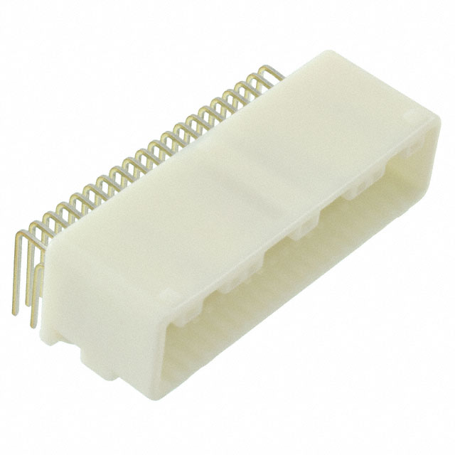

Is this the outside-world connector: https://www.digikey.de/product-detail/d ... ND/2273491
2.2mm vertical and 3mm horizontal pin spacing.

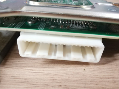

I would say that's the correct connector. Looks really like the one I have.johu wrote: ↑Mon Jul 29, 2019 12:24 pm Is this the outside-world connector: https://www.digikey.de/product-detail/d ... ND/2273491
Just like the drawing suggest from the connector on Digikey is the two screws holding it to the board on the underside, see attachment.
The numbering of the connectors seems also correct.

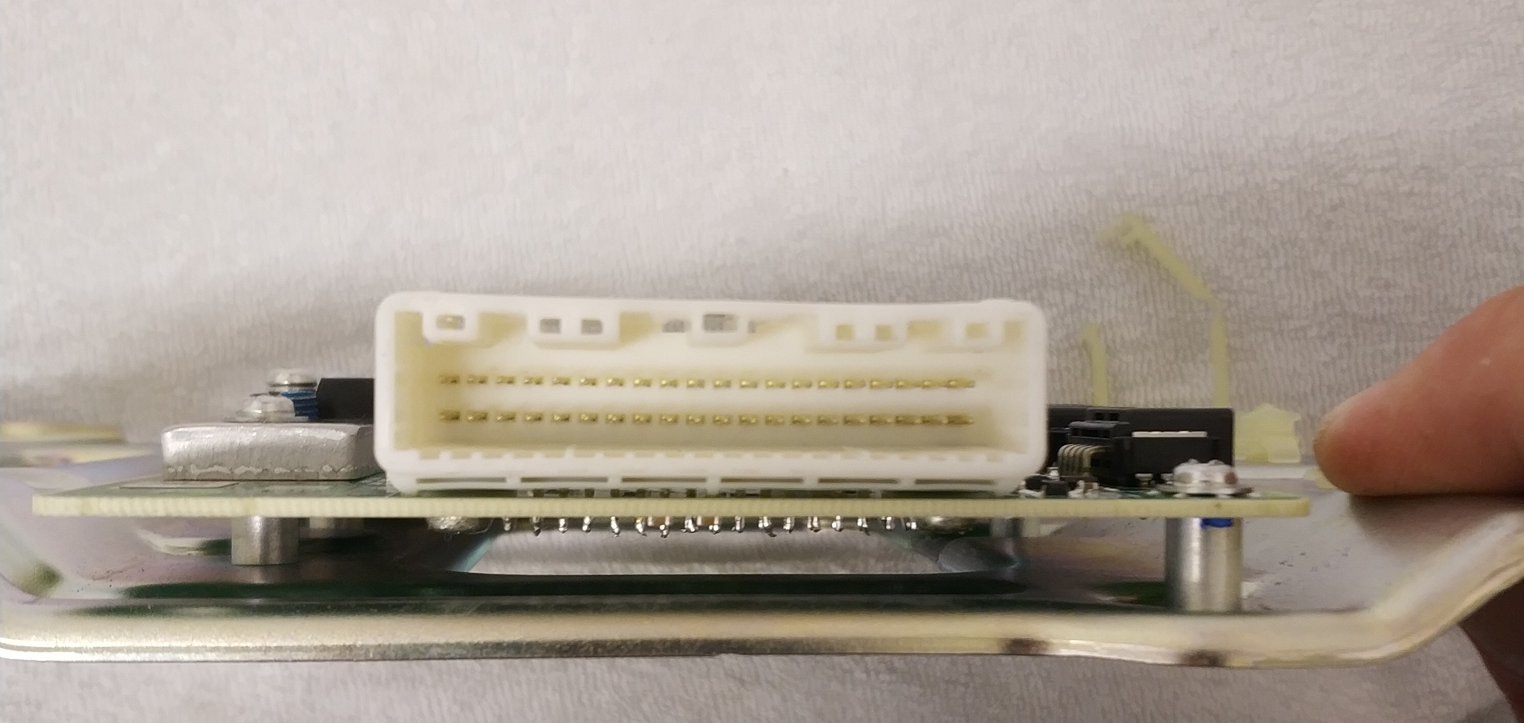

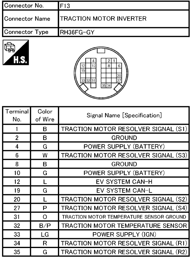

Just an heads up now when you folks are designing adapterboards. There is a little caviat that Nissan has done with the way cables go from the outside green connector to the inside white connector (the one Johannes found on Digikey). There is not much of the cables going from one number in the green connector to the same number in the white connector. I think this makes it a litle more tricky to design the board regarding how to use the pins on the white connector.
My suggestion is that you use the original needed functions like motortemp, sin, cos, excite, 12V+, GND, IGN and CAN just like Nissan has done on the white connector. In that way are we still able to look back in Nissan maintance manuals and see the correlation of functions on the pins when you look up wiring diagrams and pictures of connectors and so on. An extra little problem is that Nissan don't show the white contact in their manual.
I tried today to filter out the must needed cables between the white and green connector but falled a little short on how I cut the green connector for 6 months ago, the cables are left very short on my green connector. Will try again tomorrow but every one else who are in need of this adapterboard should have a look at their green connector and try to write down the colours and pins between the connectors.
Also have a look at the pinout of the white connector, see attachment, which I can confirm is the correct order.
What do you all think of this thought?
Robin Guldmyr
MR Electronics AB
MR Electronics AB
Okay, I did my best to sort out the connection pins between the two connectors, see attachment.
I've also attached the pinout of the green connector from the maintance manual.

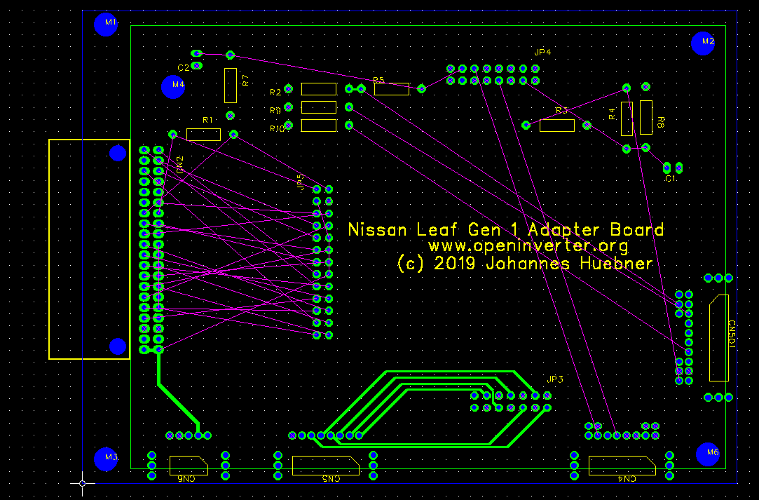

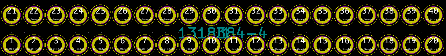

Getting started on the adapter board. KiCAD was too much trouble so using FreePCB again.
Has anyone found the bus voltage pin?

And I could use some help on "CN3"
Pins:
Pins:
- nc
- connected to 3
- connected to 2
- bus voltage?? PWM or linear?
- n/a
- Fault 1
- n/a
- Fault 2
- 5V
- nc
- nc
- Fault 3
- Fault 4
- 12V
- 5V
- Fault 5
Yeah sounds good
So I've wired up all more or less known signals, assuming all 5 fault signals are good when not low. So they have a common pull-up resistor of 10k on the mainboard and 1nF filter cap.
Missing things are the bus voltage and the characteristic of the heatsink temp sensor.
I did a pin map based on Robins table. I'm reusing Nissan pin map and in addition mapped some IO on spare pins. Everything is brought out to the white connector but not to the green one due to a lack of pins.
