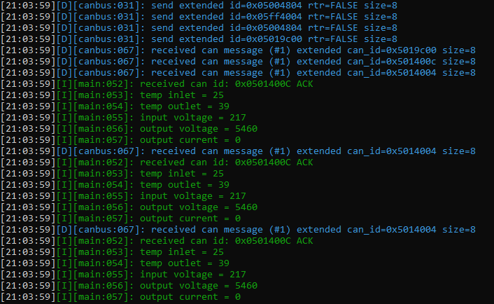

Re: Communicate and control Eltek Flatpack 2 HE
0x05004804 followed by 0x05019C00 after 100ms. Also tried 0x05009C00, with no success. Sending 0x05004804 is working nice, though, so I don't suspect communication issues.
- canbus.send:
use_extended_id: true
can_id: 0x05004804
canbus_id: eltek
data: [0x06, 0x31, 0x71, 0x01, 0x60, 0x38, 0x00, 0x00]
- delay: 100ms
- canbus.send:
can_id: 0x05019C00
canbus_id: eltek
data: [0x29, 0x15, 0x00, 0x40, 0x15]Re: Communicate and control Eltek Flatpack 2 HE

Aha, you are trying to change the default voltage, correct?
Using 0x05009C00 have always worked for me. Try without the 100ms delay between the two messages.
Are you shure you are using the correct serial nr?
This is my latest code for changing default voltage. Reads the serial nr sent from the FP via can.

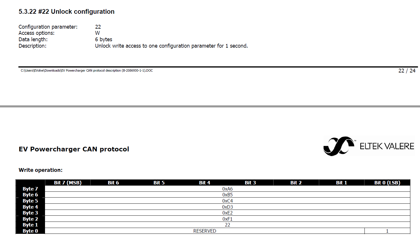

Can you please elaborate a bit more what these "Byte 0 = 0x29, Byte 1 = 0x15, Byte 2= 0x00" do?bexander wrote: ↑Fri Jan 15, 2021 4:28 pmThis default voltage can be set by sending first login and then a message with ID: 0x05009C00.
Byte 0 = 0x29, Byte 1 = 0x15, Byte 2= 0x00.
For 43.7V translate 4370 to HEX => 0x1112, separate into 2 bytes and place as byte 3 & 4.
Voltage can be set between 43.5V and 57.5V. Current can be set between 0 and max 62.5A for a 3000W FP.
These translate to 54.17. What value is that?
Overall I want to set default current limit. Can't find what command I need to execute.
Thanks.

I don't know what bytes 0-2 do, they just work with the given values. Byte 3-4 sets the default voltage.
I don't know if it is even possible to set a default current limit.

I am having some issues to set output voltage on a HE version.
Recently I used a non-HE version for arround 3 years but it finally failed
I am electronics engineer and have experience but not strong on programming.
I have build a "remote" controller using a small "ESP32-C3/S3-Zero" board with a TTL/CAN transceiver, and ESPhome as main software code. So I can control by WIFI
Communication is correct and can monitor in HomeAssistant too, but recently buyed "2nd hand" module 48/2000W HE v2.1 looks that does not works the same as old version.
I am using as a battery charger for "peak shaving" in my home.
I can set voltage from 55v to 57.5v every 2sec....5sec....even 10seg as precise +/- 0.1v (do not need more than 57v so it was software limited. not tested higher values)
these "high range" goes fine but for lower setpoint I see different curve.
setpoint: 55.0v = Output:55.05v .....54.0v= 53.8v .... 51.0v= 52.3v .... 48.0v = 50.15v
I know there is few information about Eltek, even it looks a great rectifiers, but someone knows about this issue ??
I have read lot of github and personal webpages but not really explained this issue or firmware mistake, just only mention it.
Just see that here are post to comment communication issues with Eltek Flatpack2 rectifiers.
