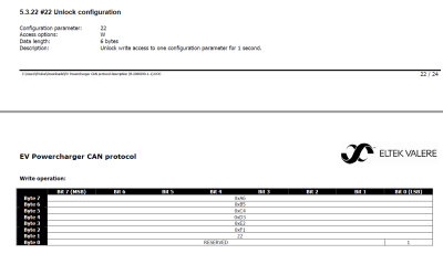

bexander wrote: Mon Nov 28, 2022 6:20 pm Sorry, totaly missed your post. :(
You need to send at least 0x05FF4004 (or 05) repeatedly after login is complete.
In my case I send login message (0x05004804) with serial number followed by 0x05FF4004 with desired data every 1 second.
To set default voltage I send login followed by 0x05019C00 with data as per your post for 48,00V then power off FP. When restarted it should go to defaut voltage of 48,00V after walk-in is complete (should take approx 5s or 60s).
Hello, having the same issue, I'm suspecting locked configuration, but struggling with identifying correct frame ID. Any ideas?

The datasheet is for at EV Powercharger and not the Flatpack 2 HE. I have not heard of any locked configuration for the Flatpack.
What message are you sending and at what frequency?

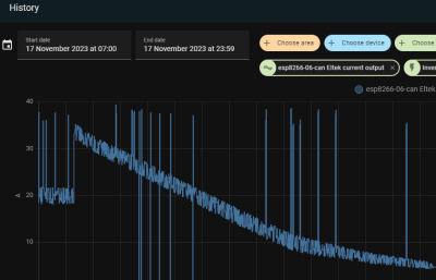

TomHC wrote: Mon Aug 28, 2023 8:53 am BTW, anyone interested in Home Assistant /ESPhome control of Flatpack2, here's the code - https://github.com/taHC81/Eltek-Flatpack2-ESPhome
I have the unit set to limit its voltage to 48V for my batteries
It successsful tails off the charge power as it reaches its target voltage, but then gives it full throttle every few minutes
Ive edited your code only to amend the serial number and it logs in frequently and changes set voltage, but i still seem to have full throttle applied regularily
I note from your github page:
note that PSU is reverting to the default voltage with no current limit while the communication is lost
Any thoughts how i can prevent it disconnecting?
