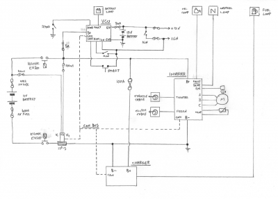

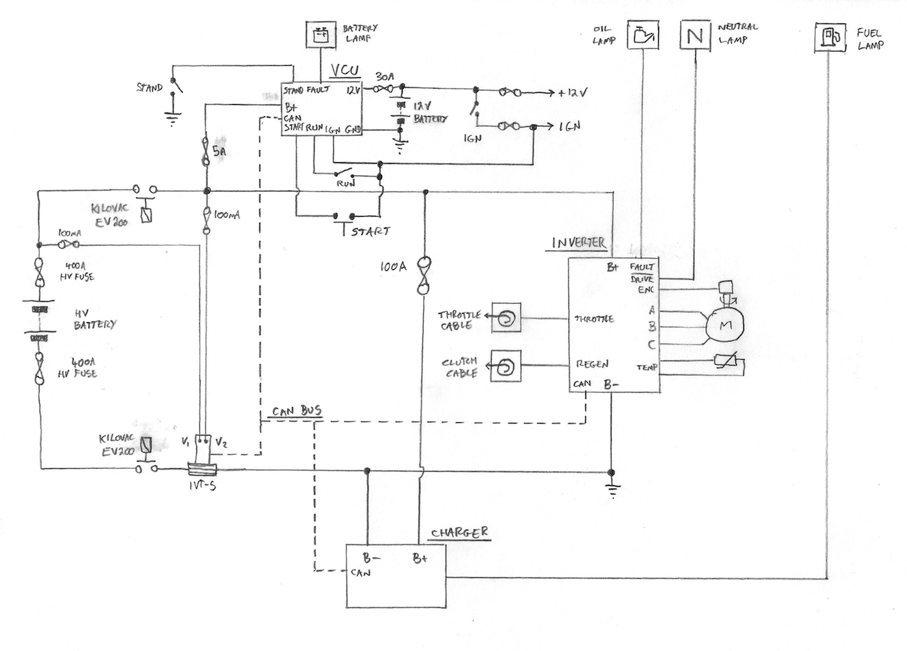

Good question - one I'm grappling with right now
As of today, I've settled on:
1x open source "VCU" (based on a Teensy) that will do the physical switches/dials/precharge/contactors etc and send any necessary enable/disable messages over CAN. It will also run the guess-o-meter code for the range estimation using CAN messages from an Isabellenhütte IVT-S. It will also (hopefully) manage a bidirectional DC:DC for 12V battery charging and precharge, though that may end up with a Teensy of its own.
1x CAN-controlled inverter. I don't know if this will be an OpenInverter design or something closed-source.
1x CAN-controlled charger. Probably an expensive closed source thing.
- clanger9
- Posts: 205
- Location: Chester, UK
Re: Controlling an analog dash

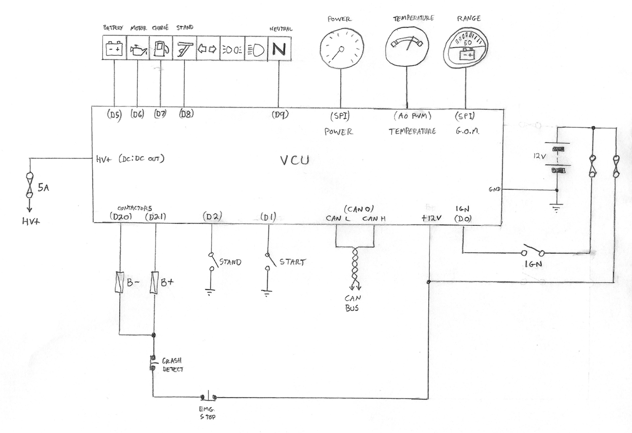

This is roughly where my head is at:
The "VCU" will also have outputs for the temperature gauge & remaining range display (not shown). The basic idea is to preserve as much as possible of the original bike "user interface" i.e. retaining the meaning and purpose of the original switchgear & indicator lights. It is likely that all the indicator lights will be handled by the VCU (via CAN), rather than coming directly from the inverter & charger (as shown in my diagram).
I am trying to get my head around using an Arduino-based finite state machine to do the logic control e.g. ignition must be off & stand down to enable charging, ignition must be on, stand up & starter pressed to enable inverter output etc.
The hope is to have all "my" vehicle-specific code in one place (the VCU), with others providing generic CAN-based hardware & software for the charger & inverter...
Greenbeast
- Posts: 115
- Joined: Sat Dec 26, 2020 5:44 pm
Nice diagram!

Here's my VCU diagram re-drawn. Looking a bit clearer now. Next step is to prototype this on a Teensy...
PWM should work fine for the fuel & temp gauges. For your tacho, you might need to add a push-pull stage if it needs a zero-crossing waveform. Hopefully it'll just accept a variable frequency square wave.
I plan to replace the insides of my mechanical current meter with an OLED display. It will show a bargraph-style battery gauge with a digital range guess-o-meter. The tacho will get a larger (LCD?) display showing an output power gauge and (possibly) HV volts & amps. I tend to prefer the minimum amount of distraction on a dashboard. Which is why I'll be retaining the idiot lights...
