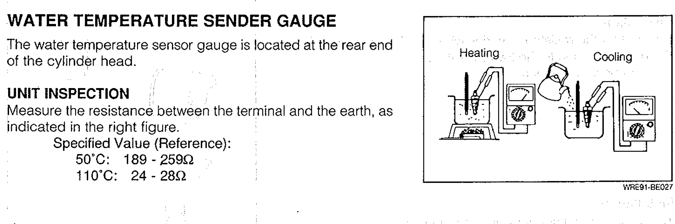

I was lucky enough to find a full service manual recently, the dash circuit diagram doesn't line up completely accurately with my dash and myb tracing of the pins (assume it's for an earlier version of the vehicle), but i'm kinda guessing the temp/fuel senders and gauges didn't change
Temp Gauge Fuel Gauge

Looks good - that should work fine with PWM.

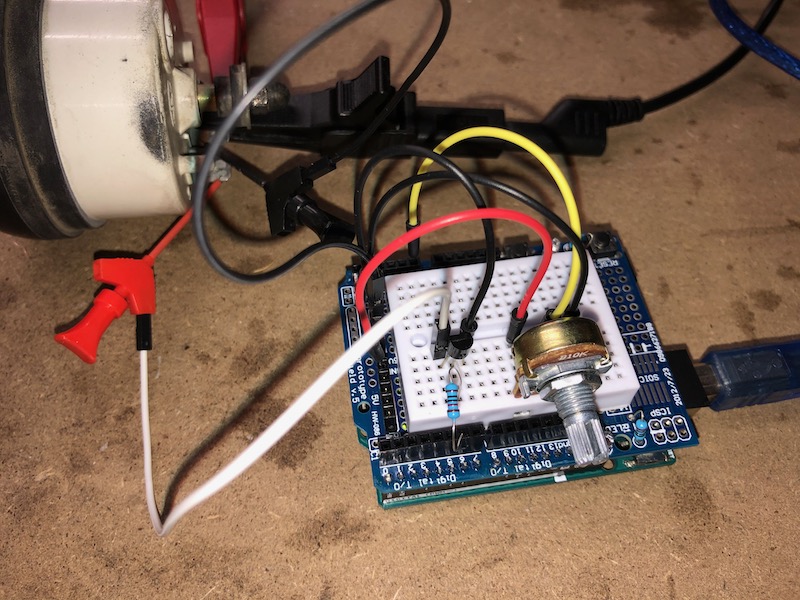

This might be a more useful test setup (on a roll now...)
This is what I used to characterise the gauge. It adds a potentiometer so you can set the gauge to any value. The value is shown on the serial monitor.
NOTE: if you're using a 3.3V Arduino (e.g. Due or Teensy) DO NOT connect the high end of the pot to 5V as shown in the diagram. It needs to be connected to 3.3V, otherwise you will damage your board...
int meter_pin = 6;
int meter_value;
int setpoint_pin = A0;
int setpoint;
void setup() {
Serial.begin(115200);
pinMode(meter_pin, OUTPUT);
void temperature(int meter_value) {
analogWrite(meter_pin, meter_value);
Serial.println(meter_value);
void loop() {
setpoint = analogRead(setpoint_pin);
setpoint = map(setpoint,0,1023,0,255);
temperature(setpoint);
delay(100);
