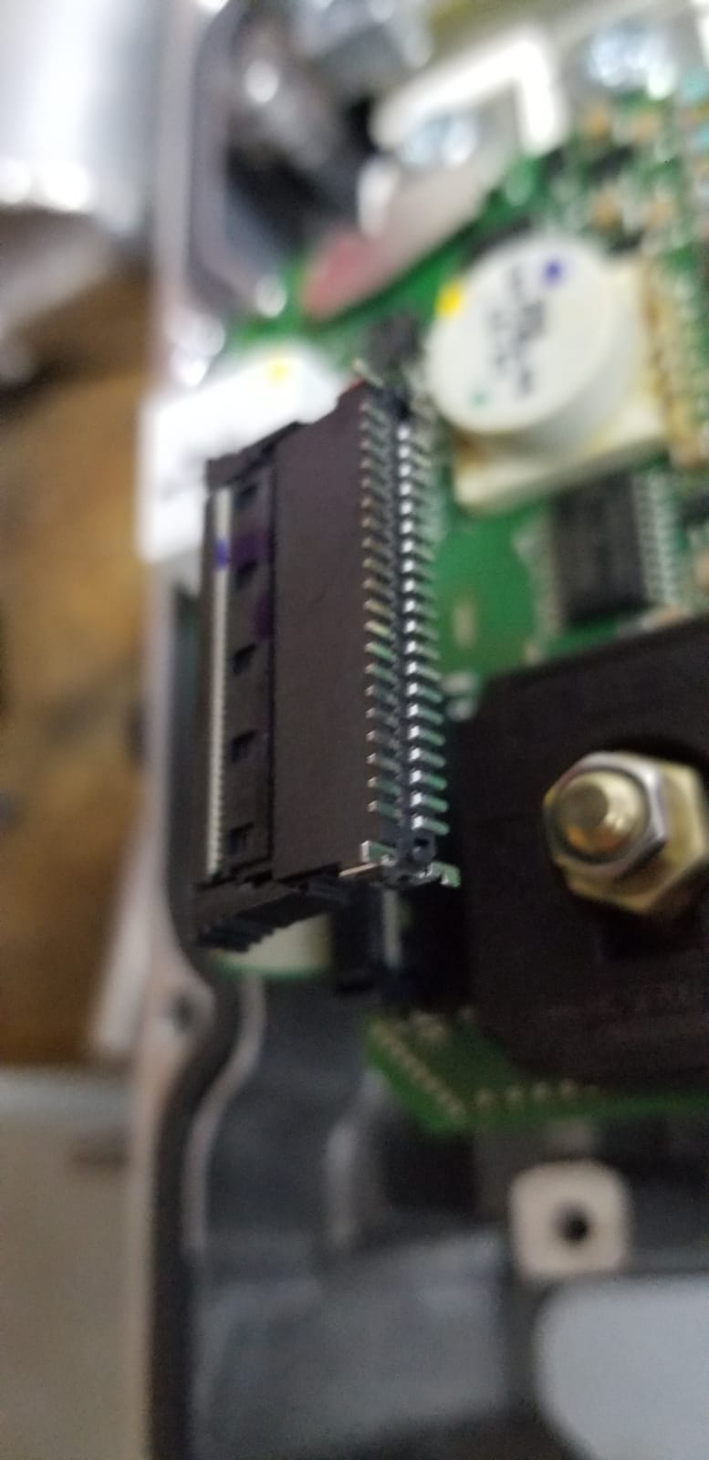

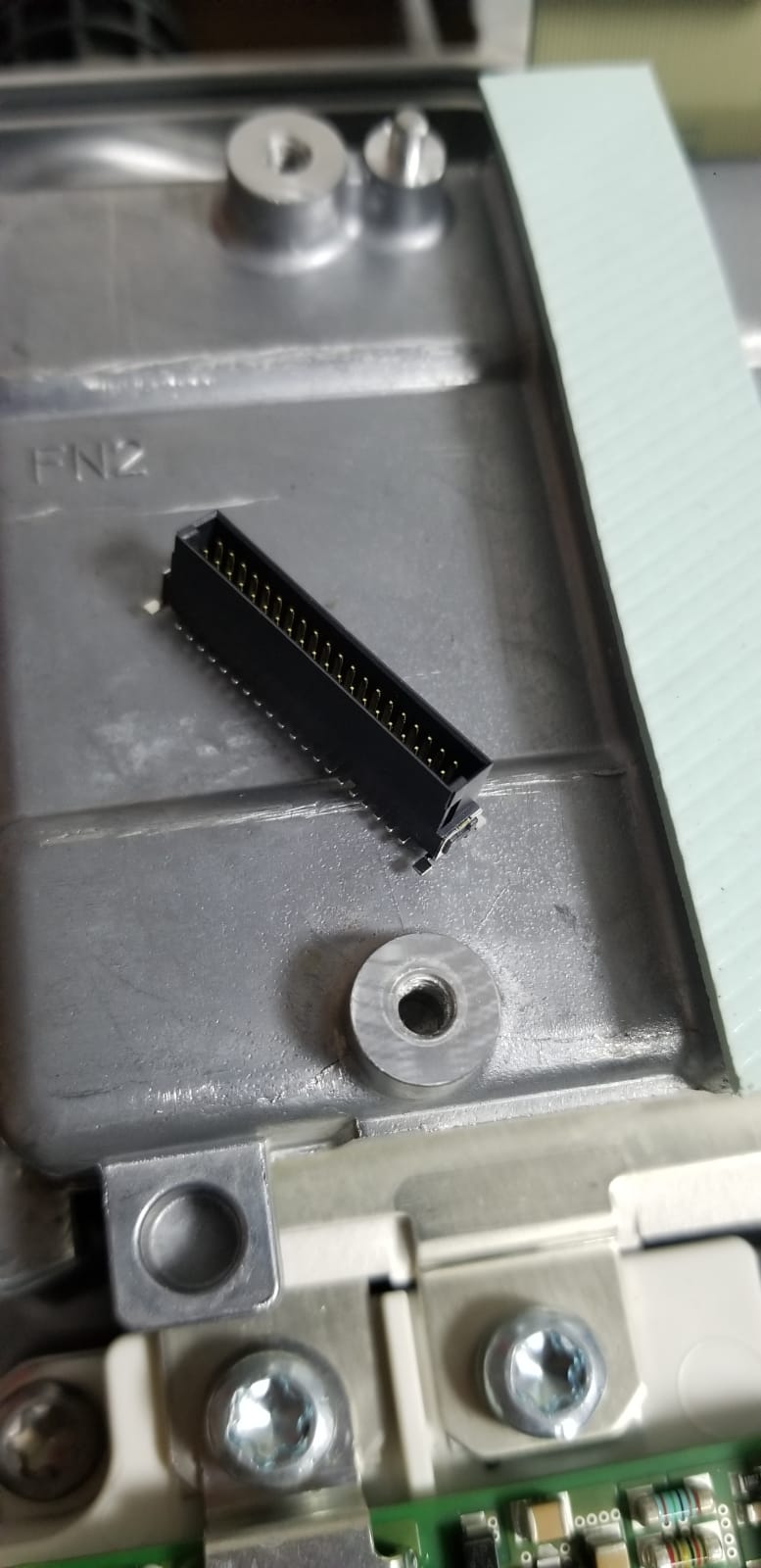

And this should be the correct header: https://www.digikey.de/product-detail/d ... ND/8537679
I think it can only be reflowed as the first pin row is obscured by the second.
The straight version could be hand-soldered, just have to check of the ribbon is long enough

Yes that is the correct header mine arrived today and fits beautifully.

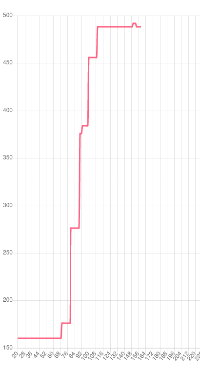

The BMW motor is 12 pole and has a maximum speed of 11400Rev / min. My Bamocar D3 400-400 inverter does not allow too low PWM frequency at higher speeds, when I do an "auto setup". It has a variable PWM frequency depending on the speed and reduces the permitted current at the higher frequencies. In my conversion, I also have BMW's singel speed gearbox and have to use the higher speeds. A 3000km Gearbox + engine 1000EUR. The drive shafts were 800EUR and only needed to shorten one shaft a bit and they fit in Renault's outer CV joints. Have tested the drive package in the car, but an IGBT broke down. Got the correct error code anyway, after checking the IGBT's. I also have a maximum of 440 volts on my battery pack and hope BMW's inverter can take it. As an old car designer, I know that the easiest way to sell a car is with horsepower. That probably applies to your boards as well.

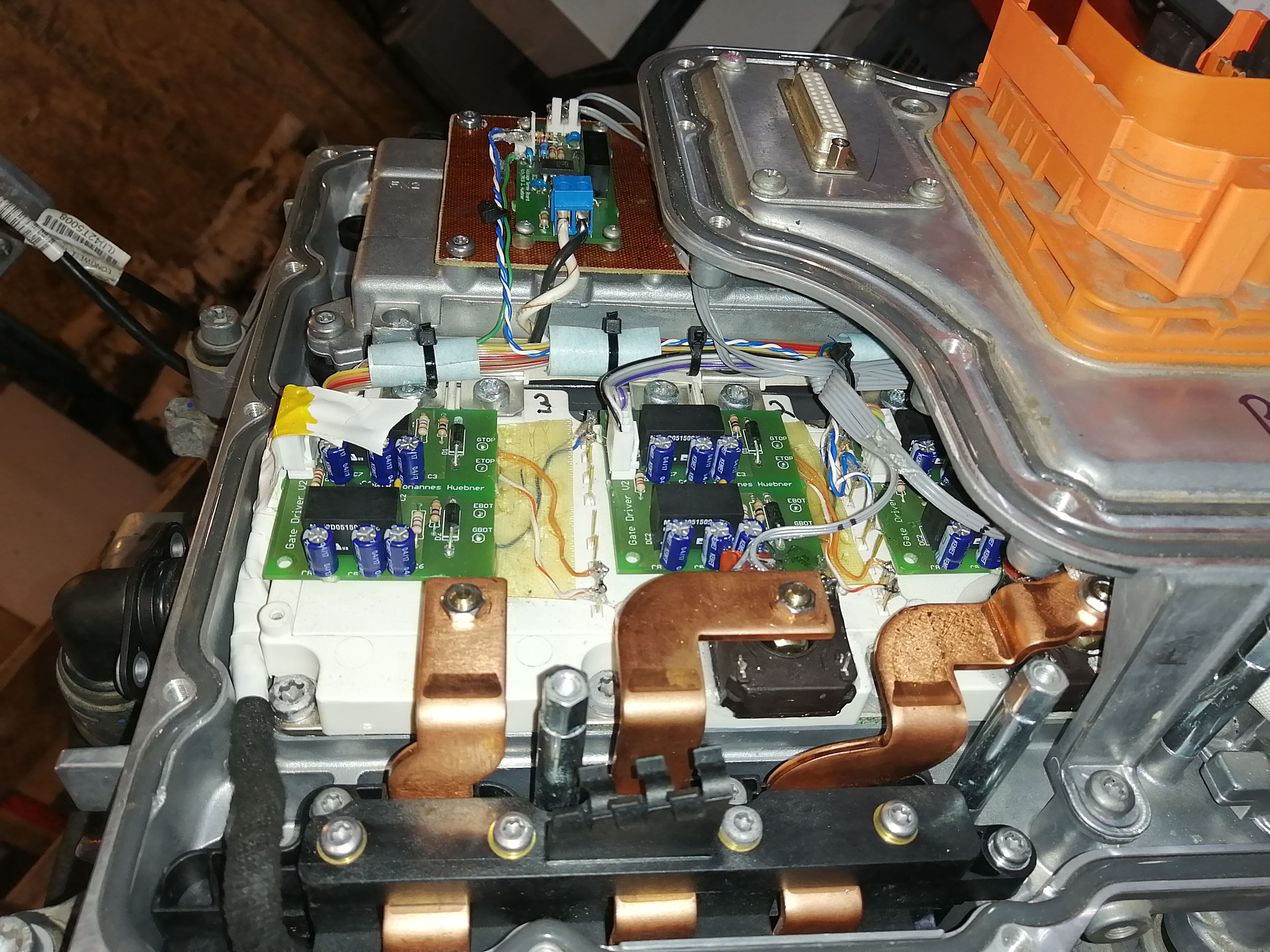

I'm also working on this inverter but I took a different way, I used the original LEM current sensor, get rid of the board and use the gate driver from Johu, might not be the best thing to do, but I tough it would be easier for me... no need to reverse engineer this board and less time consuming, I will keep reading your updates
BMW I3 Project
viewtopic.php?f=11&t=736&sid=002463d39c ... 3ad7740f1f

Yes that will also work but of course the OEM drivers offer some more protection. They can also be connected to the PWM outputs as is, the only challenge is the 32V supply voltage.
Only temp and bus voltage measurement are more difficult to interface but you can just use the voltage sense board included with the kit to overcome that.

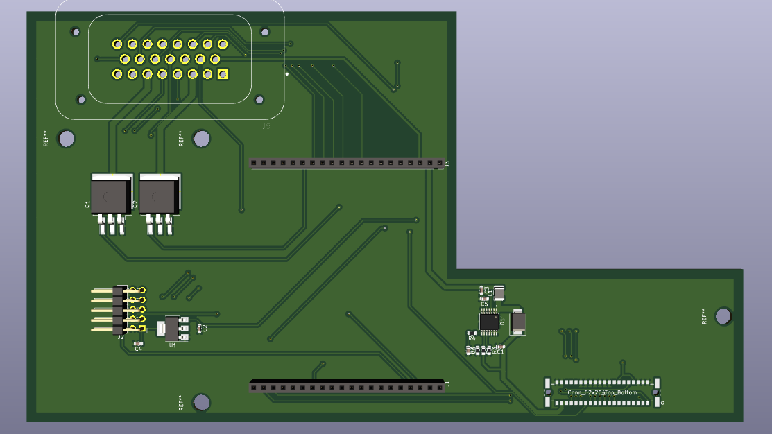

First cut done
Will send it out to almighty JLC tomorrow probably.
I use a 23-pin ampseal with reduced IO-set that is assigned similar to the B-class (SDU) ampseal

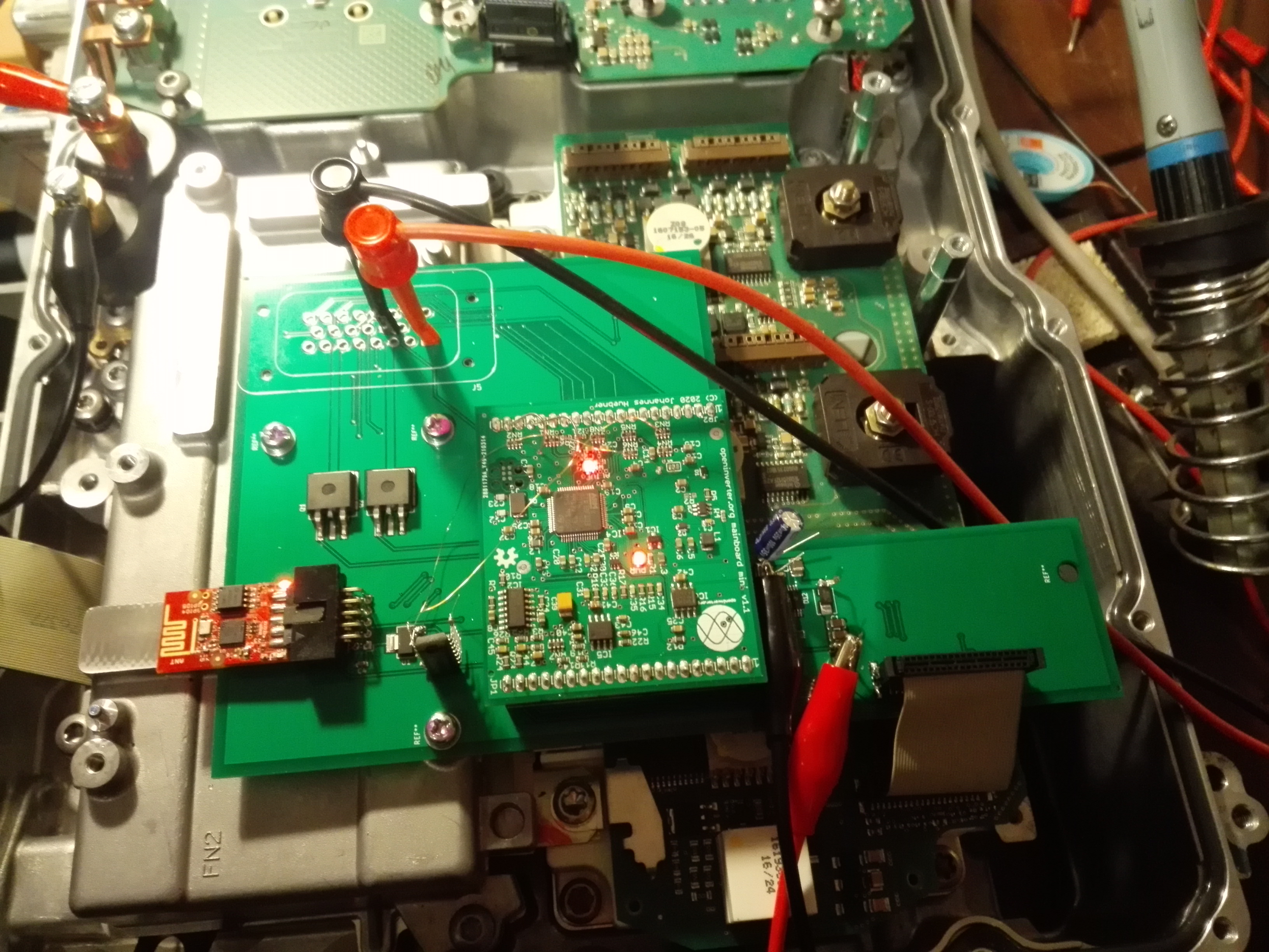

Mail from JLCPCB today
The board "in general" is working but has a few design flaws.
- The 32V boost converter overheats and cuts back seconds after the PWM becomes active. It will need more cooling and lower switching frequency. 1 Mhz is too much. That also means larger inductor.
- The communication between ESP and STM is disturbed and I cannot refresh the parameters once the PWM is running. Will need better routing and perhaps some low pass filtering.
- SPI is not working because there is a voltage divider before the digital isolator. WTF? Anyway, seems my test board with LD1117 had like 0.07V higher 3V3 level and just made it, the mini mainboard with just 3.27V doesn't make it. Will need to add a buffer. On the pic you see one from my 74 collection.
