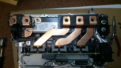

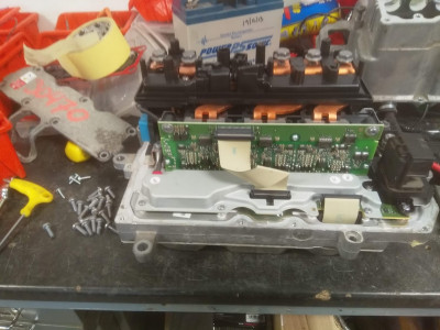

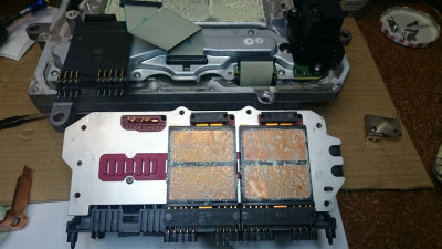

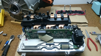

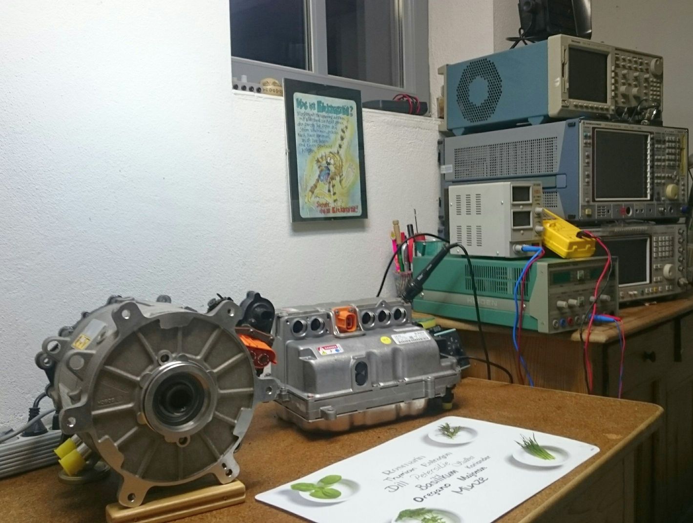

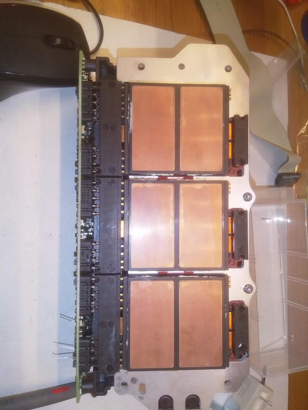

Hello openinverter-enthusiasts,
I have the eGolf Inverter on my workbench ;)
    OEM-No.: 5QE907070 / 5QE.907.070.A
      Vendor: Bosch INVCON 2.3
        Rated @85kWp
        I’m still in a very early test-phase together with a
        Bosch SMG-180.
          This is a high efficient 12Pole PMS Motor in an IPM style.
            29,2 kg
              conservatively rated @ 80kWp mech
                max. 12.500rpm
                  max. 400Arms
                    Motor-Feedback is a 6-speed high precision Multi Coil Resolver from Tyco Electronics (customized for Bosch only)
                    So what’s inside the Inverter ?
                      Three halfbridge IGBT’s from Bosch, 600A rated, Type: MH6560C
                        Datasheet: https://www.datasheets360.com/pdf/8193944722297093682
                          A DC-BUS_Cap from Epcos.
                            A 2,5kW DC/DC
                            etc.
                            I’ve made some pictures.
                            Regards
                            Michael

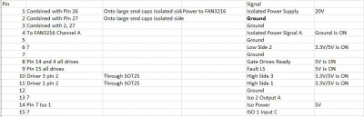

                            Luckily some clever guy took good notes. ;) its is now a year a go I worked on this. Got this inverter from Zero-EV, however we decided it was no commercial use/did not fit projects we had so I stopped working on it on the side.
                            Currently the Isolated feedbacks and temperatures are unknown and the current ratios, but all pins for the current sensors identified.

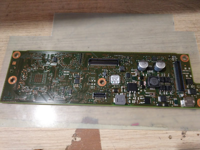

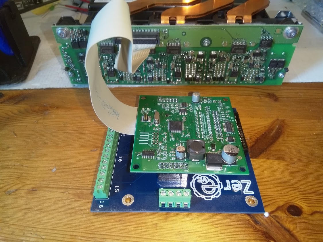

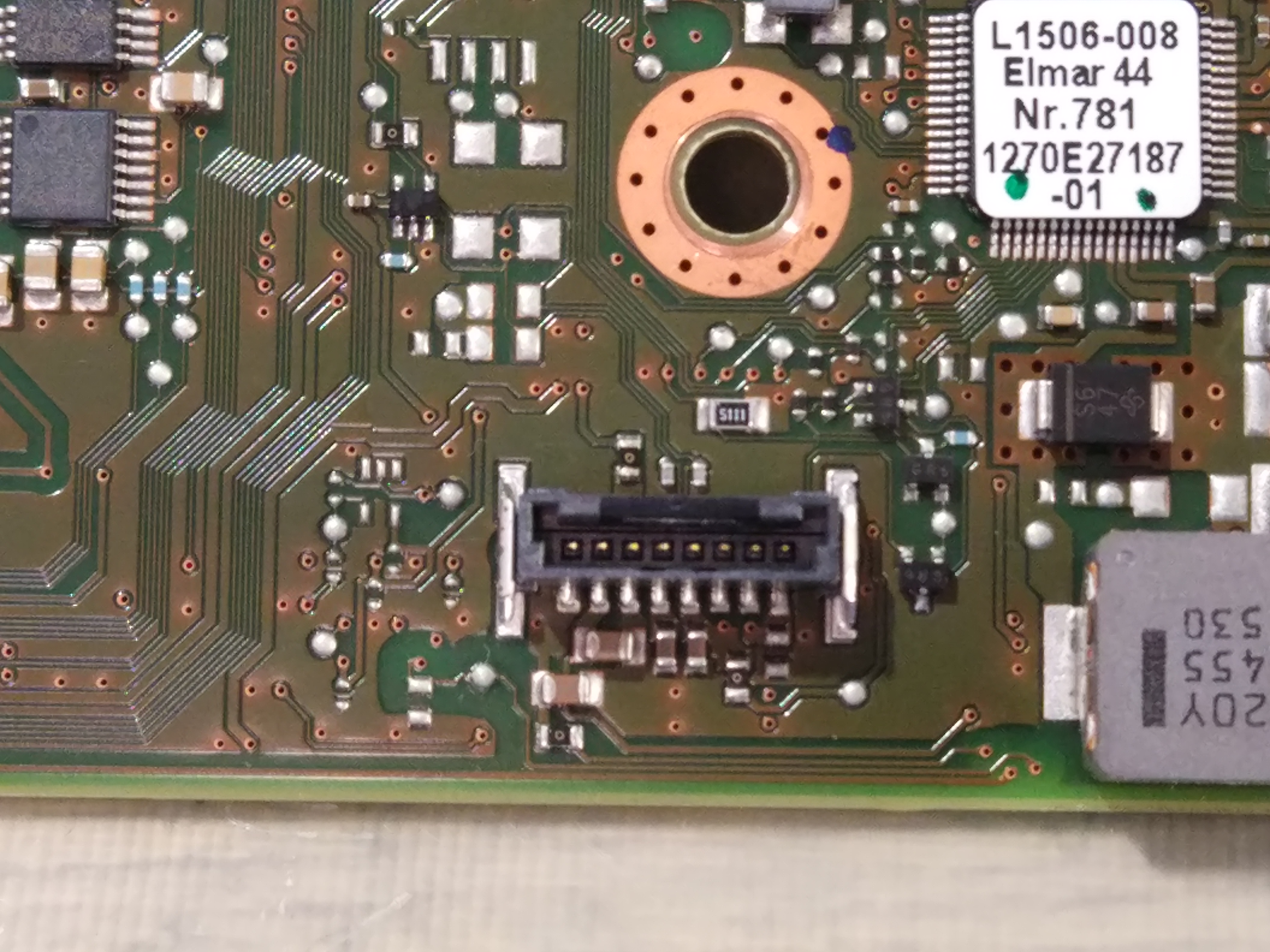

                            I manage to get one VW inverter here. Its so small!
                            I managed to open it up and i see the brain board gets its signals from the big connector on the side. So your idea was to replace its brain with your own master board. I would ask three questions, though i dont mean to imply the fairytale...
                            First question Tom91; why does it need isolated power supply?
                            Next question; Is there only one isolated supply or more required?
                            Third question; did you figure also the pinout on how to start the DCDC 12V converter? Any info on its connector pins? I see it is also ERNI 1.27mm 8P connector no. 284699.
                            So my plan is to build my interface board and try to use gen2 controler to drive a motor first with 60Vdc. Then i will try to make DCDC obey.
                            A

                            arber333 wrote: Wed Apr 15, 2020 5:57 pm I manage to get one VW inverter here. Its so small!
                            That inverter looks different then the one i had.
                            No it does not, it is the supply to the optos and isolators. Check the schematics.
                            No isolated supply, just 5V as far as i know and then a supply in of 20V (atleast that worked for me.
                            It is painful to get working right i remember that much. It takes 12-20V then creates the isolated supply from that.
                            No idea on the DCDC.
                            I would say there is quite some figuring out left to do, I should have disassembled the whole inverter and powered it on to try and intercept the signals to the power stages to check my findings.

                            tom91 wrote: Wed Apr 15, 2020 7:11 pm I would say there is quite some figuring out left to do, I should have disassembled the whole inverter and powered it on to try and intercept the signals to the power stages to check my findings.
                            I think i will do the same and trace the outputs vs your results. Hopefully they used the same layout.
                            I have here 50Vdc battery and also one 10A power supply that can supply enough current to turn my small ACIM motor.
                            It seems that it would be better to abandon the side connector and make a new cover from the front in which to mount a new board. Space is tight...
                            Do you have some photos of that inverter board? Maybe i can catch some similarities.

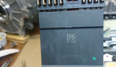

                            VW GTE test setup, dont mind the mumbling idioot.
                            So to get the isolation side to work you need to generate a 12-20V supply and then a pwm signal to start generating some voltage. there is a feedback output to indicate the isolated side has power.
                            Pictures of the brick i have and done the testing on, now its just down to getting it working really. Designed the PCB so I can use the Johannes brain to drive the IGBTS while the other signals and unkowns are on the screw terminals.

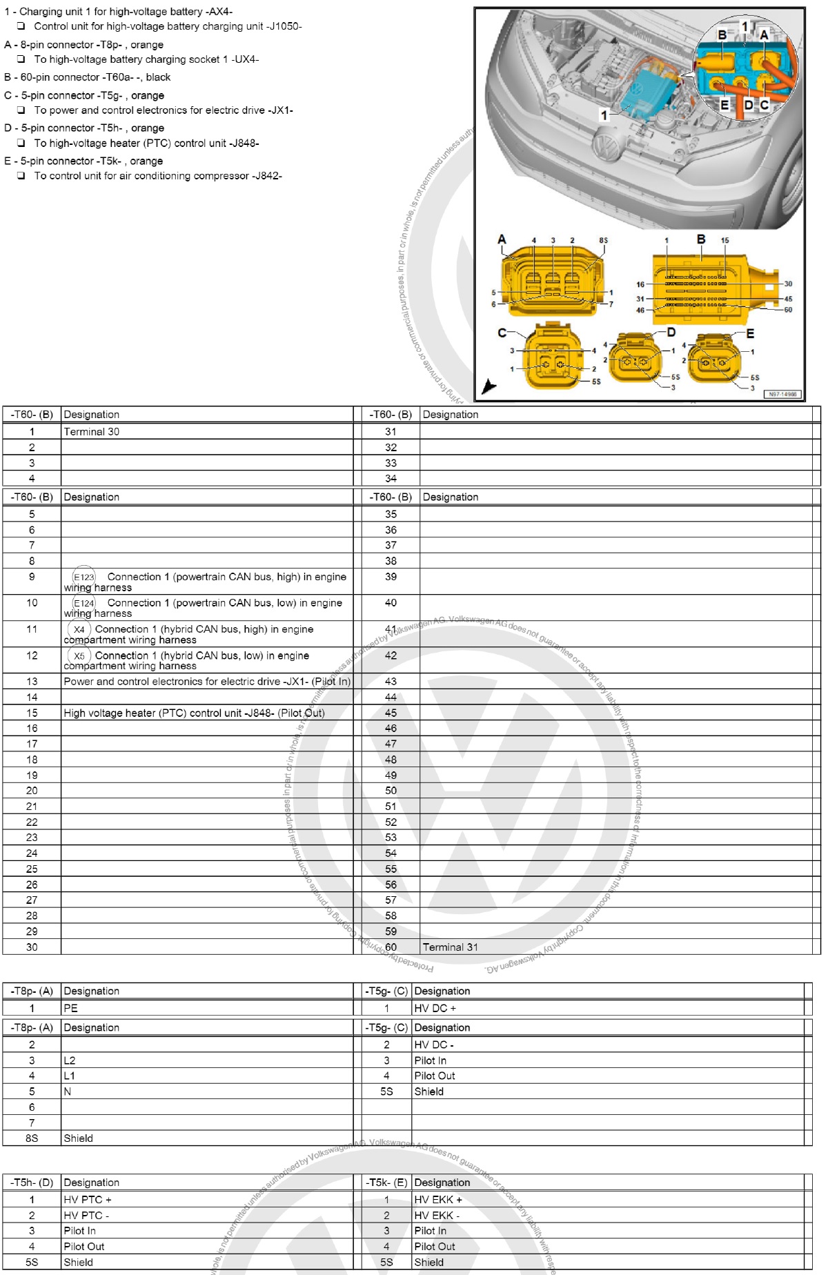

                            Anyone has any info on VW inverter and charger wiring from Golf GTE? HV and LV connector pinout would be appreciated.
                            I have them sitting here not doing their thing and that frustrates me :).

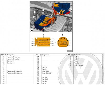

                            golfdubcrazy
                            Posts: 88
                            Been thanked: 11 times
                            Re: VW eGolf hardware
                            Post by golfdubcrazy »
                            Hope this helps.
                            Posts: 3796
                            Been thanked: 413 times
                            golfdubcrazy wrote: Tue Mar 30, 2021 10:10 pm Hope this helps.
                            Wicked! Thanks. I will try it from here then. Should be getting some CAN msg from charger.

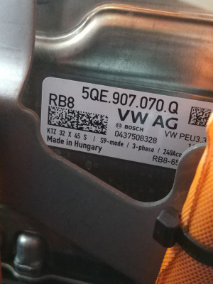

                            I just picked up one of these inverters.
                            I think (on a Google image search based hunch) that it could be the same as the PIM in a fiat 500e.
