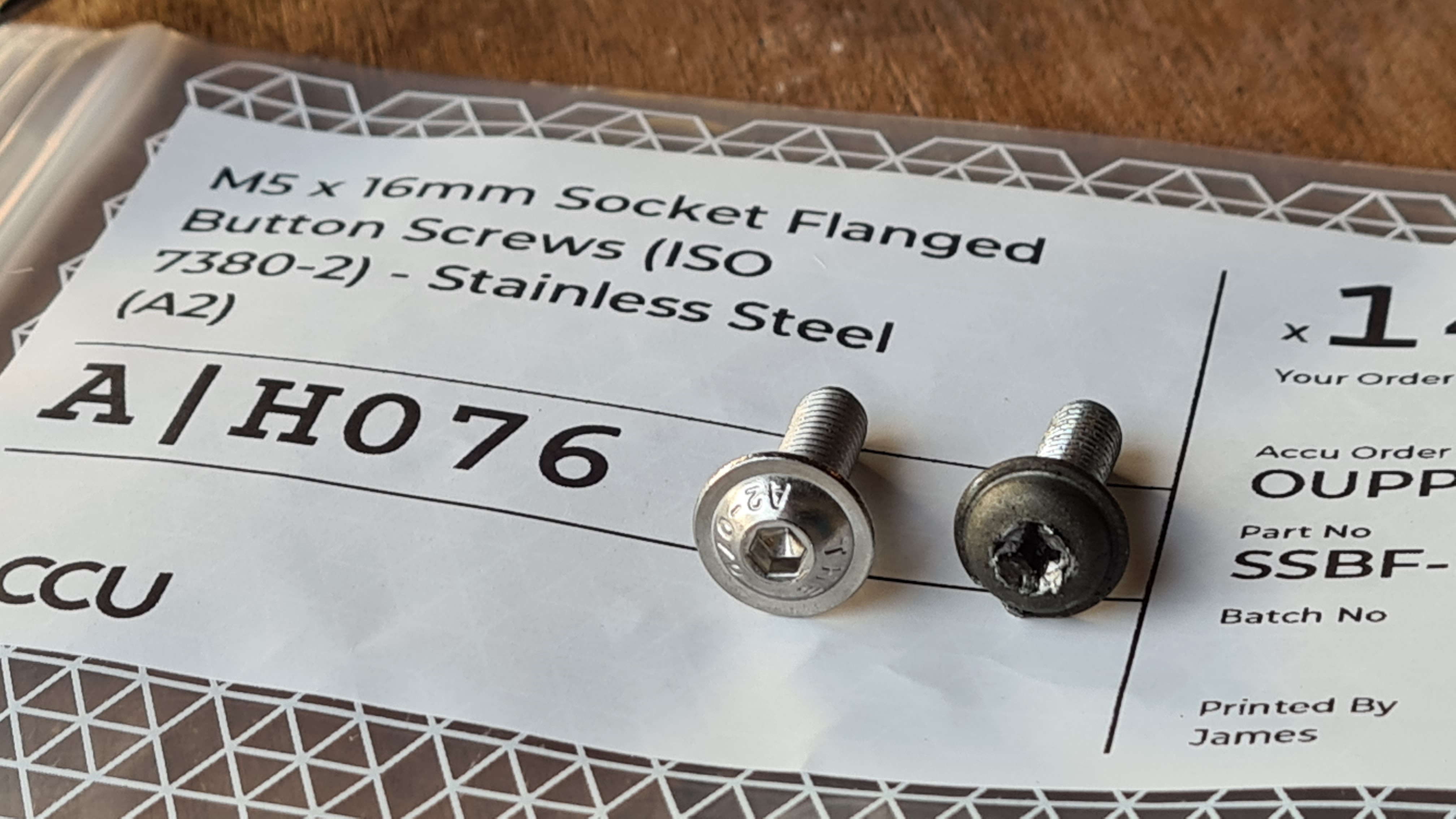

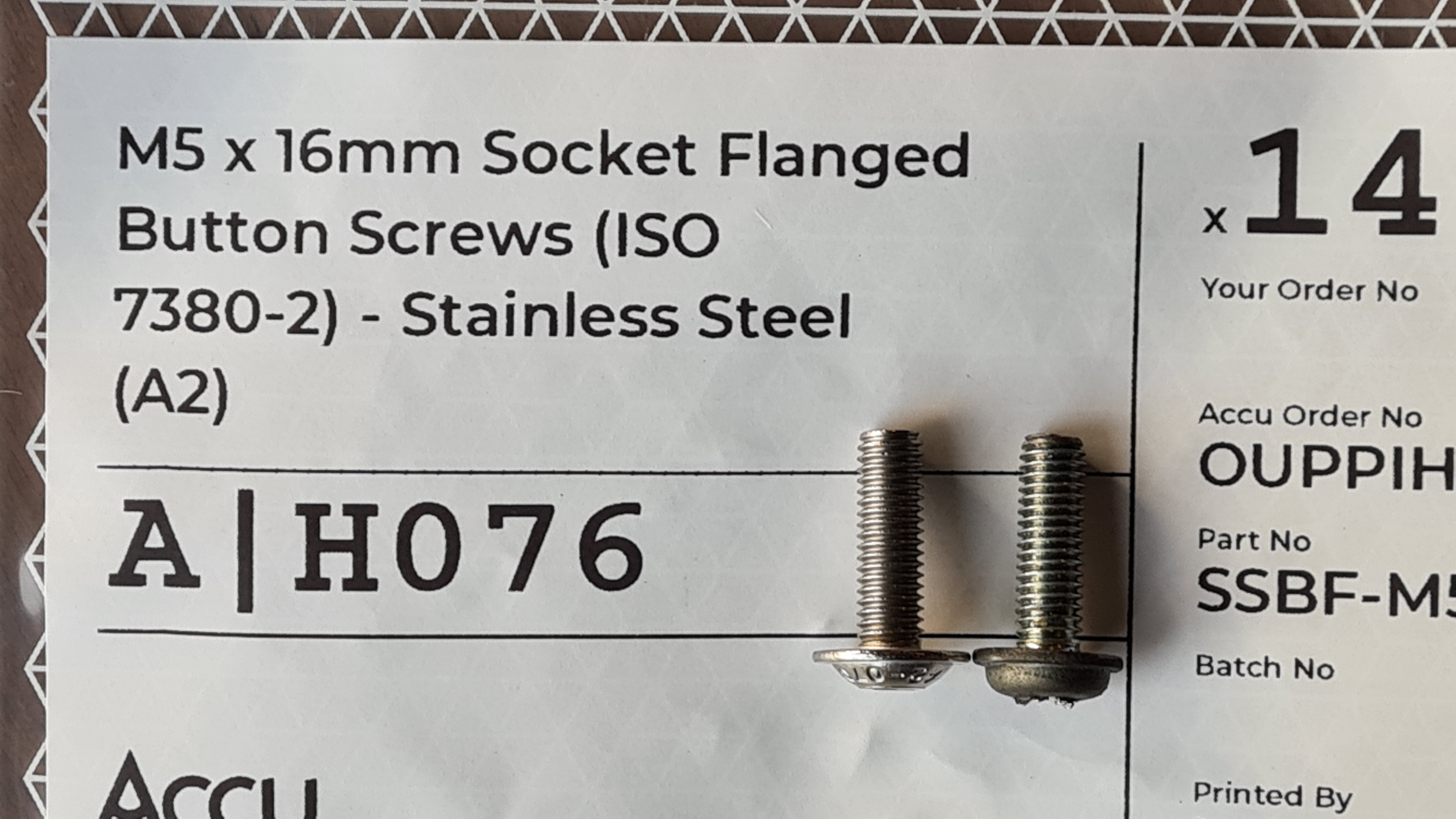

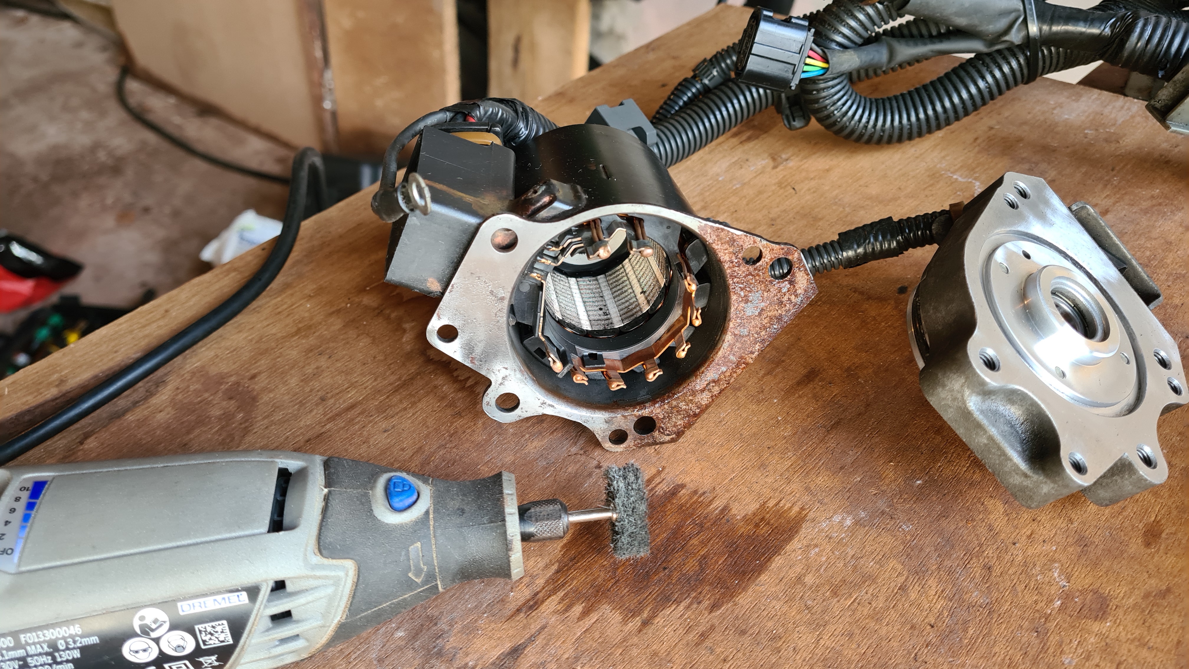

Bought some screws to replace the ones I accidentally stripped trying to disassemble the oil pump.
(new one on left, old one on the right) Then whilst the oil pump was apart I cleaned up most of the rust (not sure why it was rusty, left in a junkyard in Romania for a few years perhaps) Next I replaced the second bearing (on the rotor) which I believe to be 608-2Z.
I looked into making a puller plate like SciroccoEV suggested but sadly I just don't have the kit to make one. Instead tried to use flat screwdriver and lever against the rotor. It worked but time will tell whether I've done any damage! Just need to replace the rubber O rings now (think it's a 55 mm internal diameter ring between the stator case and first plate, then two 50mm O rings between each of the other plates).

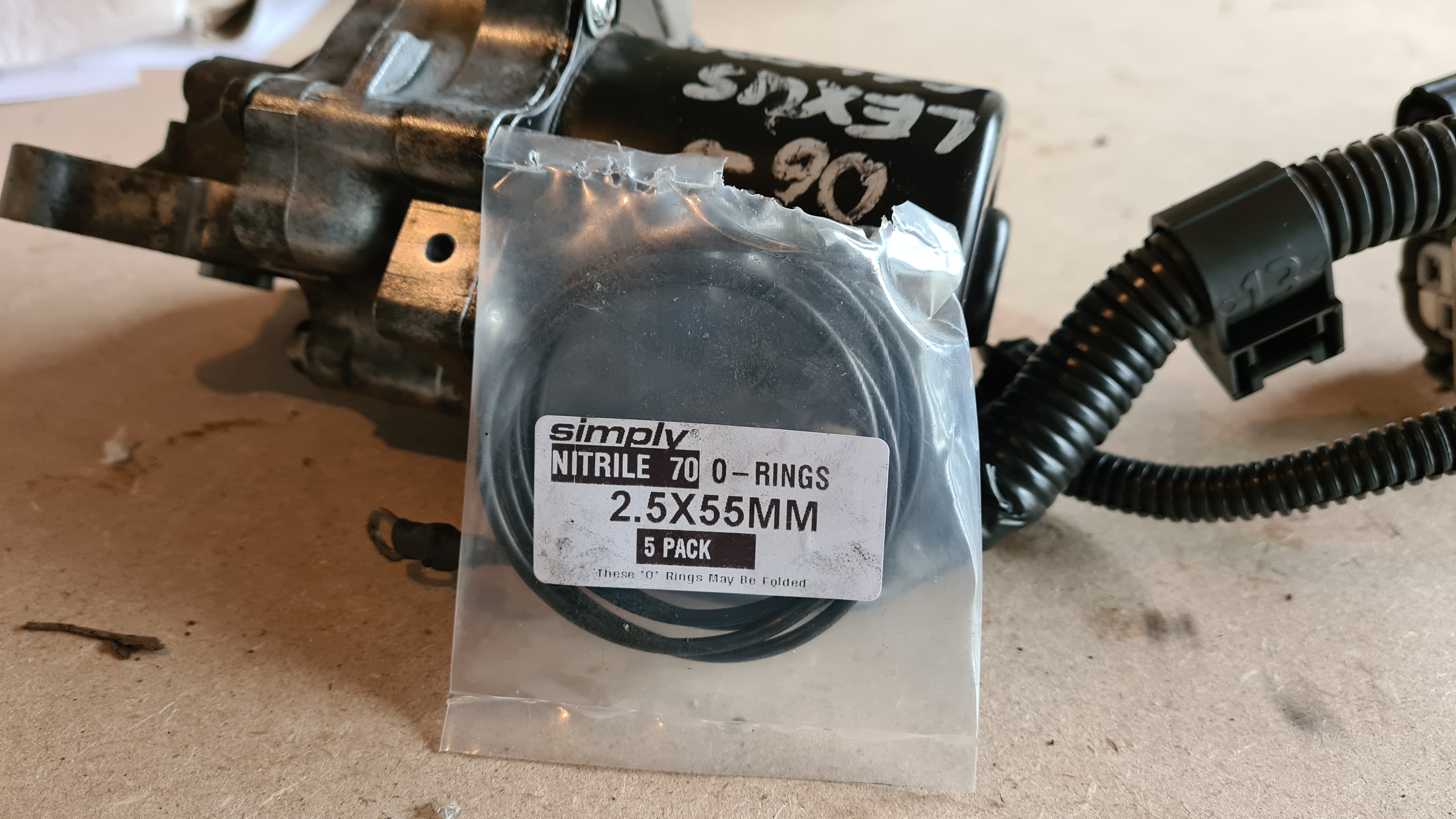

Have replaced all the o rings in the oil pump as they were corroded.
For others who are refurbishing this oil pump (part no. 56010-HRA030) if you need new o-rings you'll need are:
1 x 55mm int. diameter, 2.5mm cross section (For the black outer case).
2 x 50mm int. diameter, 2.5mm cross section (For between the two "layers")

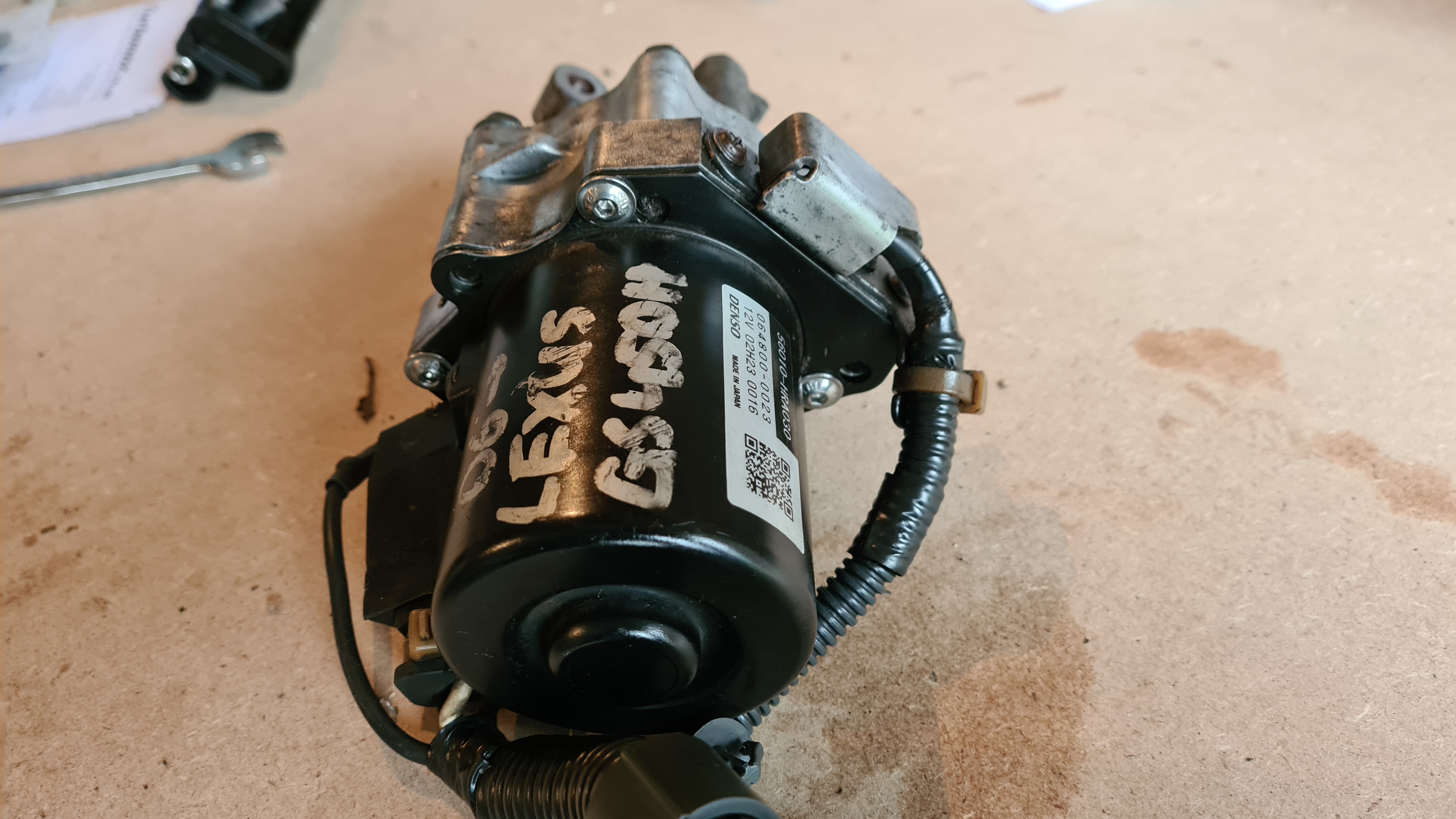

M8 35mm bolts arrived so I've fitted the refurbished oil pump.
(Next job is to test the pump runs ok before I continue.)

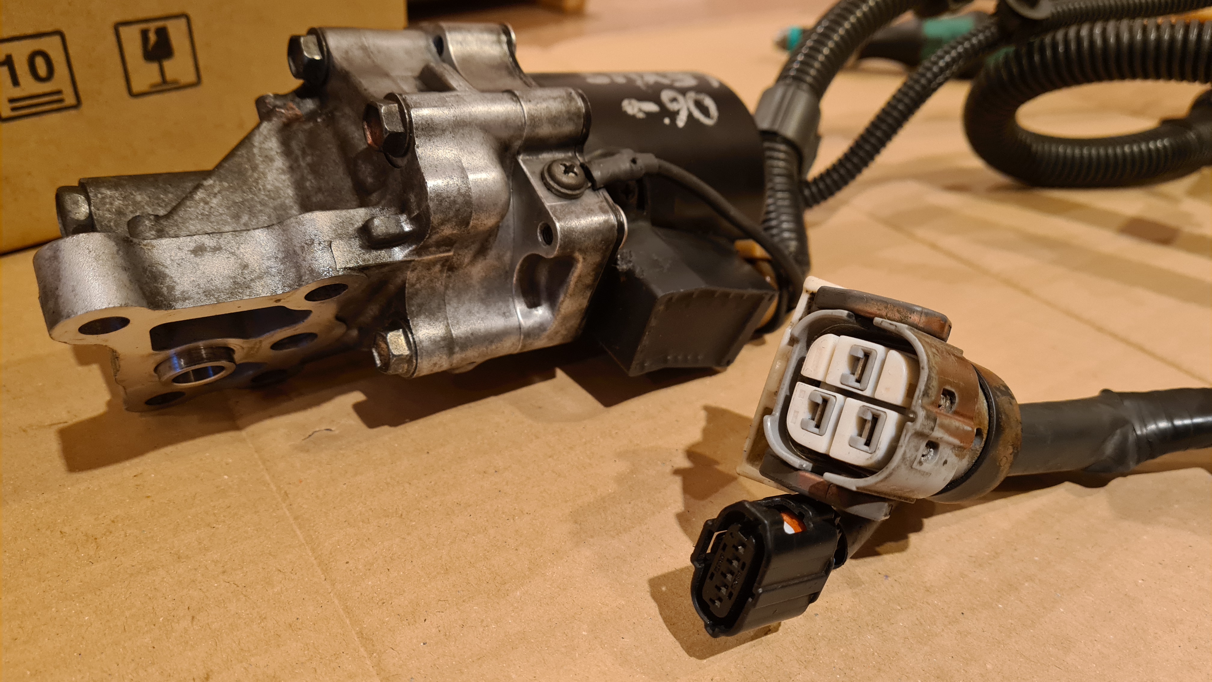

I'm having trouble understanding the wiring for the GS450H transmission oil pump that's on the wiki.
Could anyone tell me how to test that my oil pump is still working.
I'm assuming it's 12v applied... but don't know where to hook up the + and - wires....
Can anyone help?
Can anyone help?
Re: Reliant Scimitar SE5 (1971) with Lexus transmission
Never mind! Electric_SLK explained it all to me!
Seems obvious now: the oil pump motor is three phase, hence the three pins in the white connector! I need the oil pump controller (and he suggested that the controller needs to share the same ground as the 12V supply). Next stop, ebay and some lexus breakers yards!

I am aware that Phillips and Pozidrive drivers look different.... but admittedly I have no real idea of the difference otherwise... I have both sets of drivers and just try the one that fits best! Is it likely that the screws on Lexus parts are all Pozidrive? I did speak to another converter who said he had the exact same problem, so it might only partly be my fault that I stripped them.

Are you sure the screws aren't JIS - Japanese Industrial System?
JIS predates ISO Metric. People used to complain all the time about the crappy screws on Japanese motorcycle engines, but with a set of JIS impact bits and an inpact driver, I never had a problem with them.
Pozidrive screws have parallel sides to the driving surfaces whereas the Phillips have a taper which causes a resultant force pushing the driver out of the socket. Pozidrive have a triangular web between the driving surfaces and a star shaped pattern on the sockets.

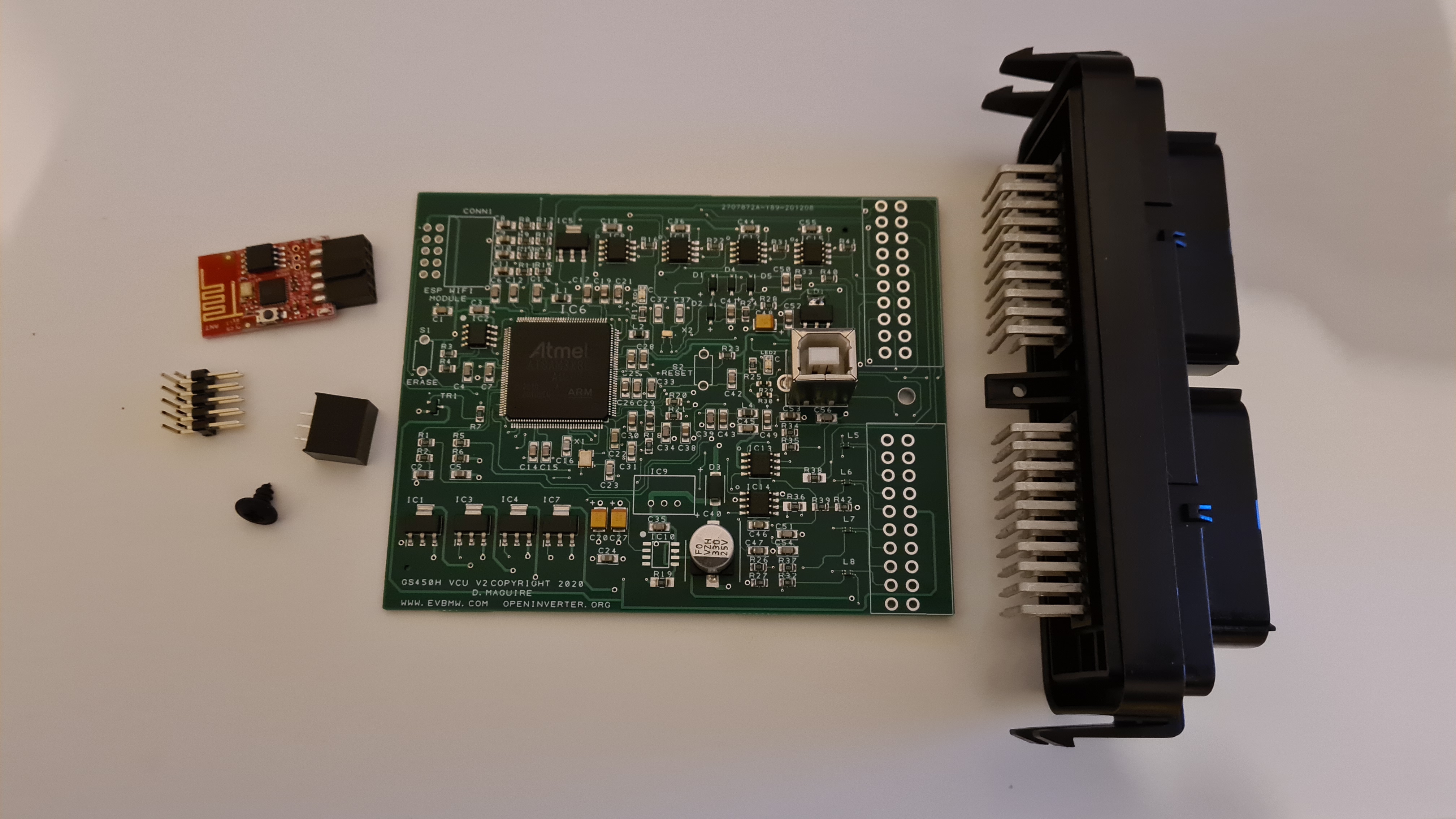

Anyway, today I found a good deal on a really well refurbished chassis for the Scimitar, so once lockdown has eased I'll arrange the collection. (The parts of my current chassis are either rust or have long ago crumbled away to nothing, so it was well worth the investment)
And a parcel arrived today with the EVBMW.com VCU for my Lexus inverter, whoop!

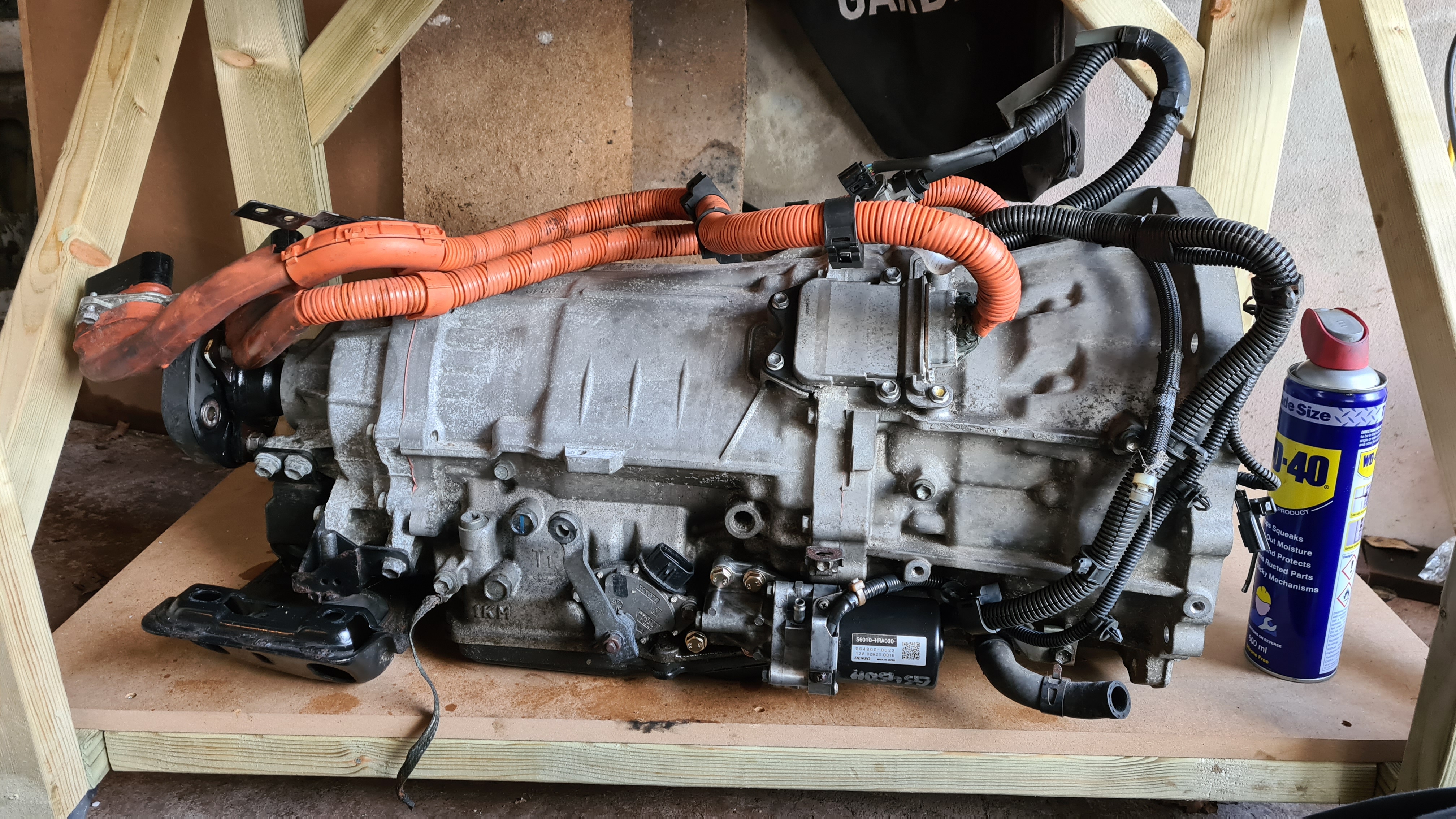

The Lexus transmission had a lot of oxidisation on it so I decided to clean it up with lots of Autosol and my Dremel before it's mounted in the car.
(Broke the Dremel somehow and took it apart to see if I could fix it but I think it was a broken wire right inside the windings so I gave in and bought a new one).
Probably totally unnecessary but quite therapeutic!

Right, next job: As per the Lexus transmission wiki, i can't find the connector for the inverter (coming from the ECU - part no. 90980-12630 i think) so I'll have to rewire the inverter with a pair of new matching connectors.
Can anyone give me any tips on how to rewire the new connector? Presumably you need to completely open up the inverter?
PS i looked and looked hoping that i could find the missing connector online somewhere if I looked hard enough but no joy.

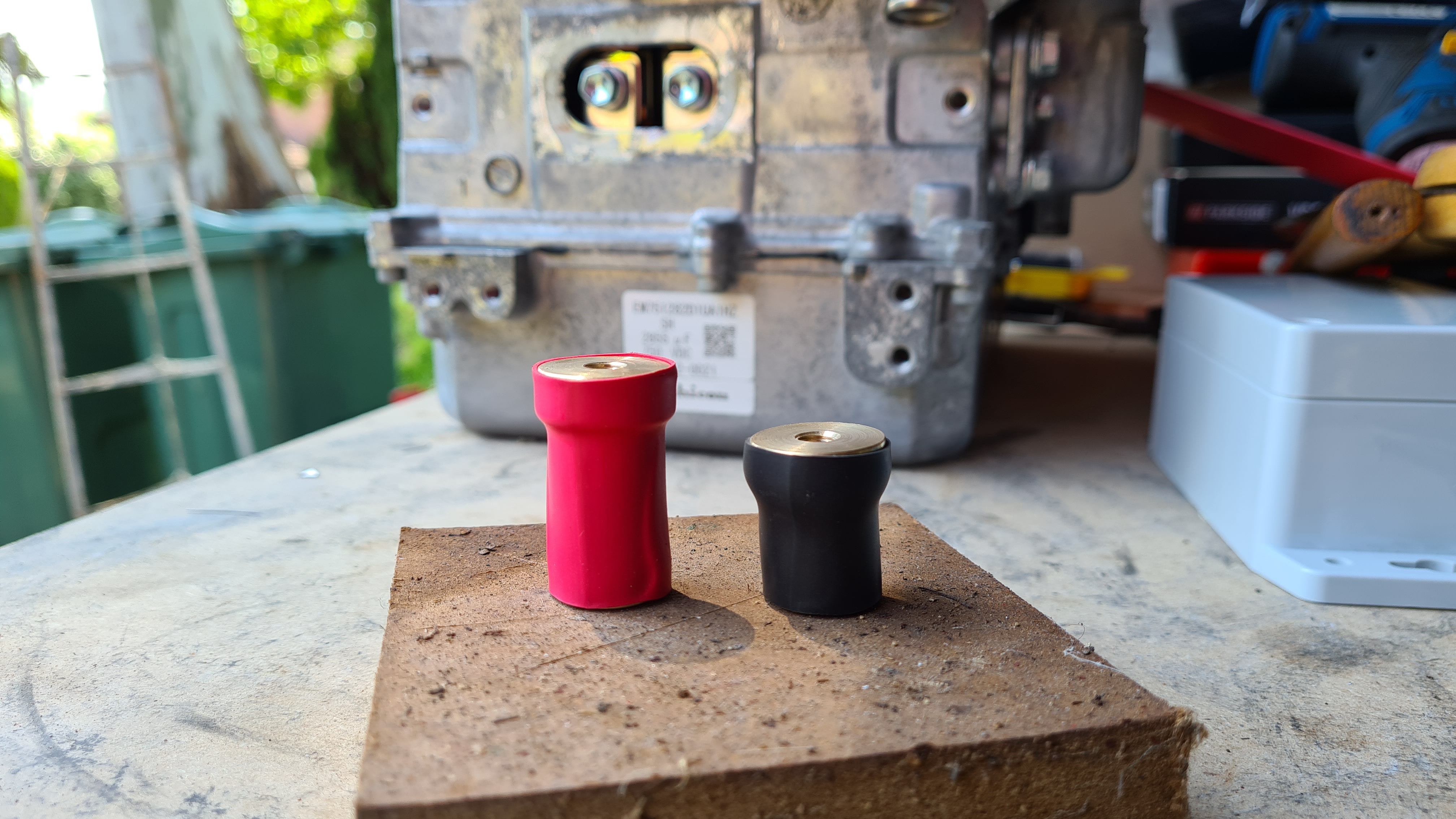

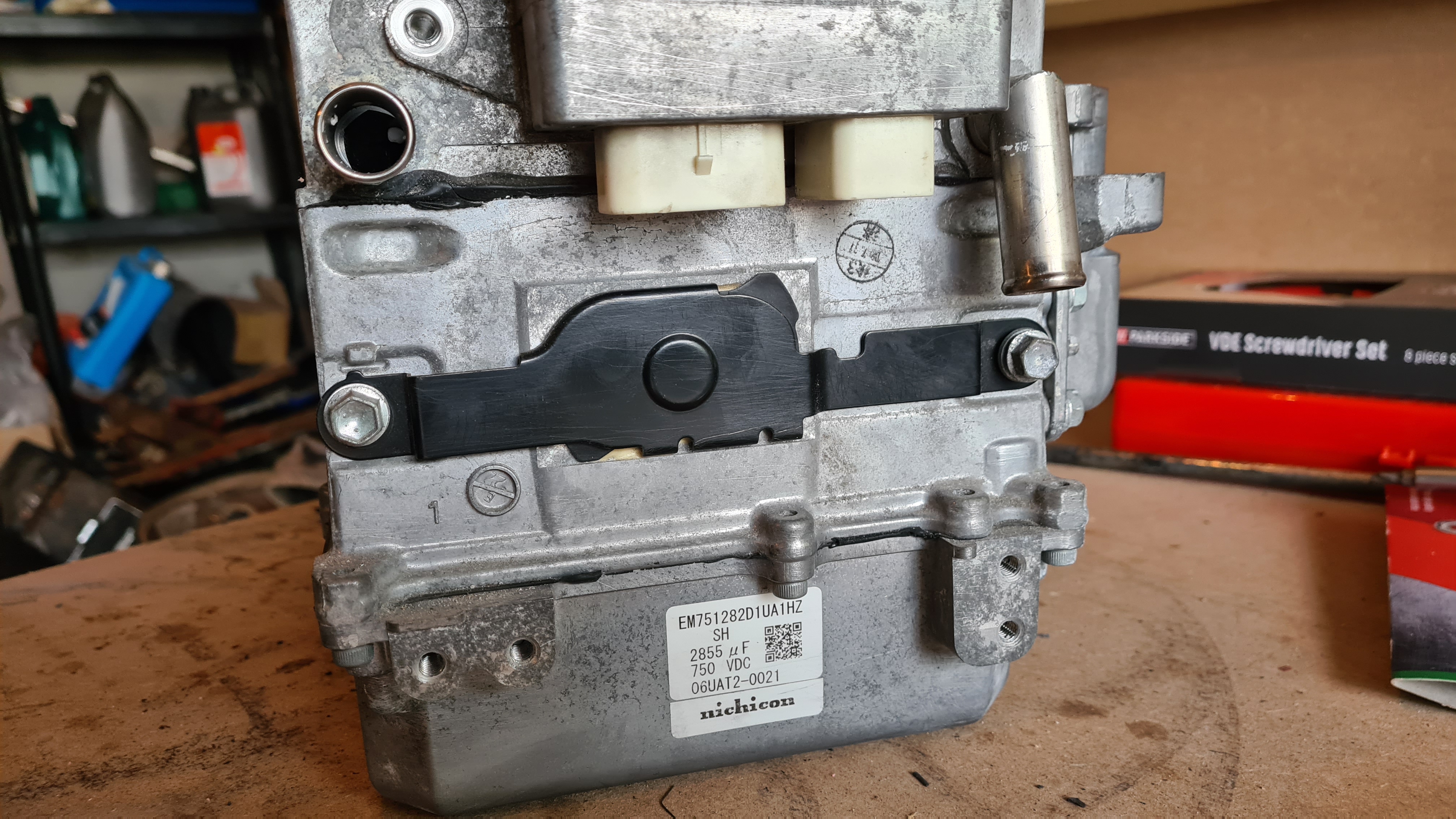

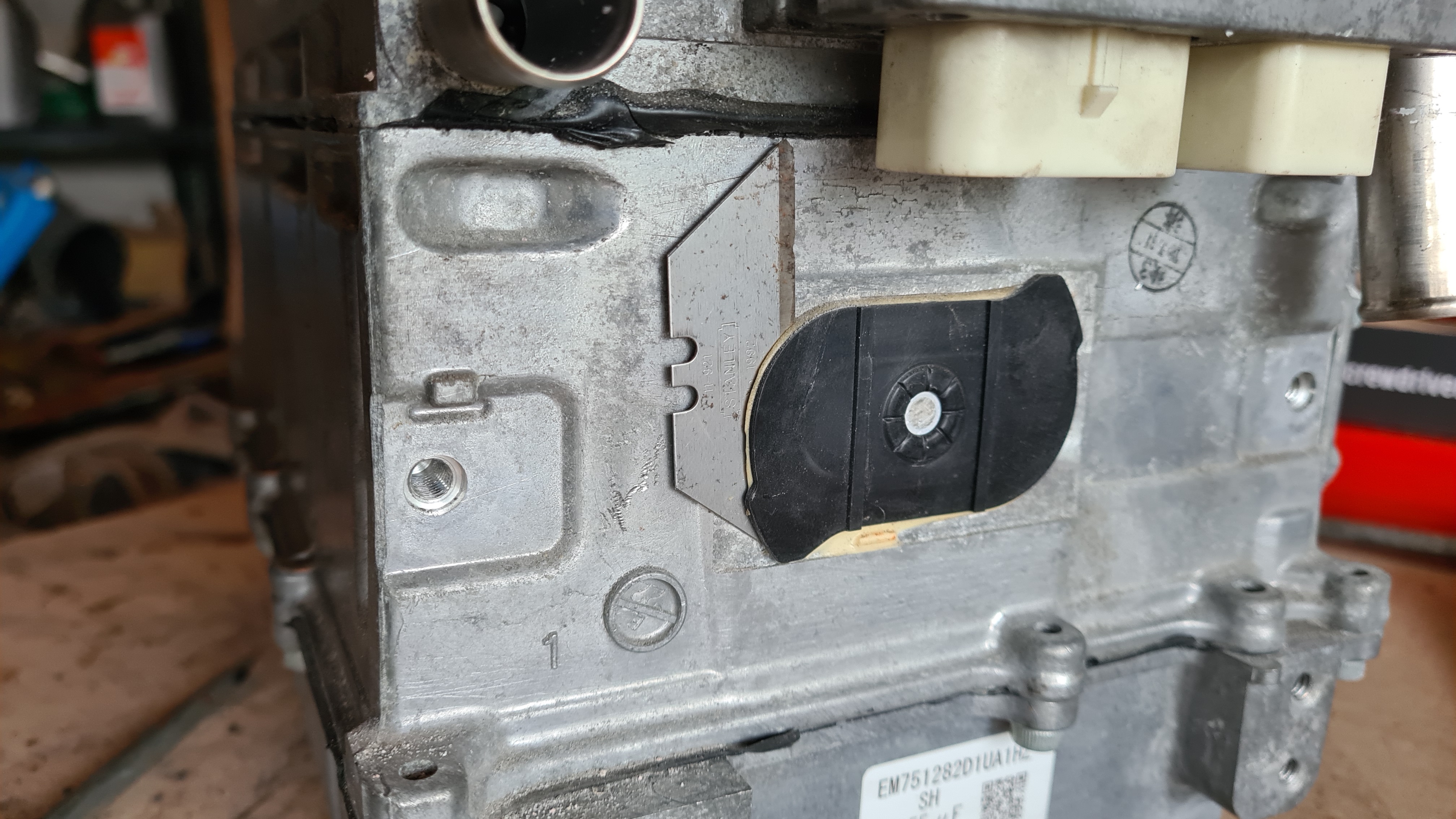

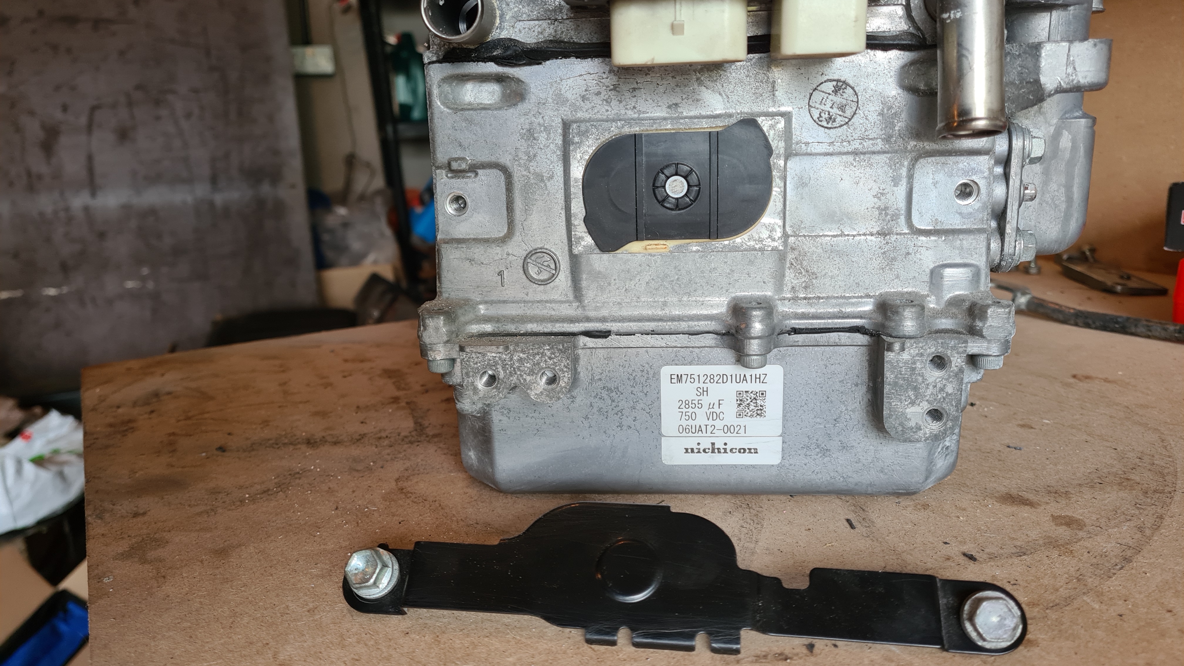

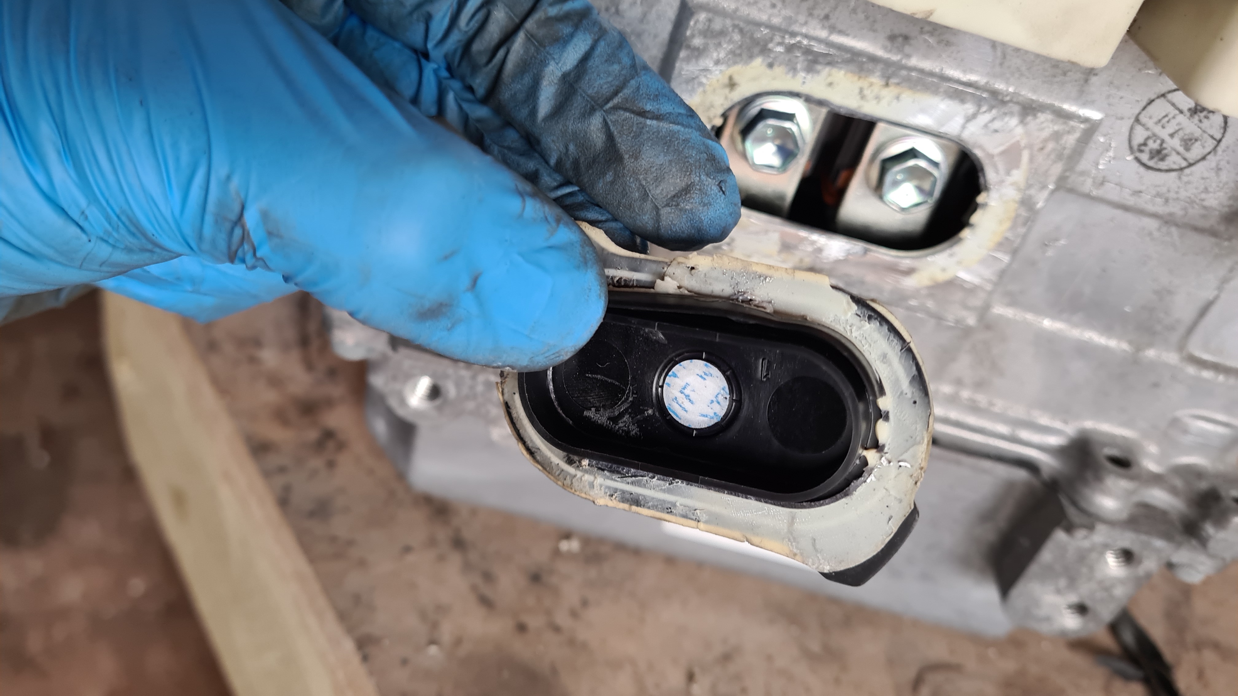

Bit of a stall in progress but trying to get back to my conversion project.
Made a mess of opening up the buck/boost converter part of the inverter, to allow access to HV terminals, but it'll do... Then spoke to some of the other guys from the New Electric conversion course and took their advice on how to create HV terminal stand-offs for my Lexus GS450H inverter, and added in some of Damien Maguires terminal design features too.
Then found this guy on eBay who made me a pair of brass terminals for £23...
https://www.ebay.co.uk/itm/324625667283
They are M6 threaded brass standoffs, one 25mm long as per the picture and the other is 35mm long.
(I'm assuming the different lengths of Damien's design is a safety feature in case either terminal becomes loose and spins to create a short)
I've used some 25mm heat shrink (red/black) for safety and identification...
Tried to find nickel-plated brass M6 bolts but the best I could find was 200 of them for £70! Was suggested to me that nickel plated brass would improve conductivity, but I can't justify the expense really, so I've ordered some brass ones instead. Hope they'll do the job)
- SciroccoEV
- Posts: 370
- Location: Luton UK
- Been thanked: 16 times
Bolt is for compression, not conduction. Plated steel, or stainless (A4 grade) will do.
