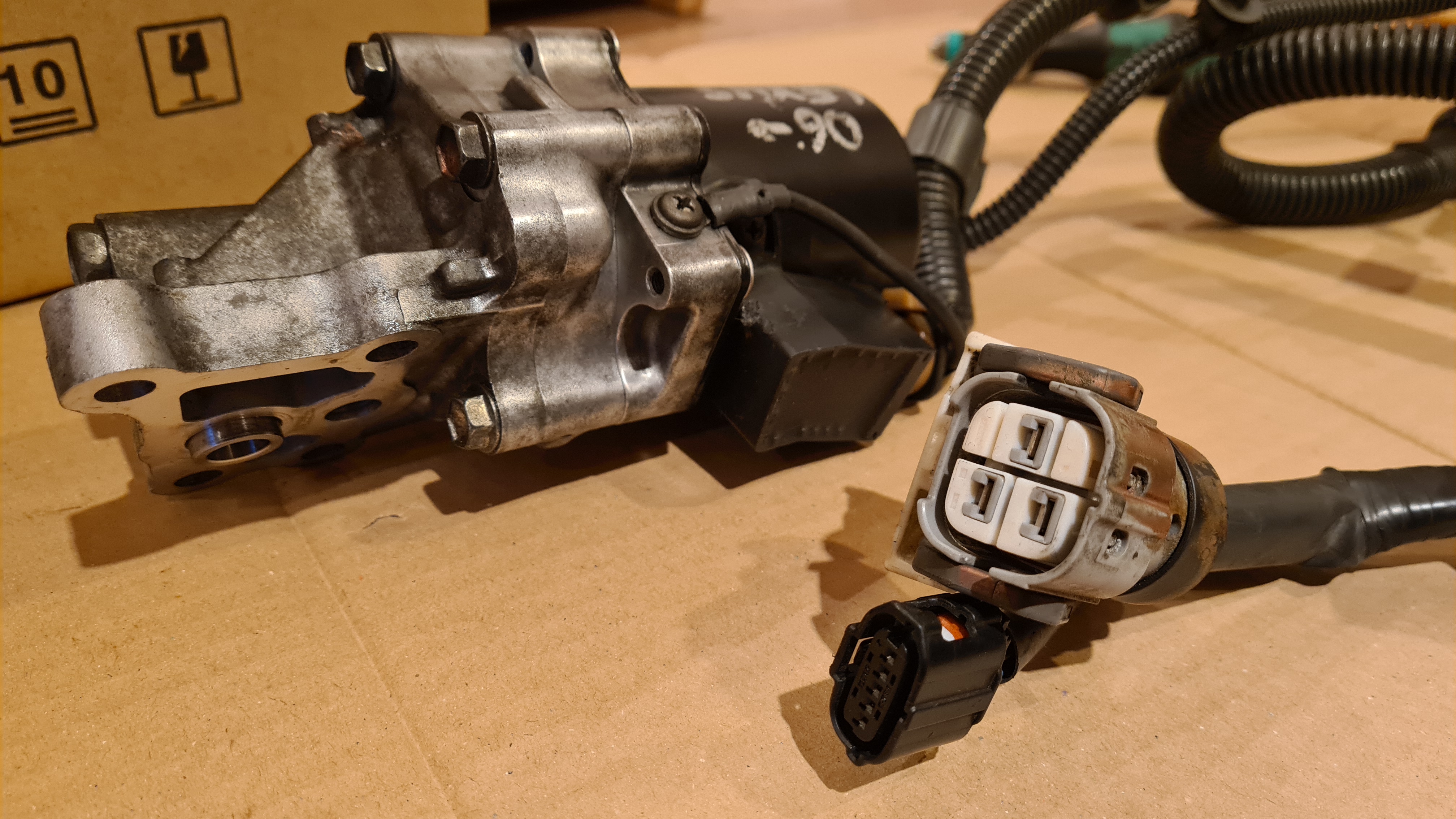

I'm having trouble understanding the wiring for the GS450H transmission oil pump that's on the wiki.
Could anyone tell me how to test that my oil pump is still working.
I'm assuming it's 12v applied... but don't know where to hook up the + and - wires....
Can anyone help?
slanceley
Posts: 44
Joined: Wed Nov 06, 2019 5:13 pm
Has thanked: 6 times
Re: Reliant Scimitar SE5 (1971) with Lexus transmission
Post by slanceley »
Never mind! Electric_SLK explained it all to me!
Seems obvious now: the oil pump motor is three phase, hence the three pins in the white connector! I need the oil pump controller (and he suggested that the controller needs to share the same ground as the 12V supply). Next stop, ebay and some lexus breakers yards!
