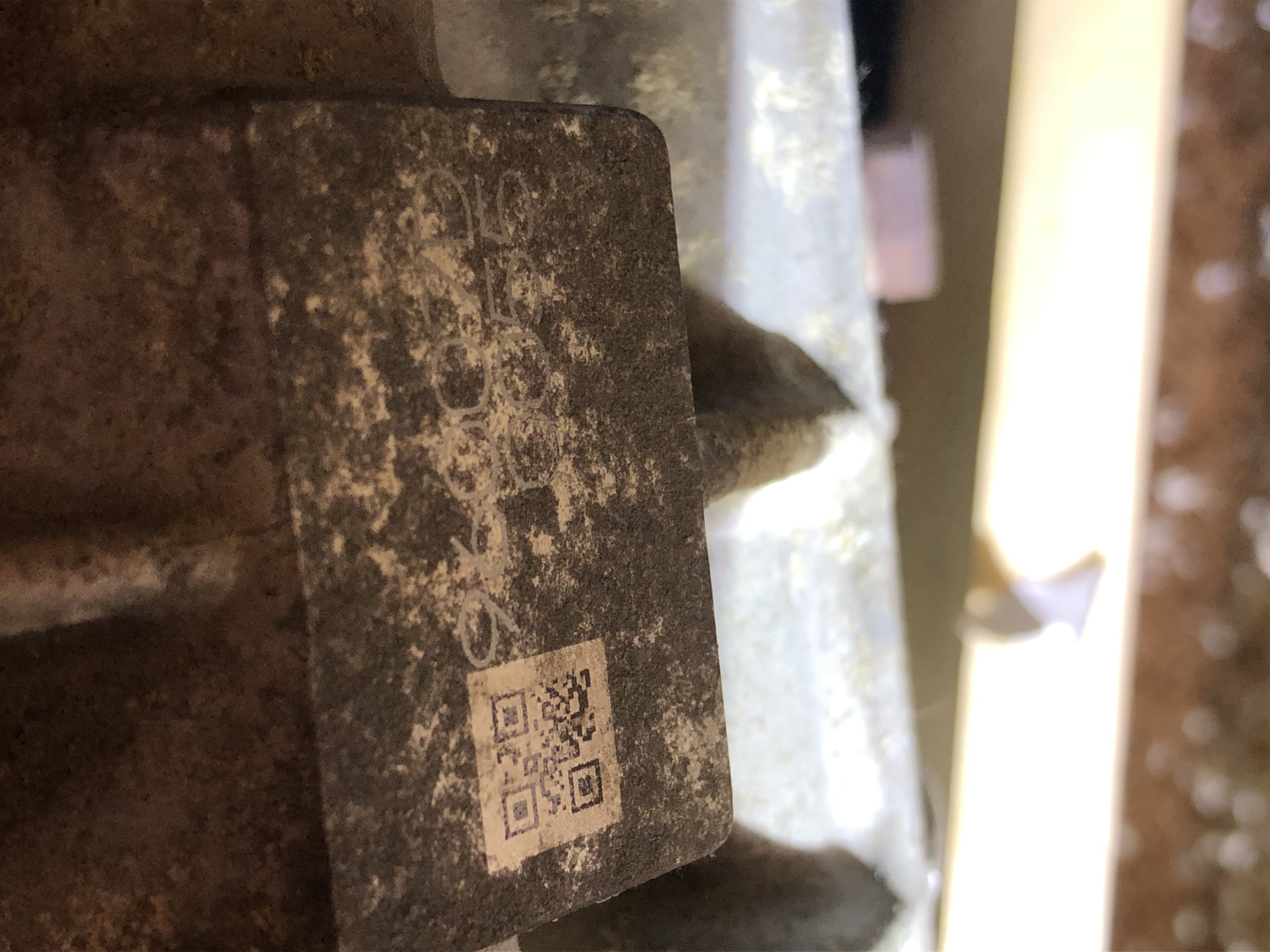

This is my motor. When testing it today with Johannes he found out that its alignment was way more out than on his own motor.
7E001B005A

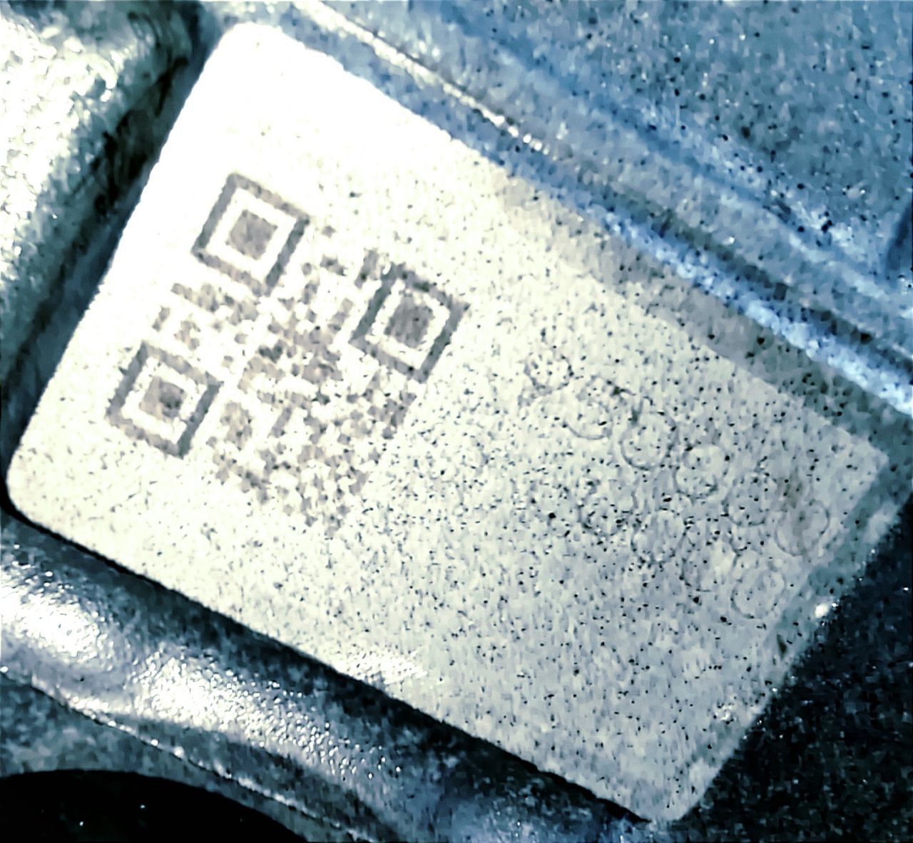

Hello.
I have a Nissan Leaf EM61 engine, the resolver value is 950000 0000
values I set in syncofs 45 000
