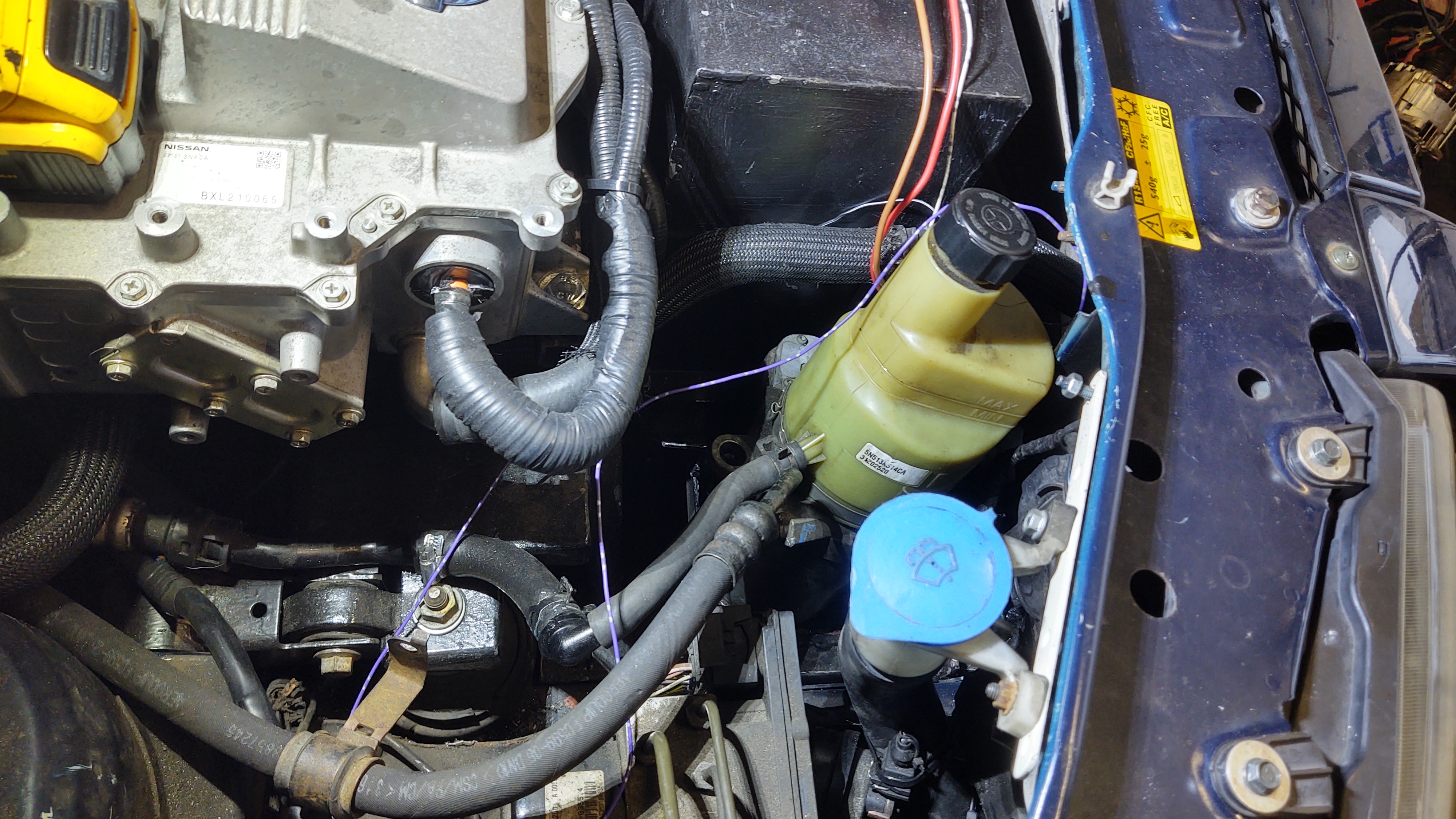

Re: [Driving] Freelander EV With Gen1 Leaf electrics and EVBMW VCU
Big change happening.
The power steering solution I had come up with is not cutting the mustard so is currently being removed. It's a pity after all the work I put into it but when parking it wasn't giving enough assistance and lacked the torque needed when the end stop was reached so sometimes just cut out.
It was OK when first installed but a couple of months ago after completing the build I was charging the main battery and stupidly left the power steering turned on, low so it wasn't spinning but still on. I never figured out why but for some reason the DC motor controller that should have been feeding 7V to the rotor decided instead to pass through the full 40ish Volts. I had no idea this had happened until I noticed a funny smell and after several minutes trying to figure out where the smell was coming from saw smoke coming from under the bonnet.
As you can imagine there was some degree of panic before I figured out what the issue was but by then I think the alty motor had been irreparably damaged and hasn't been quite 100% since and might even be getting worse so now is being replaced.
It's a Volvo electric hydraulic power steering pump that can be controlled by CAN but works fine with only 12V.
I've tested it and it seems to be great so I'm going ahead and doing the swap.

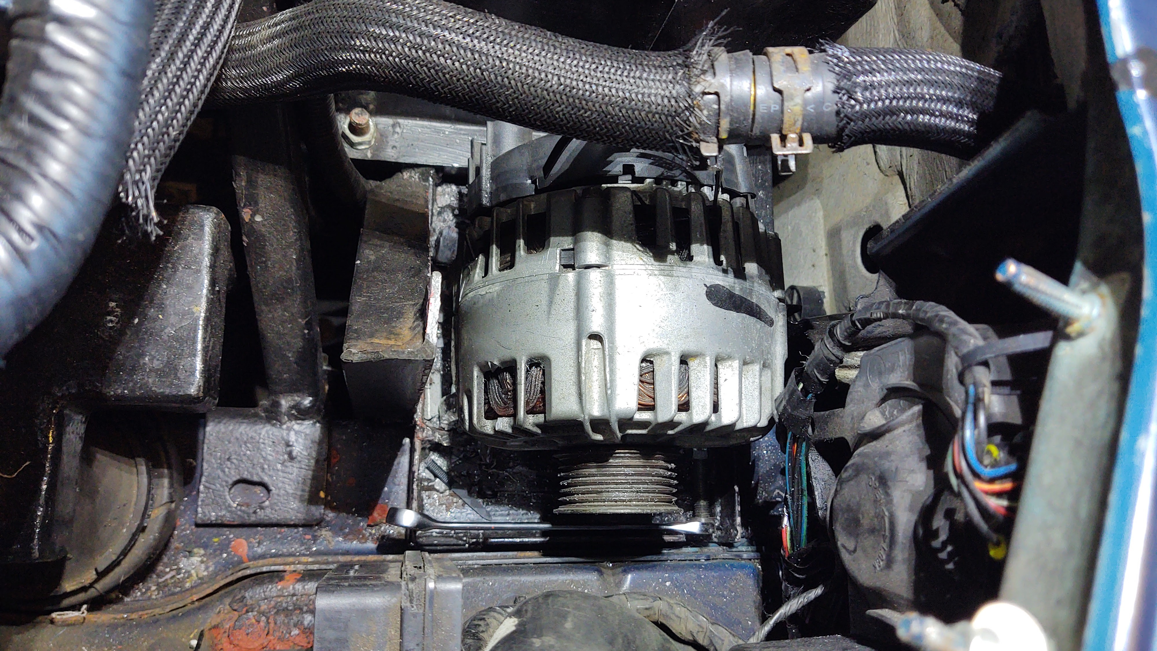

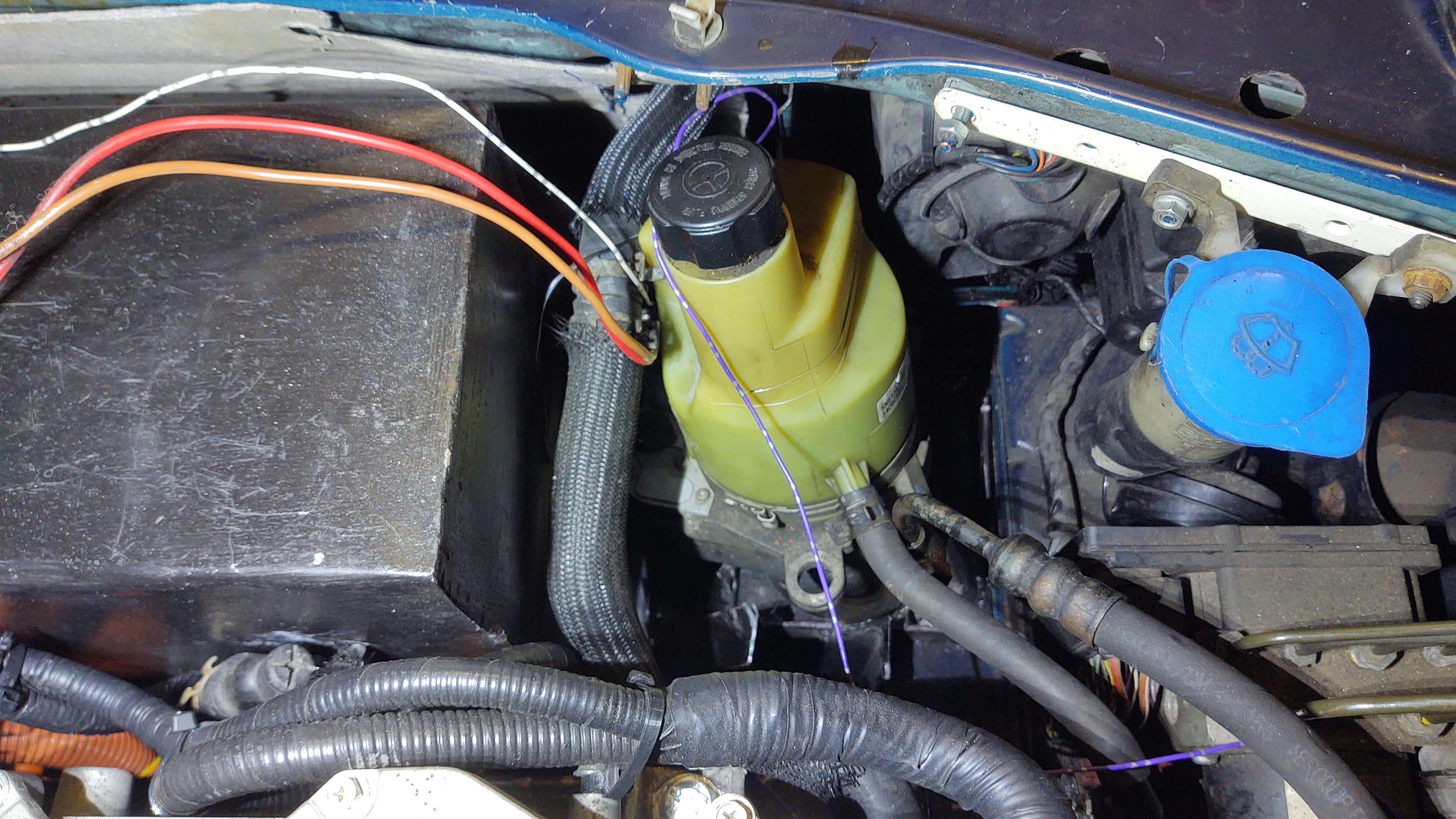

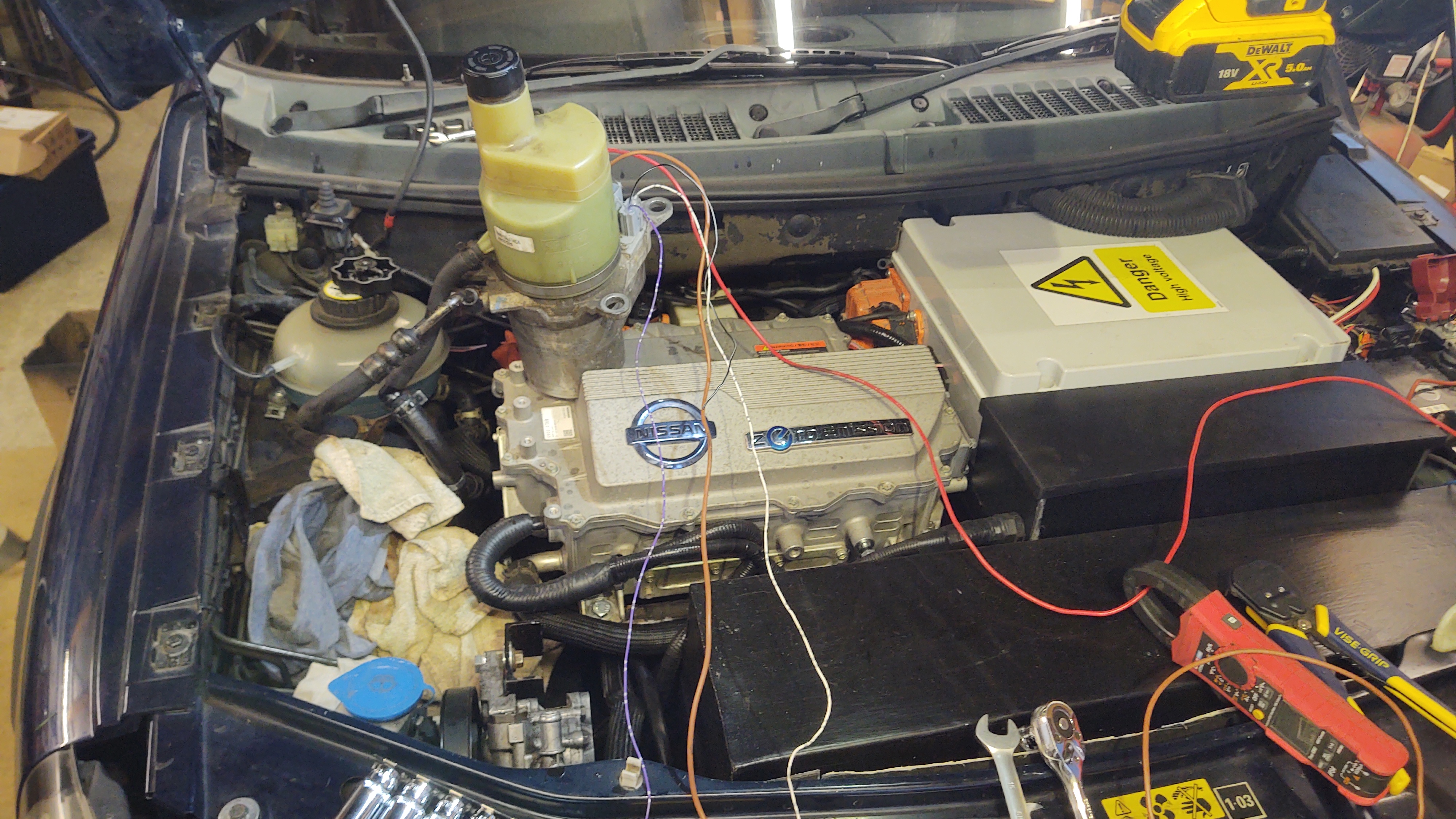

After a ball ache of a job involving spanner, grinder, dremel, crow bar, cold chisel, 4 pounder and engine hoist the altymotor is finally out and the old mount is cut down enough to get the Volvo pump in.
This is the Volvo pump in.situ, it fits well so shouldn't be too hard to secure and after a brief test drive is quiet enough it can only be heard when stationary but gives enough assistance for parking etc.
This is it as I almost finished winding out one side. Doing this released one corner but I basically smashed it out of the other three.

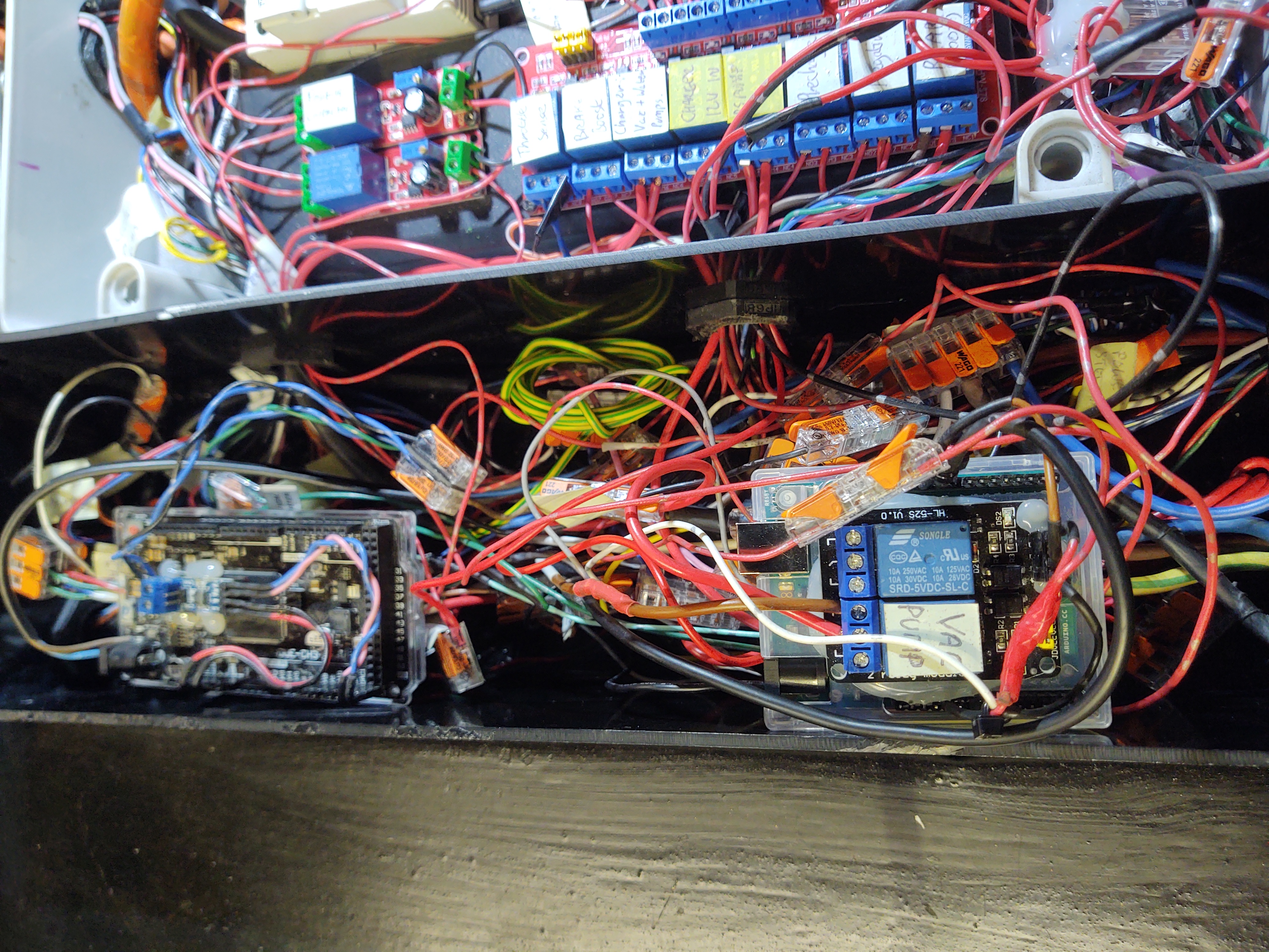

I mentioned a while ago I was having problems with the car cutting out as I drove. I have to admit it was getting me down as I didn't really know where to look but as sometimes happens fate lent me a hand.
The last couple of times I tried to charge the HV battery it stopped charging after around 30 minutes and I had to restart the charge. This was particularly annoying as I still don't have a way to stop the charging automatically when the battery is full so I need to set a timer to remind me to check it, so had to keep extending the timer.
On Sunday after a charging session I took the car out for a drive and it cut out three times in 2 miles.
I kinda figured the two problems may be connected so I posted about the charging issue in Openinverter.org and after looking at the CAN logs I posted a couple of guys came back with some very helpful solutions.
Long story short after a couple of days chasing it I discovered the timer module I use as a fail safe to control the positive contactor had too many other devices attached to the same power lead and it was glitching. I was able to make the fault occur just by flashing the head lights, not every time but almost and I think it also happened when the brake boost pump kicks in which it does periodically.
Anyway I have driven the car several times since sorting this issue and charged it and it hasn't cut out yet so I'm daring to hope I may have sorted both faults. I plan to make a change so that the timer module triggers a latching relay and take the power for the relay directly from the ignition switch. This way I'll have a decent quality relay controlling the positive contactor instead of a $2 timer module.
Being used for it's intended purpose.
Now I need to look at the drivers window regulator that is making some horrible noises and the rear NS that isn't dropping at all. :rolleyes:

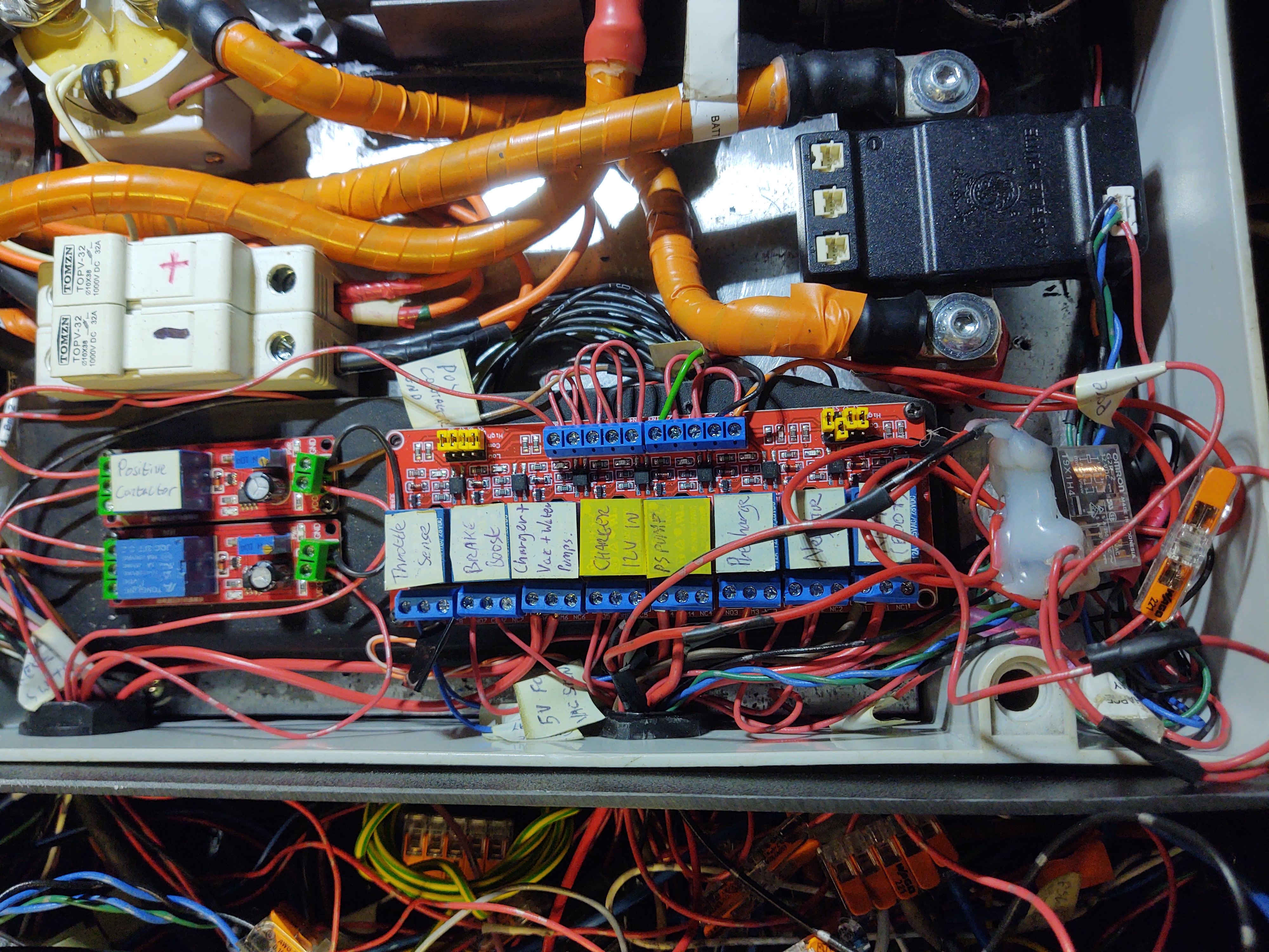

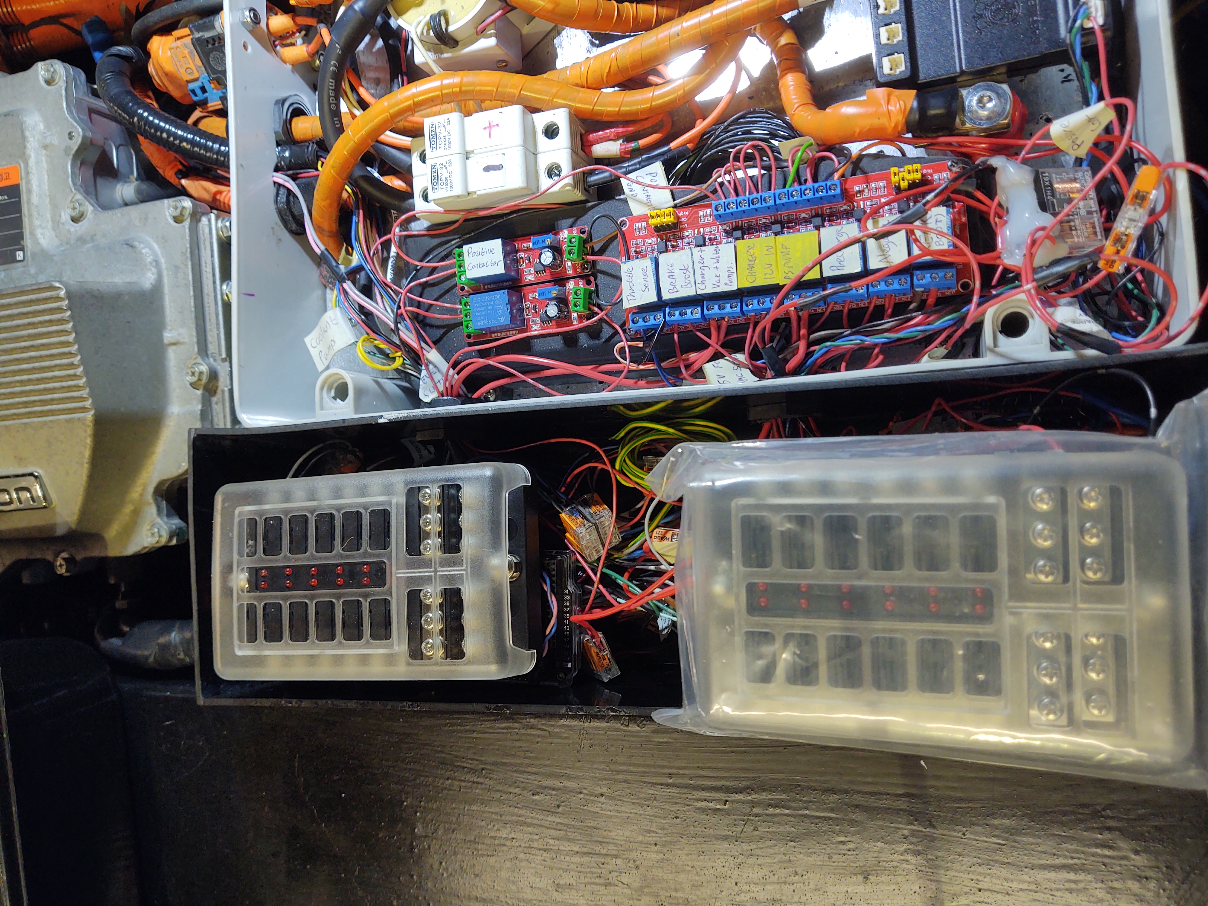

So it ain't pretty but I happened to have a DPST (double pole single throw) relay with wires soldered to it so I connected it in tonight and tested what would happen if the timer module glitched.
The relay is bottom left if you click on the image or bottom right if you don't. So far all seems good
This is the tangle of spaggetti I need to tidy up. And this is where I plan to put the fuse blocks I bought to help with the tidy up.
