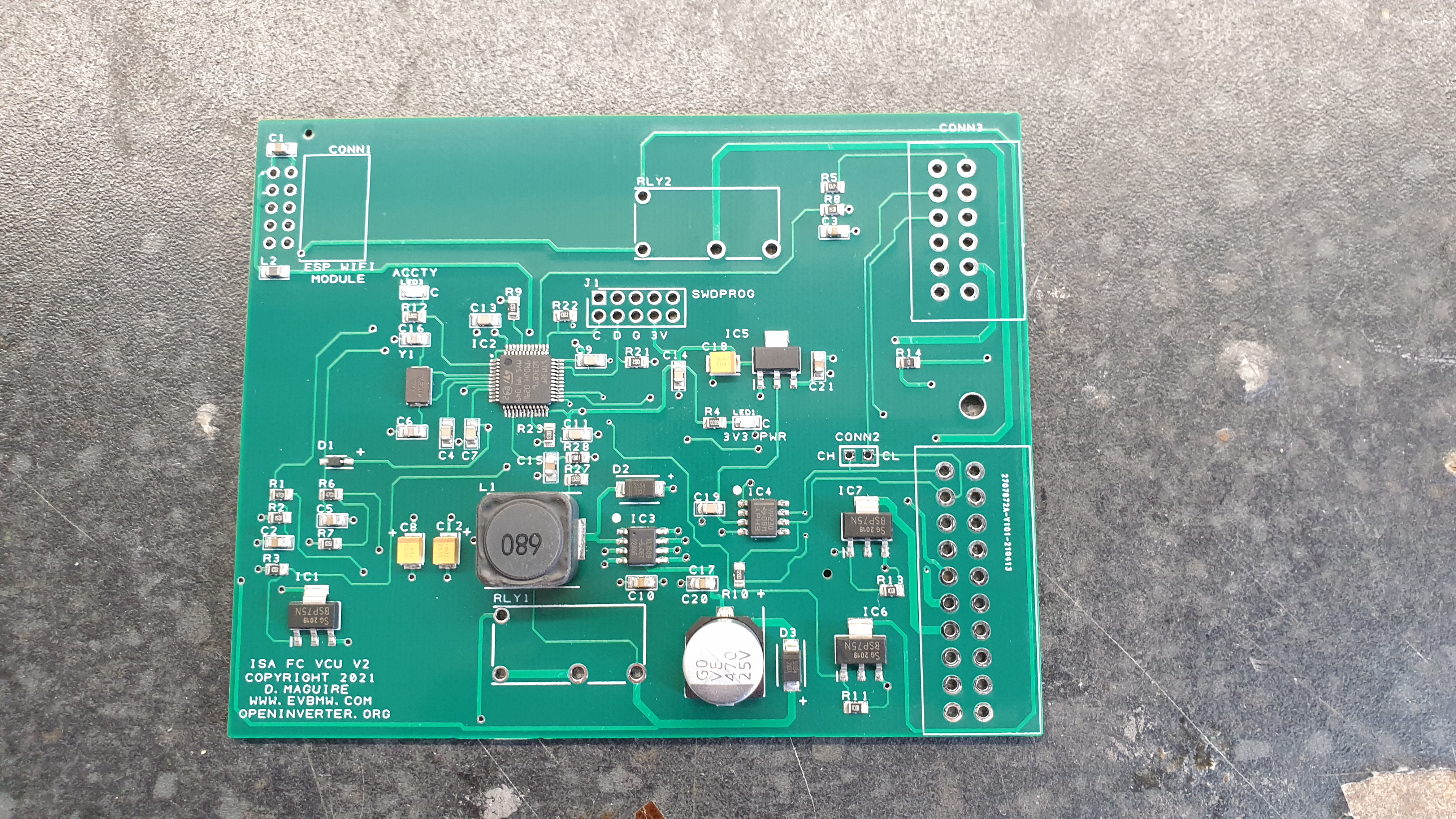

There is no SWDIO label on the programming port in your schematic, did you pick that up before you did the pcb layout?
Also there appears to be no 10k pullup on the reset line which is a definite requirement.

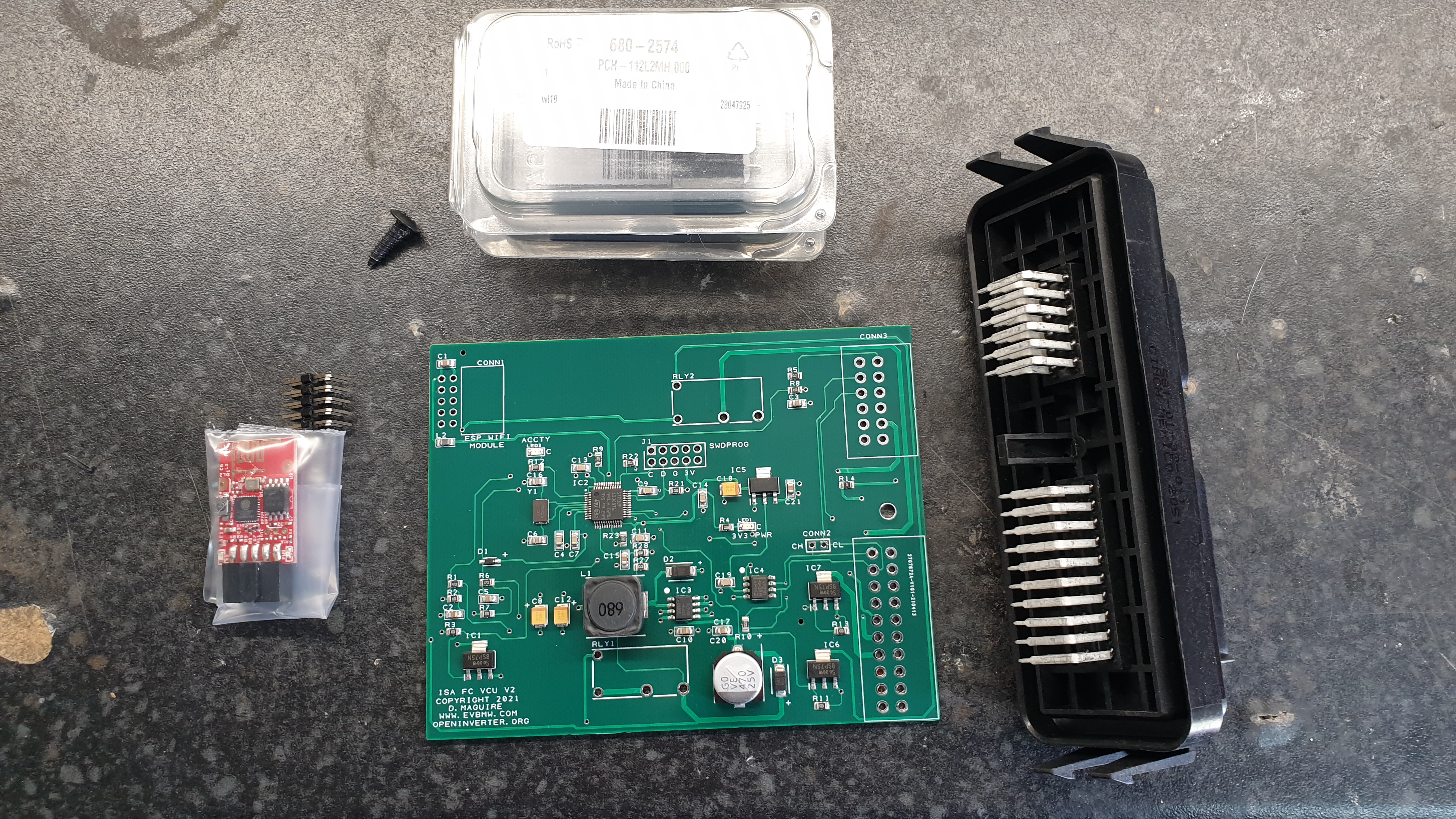

Ok folks just did a major update over on the repo :
https://github.com/damienmaguire/Chadem ... Controller
New hardware and software is now on there for the openinverter STM32 based version.
Kits and boards will soon be available on the webshop and expect some firmware tweaks over the coming days as I test the controller in the E39.
Instructional video for this and the pcs controller also on the way soon.
Note : due to a severe restriction on the supply of the Cinch Me-Mx connector header there are two variants of the board. One with the Me-Mx and the other with a 35 way Ampseal header. Both are the same circuit just a different header. Pinouts for both will be posted here and on the repo shortly. I have also commissioned the design of a 3d printable housing for the Ampseal variant of both this and the PCS controller. This design will be posted on here and on the repo once completed and test fitted.

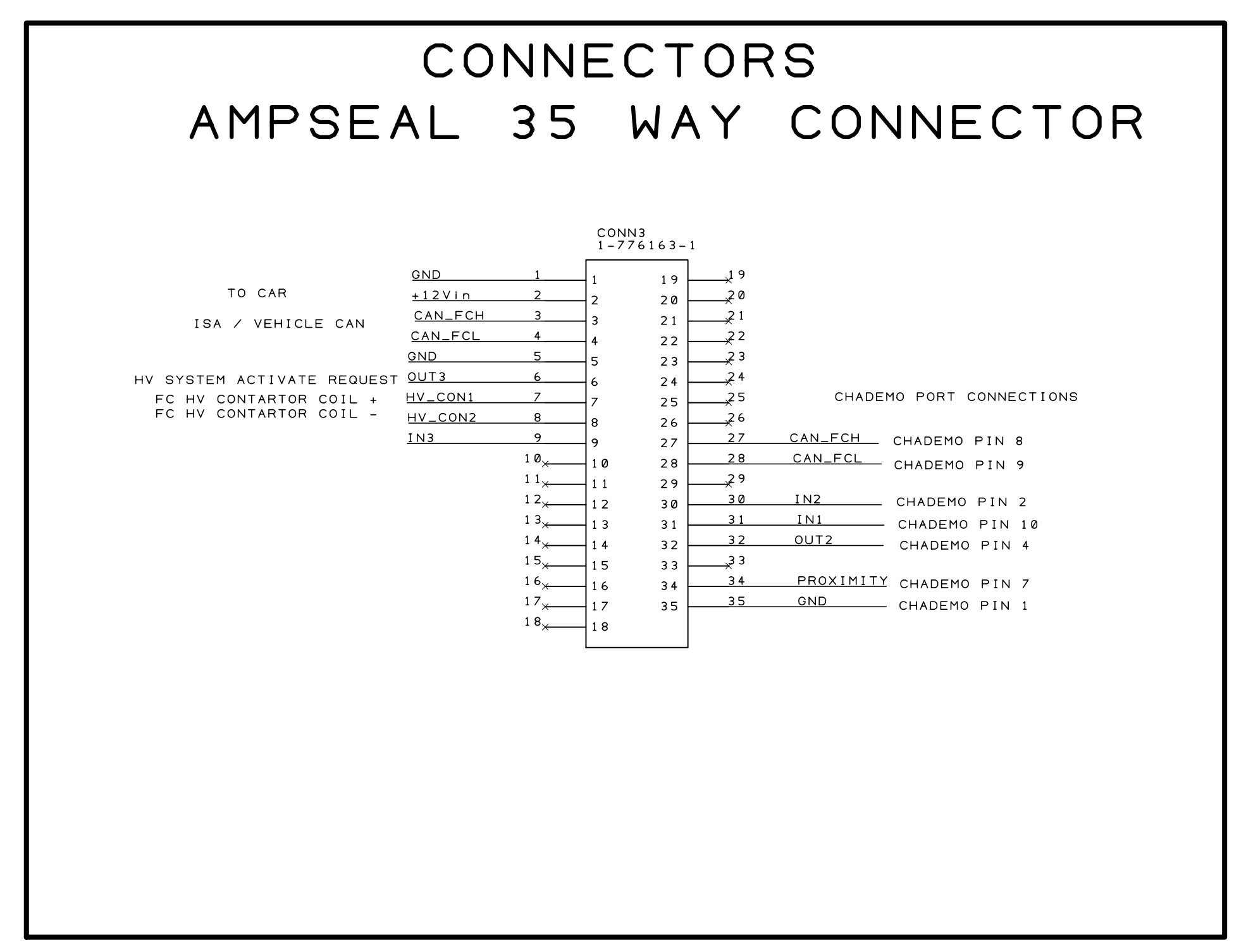

Ok potentially dumb question:
Do the contactor relays on the board pull to ground or 12V when activated?
Isaac96
- Posts: 656
On the 'Chademo VCU' the contactor relay connects the contactors between pin 2 (positive signal from EVSE) to pin 10 (negative signal from EVSE).
The other relay simply powers up the unit when pin 7 is grounded.
EDIT Fixed mistake
EDIT Fixed mistake

Ok so both contactors' + lead goes to pin 7 and both contactors' - lead goes to pin 8? on the 35 pin version?
Isaac96
- Posts: 656
No idea what the numbers are on the 35 pin. I only know the chademo side and the relay wiring. But you probably have it right.

35 pin pin numbers below for reference

One more dumb question: Out 3 "HV System Request", What should that be wired to?
Isaac96
- Posts: 656
So Damien has really cool HVJBs in his vehicles that allow him to distribute power out to many different things. He's got main pack contactors, charger contactors, Chademo contactors inverter contactors, etc.
Whenever power is needed for something, the main pack contactors turn on and then whatever else is needed can be powered up. HV system request would go to those contactors so that the chademo contactors could be connected.
If you don't have a fancy HVJB/pack contactors etc then you don't need to use HV system request at all.

Should the wifi connection appear as soon as the board has 12V, or only when plugged into a station? I'm not seeing it come up when just 12V is connected with the car in my garage. The laptop is next to the board so it's not a wifi range issue.
- Posts: 4000
- Been thanked: 1114 times
The board only powers when the proximity pin of the chademo port is pulled to ground.
