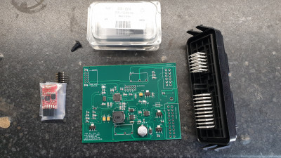

Ok folks just did a major update over on the repo :
https://github.com/damienmaguire/Chadem ... Controller
New hardware and software is now on there for the openinverter STM32 based version.
Kits and boards will soon be available on the webshop and expect some firmware tweaks over the coming days as I test the controller in the E39.
Instructional video for this and the pcs controller also on the way soon.
Note : due to a severe restriction on the supply of the Cinch Me-Mx connector header there are two variants of the board. One with the Me-Mx and the other with a 35 way Ampseal header. Both are the same circuit just a different header. Pinouts for both will be posted here and on the repo shortly. I have also commissioned the design of a 3d printable housing for the Ampseal variant of both this and the PCS controller. This design will be posted on here and on the repo once completed and test fitted.

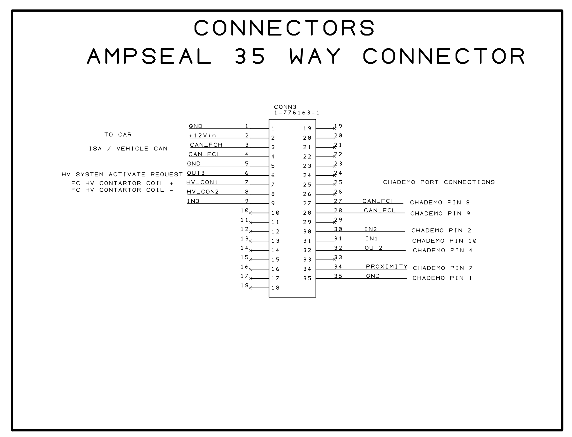

Ok potentially dumb question:
Do the contactor relays on the board pull to ground or 12V when activated?
Isaac96
Posts: 656
Post by Isaac96 »
On the 'Chademo VCU' the contactor relay connects the contactors between pin 2 (positive signal from EVSE) to pin 10 (negative signal from EVSE).
The other relay simply powers up the unit when pin 7 is grounded.
EDIT Fixed mistake

Isaac96 wrote: Fri Aug 27, 2021 4:00 pm On the 'Chademo VCU' the contactor relay connects the contactors between pin 2 (positive signal from EVSE) to pin 10 (negative signal from EVSE).
EDIT Fixed mistake
Ok so both contactors' + lead goes to pin 7 and both contactors' - lead goes to pin 8? on the 35 pin version?
Isaac96
Posts: 656
Post by Isaac96 »
No idea what the numbers are on the 35 pin. I only know the chademo side and the relay wiring. But you probably have it right.

Isaac96 wrote: Fri Aug 27, 2021 5:33 pm No idea what the numbers are on the 35 pin. I only know the chademo side and the relay wiring. But you probably have it right.
35 pin pin numbers below for reference
Isaac96
Posts: 656
Post by Isaac96 »
You're bang on then.
