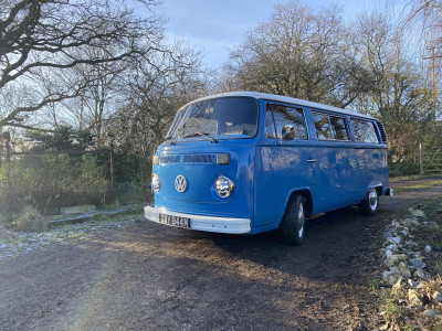

I hearby change my project status to DRIVING (fully legal and in use)
Whoop!

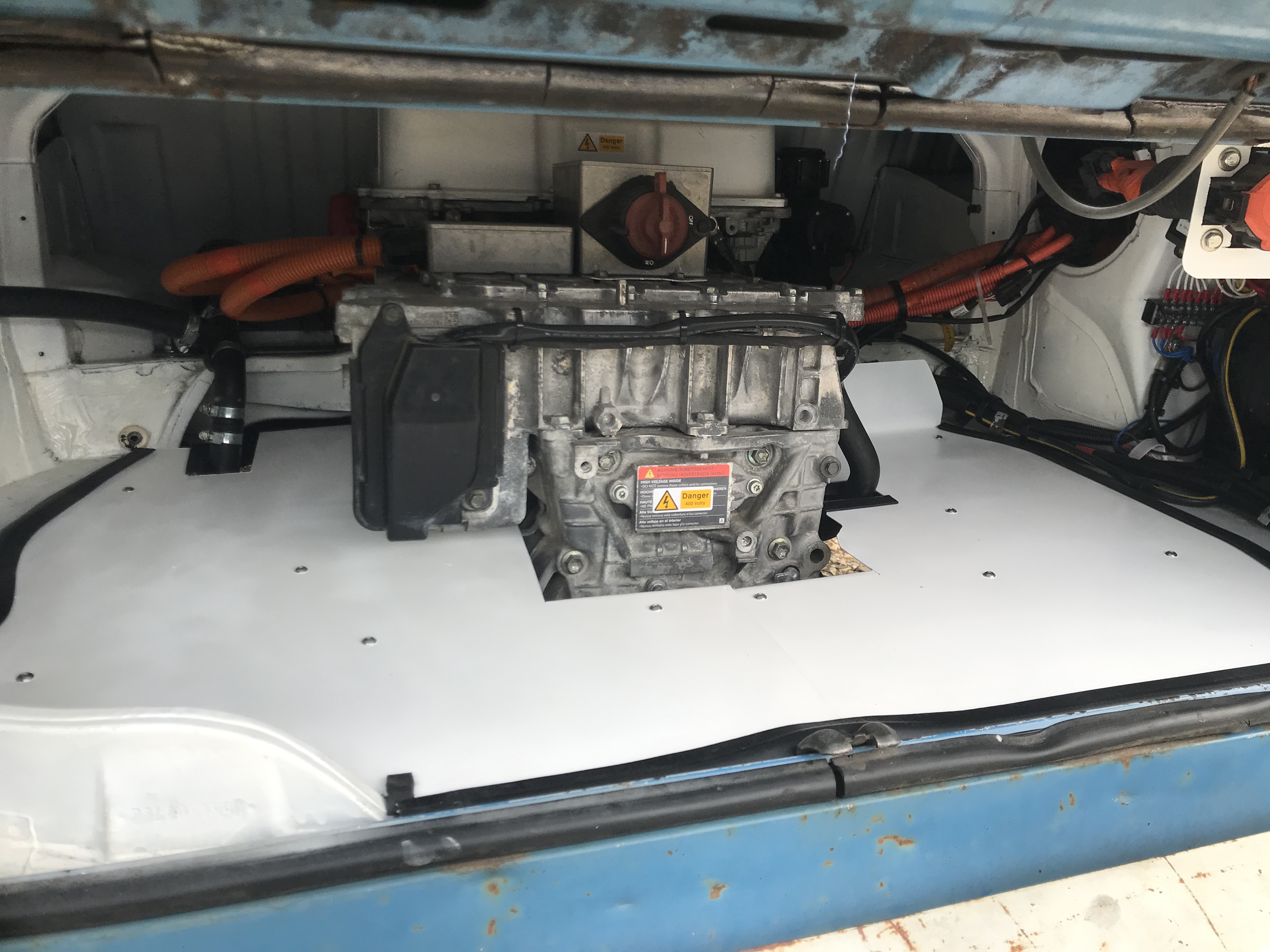

So now the engine / motor bay has an aluminium sheet installed. Intention is to reduce road water from getting into the bay to reduce risk of a 12v short. Plus it’s linked to the discussion I had with Terry about cooling.
Travelled on Friday about 70 miles, outside temp about 28 deg C. Generally the reported motor (incl PDM and inverter) coolant temp was in the 50s - 60s. Probably obvious to say this, but driving through a sequence of roundabouts on a section of dual carriageway generated the most heat due to the hard regen braking followed by fast acceleration, and then repeated multiple times shortly after. That had a peak of 75, but it quickly dropped back into the 60s.
I think my conclusion is the bigger radiator dissipated the heat more rapidly! No shit!
As to the effect of the aluminium sheet. Can’t really be conclusive, but I’m glad it’s there just to keep debris and wet out of the bay.
In a nod to the comments from Terry, since I had to make the cut out shape in the sheet larger in order to wiggle it into the awkward space around the motor, most of that extra wiggle space I put toward the rear, so that any positive air pressure from the T2s side scoops might get pushed down through that gap over the radiator below. Not possible to tell if that has any effect, but that’s the intention.
Worth noting the VCU turns on the fan at 60 degrees. Not configurable, so potentially I could divorce the fan control to a separate isolated circuit to have it come on at lower temps.
I’ll continue to have my co-pilot read out temperatures on long hot journeys to check how it behaves, but I suspect I’m parking this item now until next summer.

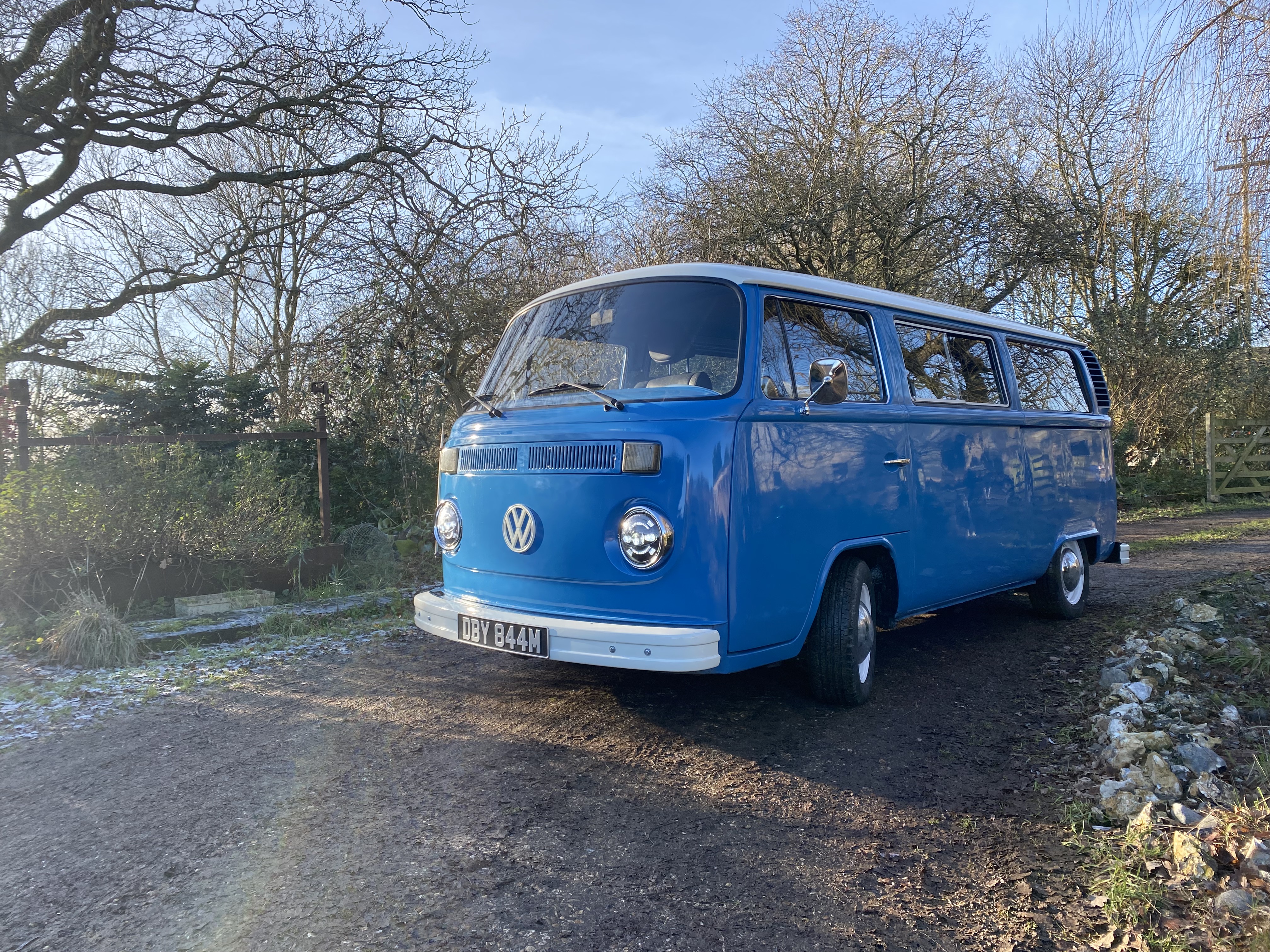

Right then, my next priority jobs in no particular order…
Sort out my dashboard. I can 3D print the controls I need, but have some styling decisions to make first.
Mount Chademo port to my outside fuel flap. Should be doable, but need to extend HV cables.
Brake Ibooster - I really can’t stand my vac pump noise anymore.
I’ve used the model list from EV Create and gone cross eyed opening countless tabs on eBay. Think what I’m after is the Renault Zoe flavour because it seems to be the only variant that has a small mounted fluid container, plus a tube to a 2nd remote container, which is an arrangement that works best for the VW.
But it’s slightly frustrating finding one that includes the large plug, most of the UK sellers don’t include it. European sellers, mainly Lithuania for some reason are much better at including it. But then there’s more postage!
I’m looking all shiny now… (and the van’s not bad either!)

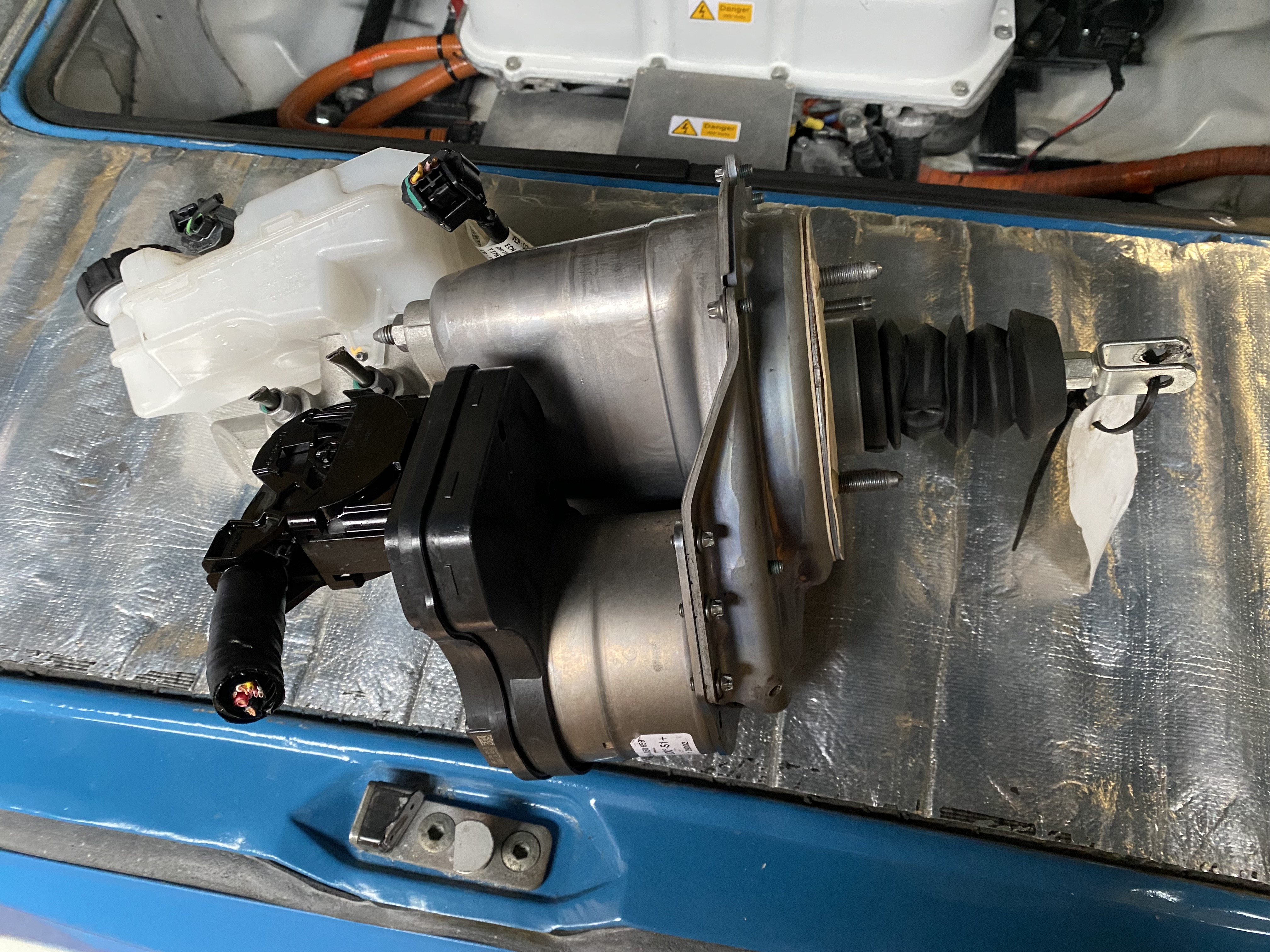

I now own a Renault Arkana ibooster. Never heard of an Arkana.
At £56 incl delivery I thought it was worth a punt. Marc helpfully told me that the Renault Zoe version needs CAN ack, so I realise this could be the same as it’s the same make. So I’ll just have to work that out if that’s how it turns out.

Wired up the Renault Arkana Gen2 ibooster for a bench test. Seems to work. As suspected it does require CAN or it won’t move. Used pins 16 and 25 for CAN in addition to the other standard pins for basic mode as shown in the EV Create guide.
