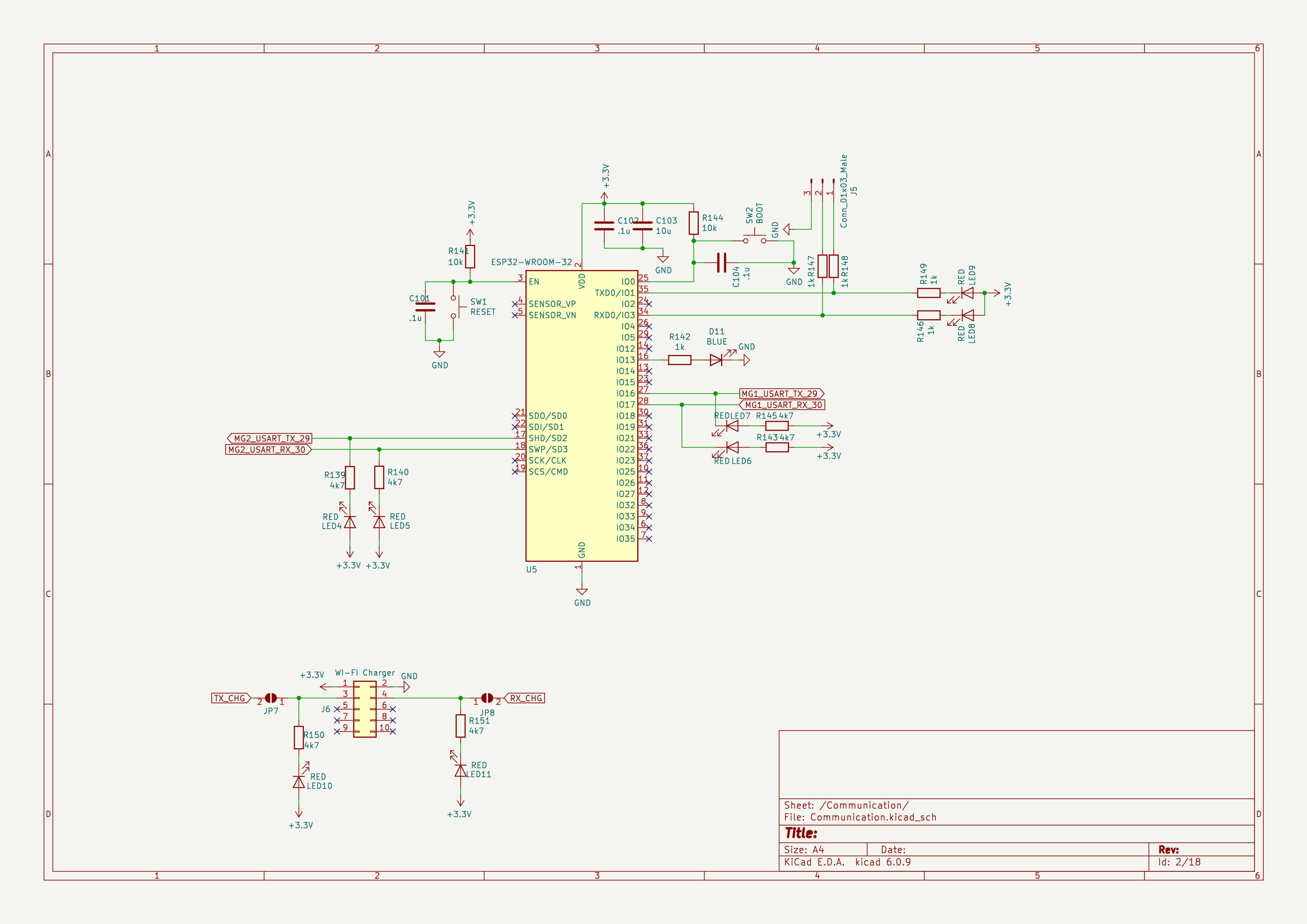

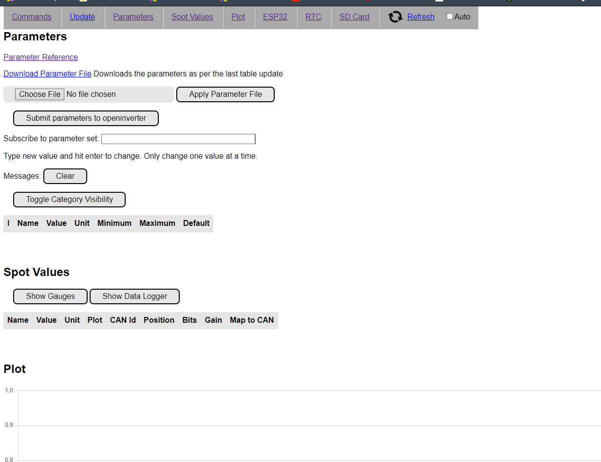

Does any one have the Sine firmware and bootloader, that works with esp32 web interface hex. file to share. SMD Update dont work so i think i need hex file only, I saw there is a modified firmware that was posted but it wasnt compiled. im not very CMD knowledgeable to make one.
I have 5.20 Sine installed and I can not see parameters at all in web parameters section. There are no values.
I have v6 LDU board with ESP32-Whoom Module.

I never tested the ESP32 code on my github for firmware updates and I seem to remember that when Johannes tried it he had to make a few changes (detailed above somewhere), they never got pulled due to github forking issues. @johu - if you can post the changes somewhere I'll update the repository?
If you can't see the parameters you also have a comms problem too.
If you want a simpler option the ESP8266 is currently a more stable/mature solution (the ESP32 option is still being developed).

Just realized I never forked your repo, will clean that all up later (or you give me write access, will push to another branch).
For my scenario I changed the inverter UART to UART0.
Most of all I bugfixed the update process:
-  int pages = (file.size() + PAGE_SIZE_BYTES - 1) / PAGE_SIZE_BYTES;
+  uint8_t pages = (file.size() + PAGE_SIZE_BYTES - 1) / PAGE_SIZE_BYTES;
-    snprintf(uartMessBuff, UART_MESSBUF_SIZE, "%d", pages);
-    uart_write_bytes(INVERTER_PORT, uartMessBuff, strnlen(uartMessBuff, UART_MESSBUF_SIZE));
+    uart_write_bytes(INVERTER_PORT, &pages, 1);
That was it, it all works then. I'm already shipping that on the Tesla SDU and Nissan Leaf kit.

In the meantime I've added Johannes changes (hopefully all of them but untested) to a branch - https://github.com/Pete9008/esp32-web-i ... /tree/johu
Hopefully this will work with ESP32 modules that are integrated onto boards.

Board arrived today Pete, thanks. Need to get my head around what's changes are needed in the inverter firmware to get this working again with the latest release code.

My branch is https://github.com/mmadzar/GN02475inv and inverter firmware update code wasn't changed, just added some custom code that no one else needs. :)
I can confirm that firmware update code works. I uploaded v5.26.Y firmware last night without any problems. Just uploaded bin file and that was it.

Bigpie wrote: Tue Apr 04, 2023 12:20 pm Board arrived today Pete, thanks. Need to get my head around what's changes are needed in the inverter firmware to get this working again with the latest release code.
You and me both!
Thinking about it my board was built up largely of bits and pieces I already had so the parts list might not be quite as good as it could be. Let me know if anything doesn't make sense.
mario wrote: Tue Apr 04, 2023 12:29 pm My branch is https://github.com/mmadzar/GN02475inv and inverter firmware update code wasn't changed, just added some custom code that no one else needs. :)
Thanks for posting, I'd noticed your fork and wondered whether it was someone on here :)
Would you be able to give a bit more detail on what your additions are as they could well be useful to someone (I'm curious about the MQTT stuff in particular)?

I've been having a bit of a read, the code on Johannes GitHub doesn't contain your binary logging changes, but does contain binstream that works differently. As I understand, the binstream that's in released code doesn't send the values each loop, so not ideal.
I've not braved a look at the BOM yet, but I guess adding your flavour of binary logging would be where I go next.
