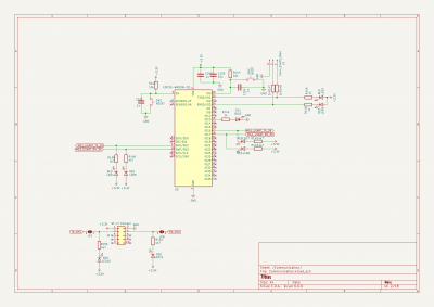

Hello everybody! I have a couple of questions: I have GPIOs 16 and 17 connected to MG 1 in my ESP 32. It works! And MG 2 is connected to GPIO 9 and 10.
I make changes to the code:
#define DBG_OUTPUT_PORT Serial
#define INVERTER_PORT UART_NUM_2
#define INVERTER_RX 9
#define INVERTER_TX 10
The following messages come to the debug port:
rst:0x8 (TG1WDT_SYS_RESET),boot:0x13 (SPI_FAST_FLASH_BOOT)
configsip: 0, SPIWP:0xee
clk_drv:0x00,q_drv:0x00,d_drv:0x00,cs0_drv:0x00,hd_drv:0x00,wp_drv:0x00
mode:DIO, clock div:2
load:0x3fff0030,len:1344
load:0x40078000,len:13836
load:0x40080400,len:3608
entry 0x400805f0
ets Jun 8 2016 00:22:57
Moreover, even if the ESP is flashed with UART GPIO 16 17 and connect MG 2 to the outputs as in the diagram, then the ESP also constantly reboots.
is it possible to use UART1 in this code? If so, how and what can be changed?
Pete9008
Posts: 1801
Has thanked: 102 times
Been thanked: 350 times
Re: ESP32 Based Web Interface & Data Logger
Post by Pete9008 »
You have to be a bit careful which pins you use, some conflict with the internal flash memory in the ESP32 module.
Think you need to avoid pins 6-11 in particular.
Edit - also seem to remember that UART1 can conflict with some things too but afraid I can't remember what :(
Yahha777
Posts: 52
Joined: Wed Feb 27, 2019 7:03 am
Location: Belorussia. Borisov
Has thanked: 16 times
Post by Yahha777 »
Pete9008 wrote: Sat Nov 12, 2022 5:22 pm You have to be a bit careful which pins you use, some conflict with the internal flash memory in the ESP32 module.
Tried to use GPIO 1, 3. Works. 6-11 seems to be limited when using memory.
Thank you!

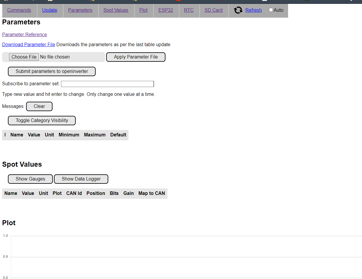

4GSHARK
Posts: 5
Joined: Thu Jan 12, 2023 6:37 am
Post by 4GSHARK »
Does any one have the Sine firmware and bootloader, that works with esp32 web interface hex. file to share. SMD Update dont work so i think i need hex file only, I saw there is a modified firmware that was posted but it wasnt compiled. im not very CMD knowledgeable to make one.
I have 5.20 Sine installed and I can not see parameters at all in web parameters section. There are no values.
I have v6 LDU board with ESP32-Whoom Module.
Pete9008
Posts: 1801
Post by Pete9008 »
I never tested the ESP32 code on my github for firmware updates and I seem to remember that when Johannes tried it he had to make a few changes (detailed above somewhere), they never got pulled due to github forking issues. @johu - if you can post the changes somewhere I'll update the repository?
If you can't see the parameters you also have a comms problem too.
If you want a simpler option the ESP8266 is currently a more stable/mature solution (the ESP32 option is still being developed).

In the meantime I've added Johannes changes (hopefully all of them but untested) to a branch - https://github.com/Pete9008/esp32-web-i ... /tree/johu
Hopefully this will work with ESP32 modules that are integrated onto boards.

Board arrived today Pete, thanks. Need to get my head around what's changes are needed in the inverter firmware to get this working again with the latest release code.

My branch is https://github.com/mmadzar/GN02475inv and inverter firmware update code wasn't changed, just added some custom code that no one else needs. :)
I can confirm that firmware update code works. I uploaded v5.26.Y firmware last night without any problems. Just uploaded bin file and that was it.

Bigpie wrote: Tue Apr 04, 2023 12:20 pm Board arrived today Pete, thanks. Need to get my head around what's changes are needed in the inverter firmware to get this working again with the latest release code.
You and me both!
Thinking about it my board was built up largely of bits and pieces I already had so the parts list might not be quite as good as it could be. Let me know if anything doesn't make sense.
mario wrote: Tue Apr 04, 2023 12:29 pm My branch is https://github.com/mmadzar/GN02475inv and inverter firmware update code wasn't changed, just added some custom code that no one else needs. :)
Thanks for posting, I'd noticed your fork and wondered whether it was someone on here :)
Would you be able to give a bit more detail on what your additions are as they could well be useful to someone (I'm curious about the MQTT stuff in particular)?
