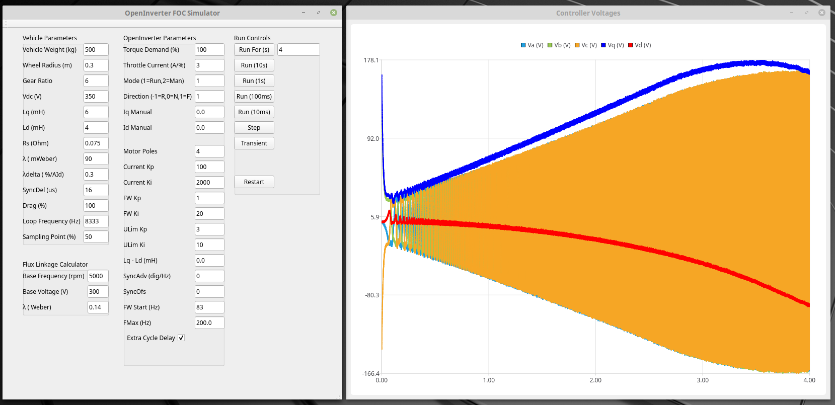

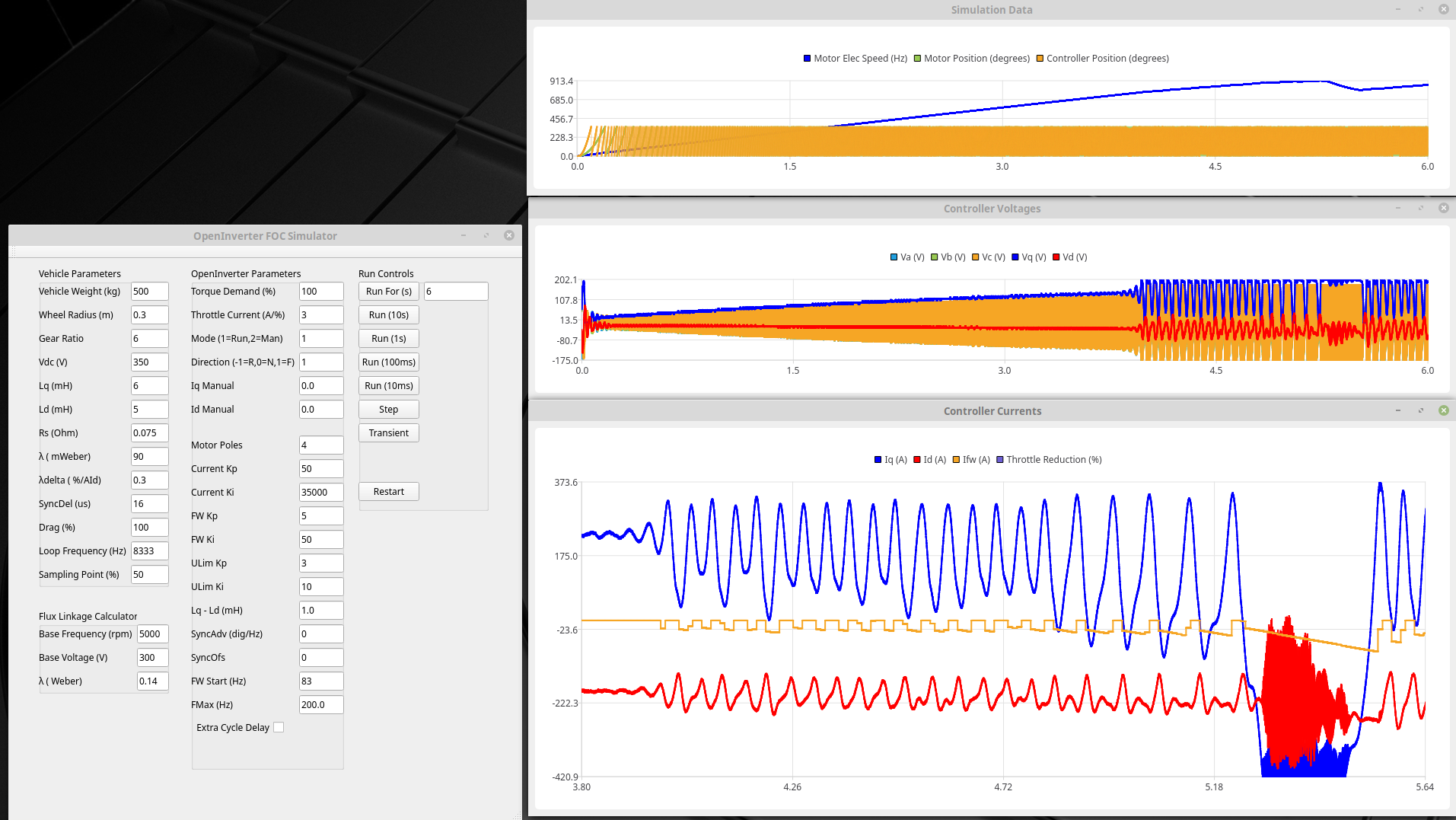

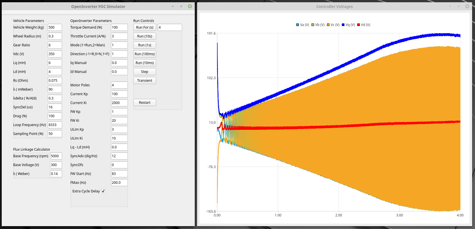

Might have just clicked, the plots show what the controller thinks is the Uq and Ud, not what is actually being seen by the motor. I think this is the sync compensation issue that I was on about the other day. The controller uses the old angle to calculate Uq and Ud, the motor sees this 113us later (when the timer is reloaded) by which point the rotor angle has changed. The amount by which it has changed goes up with motor speed so the effect gets worse with speed. This will effectively shift current/voltage between q and d as seen by the motor/controller.
I think if the angle is recalculated (using an advance value of around 12) just before calling the inverse Parke/Clarke the shape of the logged plots will change considerably and better match the simulation.
Edit - and here are two plots modelling the effect. No compensation, voltages as seen by controller:
You can see there is a strong frequency dependant Ud component
And with compensation:
The Ud component is much flatter, not perfect but then the compensation is unlikely to be prefect either.
Think I'm happy with the model again :) but am more convinced than before that either reduced latency (preferable) or sync compensation would provide benefits.
Edit2 - this makes me wonder whether there are two sets of ki/kp that work. One that uses kp to do most of the work and one that uses ki. Will try it when (at some point in the dim and distant future!) I have some hardware to try things on.

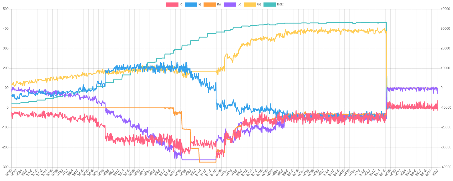

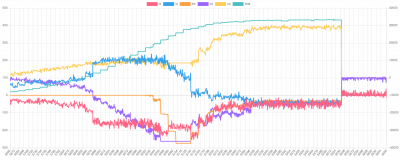

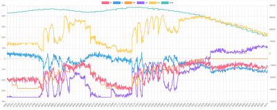

Well then here is something for you to test. Best run yet
Parameters
curkp 50
curki 35000
curkifrqgain 0
fwkp 5
fwki 50
fwmargin 4500
syncofs 1000
syncadv 0.5
ldminuslq 1
fluxlinkage 90
Still somewhat shaky but drivable, no unwanted regen, no trips.
I have increased S&H time to 7.5 clocks again because I was seeing like 70A spikes in il1/il2! They were gone then.
Next I found that increasing curki improves stability. It is now at 35000 for my Leaf motor. So a good deal of shakiness is now gone, I think with a bit more tuning it could be eliminated. Throttle reacts a bit weird once entering field weakening, you suddenly get more acceleration but you can always compensate that by coming off throttle. It never accelerates on its own. I think that can be tuned out as well. I didn't have the patience now.
stm32_foc.bin
(48.03 KiB) Downloaded 352 times

Pete9008 wrote: Fri Sep 09, 2022 12:57 pm Logic would say it must oppose Uq to reduce torque so again in phase with Uq?
Logic would say that the back emf should peak at the maximum rate of change of flux which is the quadrature component so again Uq?
Yet in the logged plots there is a clear speed dependant component in Ud and not in Uq - or am I misreading the logged plots somehow?

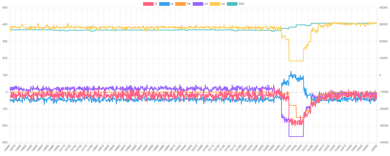

Maybe this is helpful. I was regenning downhill and briefly blipped throttle. In reaction, besides FW building up, ud becomes more negative while uq becomes less positive.
In steady state with regen uq is 30000 and ud -10000

johu wrote: Fri Sep 09, 2022 2:18 pm Maybe this is helpful. I was regenning downhill and briefly blipped throttle. In reaction, besides FW building up, ud becomes more negative while uq becomes less positive.
The back emf is definitely in phase with Uq in that plot which makes sense, the Id, Iq, Ud and Ifm make sense too. The Uq is less obvious but I think that the increased -Id meant that the back emf dropped so a reduced Uq could actually drive current into the motor?
Edit - On thinking about it that is all doing exactly what you would expect :D

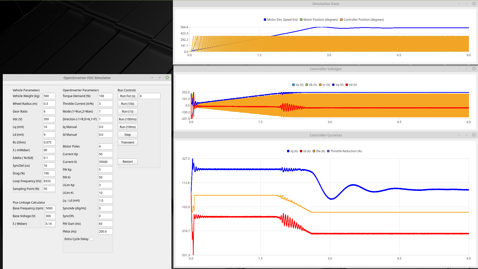

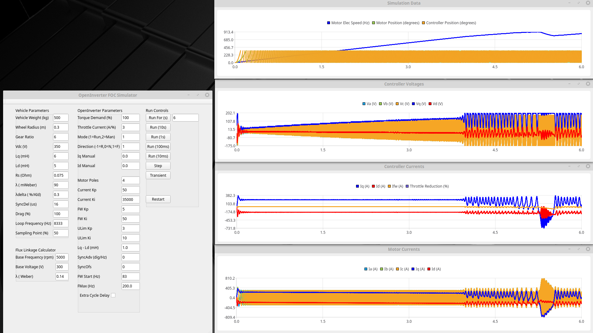

Simulator output:
Zoomed in on the controller currents to see a bit more detail of Ifw:
And with the effect of -Id on the back emf tweaked (reduced from 0.3 to 0.1%/AId)
Not too bad a match. It seems that to simulate field weakening accurately we need a bit more data on how the flux linkage changes with Id. The leaf motor looks to be somewhere between 0.1 and 0.3.

johu wrote: Fri Sep 09, 2022 4:20 pm That last one looks very good! What exactly did you tweak there?
Also I noticed you let the simulation run to 900 Hz. The Leaf motor is only specd to 10500 rpm or so i.e. 700 Hz. Not sure I'd dare run it at that speed for now, but 8000 rpm would be nice.
TBH I wouldn't dare go too far into the field weakening region at all yet. The model still shows strong regen just on acceleration (you can see it at around 900Hz in the above plots) or as soon as you aggressively come off the accelerator at even fairly modest frequencies in FW.
Don't read anything into the speeds, Ive just been running the simulations until it stops accelerating or control is lost. However, it does suggest the the inverter/firmware should be physically capable of running motors at high speeds if we can sort the stability/FW.
The tweak was to the strength of the back emf. Essentially how much the back emf is reduced for each amp of -Id. I've no idea what a sensible value is here which is why I'm interested in trying to reproduce actual logs to get a feel for what values are realistic.

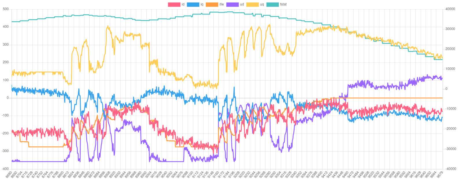

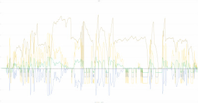

Just out on a shopping trip but had logger running on my phone. High rpm wasnt an issue. Had a couple of cutouts.
Definitely more torque though. Was able to accelerate up hill in 2nd gear
log (2).csv
(30.8 KiB) Downloaded 360 times

Bigpie wrote: Sat Sep 10, 2022 8:30 am Just out on a shopping trip but had logger running on my phone. High rpm wasnt an issue. Had a couple of cutouts.
:D

Putting up to 400A total into the motor. FW didn't become active at all. What are fwkp, fwki and fwmargin set to? Was it cutting out on acceleration or liftoff?

Pete9008
Posts: 1801
Has thanked: 102 times
Been thanked: 351 times
Post by Pete9008 »
johu wrote: Sat Sep 10, 2022 8:40 am Putting up to 400A total into the motor. FW didn't become active at all. What are fwkp, fwki and fwmargin set to? Was it cutting out on acceleration or liftoff?
Been wondering about this, is it possible that on some motors the -Id added by Mtpa is enough to do fw while on the accelerator? If so you would only see FW come in during coasting or deceleration above base frew and I don't see much of that in the plot. It would be interesting to see the Uq and Ud voltages on the plot too as that would show whether Ifw should have been added.
Pete9008
Posts: 1801
Post by Pete9008 »
johu wrote: Sat Sep 10, 2022 8:41 am Yes it is quite a multi feedback system ;) Still need to find a way to bring in FW fast enough before amplitude maxes out but then keeping the gain low as you say.
Does FW need to come in that fast? It should only need to come in as quicly as the motor can accelerate and that is very slow compared to Id and Iq. An amp per ms would probably be plenty!
Pete9008
Posts: 1801
Post by Pete9008 »
Been thinking about where I'm personally at with this. The original goal was to enable me to make the decision on whether to stick with OpenInverter or move to the Outlander inverter. There were a number of issues that were bothering me, mainly the unwanted regen when coming off the throttle but also comments on disappointing performance on the Outlander and MGR motors.
I'm pretty confident now that johu's changes are going to sort these issues :D
Unfortunately while using the simulator I've become fairly convinced that there is still a control stability issue when pushing further into the FW region of motor speed. From what I've seen in simulation it's could also be a very rapid transition from working fine to strong unexpected regen and the further you push past base frequency the stronger the regen gets. I'm hoping I'm wrong here, that the simulator isn't accurately modelling things, that the instability isn't there and it all works fine at high speed, the trouble is the only way to tell is to accelerate to high speed in a car and if the problem is there, and exhibits itself at high speed, it could get nasty. While I'm willing to take a chance while I'm driving I need to be 100% confident when it's someone else.
So - the job for this weekend it to have another go at tweaking the code to reduce latency. If I can get that to work, and in a way that is unlikely to break anything else, I'll stick with the Prius inverter running OpenInverter code. If not then I'm going to move to an Outlander inverter running OEM code (and I'm really not keen on that option as it affects a whole load of other things on the car that I was hoping to do using features that only the Prius inverter has!)

Posts: 1884
Has thanked: 91 times
Been thanked: 517 times
Attaching latest log as a method of getting it off my phone.
Getting in bother for experimenting with the kids in the car.
Cut outs always on acceleration, I'd love to get the bottom of why it's cutting out, maybe overshooting? I can sometimes get my foot to the floor, others not so.
"fwkp": 1,
"fwki": 1,
"fwmargin": 2000,
If I wanted to graph from my log, would I be plotting the avg columns?
EDIT, Sorry wrong params attached. Updated
At 435 on the bottom axis looks to be where I had 3 coutouts in a row. The brown plot in the temperature from the inverter.
params (2).json
(1.46 KiB) Downloaded 348 times
log (3).csv
(127.57 KiB) Downloaded 363 times
