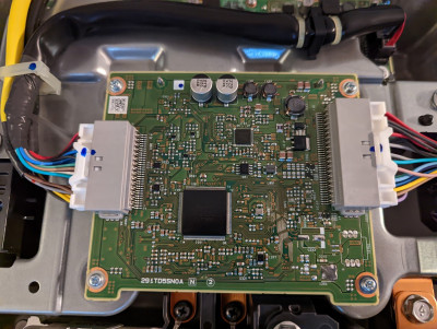

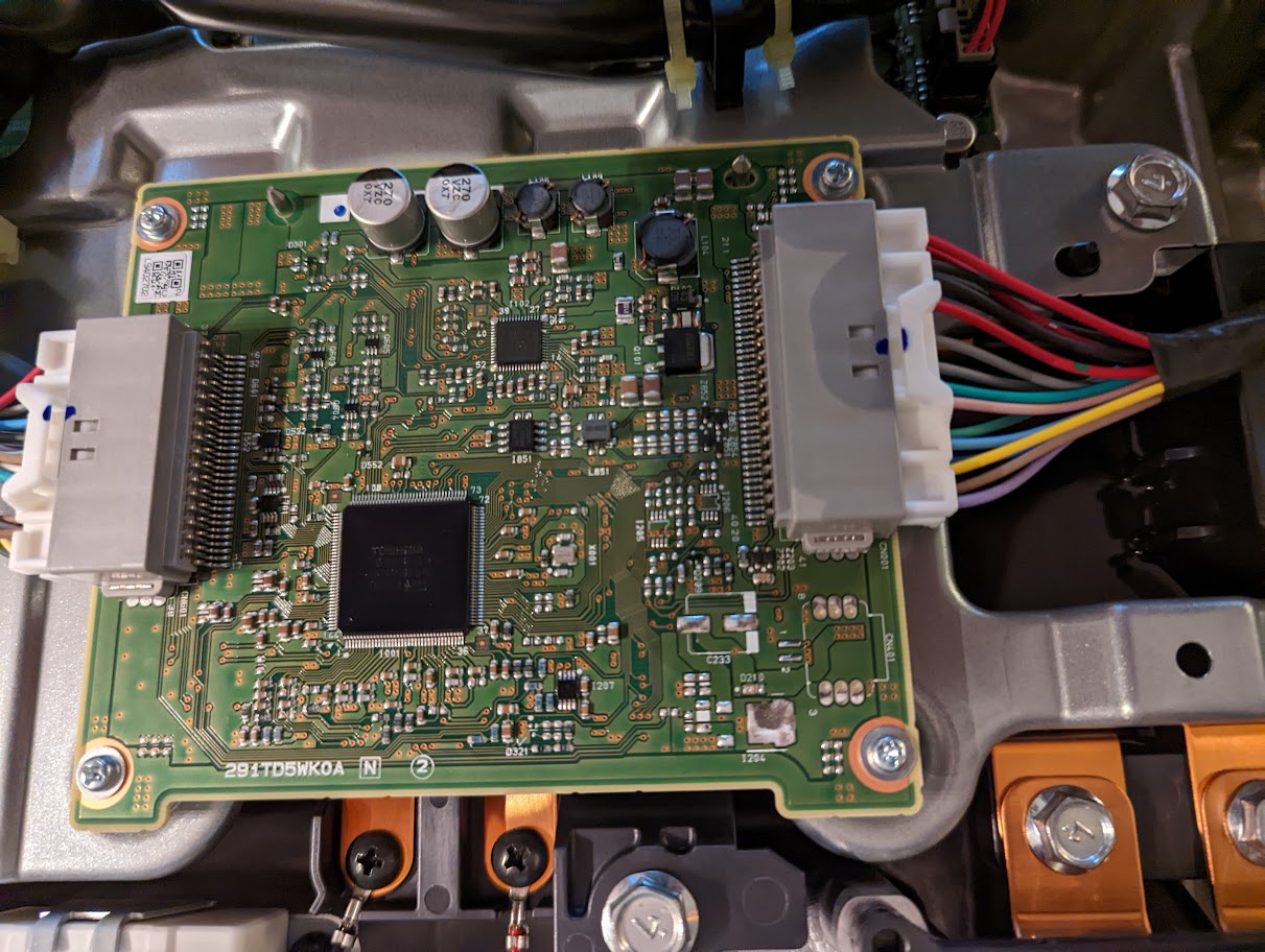

I received two inverters, one 160Kw and one 110Kw
I opened both Inverters, one is 5WK0A which is 110 Kw
the other one is 5SN0A which is 160Kw and one 110Kw
As stated before they are the same except for the main board!

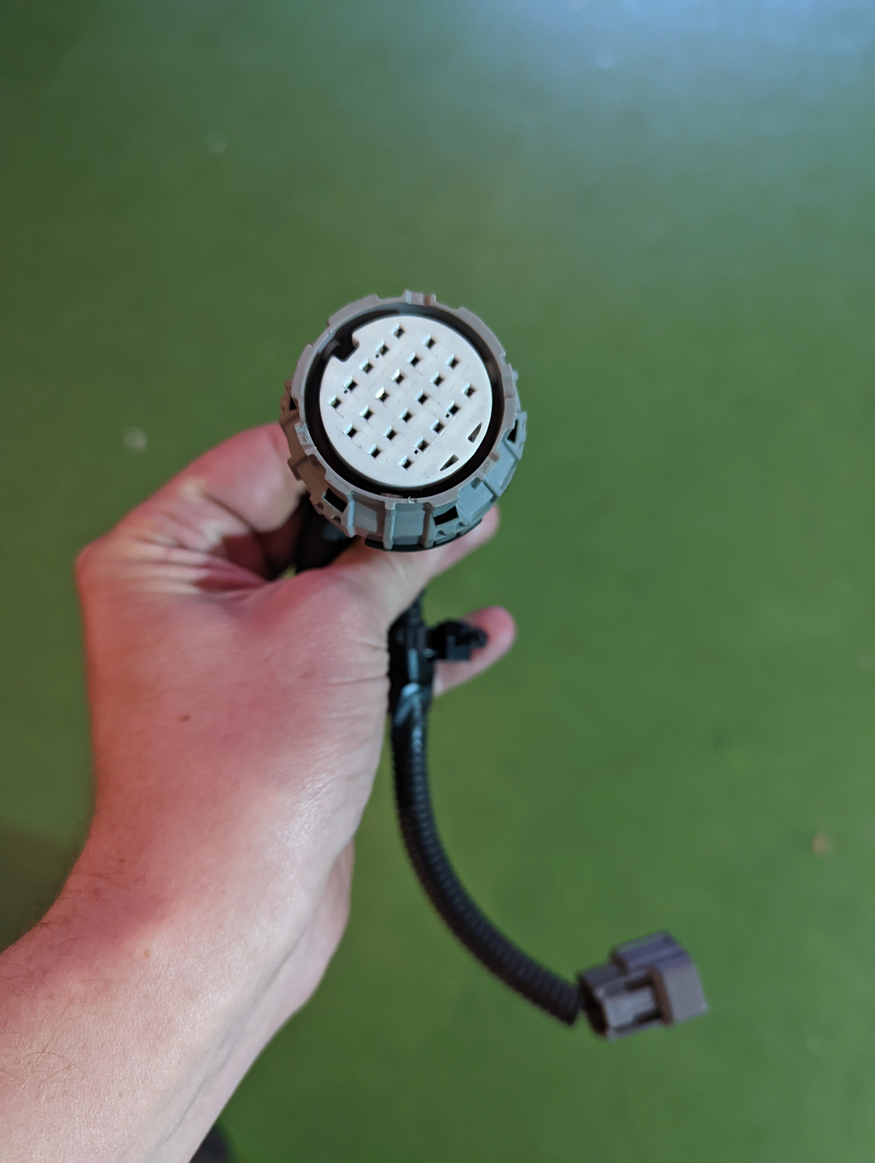

Post by Zapatero »

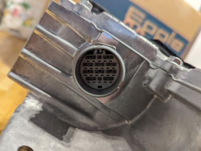

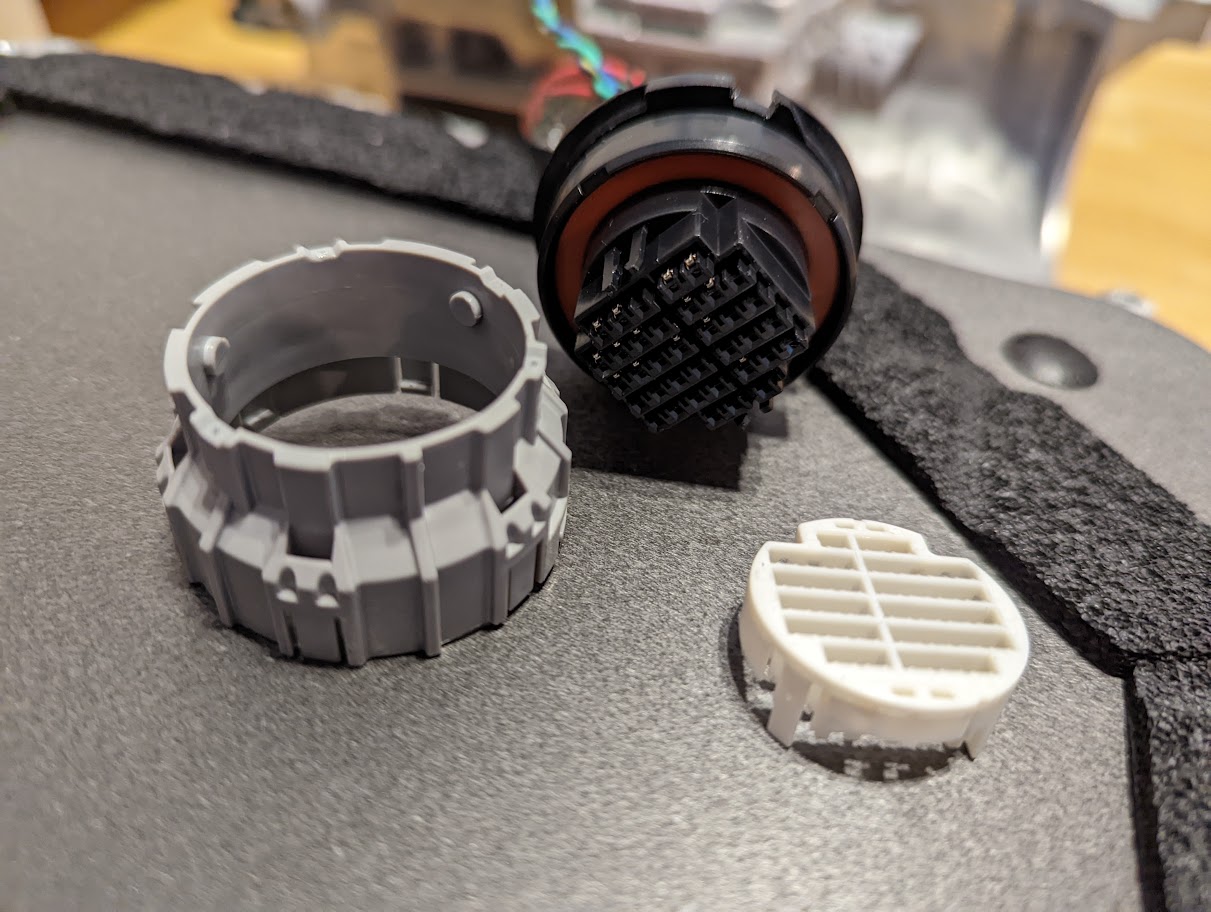

I ordered this Plug and tried to plug it in on the inverter - it does not fit!
Are there any alternatives?
Alibro
Posts: 981
Location: Northern Ireland
Has thanked: 368 times
Been thanked: 221 times
Re: Nissan Leaf Gen3 inverter
Post by Alibro »
Zapatero wrote: Wed Sep 21, 2022 6:54 am I ordered this Plug and tried to plug it in on the inverter - it does not fit!
You could approach Dave at South West EV (on Youtube). I know he cooked his old inverter and bought another so might have a spare connector or Dala.
I noticed before the HV battery connector is different to the inverter connector even though they look the same.

Zapatero wrote: Mon Sep 19, 2022 7:52 pm I received two inverters, one 160Kw and one 110Kw
Do you think the flash could be coppied from the 160kW inverter into the 110kW? :)
Posts: 990
Has thanked: 168 times
Been thanked: 349 times
dam it! dose part of the assembly fit? is it the key way or are the pin location different ?
Zapatero
Posts: 445
Location: Germany, Ulm
Has thanked: 25 times
Been thanked: 42 times
Post by Zapatero »
Except for the outer ring the amount of pins and the distance between them is totally different!
