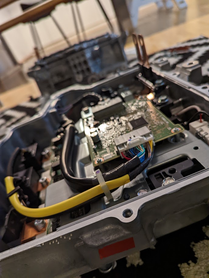

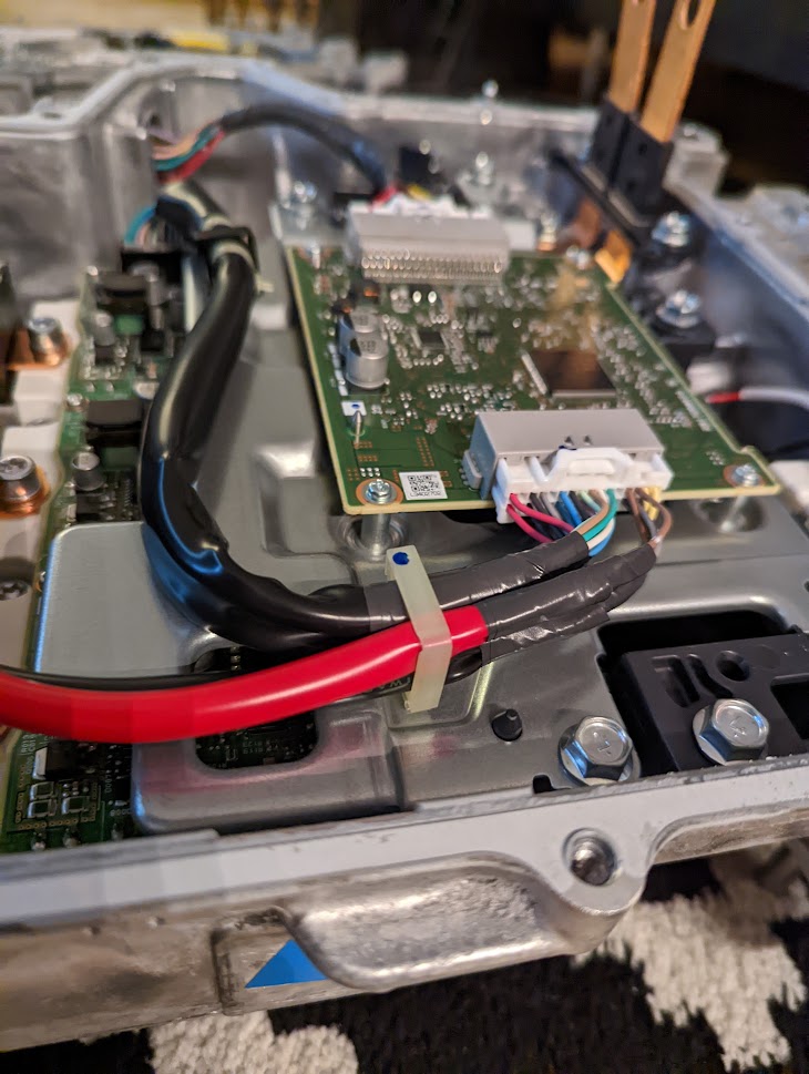

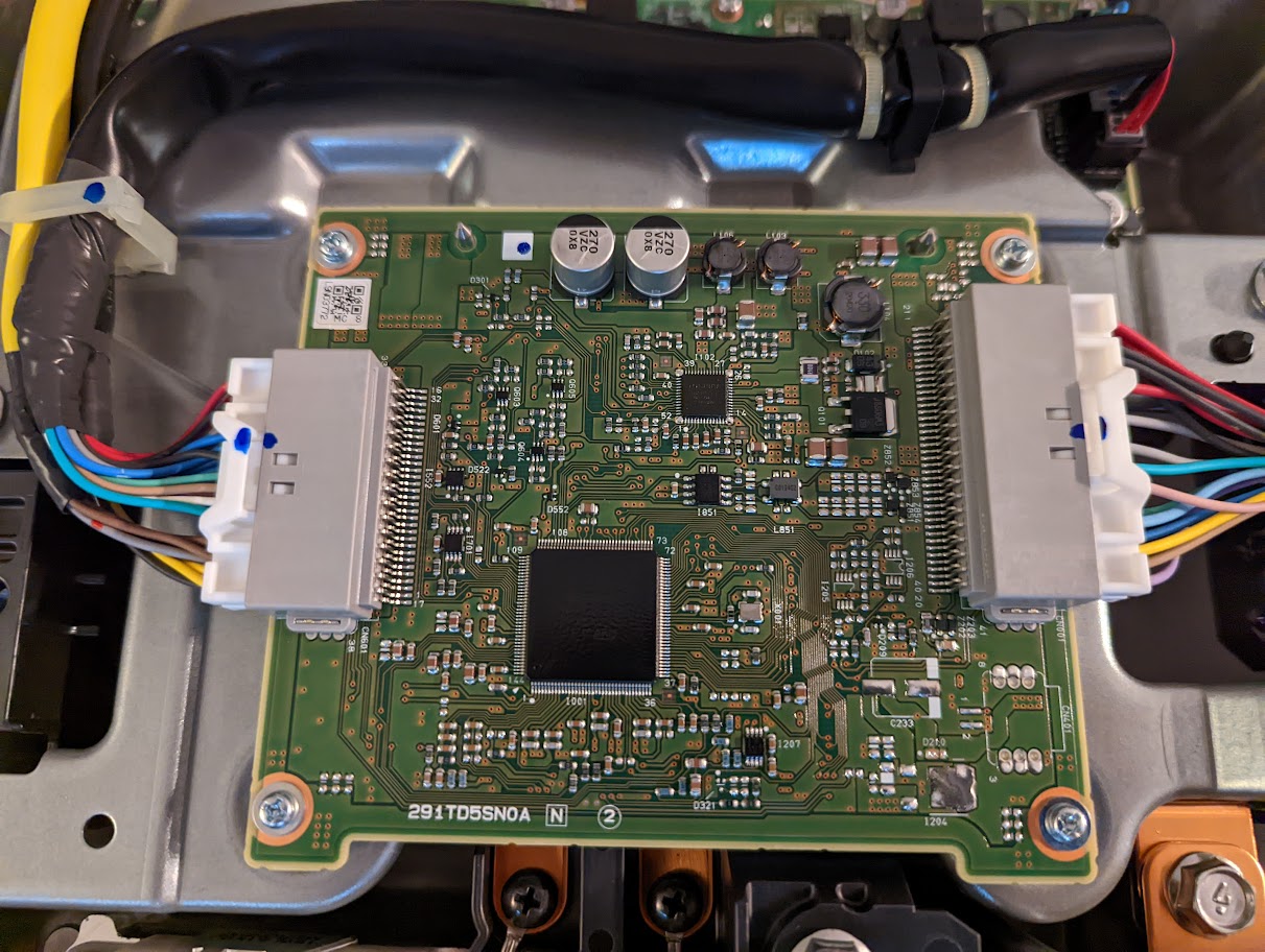

Post by Zapatero »
I received two inverters, one 160Kw and one 110Kw
I opened both Inverters, one is 5WK0A which is 110 Kw
the other one is 5SN0A which is 160Kw and one 110Kw
As stated before they are the same except for the main board!

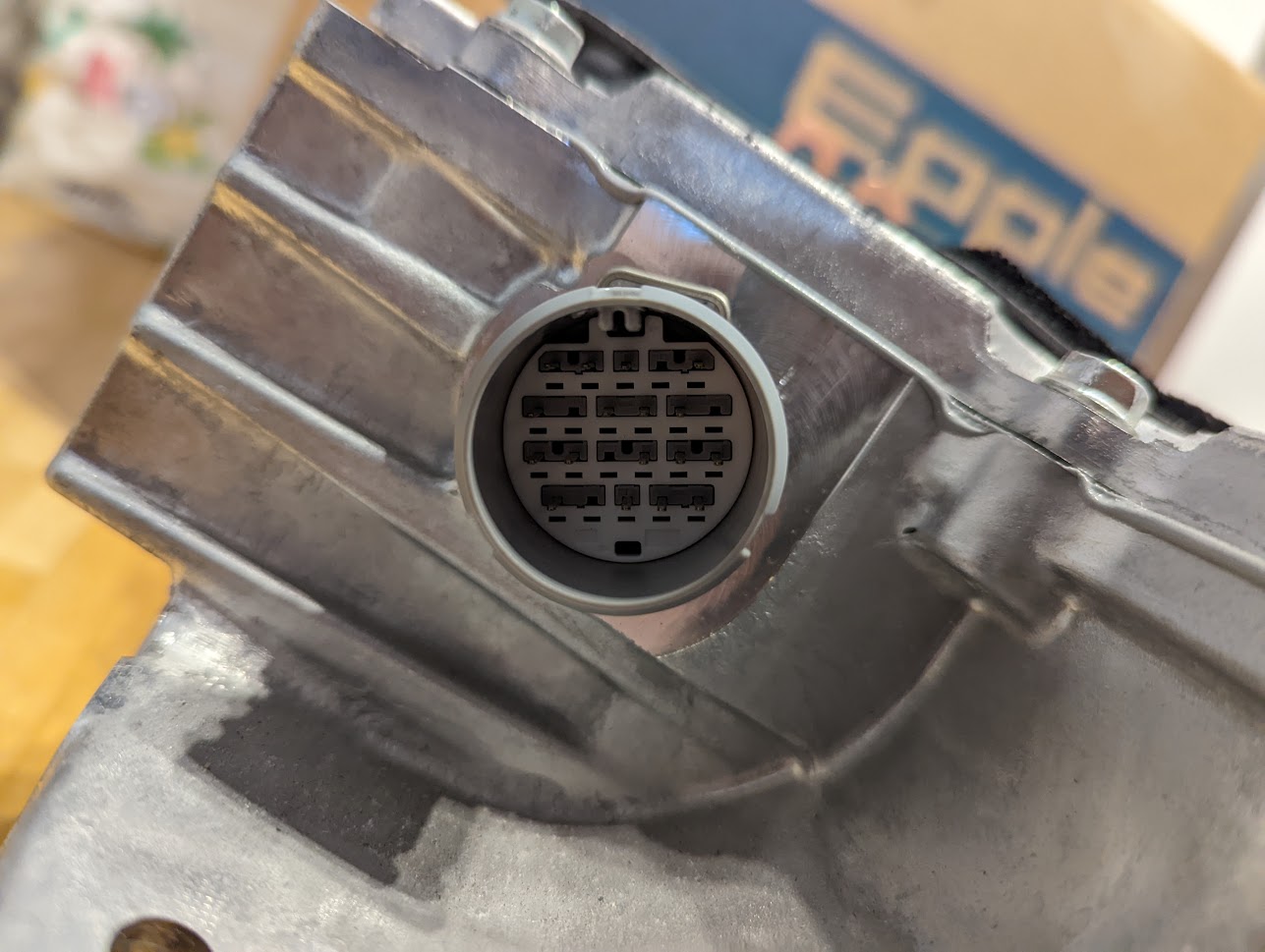

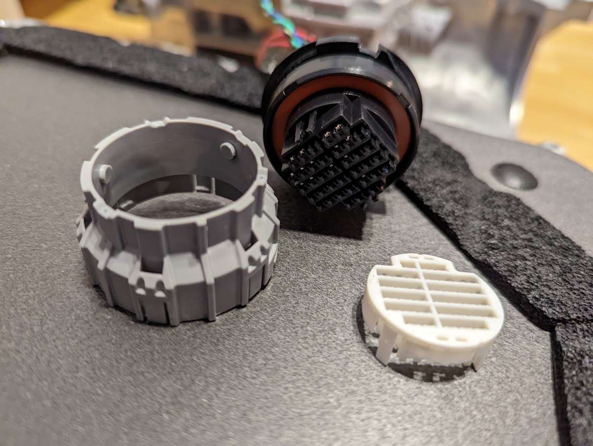

Post by Zapatero »
I ordered this Plug and tried to plug it in on the inverter - it does not fit!
Are there any alternatives?

Zapatero wrote: Wed Sep 21, 2022 6:54 am I ordered this Plug and tried to plug it in on the inverter - it does not fit!
dam it! dose part of the assembly fit? is it the key way or are the pin location different ?

Post by Zapatero »
Except for the outer ring the amount of pins and the distance between them is totally different!
