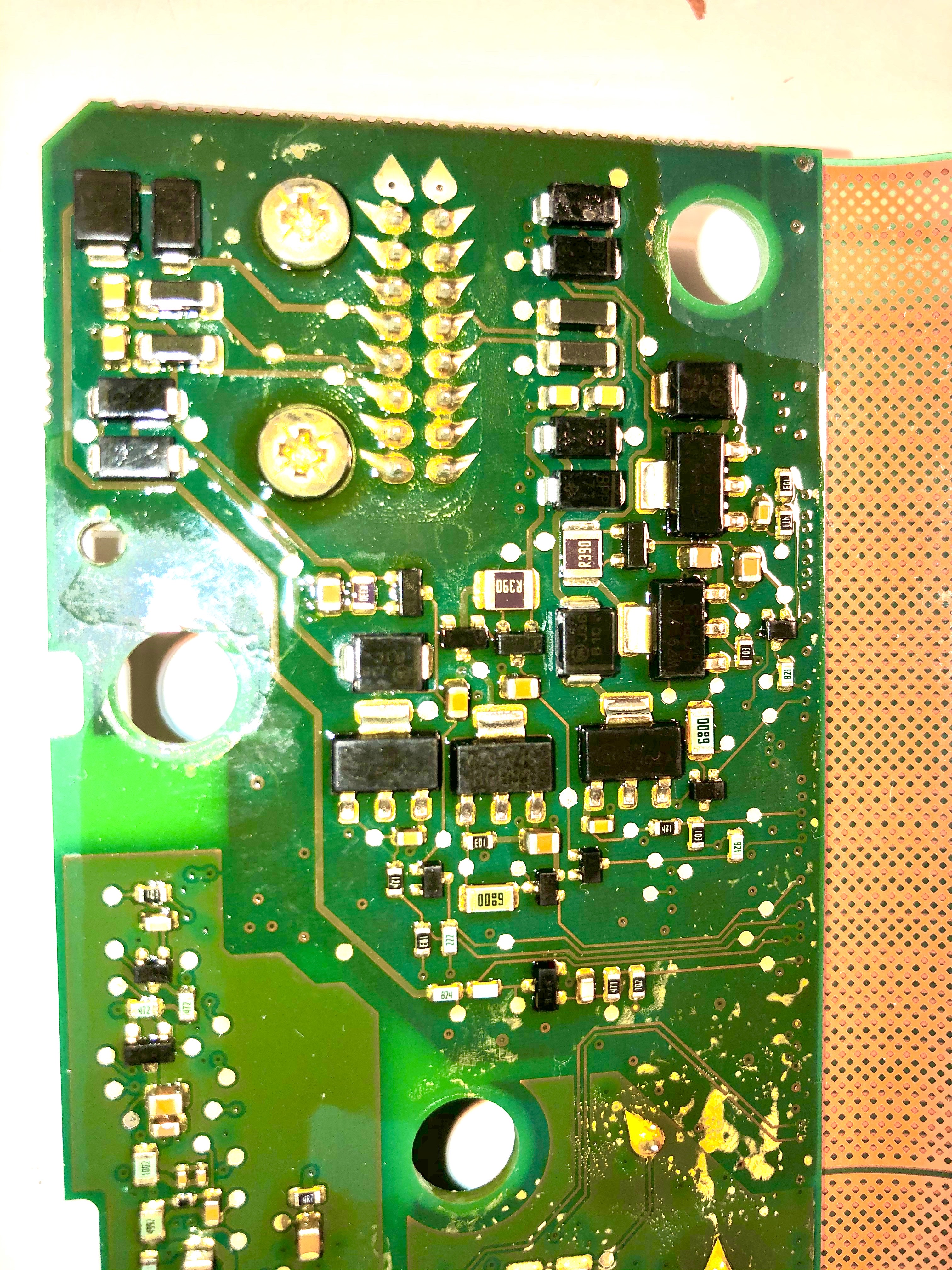

My plan was to trace the mosfets and high side transistors that drive the three contactors as in the photo and find the microprocessor connections. Break these, solder in flying leads suitably secured and drive with the Teensy via SimpBMS - modified. Its not that simple though because some of them need high and low sides driven so may need some additional electronics if I run out of pins on the Teensy 3.2. Seems a shame not use the electronics that is robust and appropriate for the contactors and also the connectors etc. There are uncoated test points on the PCB so I'm hoping I can solder directly to these and just remove a few resistors to break the connection to the main micro.bobby_come_lately wrote: ↑Thu Nov 12, 2020 3:02 pm How are you driving them? Or are you doing it manually for now?
Anyone tried that? Otherwise, I'll just connect with external mosfets to SimpBMS in the normal way.
Has anyone worked out a schematic for the sbox pcb?
I have made a little progress, if you send frame 0x300 with the first byte set to 0x9f (rest of bytes to 0xFF) it will turn "ON" the small blue relay on the PCB. It makes a very quiet, but nice noise.... (sending 0x5F turns it back "OFF")
Anyone worked out what is does? I wonder if it selects the voltage measurement between pre-fuse and post fuse. Looks like i might have to draw the schematic out.

Hi pilt, interesting. That is a 1kV instrumentation read relay. One end seems to be connected to the 5 pin ICs on the board above which I can't identify (opto isolators maybe) and the other end to the blue capacitor and 10 leg transformer (?) below it across the isolation space. I wonder if it is something do to with the "Monitoring the high-voltage electrical system for insulation faults" test?
May I ask, what techniques did you use to find that function? I'm keen to learn. Thanks!

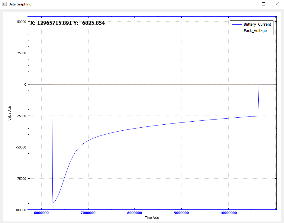

This is preliminary but seemed to work out for turning ID220 in to volts:
With parameters:Code: Select all
//ID220 DC Bus Volts pure a=((float)(256*(int)(canMsg.data[2])+canMsg.data[1]))/256.0*p1; b=(((float)(canMsg.data[0]))/256.0)*(p2/p3); c=(((float)(canMsg.data[6]))/256.0)*(p4/p5); volts220=a+b+c;I'd be really grateful if others could try that and validate or adjust. Those parameters seemed "plausible" so hopefully that is about right? I'm new to this CAN reverse engineering.Code: Select all
float p1=64.0; float p2=p1; float p3=256.0; float p4=p1; float p5=1024.0;
Attached is my spreadsheet of working out the above from the raw log if that is any help to validate what I found. This has all the IDs logged, but only calculating on ID220.
I used a UK mains rectifier and high voltage capacitor to charge up to 300VDC and let it discharge through a resistor, then disconnected it when I saw 15V on my meter so I had known voltages in the log to compare to.
I connected up my Sbox to the pack last night to see if i could check the voltage reading. In my box, it appears the voltage reading is stored in CAN message Ox210 byte 0 to 3.

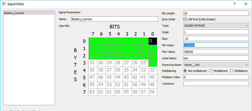

Conversion is:
byte[3]<<16 | byte[1]<<8 | byte[0]
So in my case:
210,false,Rx,0,8,AD,62,04,80,05,D1,23,BA,
becomes: 0x0462AD = 287405
scaling is 0.001
giving 287.405V
WIth my fluke multimeter i measure 287.5
Your scaling to voltage from 0x220 cannot be quite correct as you use a byte from byte 6 as well as 0,1and 2. In the CAN standard, if you look at how a .dbc file is created, signals are only placed across sequential bytes.
What tool are you using to view the CAN messages? I can post up a .dbc file with the conversion defined and you should be able to test it at other voltages to confirm?

This was connected to the battery pack, so 0x210 must be battery pack voltage as my contactors were open. I have not got them to close yet, so 0x220 must be post contactors.
Anway I have made a .dbc file that contains this info. As of yet current scaling is not clear.
I have also found a bit in message 0x510 that shows the status of the KL30C (contactor supply on pin 14)

Pilt, I have been able to get to what seem to be correct current measurements using these dbc settings, building on from your work and shared dbc file:
Needed a bit length of 25 and signed integer. I've tested to almost 100A and -100A with my PTC heater rig and is accurate against my multimeter at +- 10A. Very happy with that. Thanks for your help pilt.
Some progress!
Some progress!
