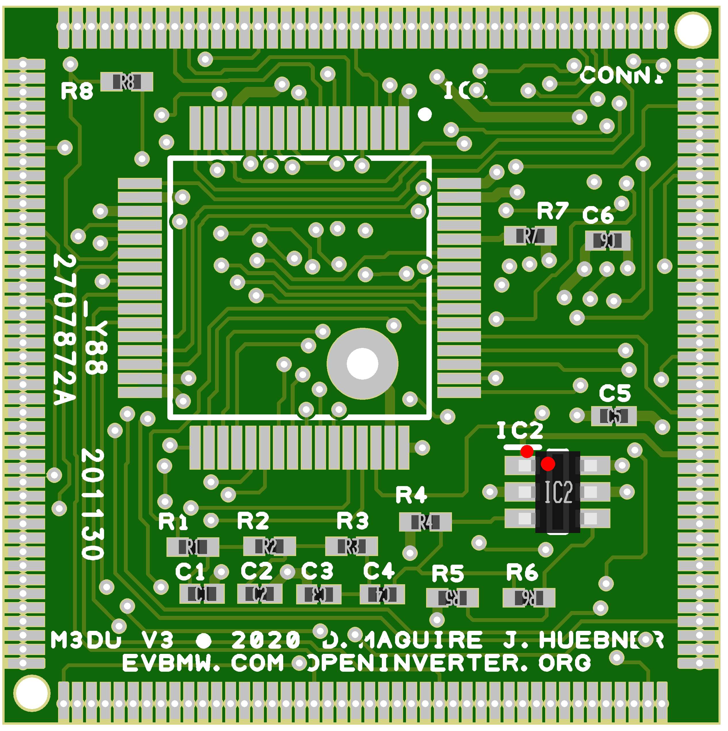

Ahhh so are indeed making a drop in Johannes on the m3 mcu footprint. Wifi breakout to the jtag connector?

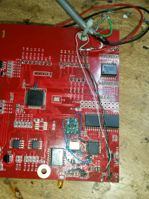

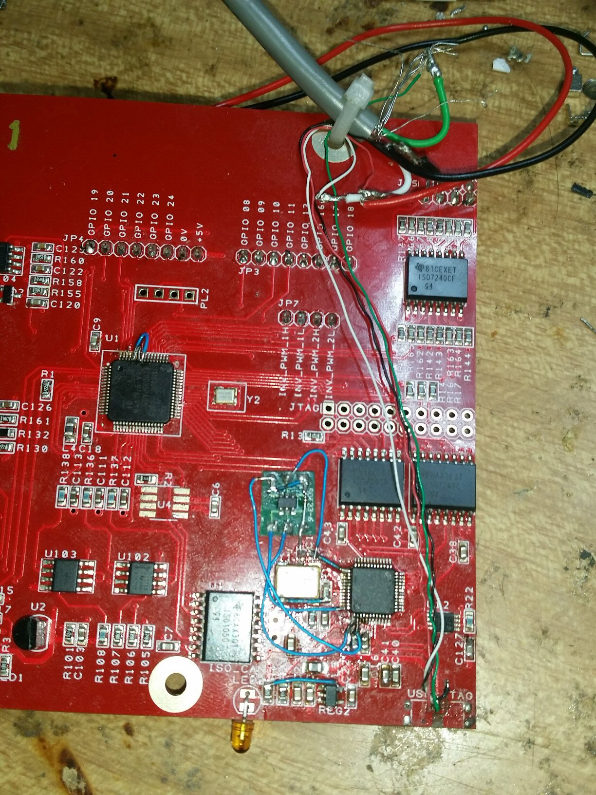

Ah it looks like I went to all the trouble making this Isolated JTAG programmer (with optional C2000 processor) for nothing!
Ignore all the bodge wires, I redid the power planes one too many times, dropped a few connections, and couldn't get the correct crystal, and the USB socket stucks. Only joking, I was making this board anyway for one of my projects, it's actually the TMS320F28035 the MCU used in the Model S.
Still want to make a version with the F28379D, or the '77D, but that's going to be a while.
If Elon's getting blasted with hotair anyway, think I could get him in the mail in an antistatic bag ?
Still want to have a go at reprogramming him to take funny cat photos or something.
