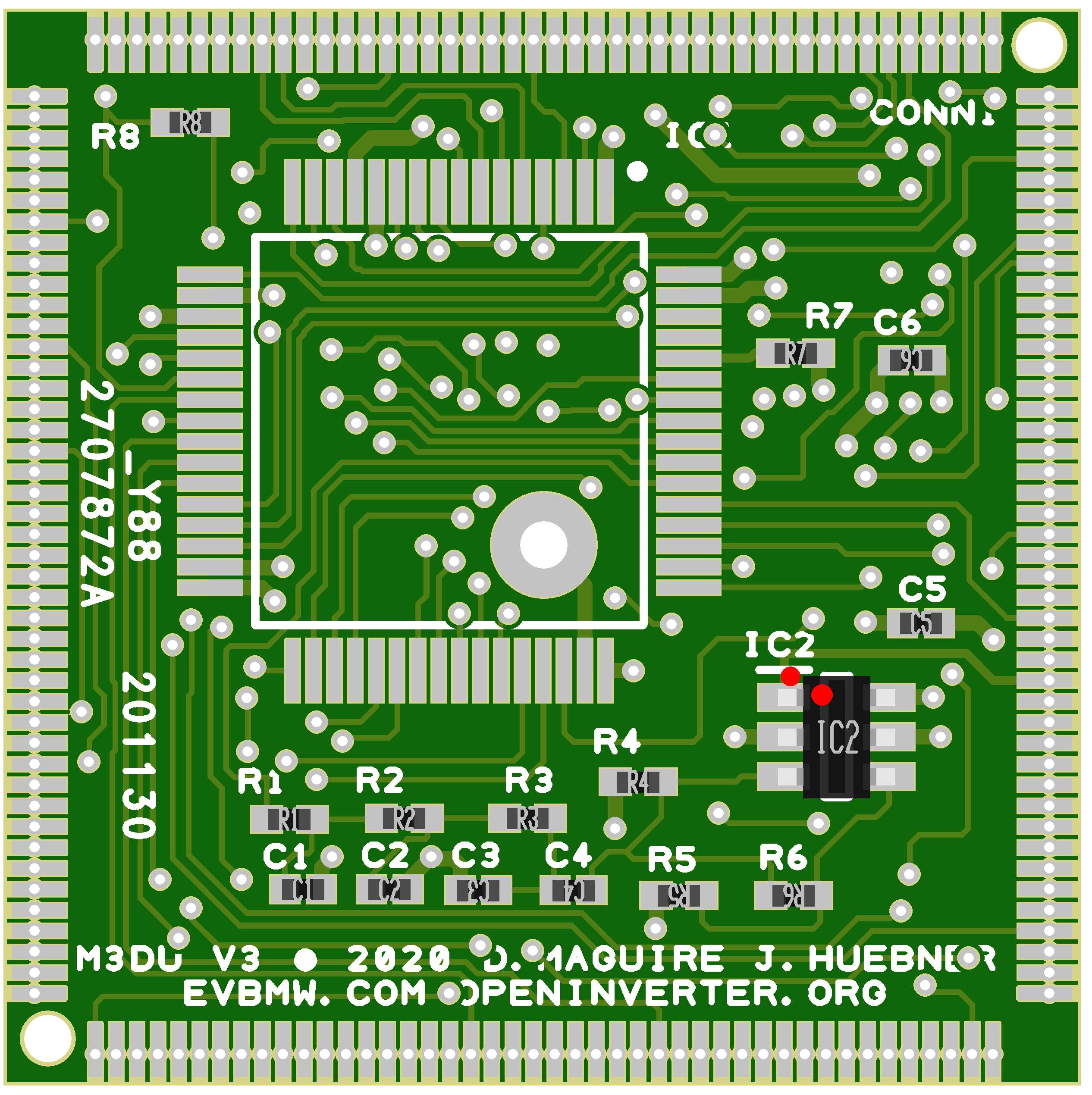

Or maybe just a legged board with connector? long enough that you can solder the pin to the old IC pad?
Did you consider this? or do we need every other pin pulled-up anyway?

Ahhh so are indeed making a drop in Johannes on the m3 mcu footprint. Wifi breakout to the jtag connector?
