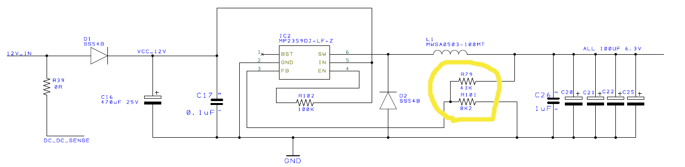

-5v should be around -4.8 to -4.9 range both on and off load.

My 5v line is down at 4.2v also, so that'll explain the -5v been off.
My 26v is 25.6v
My 3.3v is 3.28v
So they look good, I'll try and investigate the 5v later.

The resistor divider for the 5V regulator seemed to be off on my Prius gen3 V1c board too. I think it needed a slighly smaller value in place of a 8.2k resistor. If I recall correctly I paralleled it with a 82k one and the resulting voltage was close enough for me.
The board seemed to work fine without that mod though.

Yeah now that I look at the schematic, it looks like Damien has some fixing to do on the V1c board.
EDIT: Or maybe not. I just deleted this paragraph because I just wasn't sure anymore. :mrgreen: Check for yourselves.
EDIT: The datasheet seems to indicate IC2's feedback resistors 43k and 8.2k in the schematic are correct for 5.0V output. Does the board actually have these values or something else instead? E.g. if the board has 43k and 10k those would make 4.3V output, and that would match with my fix of paralleling the smaller one with 82k to increase the output voltage. This means the schematic is right, the board is wrong, and that could mean Damien ordered it wrong or JLCPCB put the wrong part on it.
Posts: 4006
Been thanked: 1135 times
Damien ordered it wrong and explained that in the video. The 10k resistor needs to be changed to 8k2 for this batch of boards which I just shipped the last one today so next batch will have this correct.

So I was just writing a post about this before I saw your latest message. Thought I'd check the values on R79 and R101 per the diagram below.
On my board:
- R101 is labelled '1002' - so yep, 10K
- R79 is labelled '4302' - and yep, 43K
I get about 4.4V from SW, which then drops down to the -4.06V when it is inverted.
BTW - had seen that in the video but didn't realise it applied to my board. My bad.

I've updated the wiki with this info. I've got 100 of the 8k2 0805 coming if anyone in UK needs a couple throwing in an envelope.
