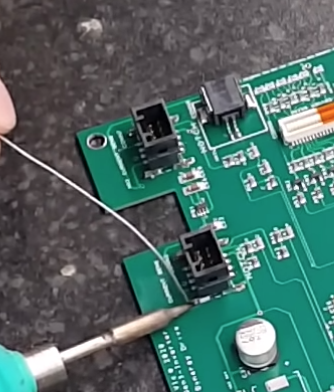

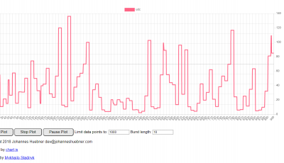

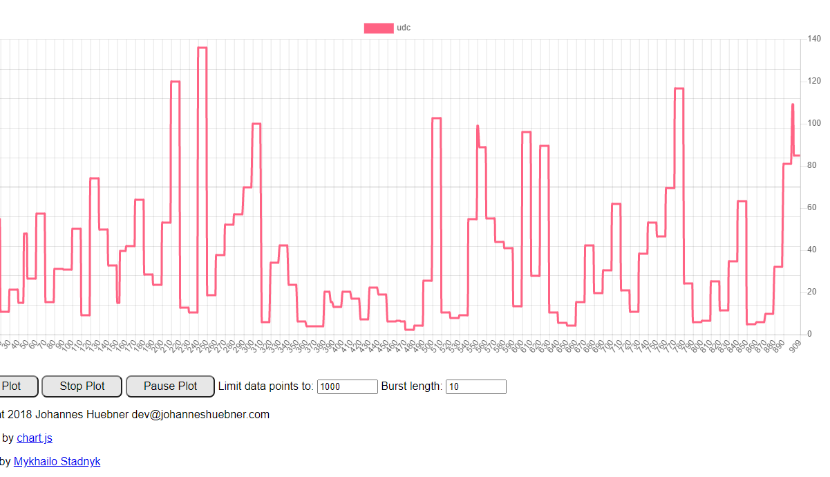

- bobby_come_lately
- Posts: 486
- Location: Manchester, UK
- Has thanked: 56 times
- Been thanked: 63 times
Just got my board back from a local electronics engineer who has been over the board and sorted out the dry joints (he confirmed one on the 50 pin connector). I'm as confident as I can be (having not done the work myself) that that's no longer the issue. But I'm still struggling.
Most basic symptom is that udc is still swinging around all over the place, as you can see from the chart attached. This is with 20V coming in and udcgain set to 4.65. Really appreciate anyone's thoughts on what might be going wrong and whether I've done something really stupid.

- Posts: 1884
- Has thanked: 91 times
- Been thanked: 517 times
I fluxed it up, then dragged solder across the pads with a flat tip then went through the pins one by one with a fine tip.
- Posts: 4007
- Been thanked: 1136 times
udc should be very stable. Have you checked your -5v power supply?

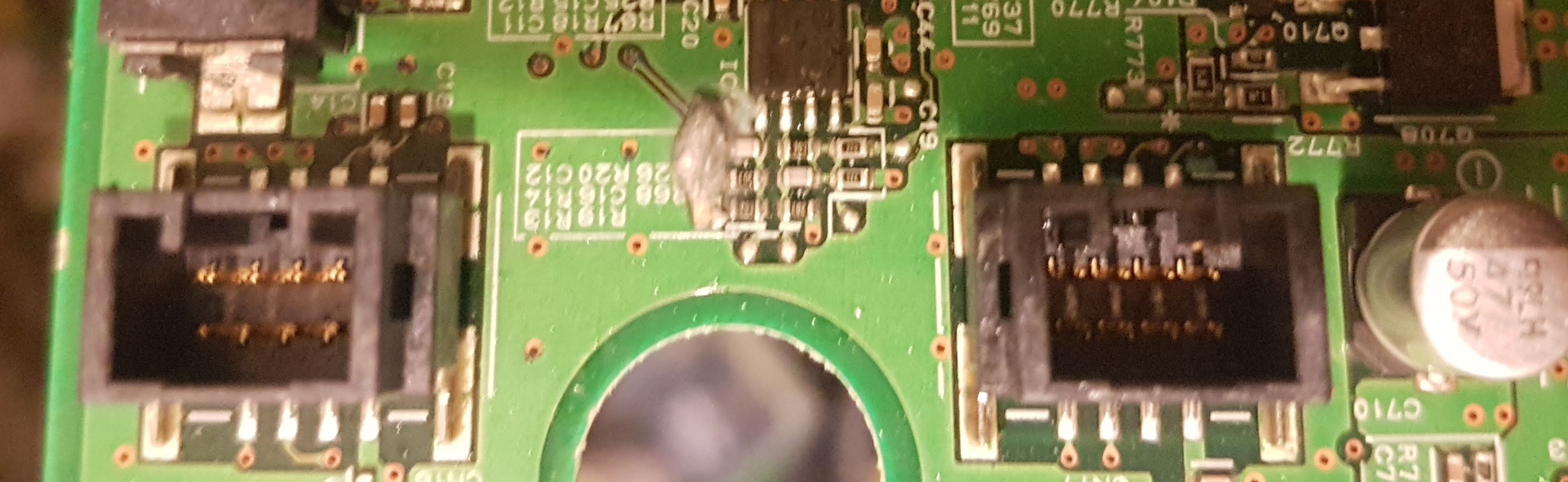

Right, fresh head this morning. I went through the schematics and the layout and traced the path of the DC bus connection from the Toyota board through the 50 pin connectors, to the ADC on the chip. That does not seem to be the issue.
BUT, when I check the voltage coming in to R76, it is all over the place.
Does this suggest there is something wrong with my Toyota board?
Or is this a product of that -5v reading being low?

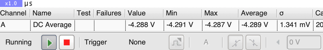

Update: ordered another inverter for testing. Paid a little over the odds but desperate to get this working.
I'd appreciate some feedback from anyone with the board running on what voltage they see at -5V via.
- Posts: 1884
I'll get a measurement for you tomorrow.
Edit, attached. This is a board but not connected to an inverter.
