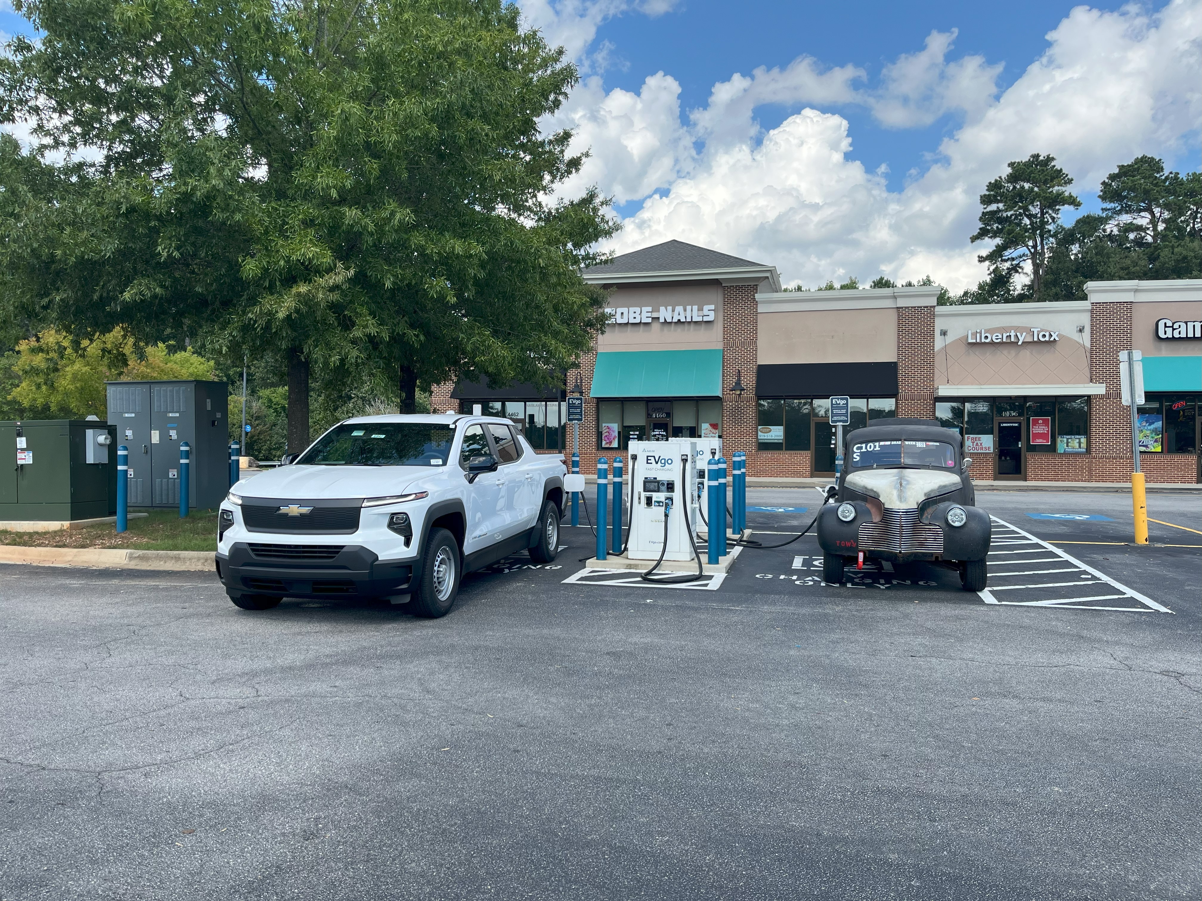

Saturday evening I went out for a cruise, and tested on two more CCS stations; an Electrify America and an ABB at a Nissan dealer. Both worked flawlessly, though I need to make some changes to my charge curve - it ramps down way to soon and way to far. Hoping to get to that this week and keep testing next weekend.
It was a lot of fun to get to basically play with the car. It was still a bit hot, but the weather is getting nicer this week. I tried to be a responsible citizen, but I did romp on the car a bit, especially when some Audi SUV thought they were going to pass me, and when I happened to turn alongside a Mercedes EQS. It is so much fun to be going 45mph and then all the sudden be doing something that starts with an 8. I love driving this thing.

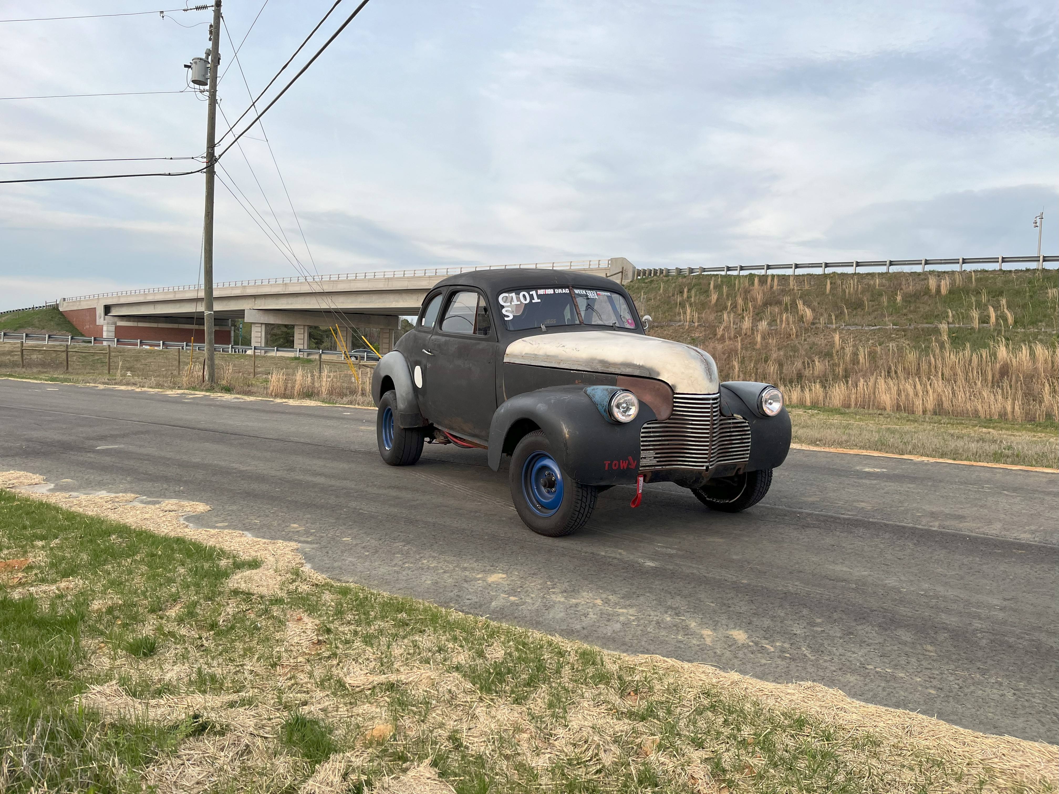

I spent all afternoon and evening on Saturday playing with the '40. This included charging testing, efficiency testing, acceleration testing, and simple cruising.
First, I tested my new CCS charge curve. I'm fairly happy with it, but it ramps down a bit too aggressively so I sat at 25kW and 8kW for a long time on a 100kW charger. But doing a stepped ramp worked better than a linear one, and reporting SOC in 10% intervals seemed to make the station a bit happier.
Then, I did an efficiency test. From the charger I was using to test, there's a good stretch of road that is very similar to the routes we get sent on for Drag Week (4 lane divided with stoplights every couple miles) that ends in a small downtown area about 13 miles away. So I drove there, got lunch, and drove back to the same charger, and charged to full again. In total: 27.3 miles consumed 10.235 kWh, meaning 2.67 mi/kWh or 375 Wh/mi. Assuming that the pack retains the energy capacity it had the last time I did a zero to 100% charge of 28kWh, that means a max range of 74 mi. I'm saying it has a safe range of 65 mi, given that I really don't want to push the battery that low.
I went home for a bit to handle other things, and then took her back out. First stop: acceleration testing. I remembered that the GPS speedo I put in the car has a 0-60 timer built in. Well with the "street" tune in it, which is what ran 12.1 sec in the 1/4 all week at DW 2024, it pulled a 3.47sec 0-60. And did it twice in a row.
