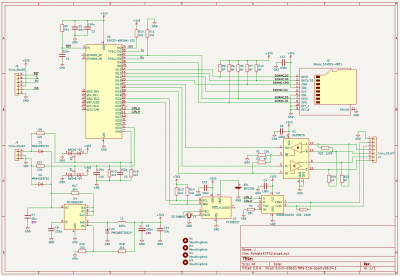

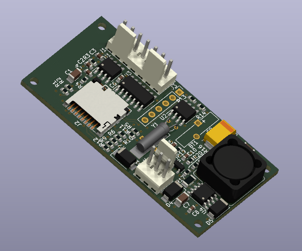

Re: Smart Roadster (with Prius Gen3 Inverter and Outlander Rear Motor)
Done!

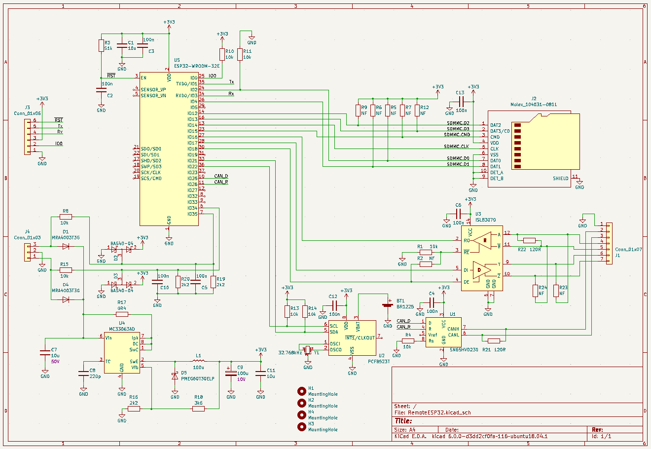

Managed to fit the CAN transceiver on plus two extra connector pins so both CAN and RS485 can be fitted and used at the same time. The CAN is connected to ESP pins IO25 (D) and IO26 (R). From what I can tell the CAN lines are are routed through the ESP's IO matrix so any pins can be used but won't know for sure till it's tested - if anyone knows whether this is the case or not please let me know.
Also managed to fit four mounting holes on
So, PCB's ordered
Although can't believe that you don't seem to be able to combine shipping on multiple boards at JLC
(or am I missing something?)

So a package from JLC turned up today, I thought great, I can build up the first PCB
Turns out that they can combine postage as it turns out that this package was both the solder mask stencils in one box, the PCBs are both in another box that isn't getting here till Monday
So the PCBs have turned up and all look ok, hopefully start building them up tomorrow

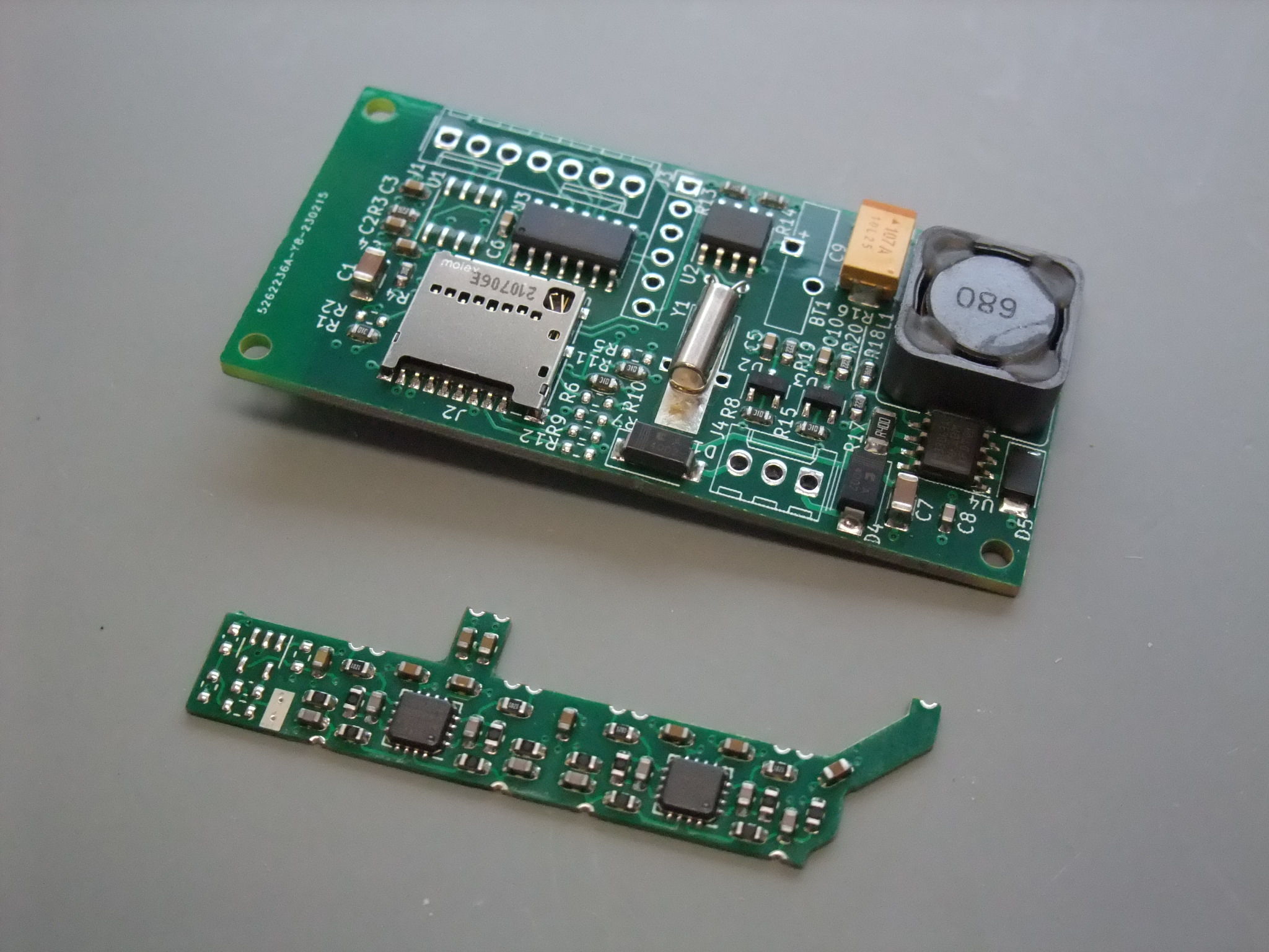

Boards built
The small one was a real fiddle to put together, my eyesight isn't what it once was!
Not tested yet. I've also realised I don't have a 3V3 CAN transceiver for the ESP board but can still see if the rest works.
3D printer has also arrived, not unboxed yet though and the filament won't be here till next week.
Edit - I'll start another thread to cover the ESP board (with links to all the data) once I've checked it works!
Edit2 - Just un-boxed the 3D printer, calibrated the Z axis, loaded the filament and had it do the demo print (simple cube model that comes pre-installed); in total took about an hour. So far can't fault it. I was expecting a customer return based on price but it looks like a brand new unit. Everything seems to work and the quality of the first print is surprisingly good. Still need to try it with ASA filament (which is due next week) but at the moment I'm well happy with it
ESP32 board now tested and seems to be working.
Couple of slight issues. First I managed to order the 250kbps slew rate limited RS485 transceiver chip for it
so it's not too happy running at higher baud rates. A 20Mbps version is available and the schematic has been updated to reflect the correct part.
Secondly the SDIO interface for the SD card conflicts with the GPIO12 pin boot functions. Essentially the ESP32 uses a pull up or pull down on this pin to detect whether it has a 1V8 or 3V3 internal flash memory fitted and adjust its voltage regulator to suit. The pull up required by the SDIO interface is incompatible with the pull down required for the 3V3 flash on the ESP32-WROOM-32E modules. To fix you have to burn an eFuse on the ESP32. Bit of a nuisance but it sorts the issue. Further details in the github readme.
There is also a new branch in the ESP32 firmware git repo to go with it.
All further work on this board will now be in its own thread viewtopic.php?t=3361
Now that this board is working I can talk to the inverter again so the next job is to fit the mod board and see if it sorts the noise issue on the current sensors.

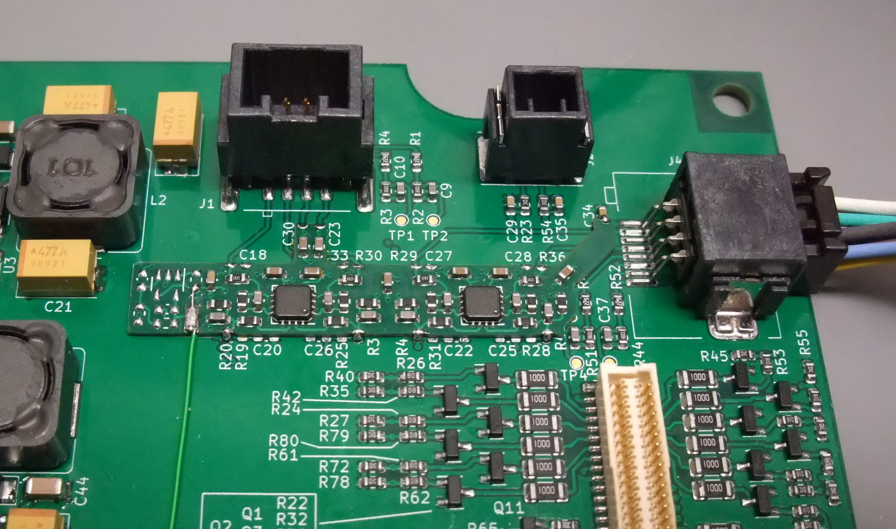

So, the mod board is fitted ..... and it works
This is what it looks like fitted to the board: Quite happy with that, should be robust enough and you would hardly notice it is there.
This is the circuit block that I ended up using (one of these per channel): The input from the CT comes in on the left and is first divided down, with a little bit of filtering, relative to the 5V rail (which is what the CT uses as its 0V reference). This is then fed into an instrumentation amplifier. Instrumentation amps are nice in that the output is proportional to the difference in the inputs, they ignore any common mode voltage. They also allow the output to be referenced to a different voltage, in this case the 3V3 rail is used (actually the VDDA pin on the processor). This means that any movement between the 3V3 and 5V rails is compensated for by the instrumentation amp. Obviously for this to work the amp has to have a bandwidth that covers the full noise frequency spectrum present on the rail and the reference line must not be filtered (so that it tracks the rail).
The above gives an output from the amp that is centred on the 3V3 rail and proportional to the CT output. To then get 0A to be in the middle of the ADC range another potential divider is used to halve the signal giving a centre point of 1.65V that is locked to the ADC reference voltage.

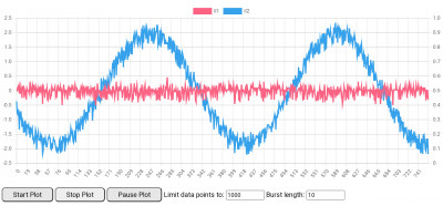

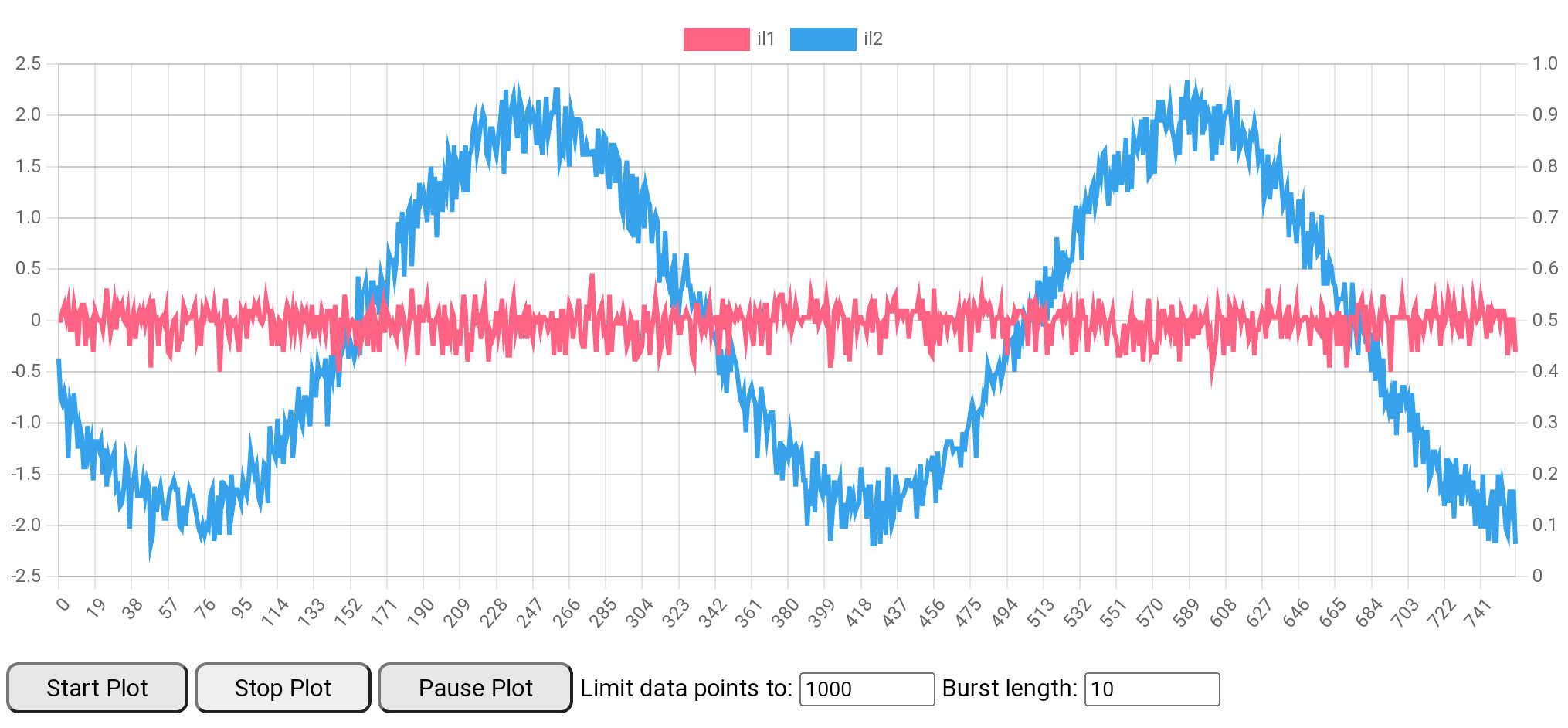

Before fitting the board I had a standard deviation on the current measurement channels of 2A, after fitting this board it is down to 0.15A!
This is what the output now looks like for a 2A peak input signal (actually 100mA x 20turns through the CT as that's all my sig gen can do): Pretty happy with that!
Note - for anyone not familiar with using standard deviation it's just a nice way to measure noise amplitude. For a random noise signal ~2/3 of samples will be within 1 standard deviation of the average and 99.9% of samples will be within 3 standard deviations. So to start with I had peak current error of 3x2A=6A, after fitting the board it's down to 3x0.15A=0.45A max error.
Edit - It's probably worth mentioning that if using multiple ADCs make sure that two different ADCs are not sampling the same channel. Initially when fitting the board the noise only went down to around 0.4A. It turned out that I was sampling the current on ADC1 as part of the regular conversion scan and the spikes generated by the ADC1 sampling capacitor charging were intermittently coinciding with ADC2 sampling and causing an error. Removing the current channels from ADC1 completely cleaned up the samples on ADC2 and got the noise down to the final 0.15A.
