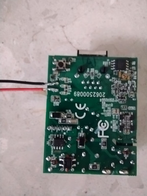

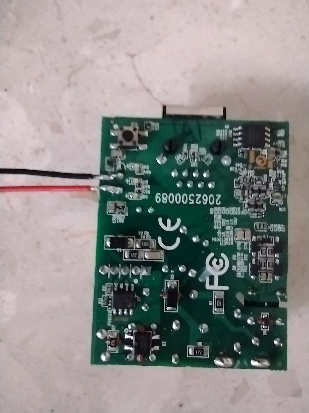

I did see some voltage on the power pins, 250V for a few seconds and soldering iron got warm. Not sure if I saw precharge or actual power. I have no port relays, maybe that's why it doesn't continue?

Also the cable check applies voltage (500V?), so it's a good idea to NOT connect a load during this. And the precharge, at least what I saw on a compleo, drives a limited current, means also here it's better to NOT connect a load during this. You could turn-on an LED or something, when the charging loop starts (the Relay-output in the software), and hot-plug your load if in the charging loop.

Both logs from today are stopping at the same step. The PreCharge is "finished" with EVSEPresentVoltage.Value": "0", and the PowerDeliveryReq runs into timeout without any response. My impression is, that very fast "finished" PreCharge is confusing the charger, so it stops talking to us. We should give the charger the time, until it really provided the intended voltage (either hardware-measured, or from EVSEPresentVoltage, or even just waiting 5 seconds inrush).

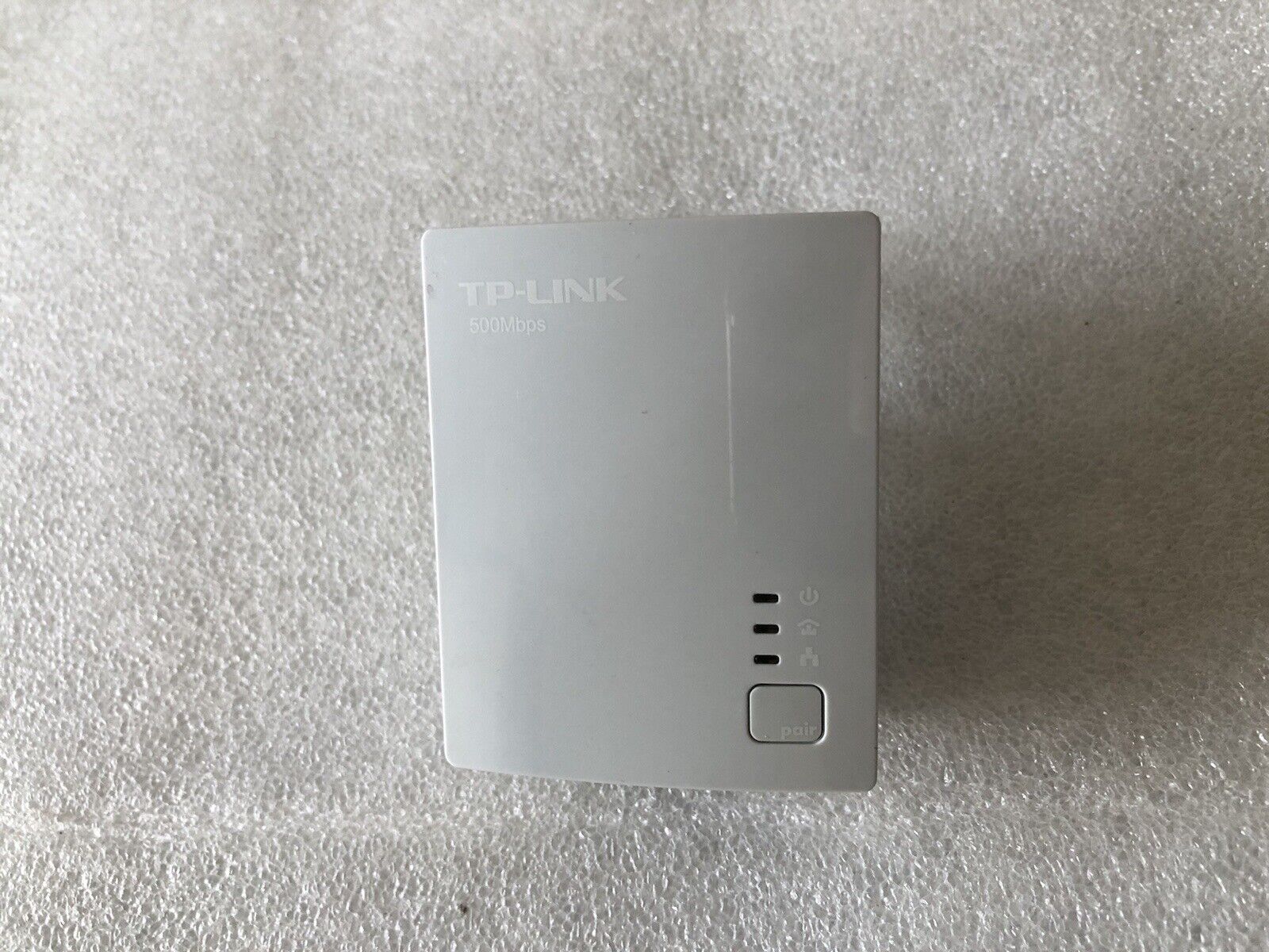

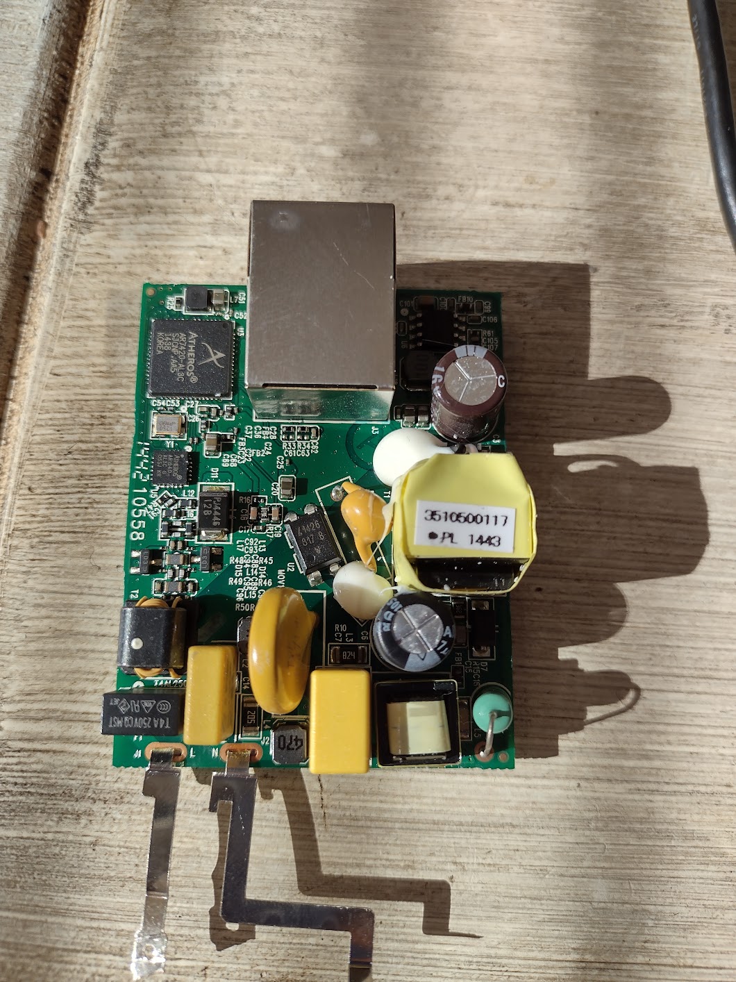

Getting in on the action with a TP-Link AV500. Board different to other's documented but has the AR7240 on there. Now running from 12V from the points in the photo
I think I've done the configuration step too.
PLC.txt
(2.77 KiB) Downloaded 409 times

Post by uhi22 »
This looks good. Looking forward to some test results, no matter whether success or fail. :⁠-⁠)
