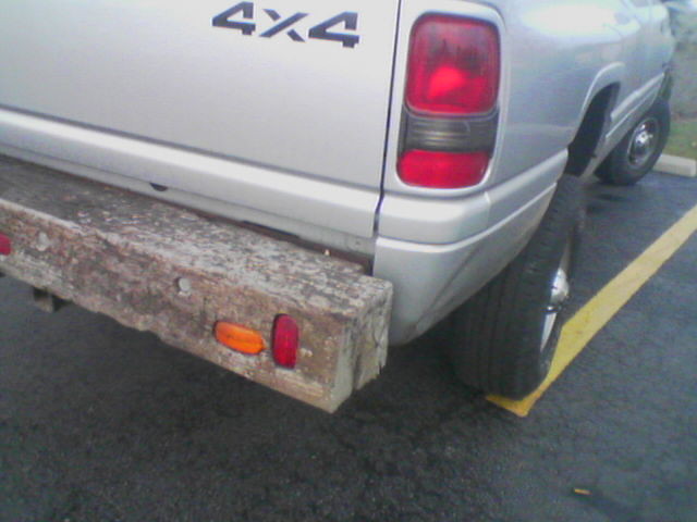

this is what comes to mind when people ask me why did I pick this truck for my EV Conversion and try to tell me how it is not aero dynamic and too heavy (for the record I did not go out a seek a 1971 Chevy truck, I already had it, and since I had like three trucks in my fleet already and was tired of doing LS Swaps, I just used the one that a dear friend sold to me and I did not have the heart to let it go)
it seems like they will bolt up and weld on all sorts of crap on their ICE powered trucks (as physics don't apply to them?!) but when it comes to building an electric all of a sudden everything has to be aircraft space age unobtainium quality
please comment and let me know if you all agree or disagree

I mean, I built my '40 Chevy because I wanted to. I wanted an EV race car, I have a family connection to that body style, and I found one cheap.
I do find that a decent amount of the objections I hear from other hot rodders are based in absolutely terrible marketing and tuning decisions by OEMs building EVs.
If I hear one more "but EVs are just appliances, electric swapping takes out the soul and character" I'm going to lose it. Yes, Priuses and Teslas are soulless appliances, but I dare anyone to attempt to drive my Tesla powered '40 for more than five minutes and tell me it's not just as much of a temperamental b!#$h as their ICE hot rod.

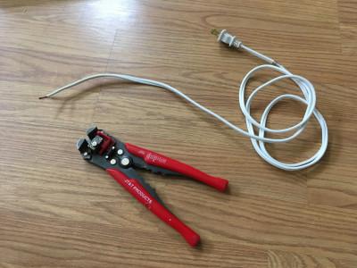

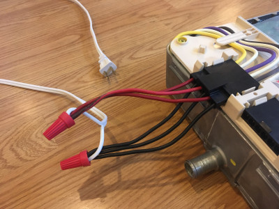

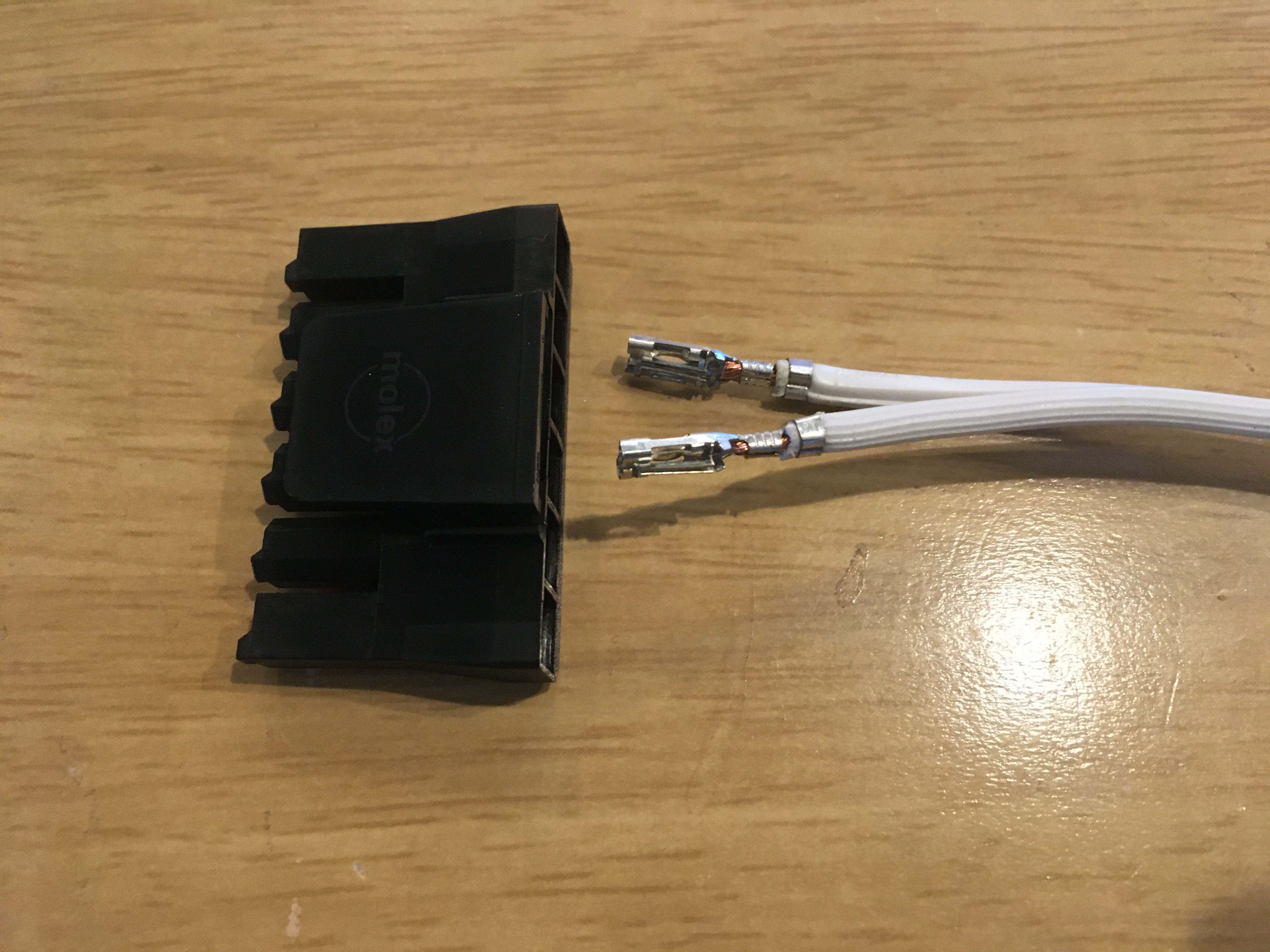

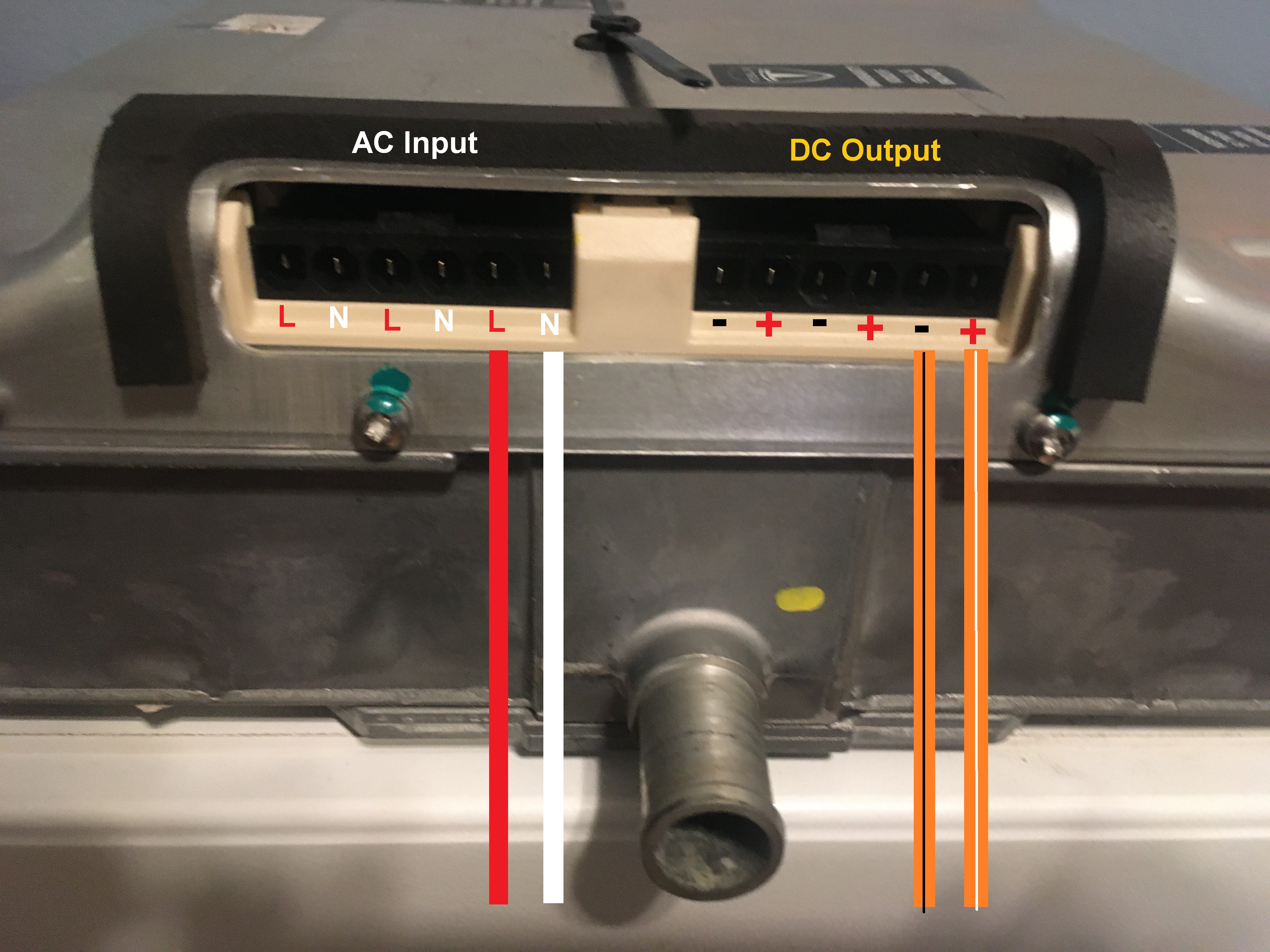

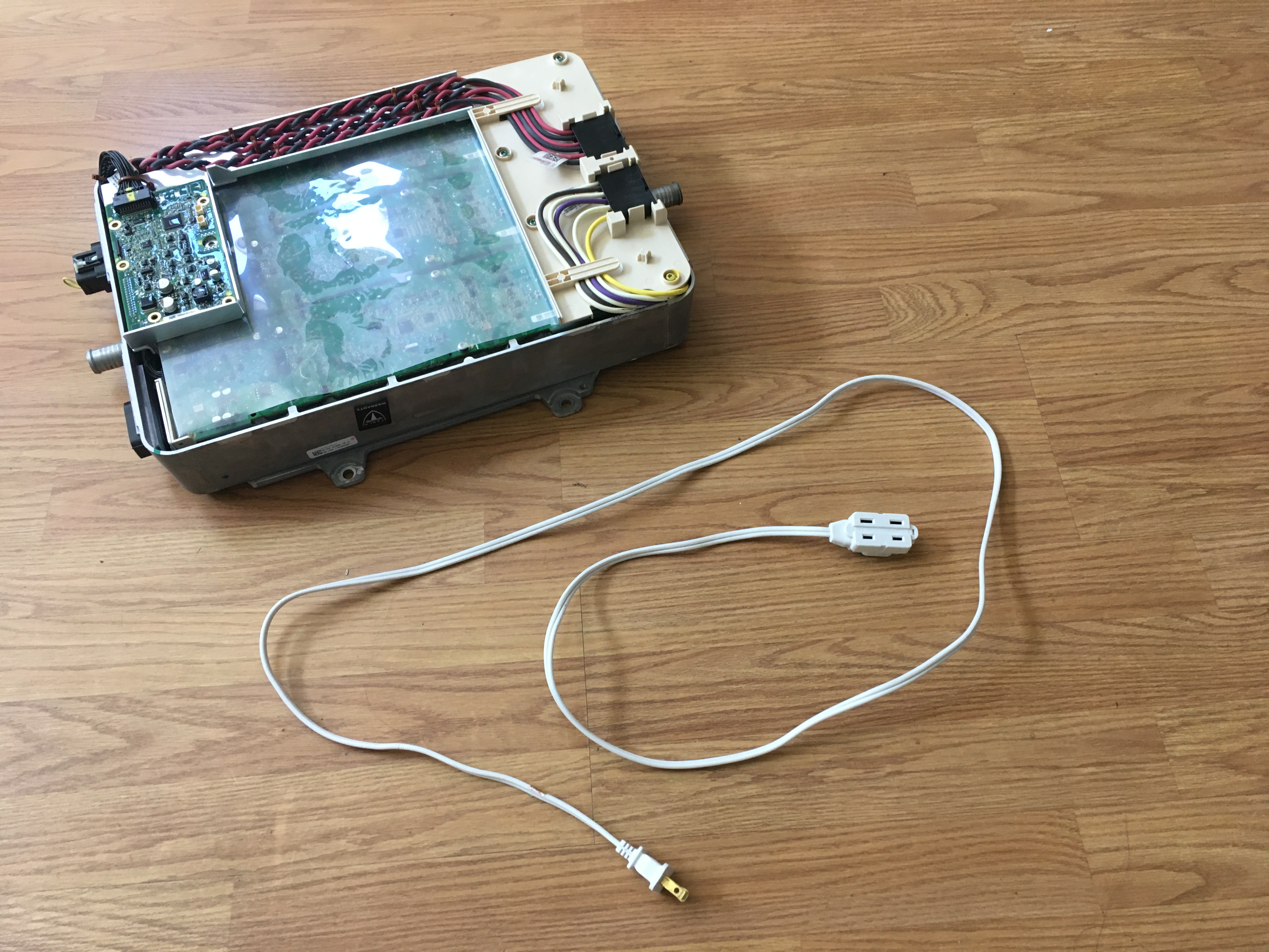

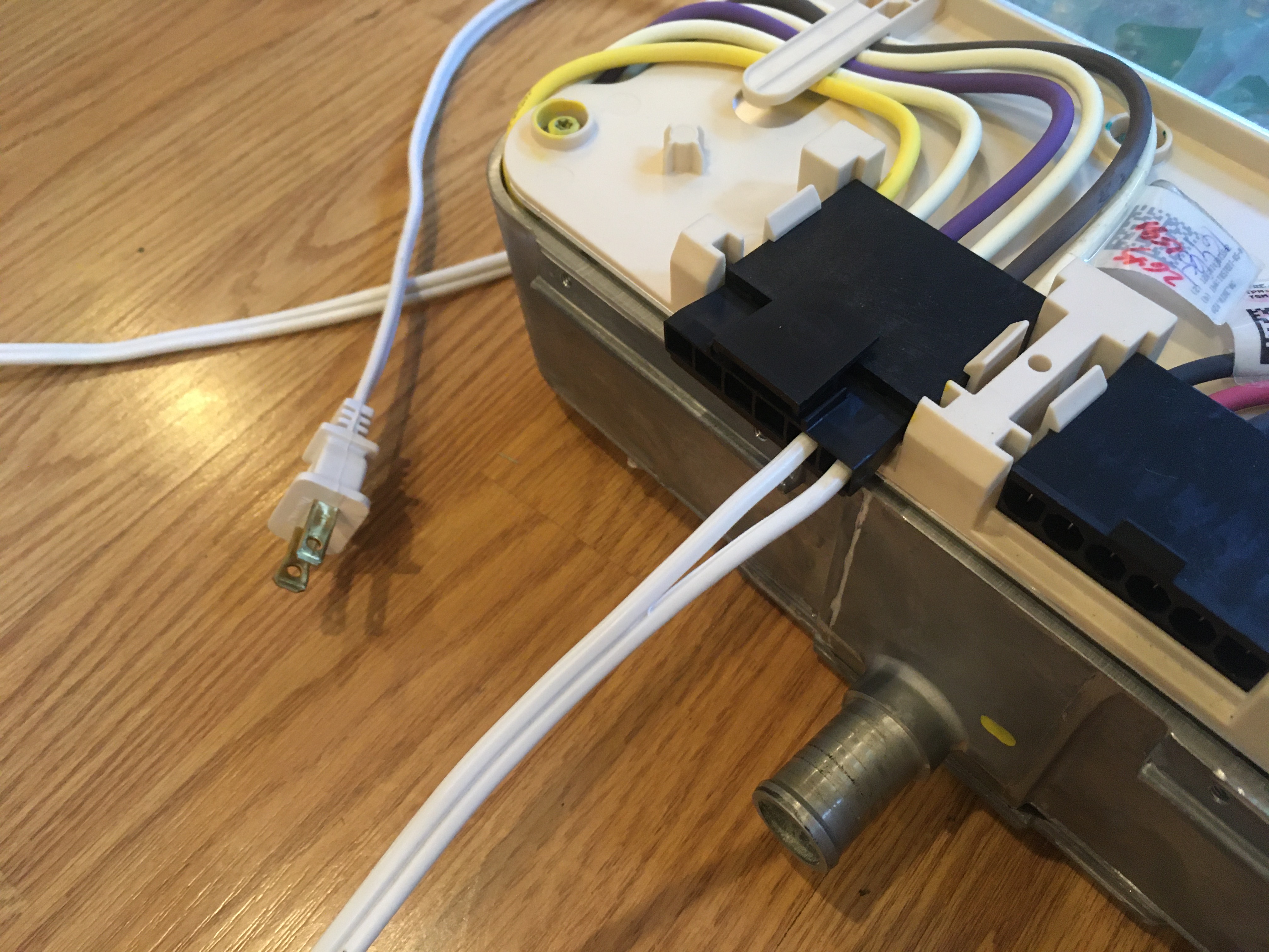

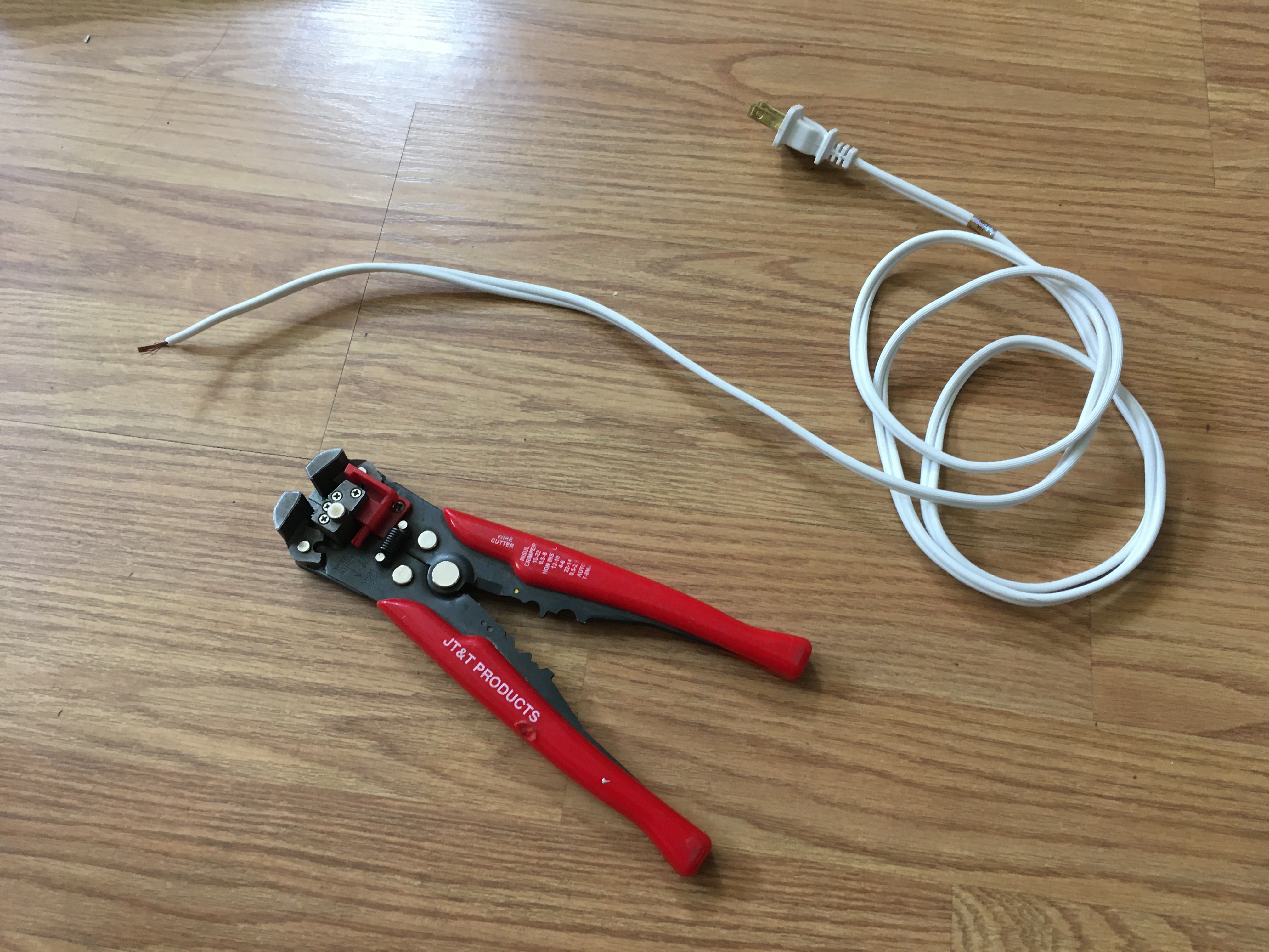

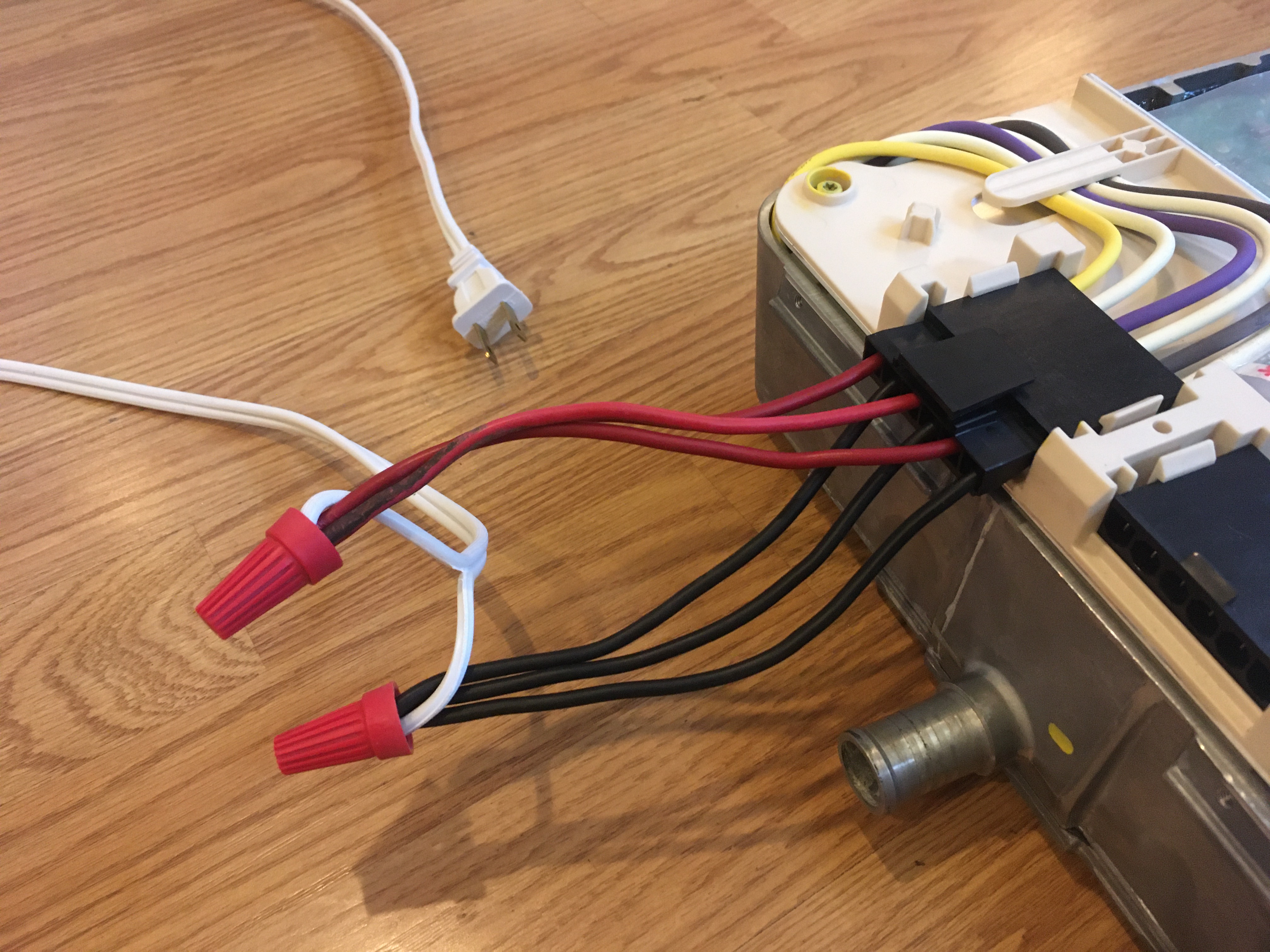

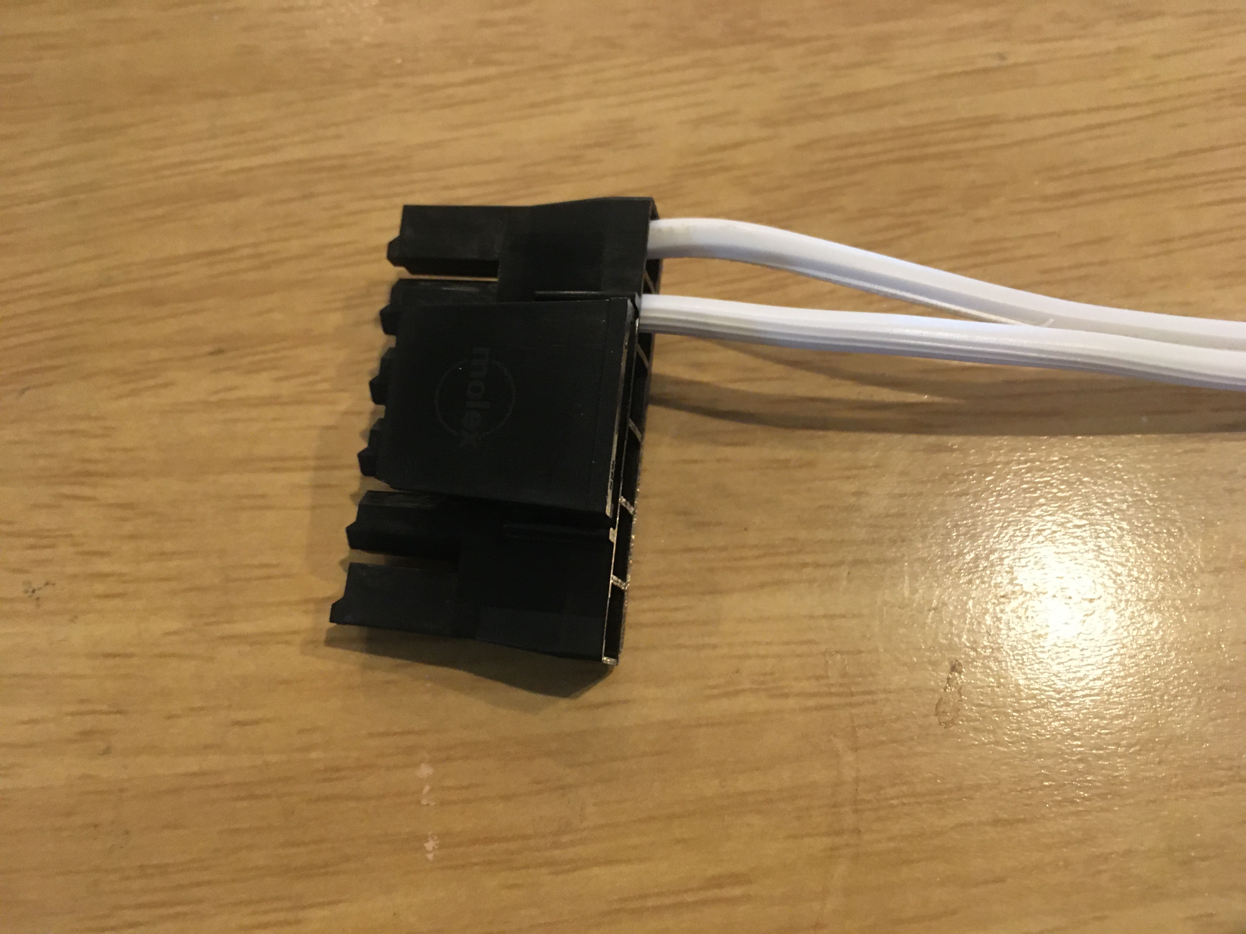

so then it was on to the high voltage side of the Tesla Model S Gen 2 charger, and I found this was the simplest way to power up one power module
Gregski
Posts: 3171
Has thanked: 635 times
Been thanked: 1611 times
Post by Gregski »

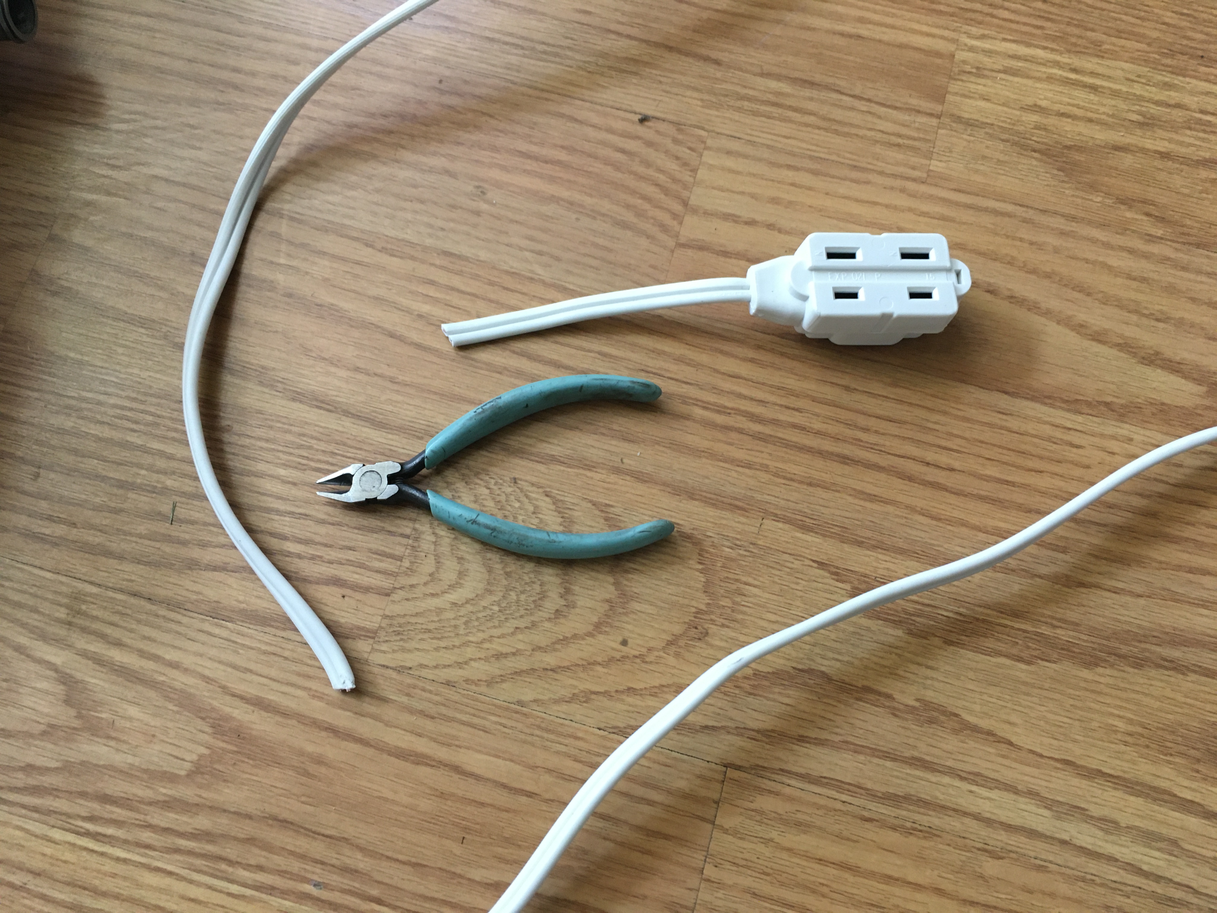

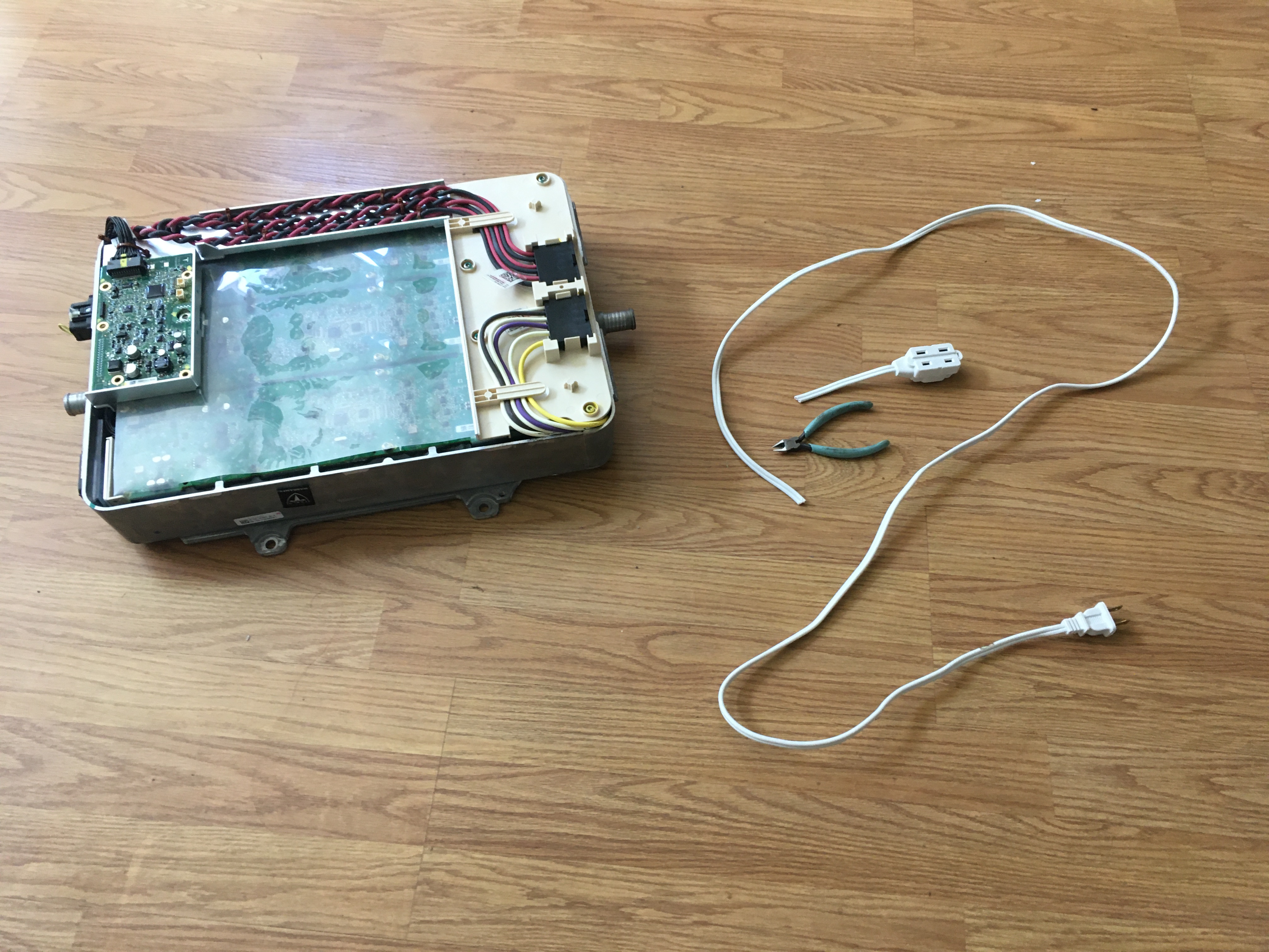

and although not exactly OSHA approved for testing this would supply 120 volts AC from the standard 15 amp US outlet to all three power modules

a little experiment

Posts: 3796
Been thanked: 413 times
Gregski wrote: Sat Mar 05, 2022 4:50 am a little experiment
Nicely done.
Your experinent proves N times voltage will spin the motor N times faster. That applies to Volt Hz control.
But since in the car we want torque control, your experiment lacks the counter torque application. Say a disk brake or another motor on the shaft in regen...
When wheels are up my Leaf motor under torque control would spin up as far as my inverter would allow it.
Therefore voltage only applies to maxspeed parameter all else are subject to amps.
On the other hand mechanical power is dependent on RPMspeed x torque. As well electrical power is directly proportional to Volts x Amps with a nominal %...

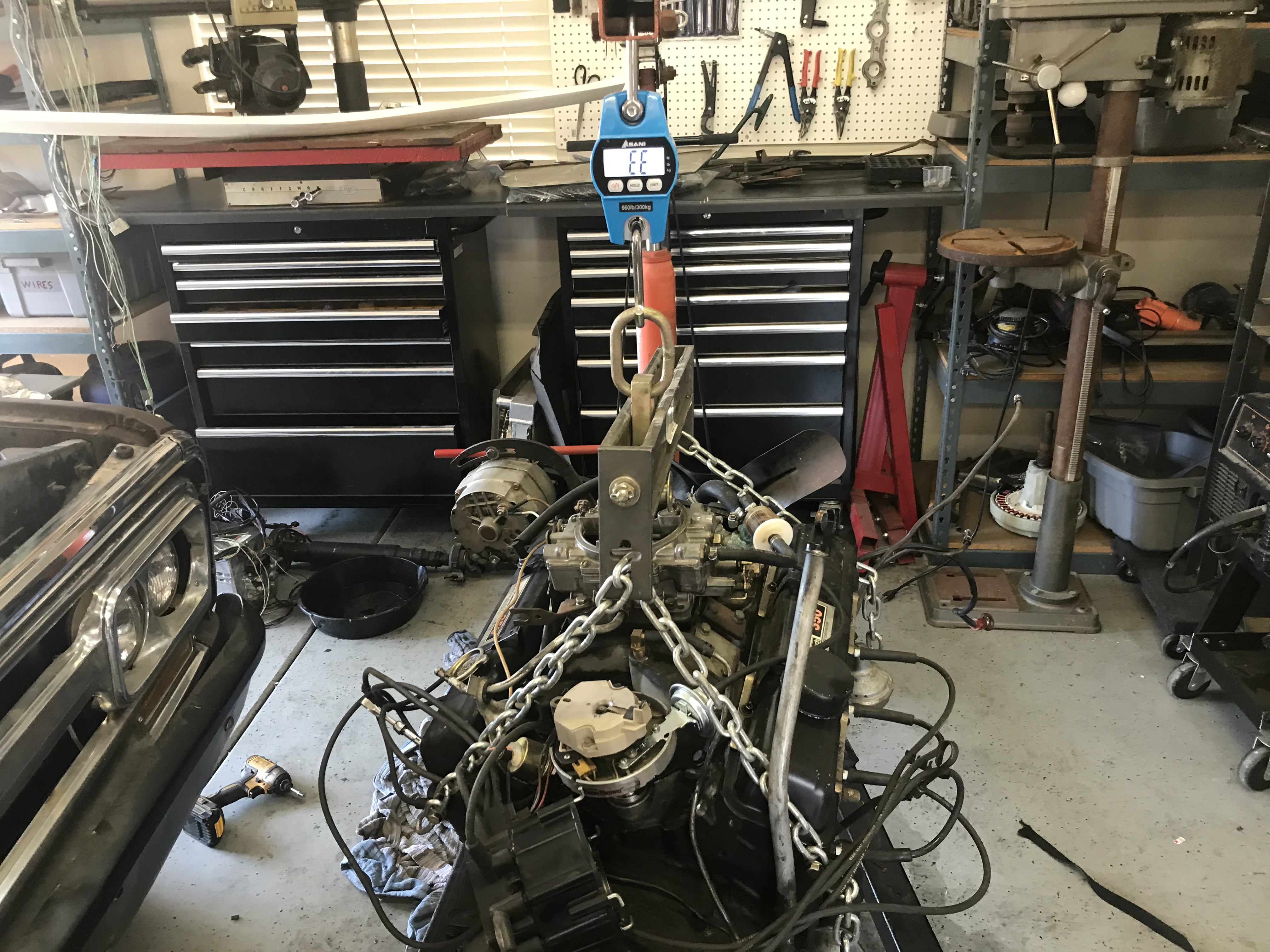

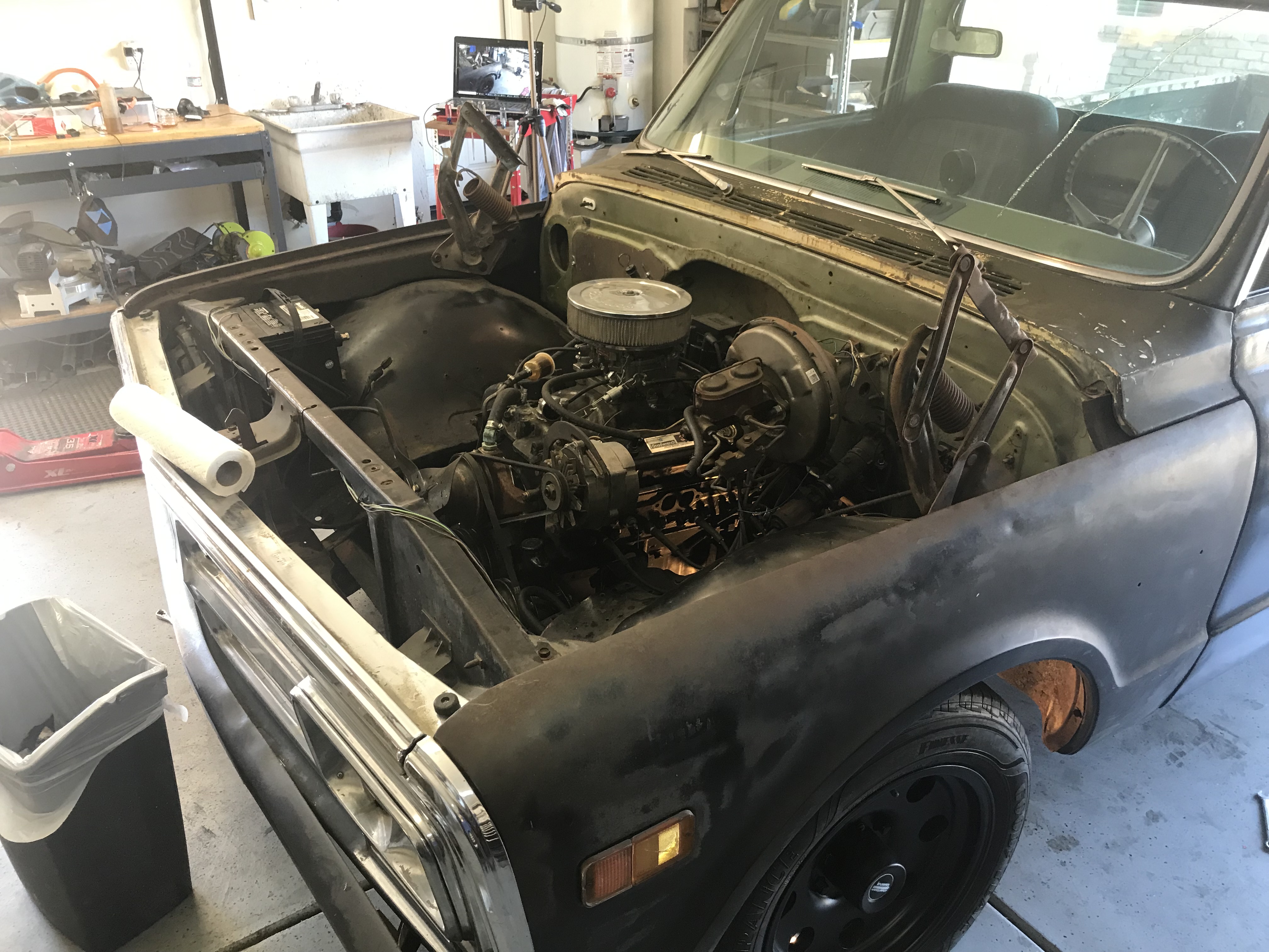

Captain's Log: March 2022 B.C. [Before Conversion]
commencing operation March Madness (aka a simple 4 step EV Conversion)
Step 1. Remove hood
... feel free to follow along at home, any car will do preferably your exes, ha ha
Gregski
Posts: 3171
Post by Gregski »

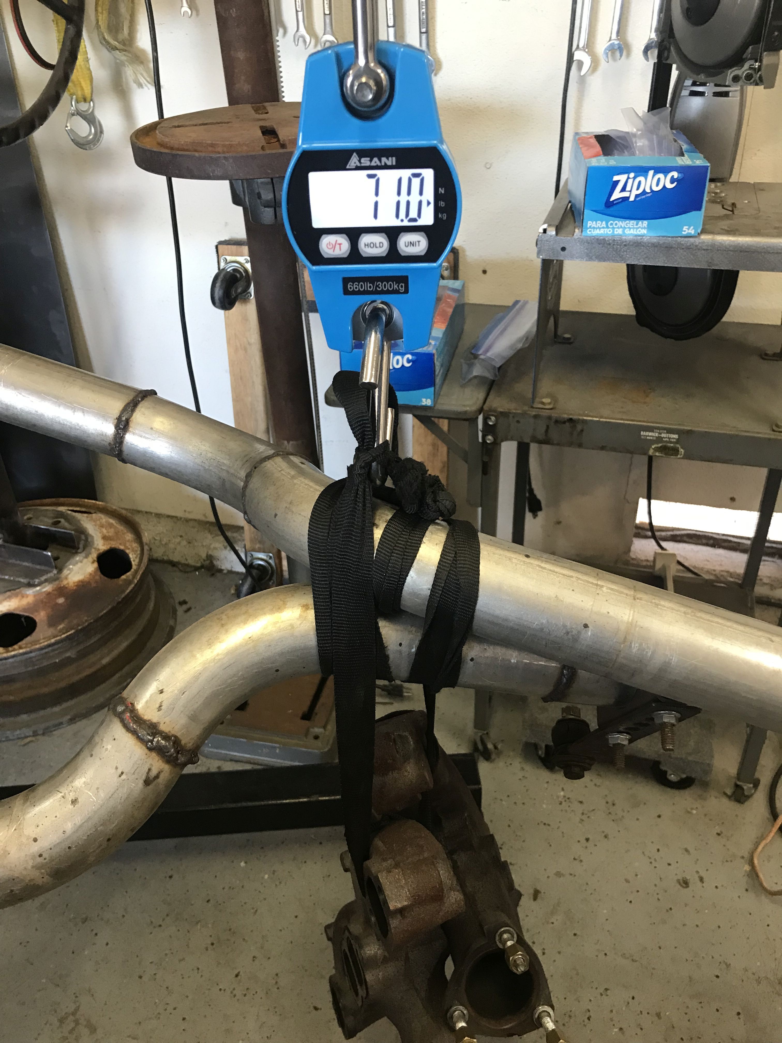

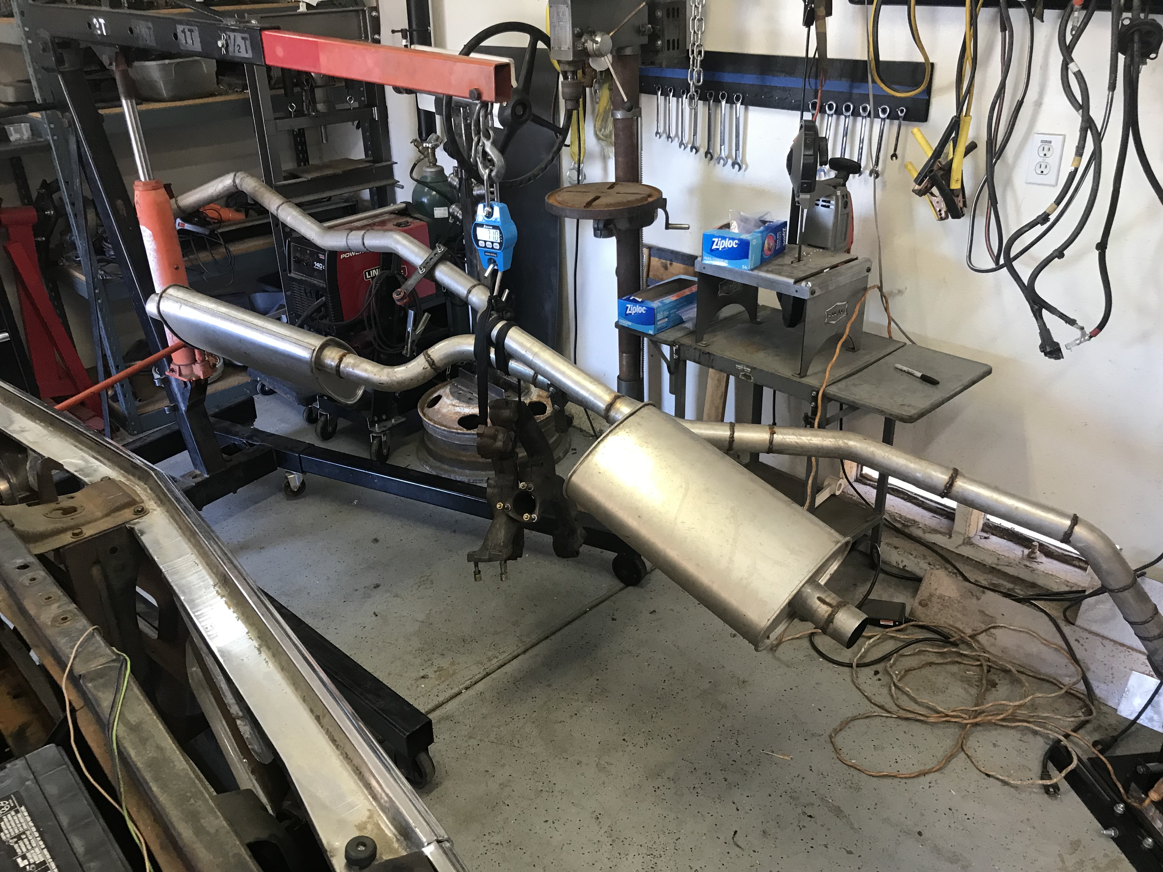

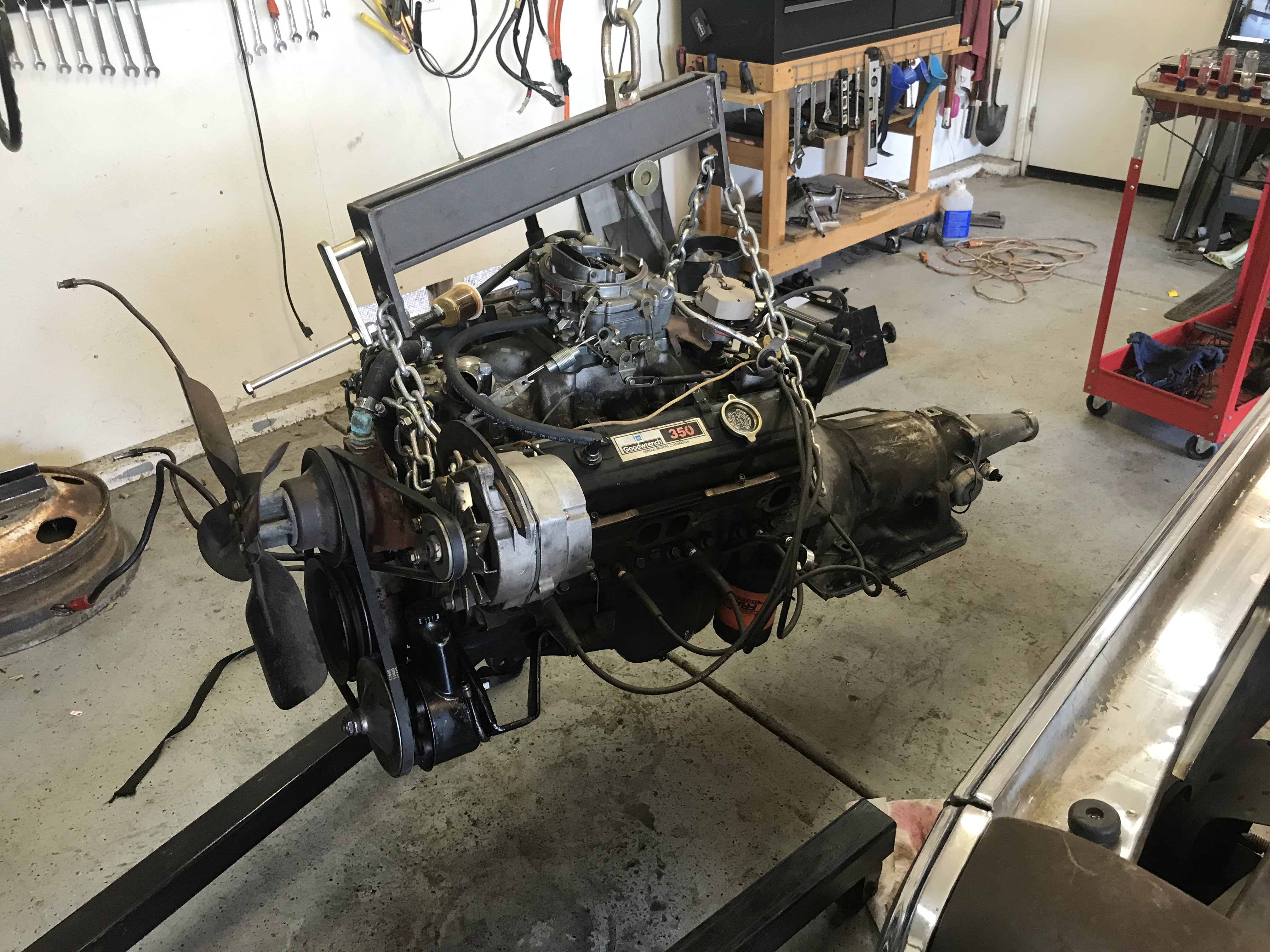

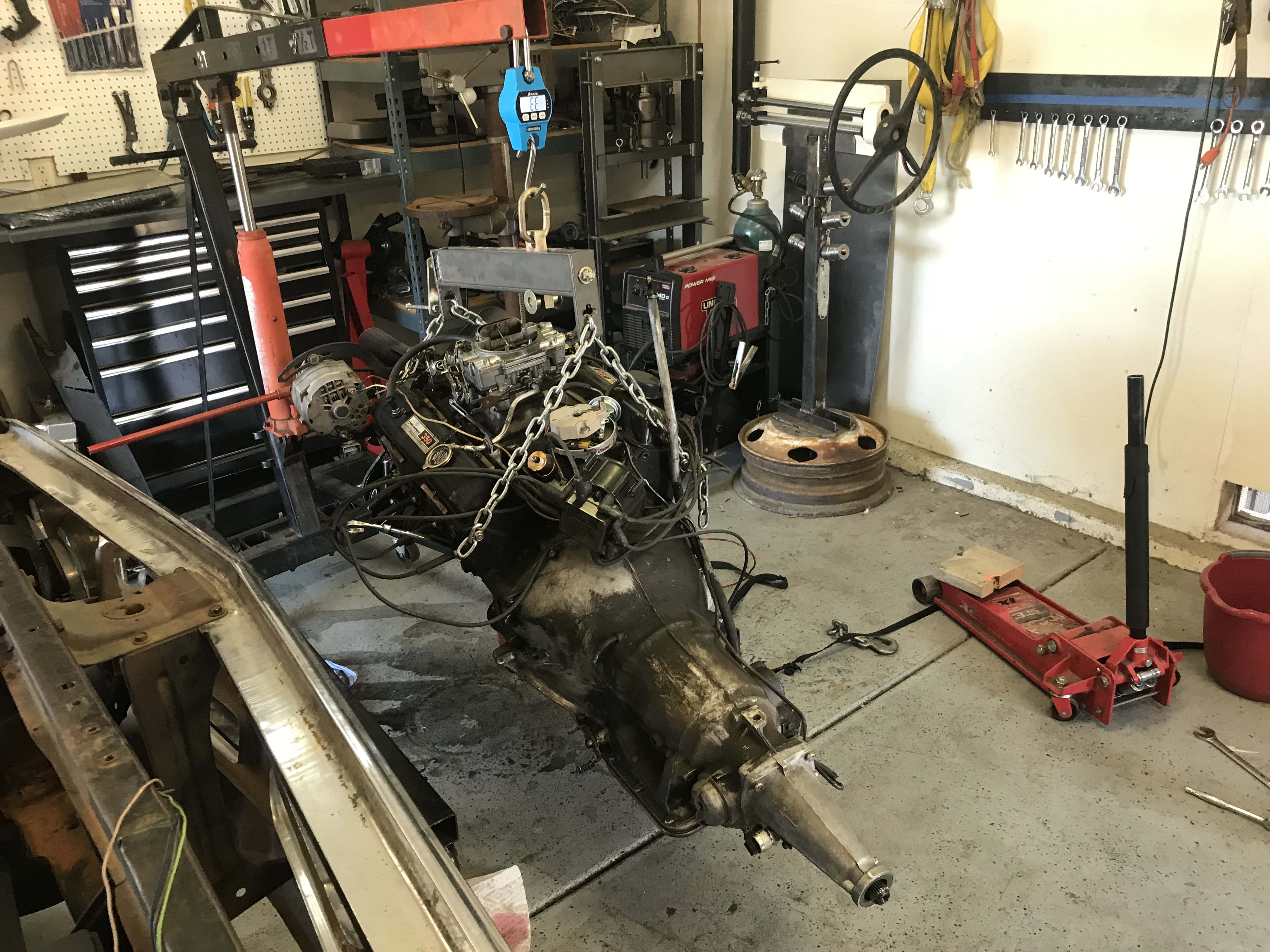

Step 2. deICE
in this step we liberate any and all systems pertaining to the Internal Combustion Engine

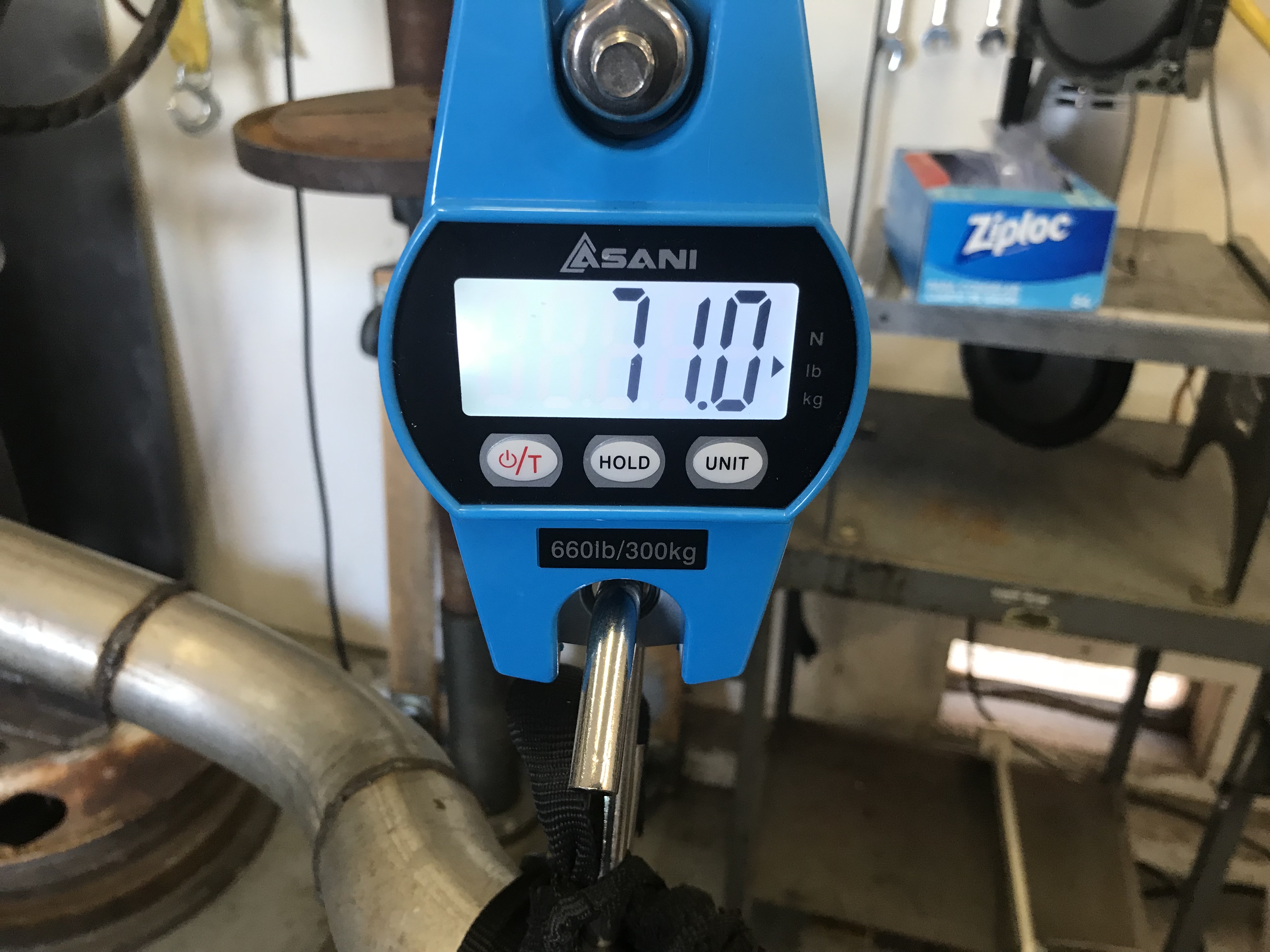

here we removed the exastulators and weighed them for those on a strict diet
Note: we included the Ram Horn exhaust manifolds for a complete exhaust system
Total Weight: 71 el bee eses
Gregski
Posts: 3171
Post by Gregski »
next we removed the Pavement Lubrication System aka SBC
Note: it broked the scale, which only goes up to 660 lbs

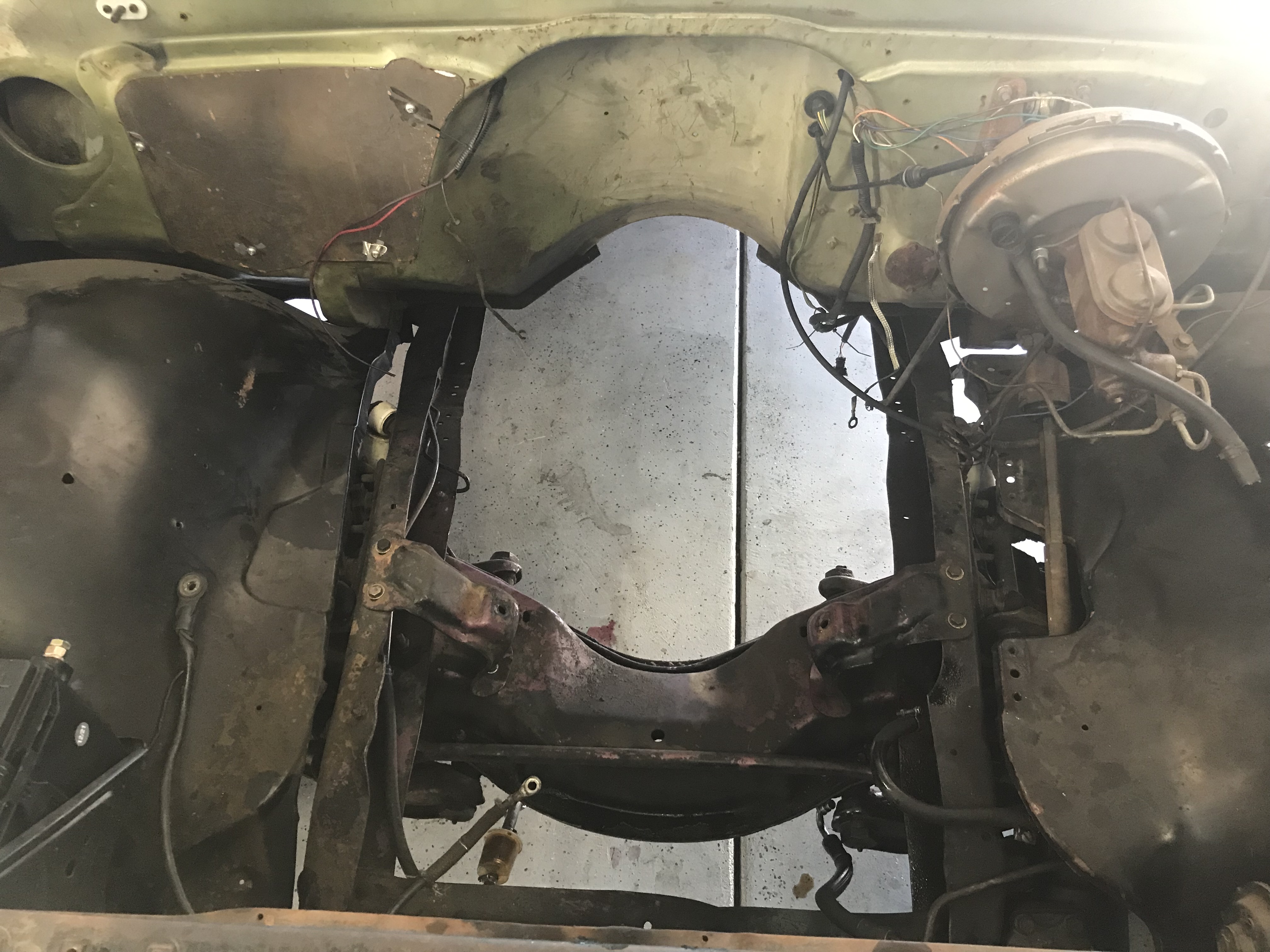

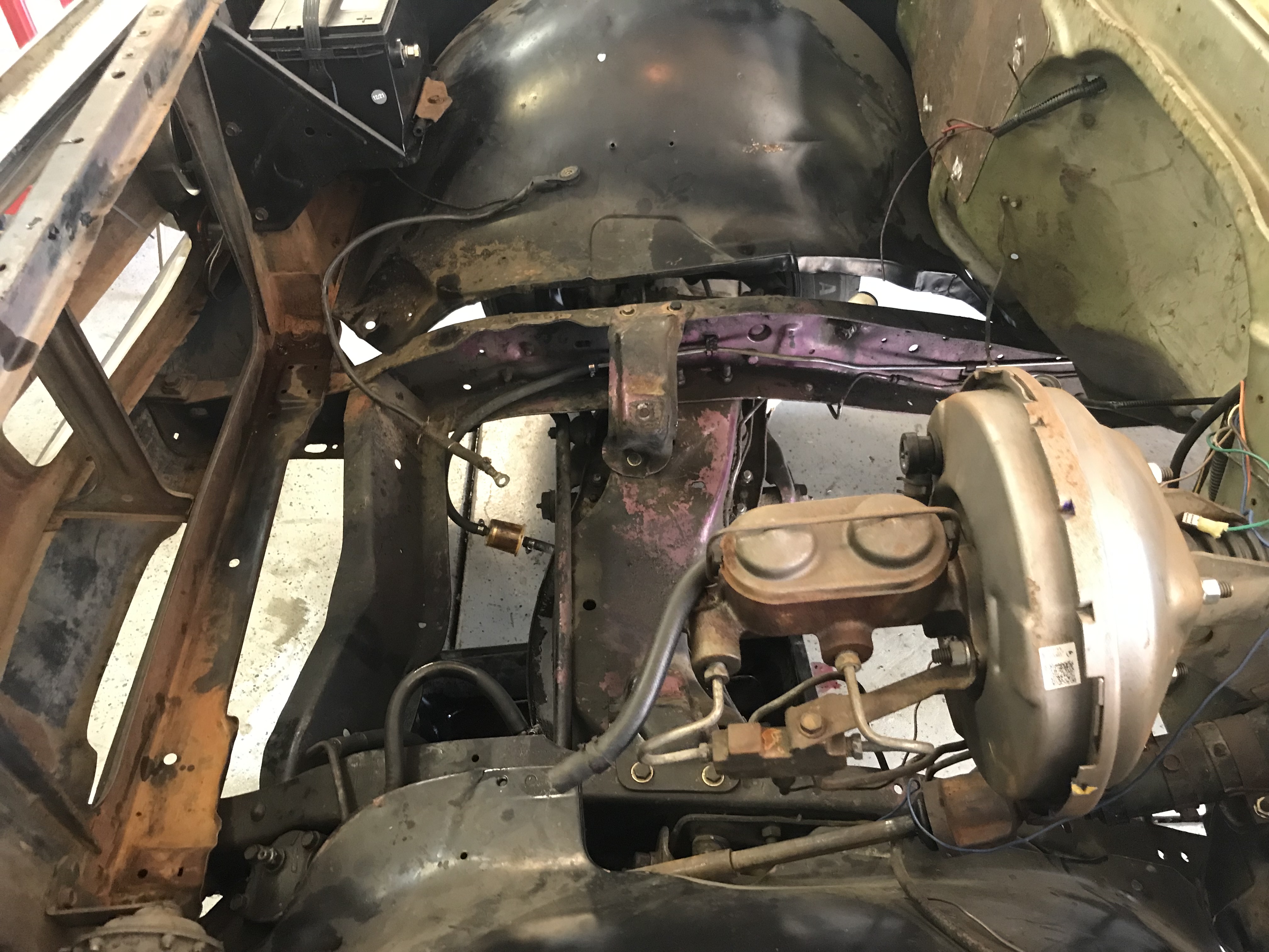

this left an empty engine bay cavity, which I am telling myself repeatedly:
you will not strip
you will not clean
you will not paint
as this is an Electrification and not a Restoration
Gregski
Posts: 3171

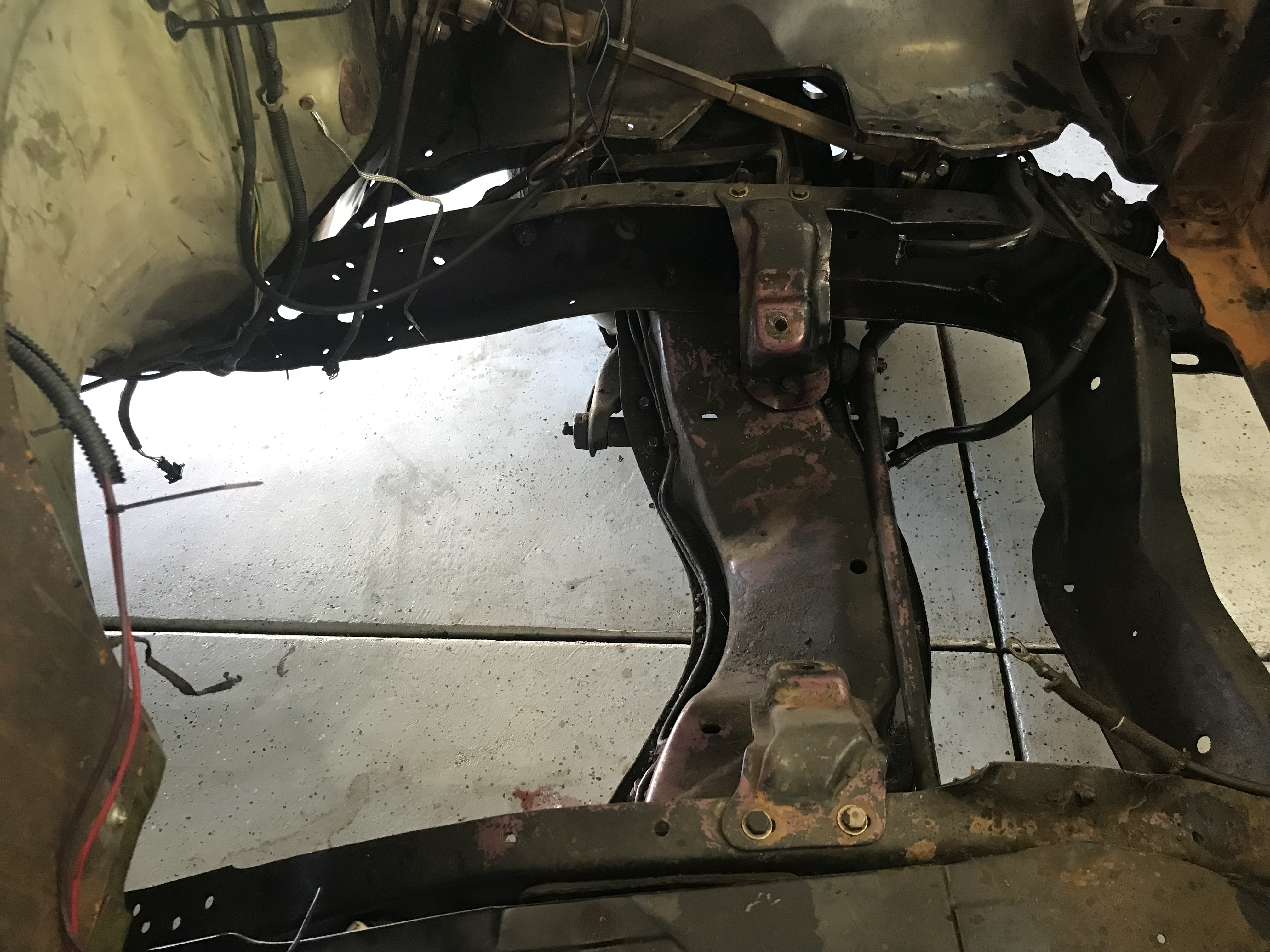

Post by Gregski »
Wait! is that flippin' purple?

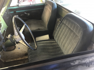

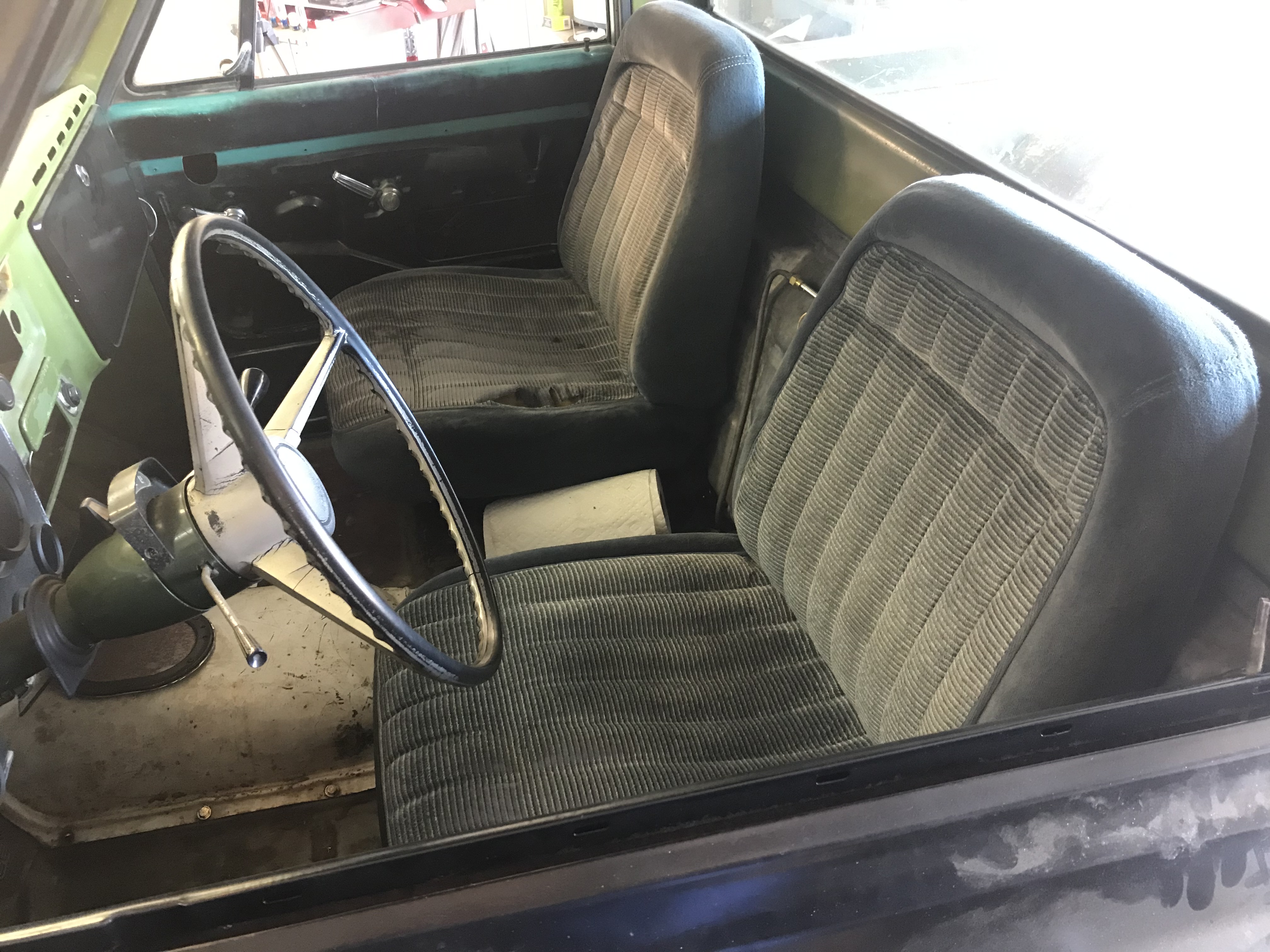

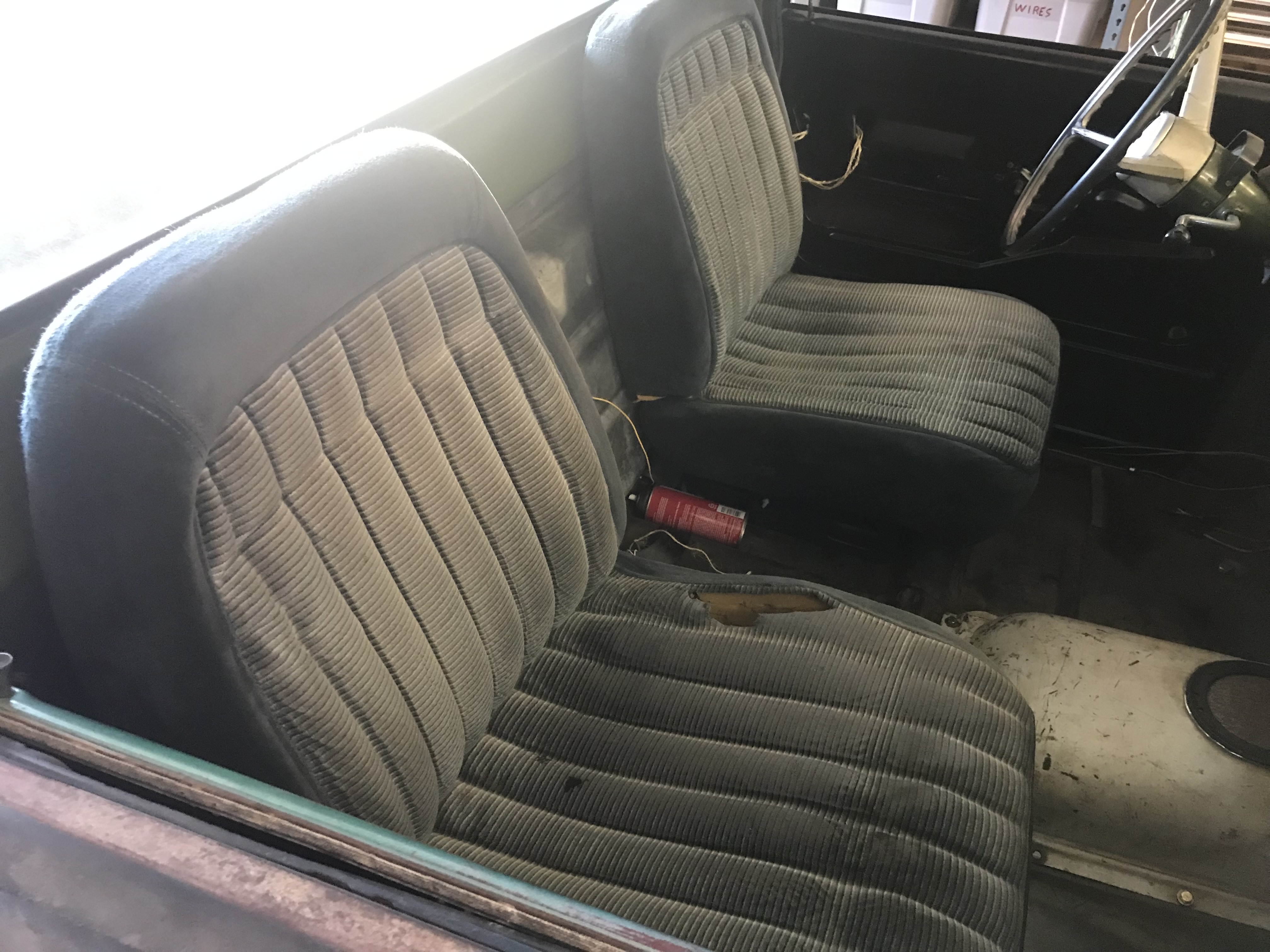

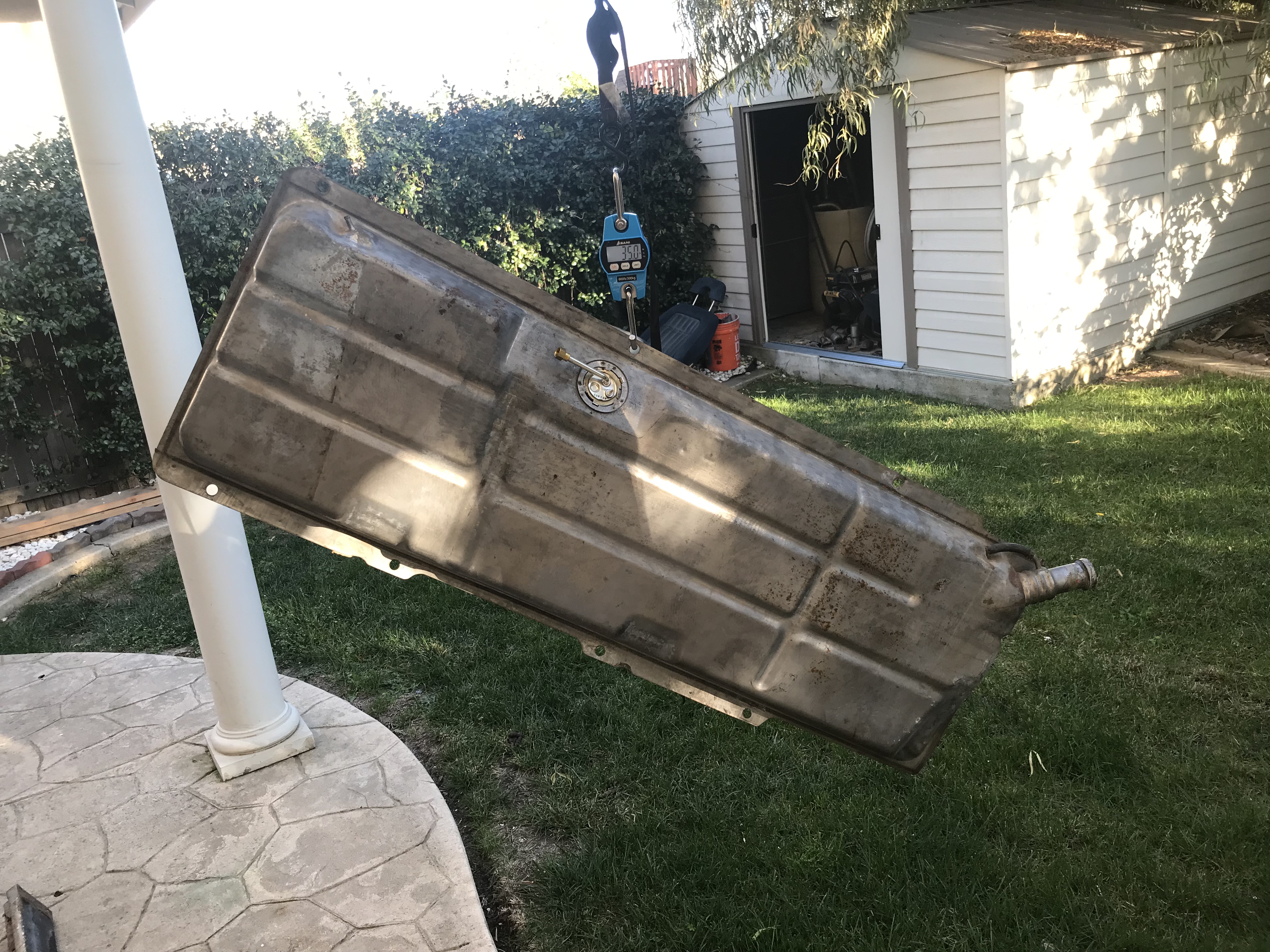

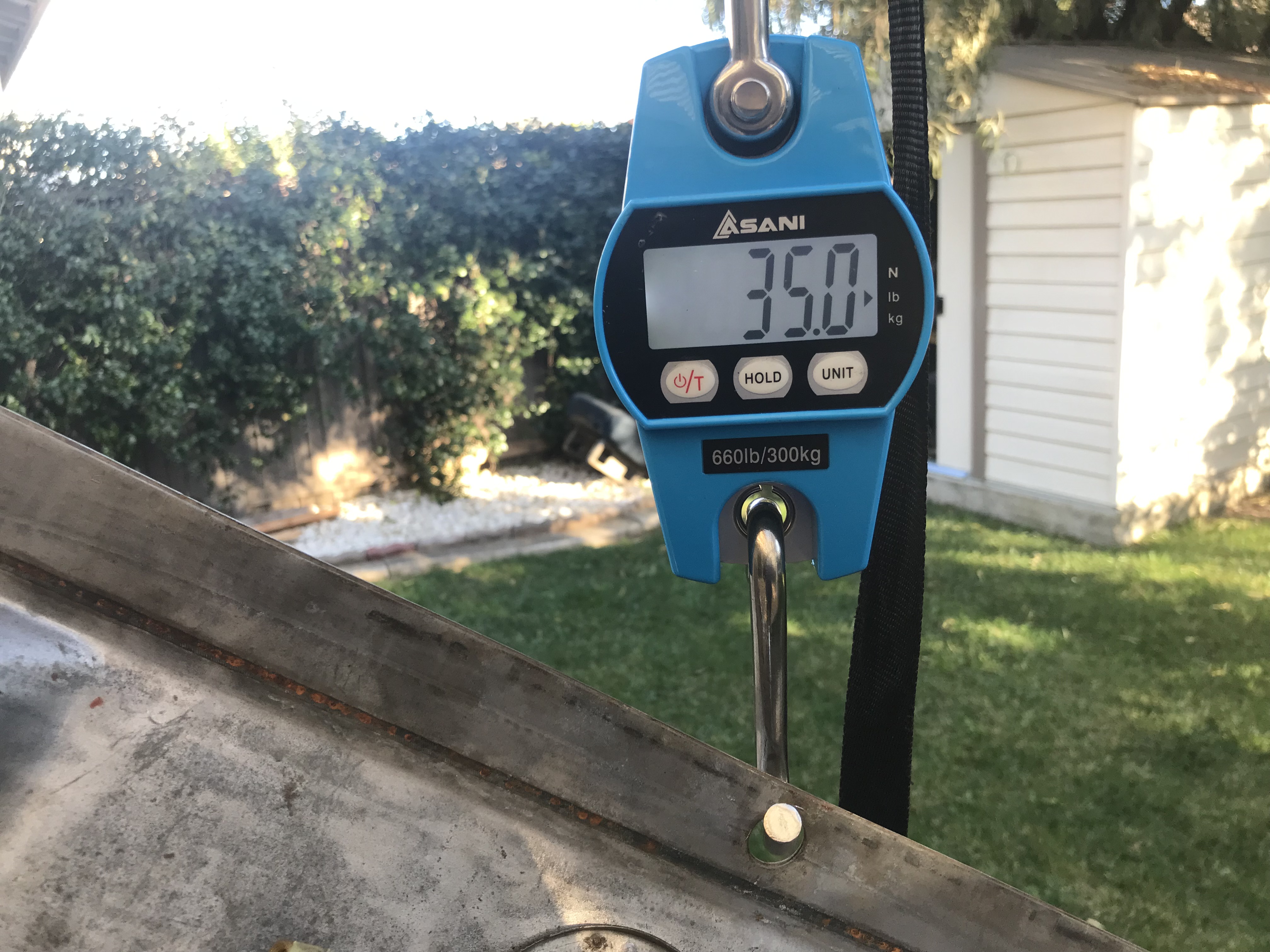

we went after the fuel tankulator next, and for that we had to remove them buckets, which gots ta go to the upholsterererer anyways
I think that's a 16 gallon tank, any guesses how many Home Depot 5 gallon buckets it took to drain it?
We also weighed the tank: it came in at 35.0 lbsers dry as a bone

so what is that? 71 + EE + 35 = 100 or so and since the scale craps out at 660 lbs we are talking about North of 7 fiddy
don't forget that The Greg drained all the fluids, and a 16 gallon fuel tank alone would add 16x7 = just over 100 pounds

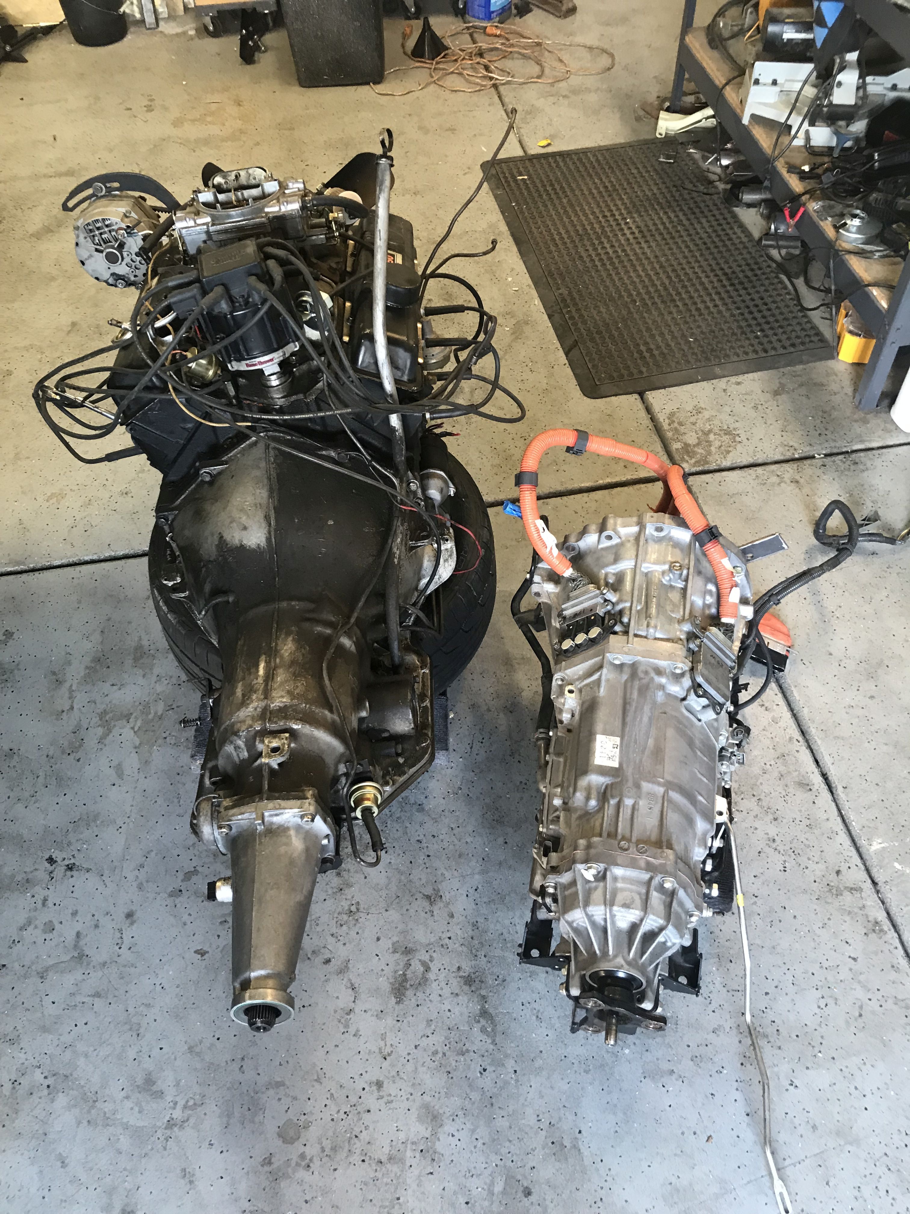

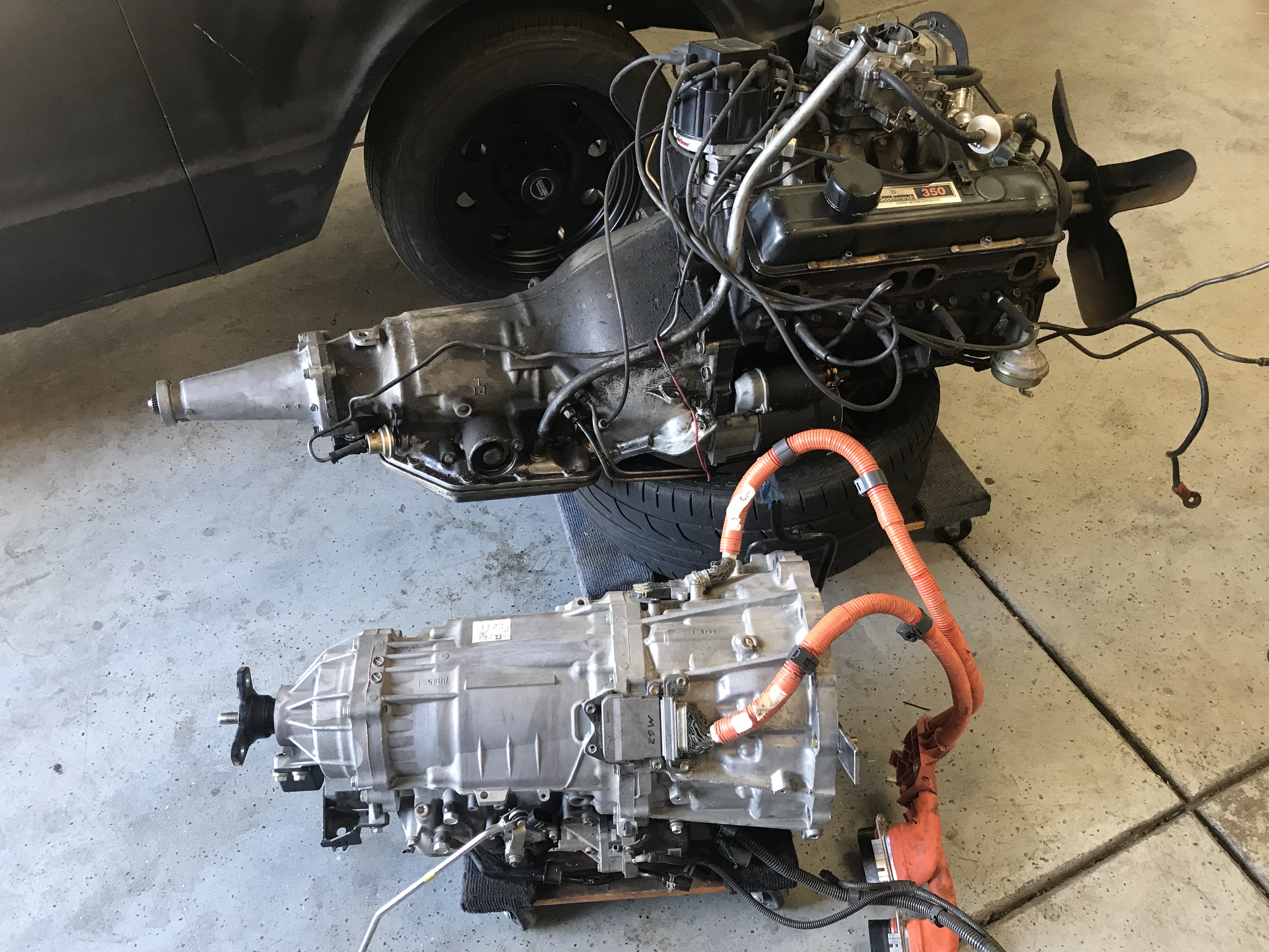

Next it was time for a little Stare and Compare
190 hp on the left over 300 hp on the right (Lexus GS450h dual electric motor transmission) you're welcome!
Been thanked: 1918 times
Seems like 10x the power per volume :D
Why am I always too lazy to weigh stuff that goes out and in?
