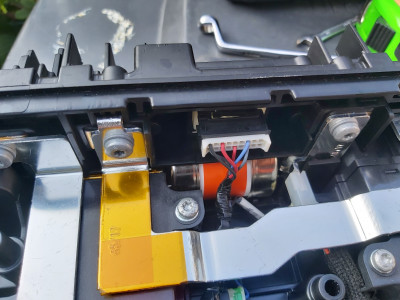

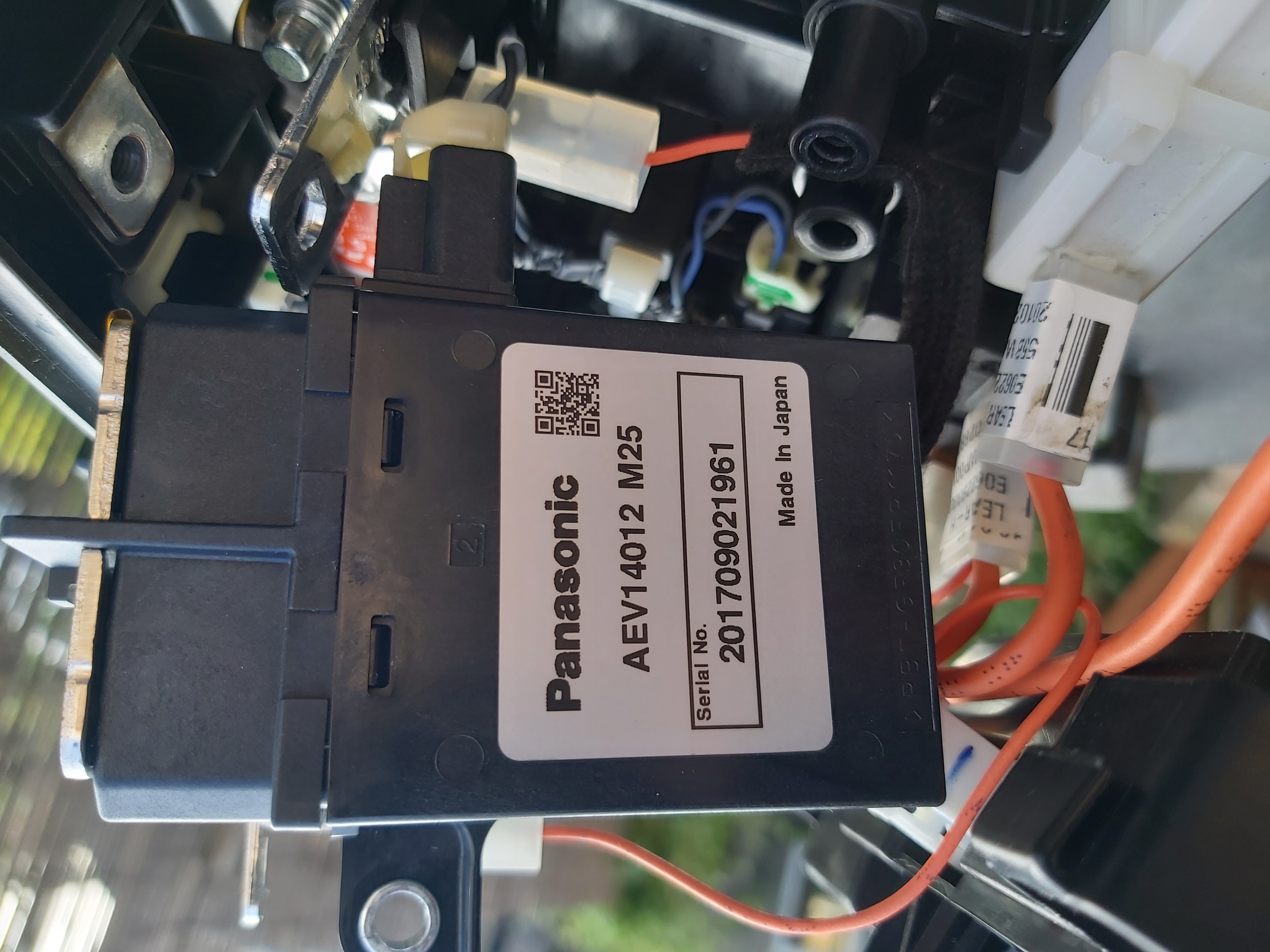

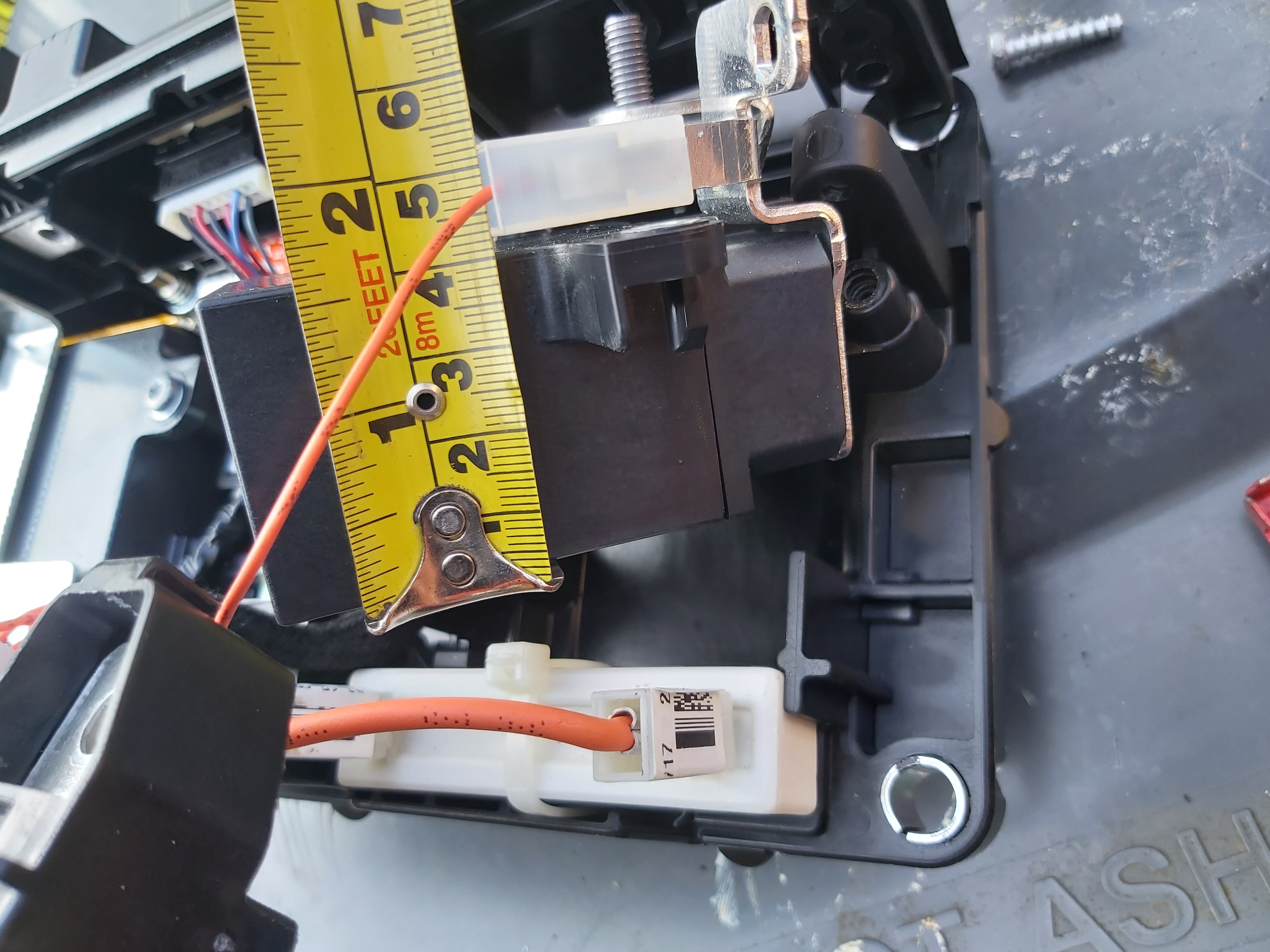

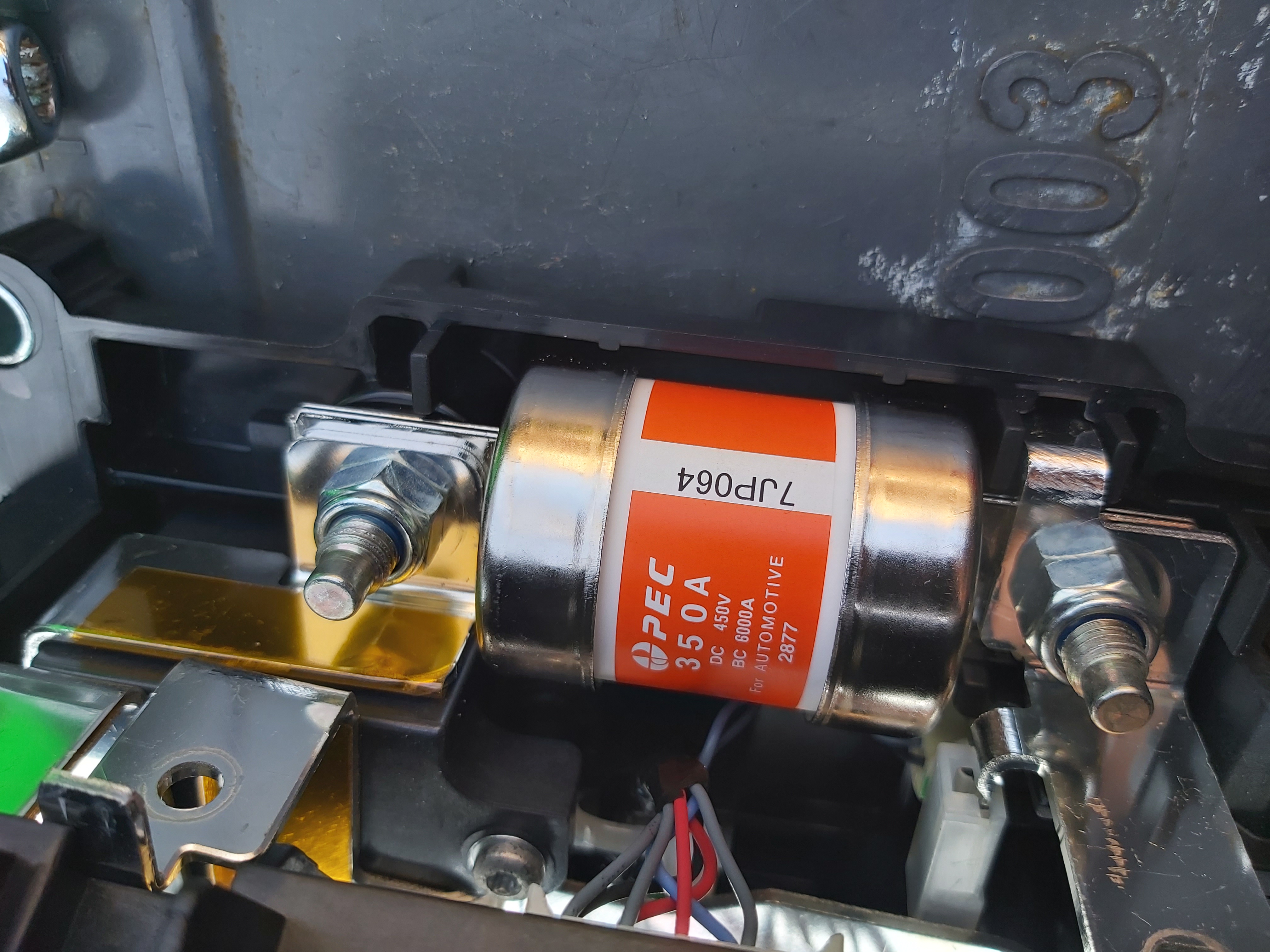

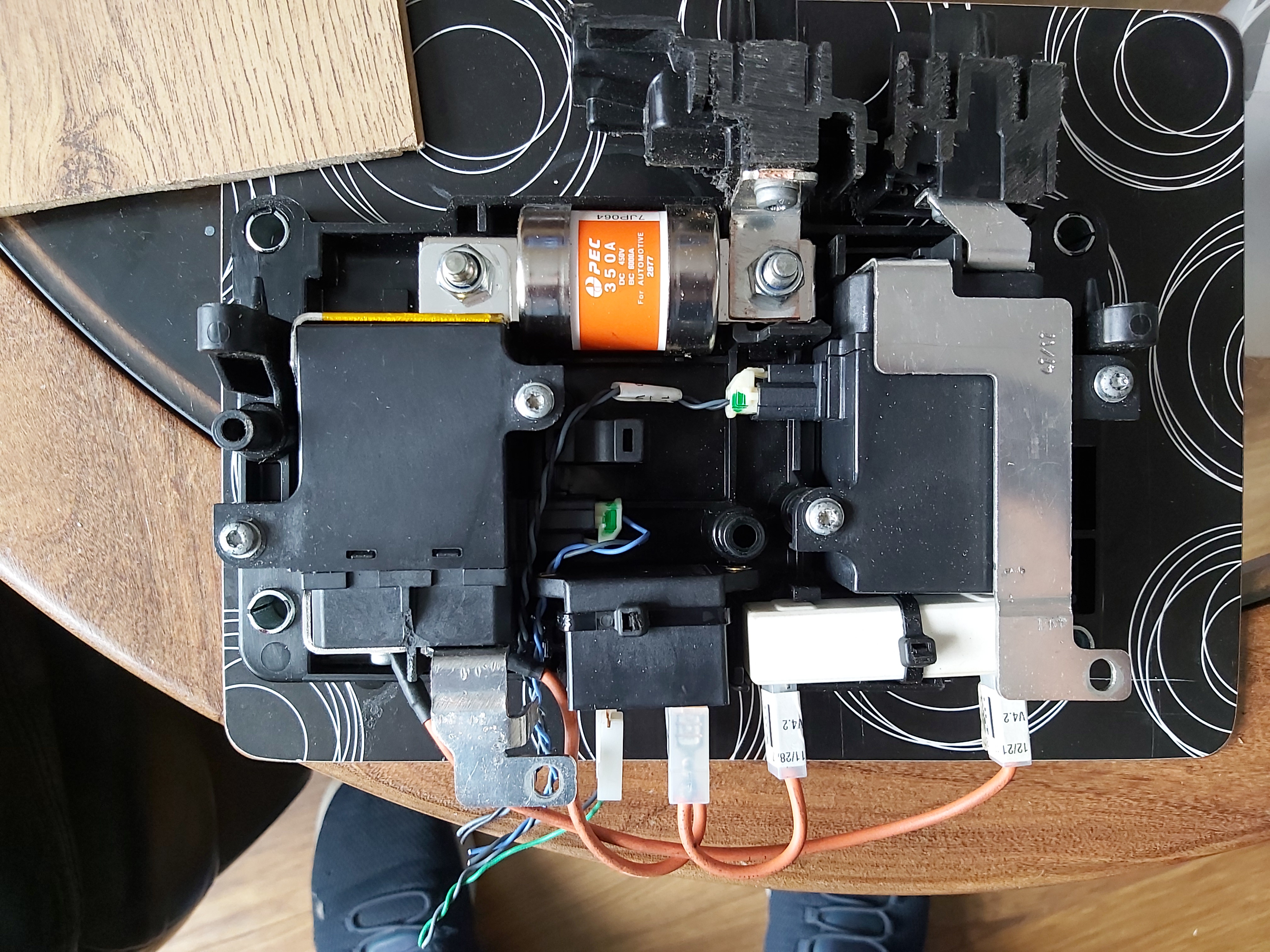

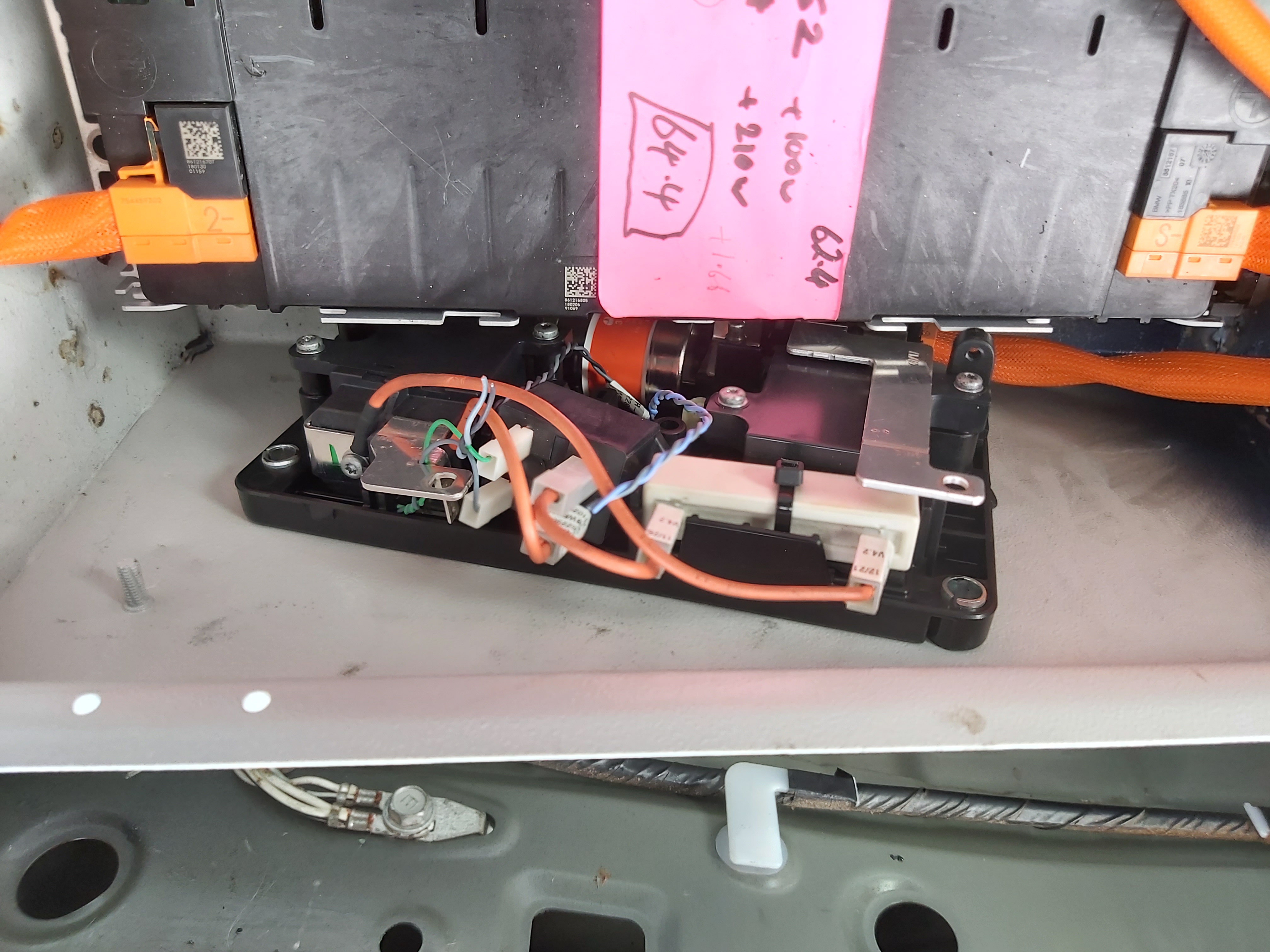

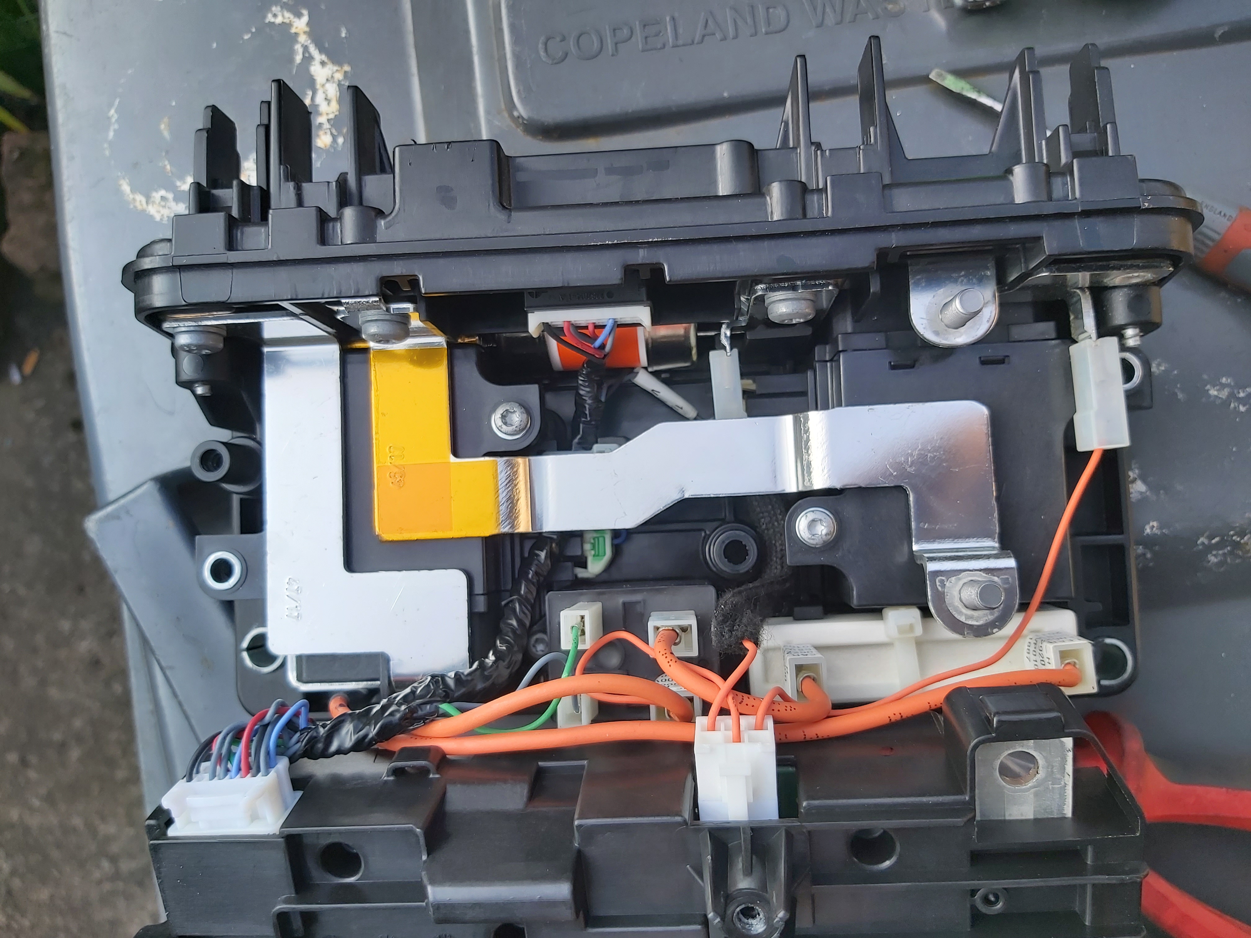

I have added some photos of inside the contactor box.
BMW contactor box internal
BMW contactor box internal 2
BMW contactor box internal 3
BMW contactor box internal fuse
BMW contactor box internal contactor
BMW contactor box internal contactor 2
BMW contactor box internal contactor 3

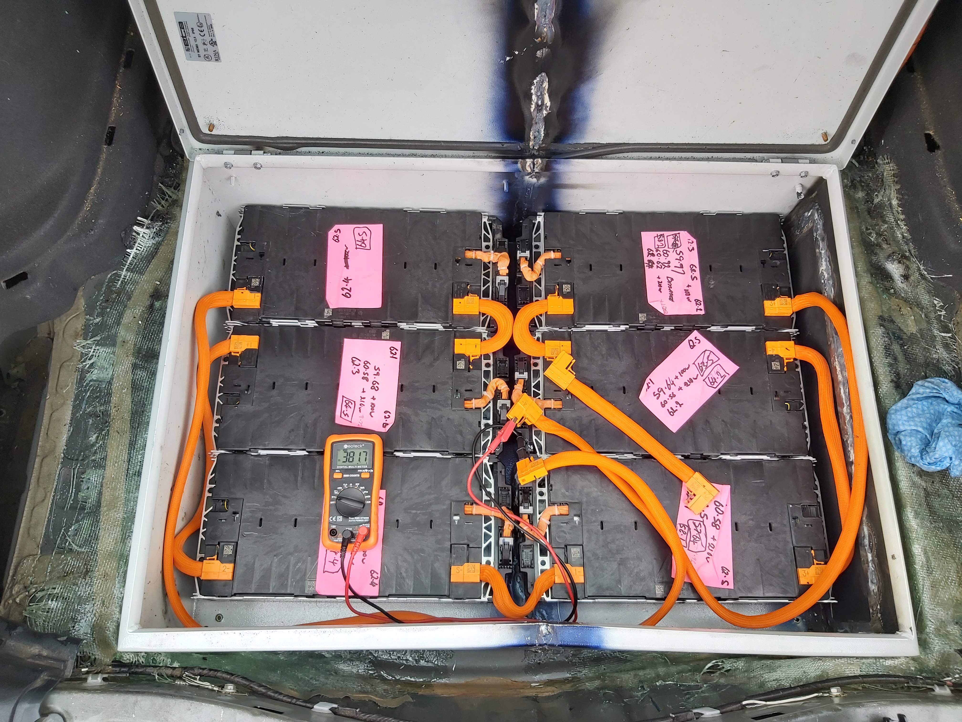

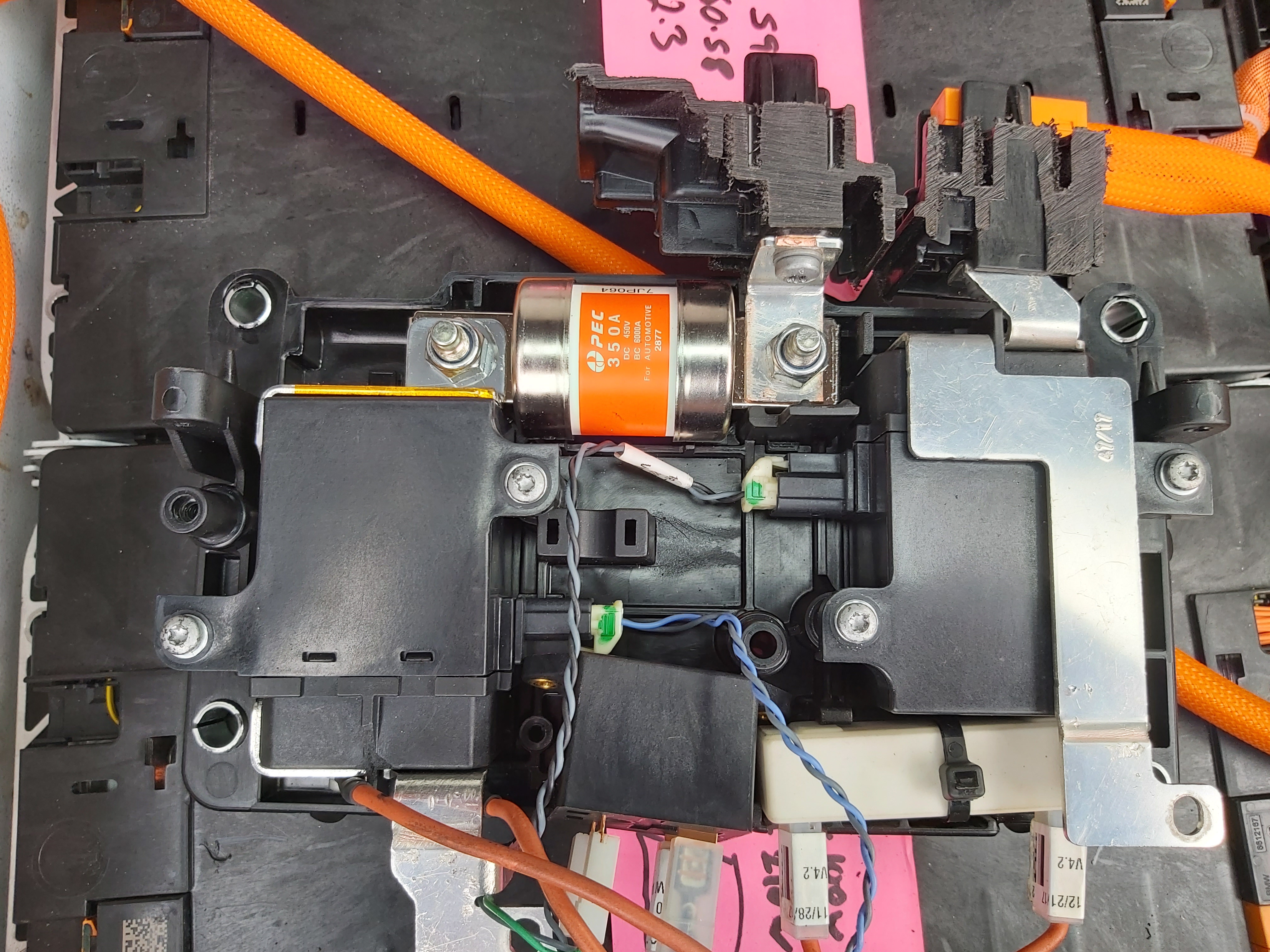

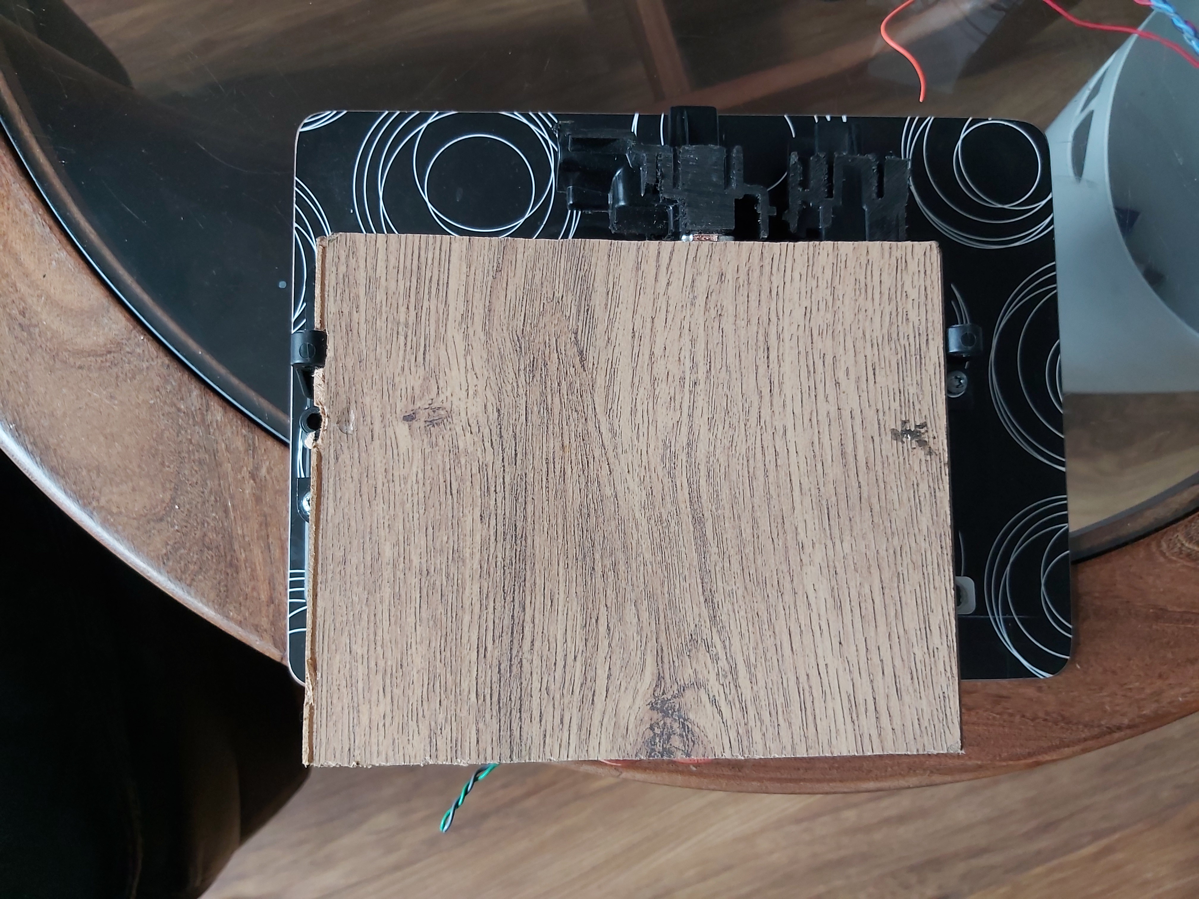

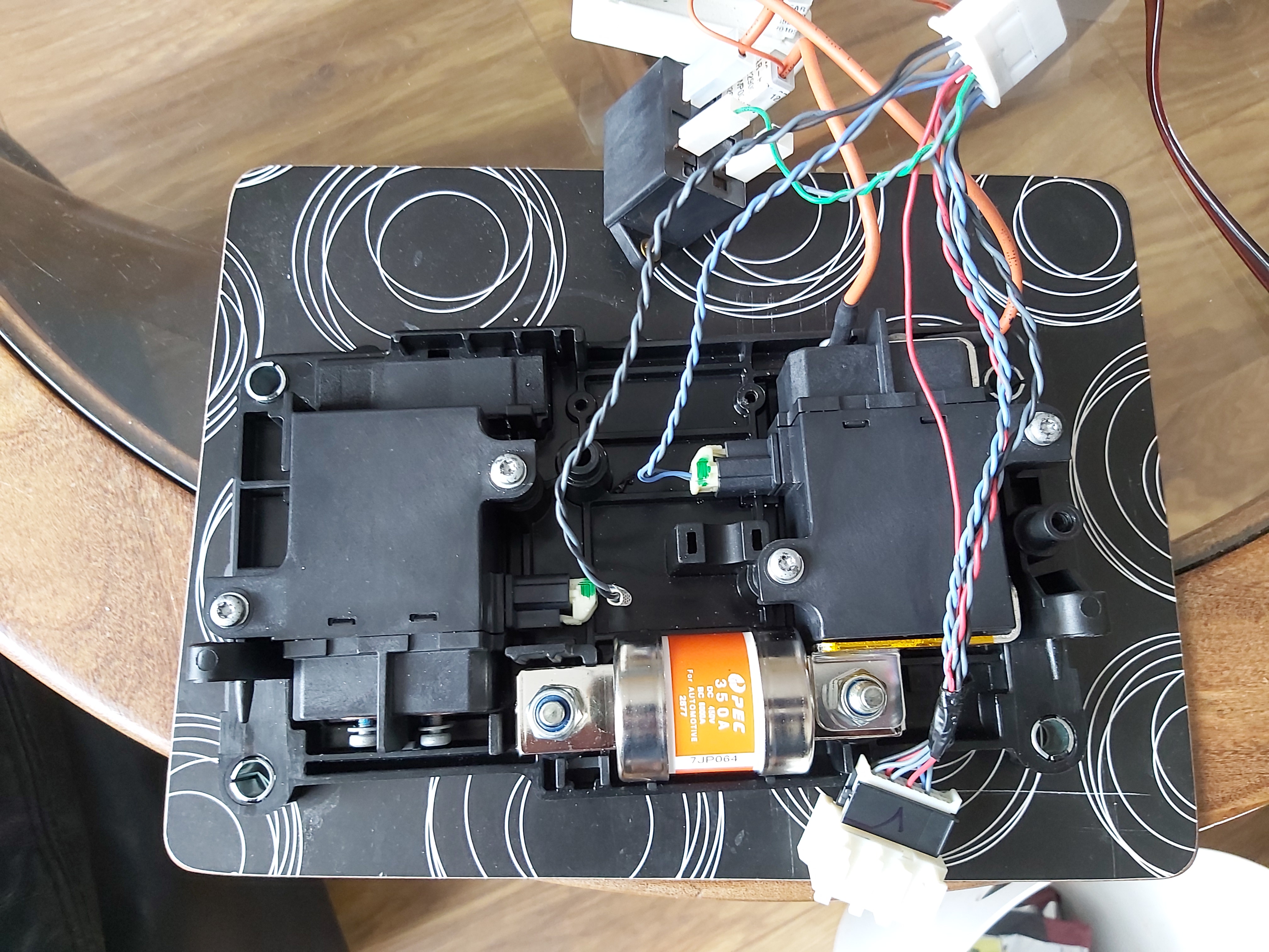

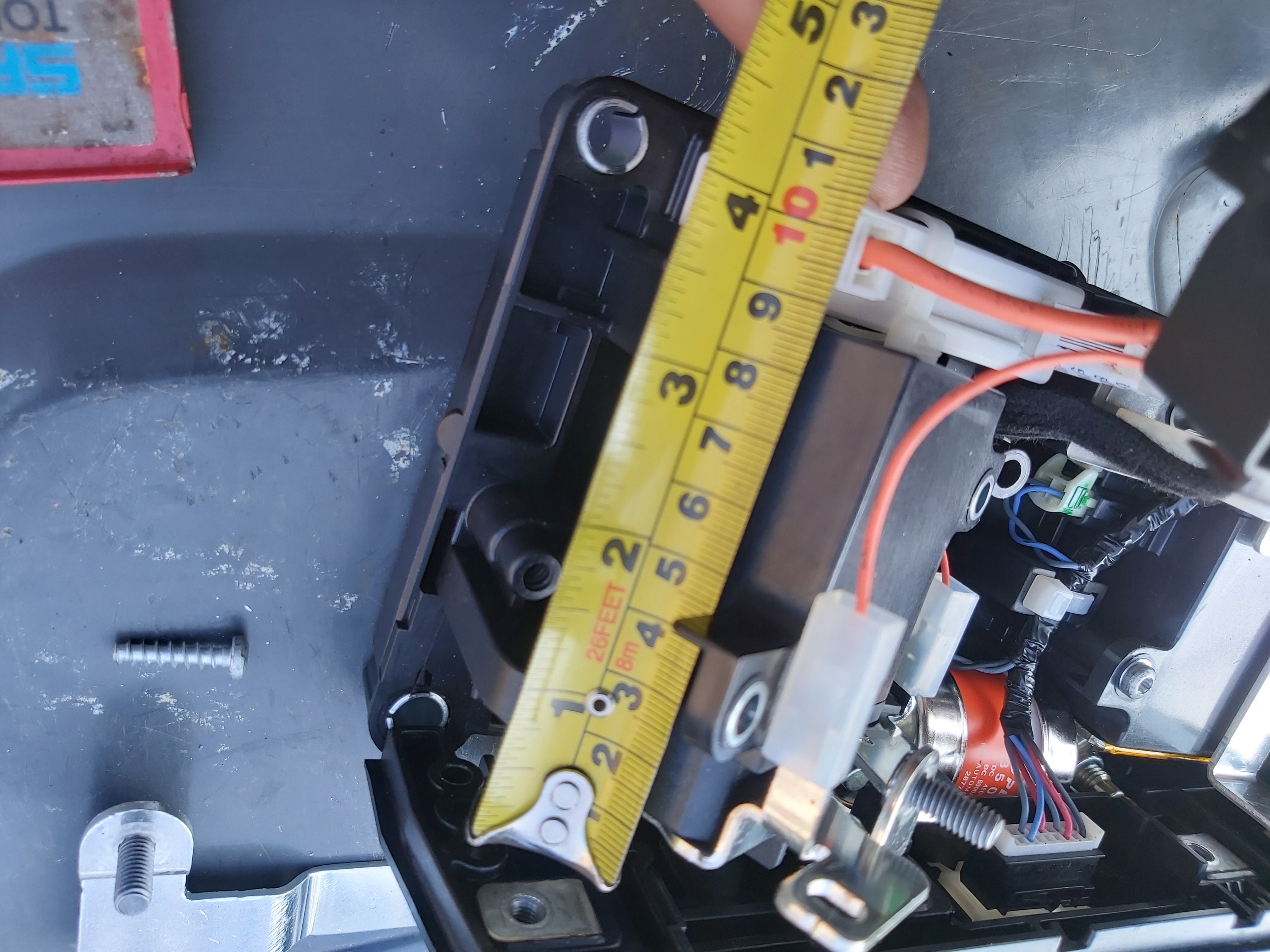

I am using the components of the BMW contact box for my project.
I had to cut down to fit in a smaller gap inside my battery box.
Battery box made from a cut down enclosure
Basic components
Basic components
Cut down contactor box
Resistor and precharge contanctor rotated 90 deg
Also I cut off the plug in connections so that I can use the BMW connectors to connect to the batteries. I also drilled and re bent the copper bus bars to fit.
Just fits in the batery box
Laminate flooring as an insulator
I am going to fit 12 batteries in this box, two sets of 6 in parallel. One above the other with 40mm spacers in-between the batteries.
Does anybody have any suggestions how to do the connections? I was considering using two sets of contactors for each 6 batteries so that if one fails I should still get home.
