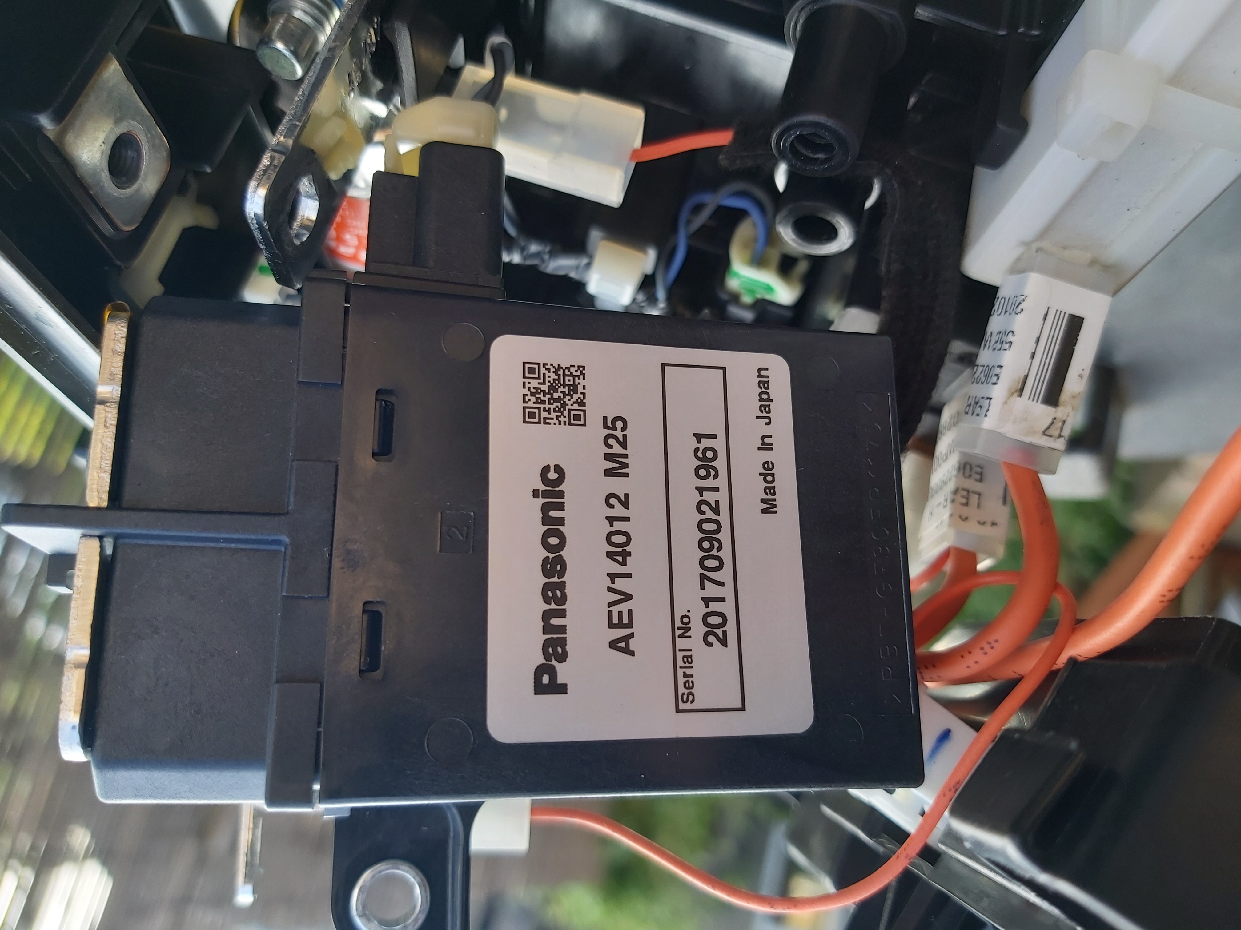

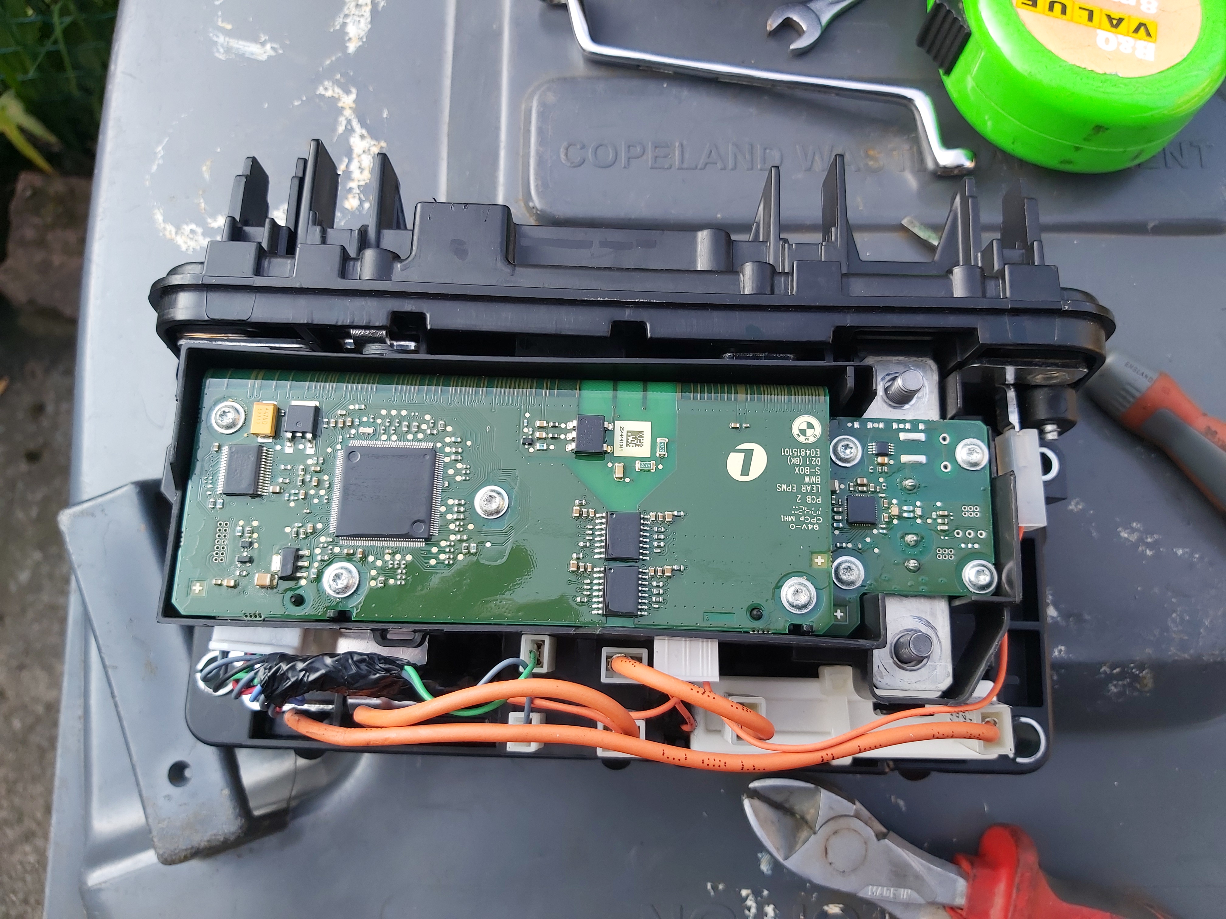

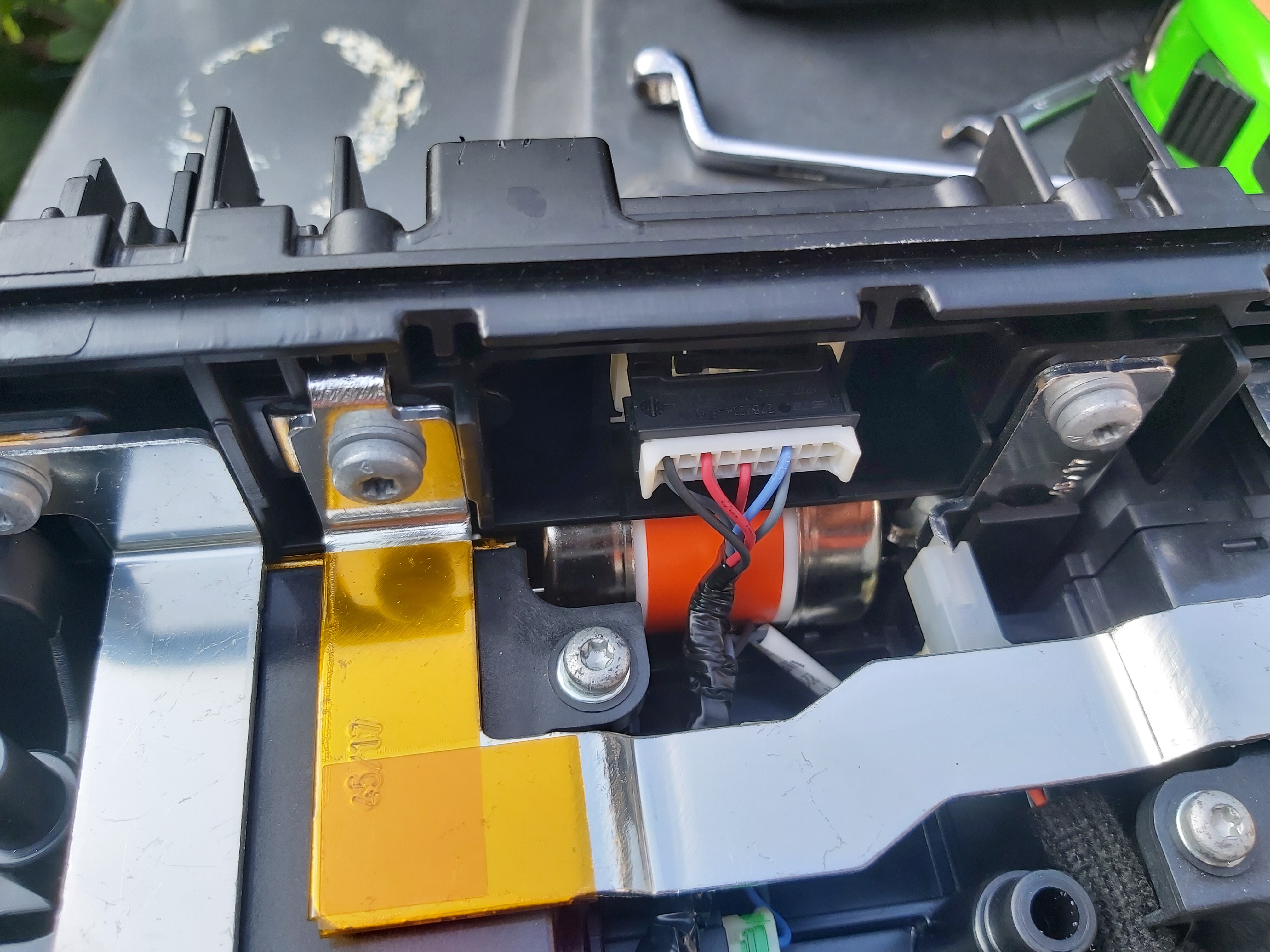

I am using the components of the BMW contact box for my project.
I had to cut down to fit in a smaller gap inside my battery box.
Also I cut off the plug in connections so that I can use the BMW connectors to connect to the batteries. I also drilled and re bent the copper bus bars to fit. I am going to fit 12 batteries in this box, two sets of 6 in parallel. One above the other with 40mm spacers in-between the batteries.
Does anybody have any suggestions how to do the connections? I was considering using two sets of contactors for each 6 batteries so that if one fails I should still get home.
