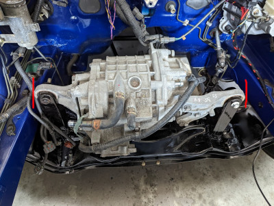

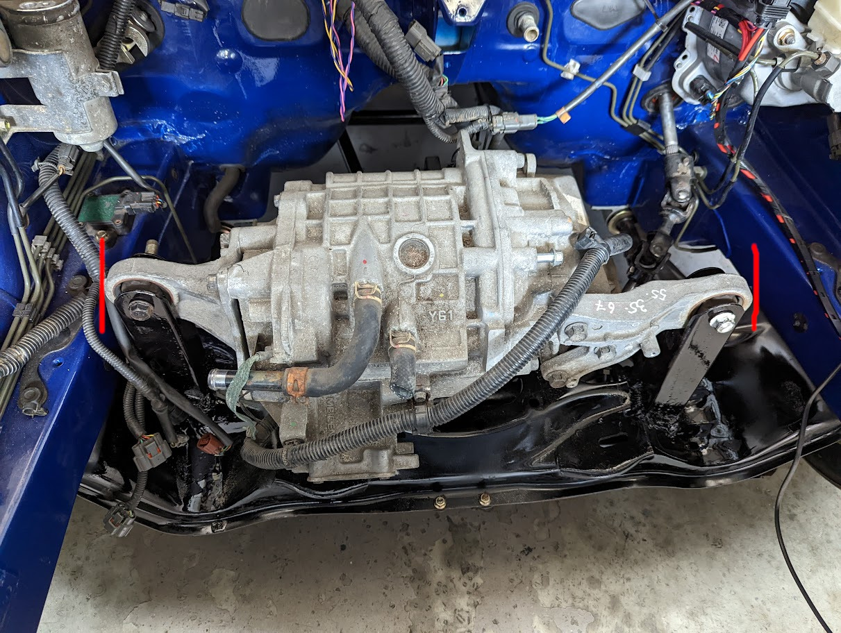

A bit of topic from the current discussion but still on the thread subject. I'm trying to find the maximum width of the rear motor package including gearbox and mounts, see red markings in picture. Please, is there anyone who can share this dimension?

bexander wrote: Thu Sep 15, 2022 12:37 pm A bit of topic from the current discussion but still on the thread subject. I'm trying to find the maximum width of the rear motor package including gearbox and mounts, see red markings in picture. Please, is there anyone who can share this dimension?
Measured 65cm on mine.

Pete9008 wrote: Thu Sep 15, 2022 2:04 pm Measured 65cm on mine.
Great, thank you!!

bexander wrote: Thu Sep 15, 2022 7:20 pm Great, thank you!!
No problem, the motor is just sitting on the garage floor at the moment so its easy to take measurements if you need anything else.

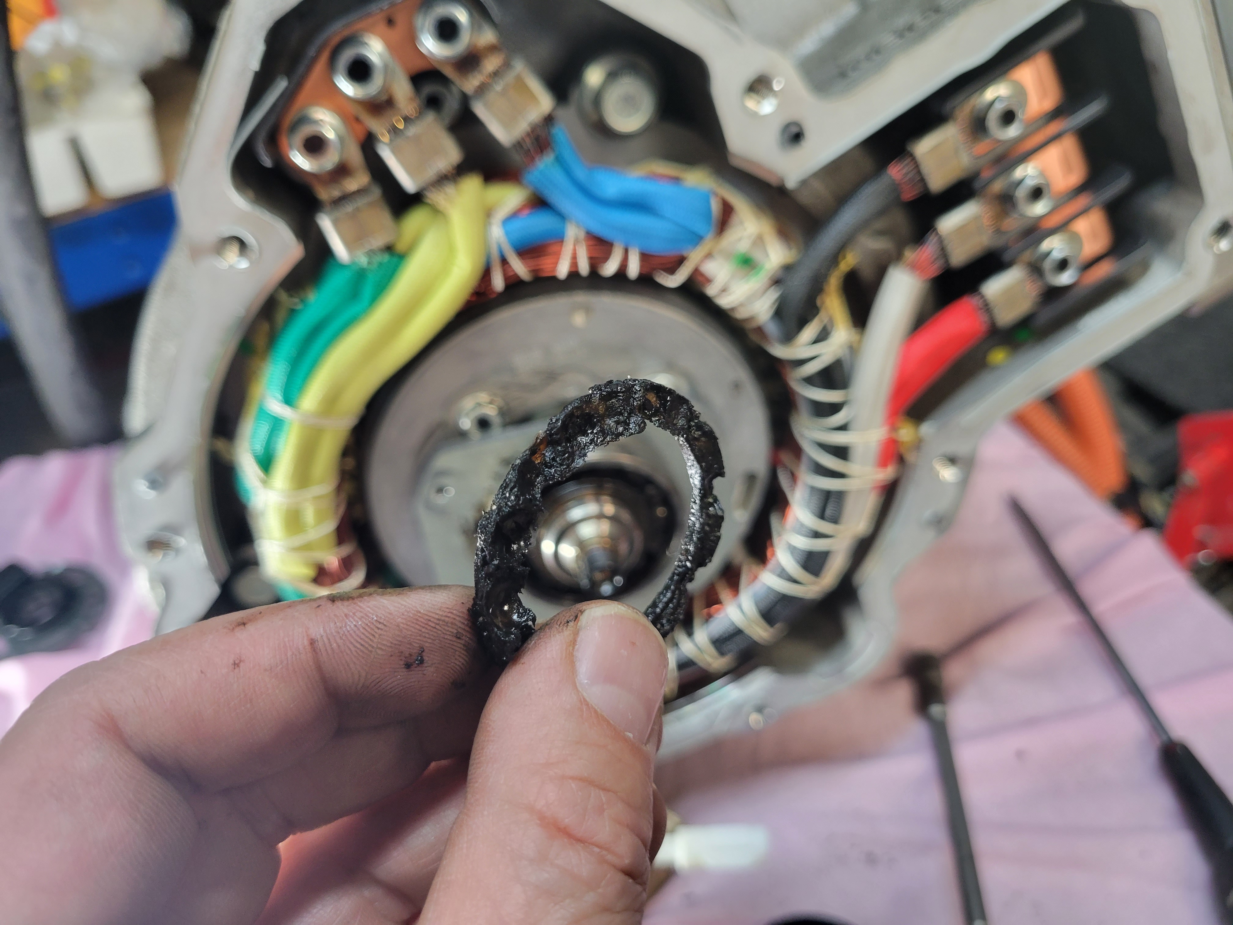

Thought you might be interested to know in this thread that I seem to have destroyed an Outlander rear motor. Not sure of the cause yet, but as you can see in latest vid, it ain't spinning any more.
Current suggestions of cause (I have no idea yet):
- Bearing failure due to poor alignment
- Overheat/burnout due to failed cooling/too much current
I'm going to get the faceplate off and take a look when I can get back to the garage.

bobby_come_lately wrote: Fri Sep 16, 2022 8:58 pm Thought you might be interested to know in this thread that I seem to have destroyed an Outlander rear motor. Not sure of the cause yet, but as you can see in latest vid, it ain't spinning any more.
Well the OC events leads me to believe one of the phases is shorting the motor casing probably. If one phase is shorting into the other you would get constant resistance to turning.
Did you have your motor in moist enviroment or maybe somewhere solvents could damage phase wiring laquer?
Some time ago I was dealing with ACIM motor that would drive normaly under 150Arms. Whenever i would exceed current inverter would throw OC. It took me like a month of testing, but i finally took apart that motor to find traces of water damage on rotor and phase wires. Obviously motor was submerged at one time and one phase was shorting just enough to trip OC under higher amps.
Check the phase wire bolts, maybe you have a short there...
Also Would it be possible your coupler would push on the bearing enough for it to sieze?
Best to take apart the motor and check stator wiring for damage. When you are at it inspect rotor for damage too.

Thanks Arber. Interesting. I don't think it has been subject to any moisture/solvents but obviously it's from a scrapyard so who knows. It's mounted on the bottom of a 4x4 (albeit one that's rarely used beyond the school run) in its normal application so seems unlikely damage would come that way. Wonder if too much coolant pressure could have damage the channels. Maybe when I open it it will be full of water! (I don't actually believe this).
I hadn't considered longitudinal pressure on the shaft. That's a possibility if my measurements were out. I did screw that up first time around, making my coupler too long. I thought I fixed that but it is a definite possibility.

bobby_come_lately wrote: Sat Sep 17, 2022 5:42 am
Well did you hear any bearing noises with motor accelerating or shifting?
You need to open the phase wire cover and measure resistance and inductance of phases. You can do that the ohm way.
Measuring the current/voltage drop of 12v through both phases and dividing that to get one phase.
Also applying 12V will show you if rotor is still alive. As soon as you apply voltage rotor will tend to jump to one side, magnet pull...

Opened it up and it's pretty obvious - total bearing failure. Not pulled the rotor out to see if there was any damage from contact between that and the stator yet. Looks like it overheated, which would be consistent with longitudinal pressure on the shaft.

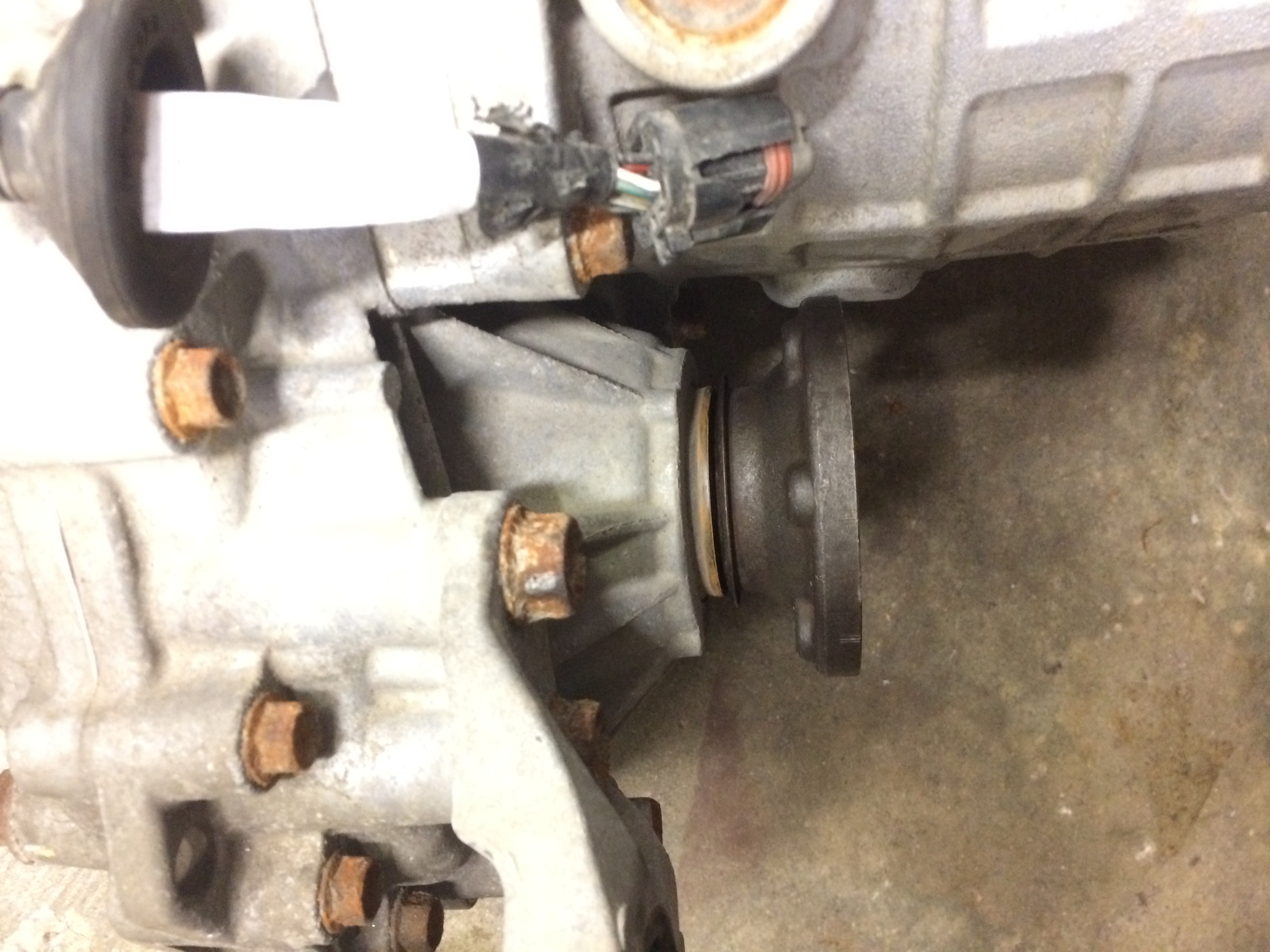

I just picked one of these up in a package deal. Pulled the axle stub... and thought the bearing seal looked close to...
A vw beetle stub flange!
Type 1/90mm will clear the motor. But a extruded boss on the motor comes close
If there’s enough room to shave the extruded boss, then a typ2 (100mm) cv flange should fit.

Bratitude wrote: Sun Sep 18, 2022 6:08 am A vw beetle stub flange!
Type 1/90mm will clear the motor. But a pressed in cap and boss come close A9CEA485-BC91-4585-9C41-0390C9A22ECA.jpeg
If there’s enough room the shave some of it down the n a typ2 (100mm) cv flange will fit.

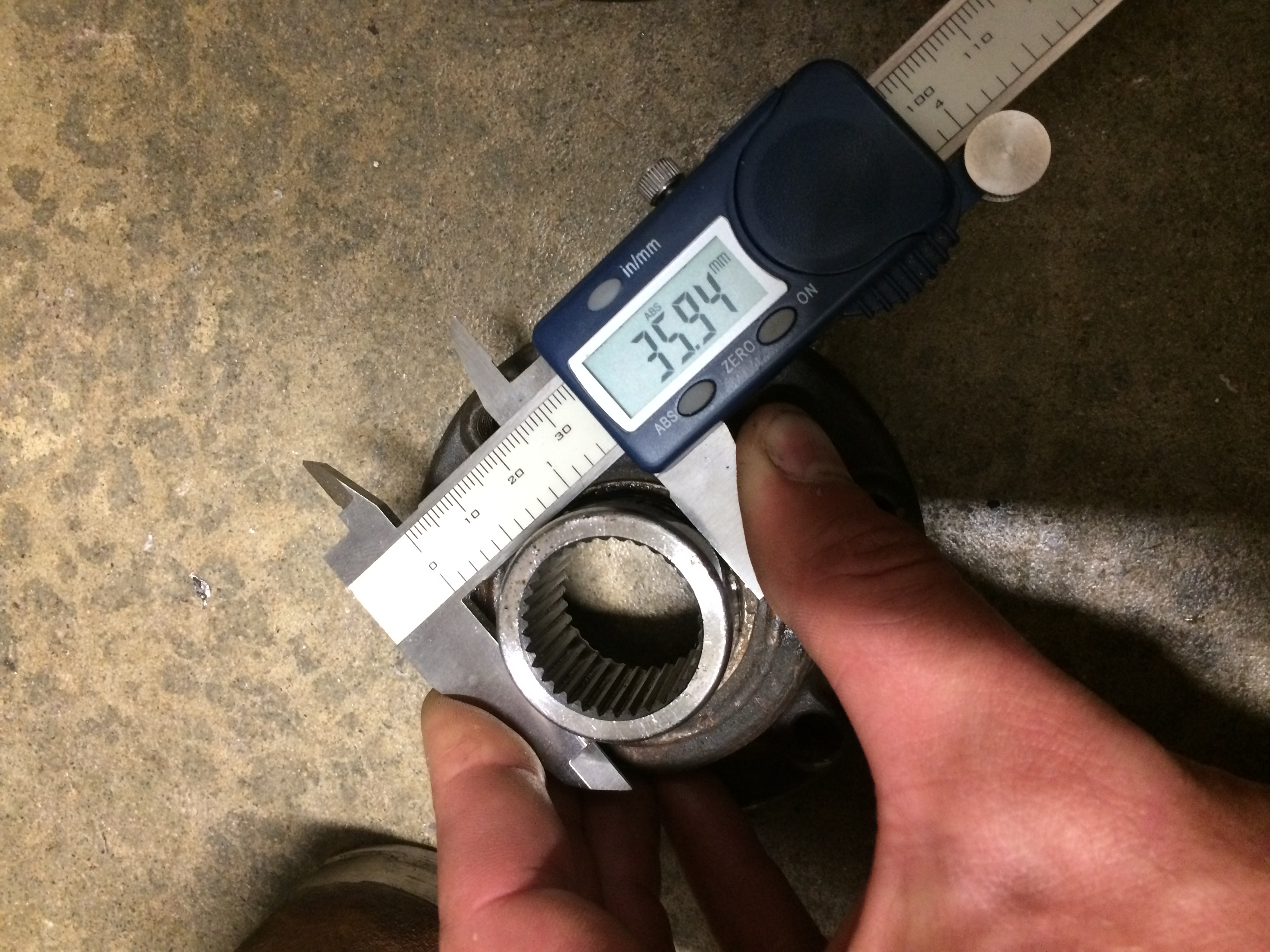

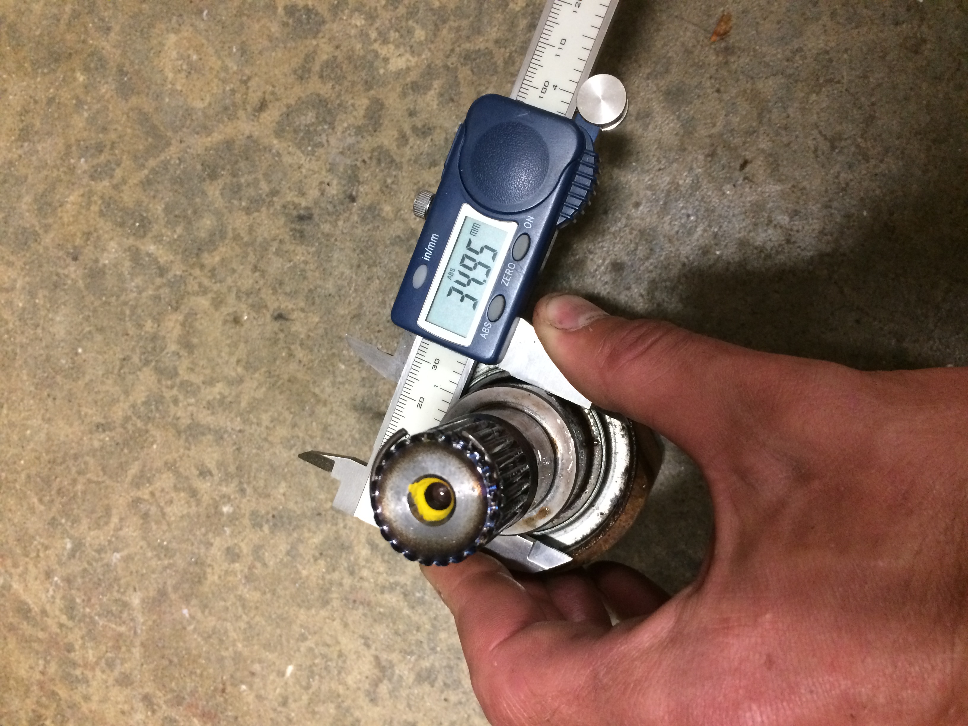

I am very interested in coming up with a drive shaft/flange solution as getting the shafts is getting difficult.

tom91 wrote: Sun Sep 18, 2022 4:41 pm I am very interested in coming up with a drive shaft/flange solution as getting the shafts is getting difficult.
The company im working with whom are cold rolling the stubs i have designed for the leaf gearbox, do all the oem prototypes. theyll have no problem making a stub for these.
is there any particular CV you have in mind? i was just thinking of making a stub shaft with the 33 vw spline so all the VW flanges fit. apposed to doing a full custom cv, say one that works with a mini shaft, would be very expensive.
