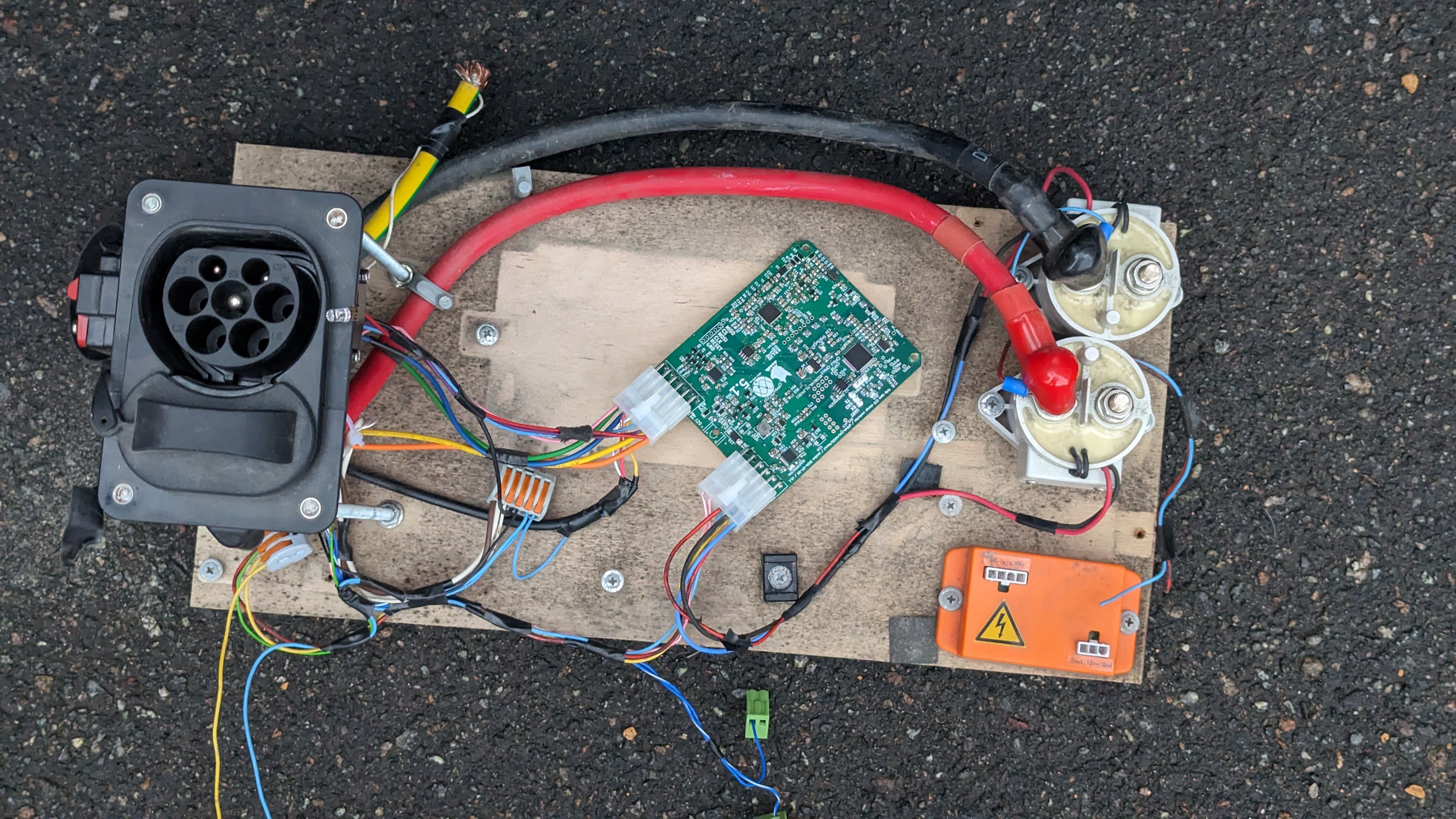

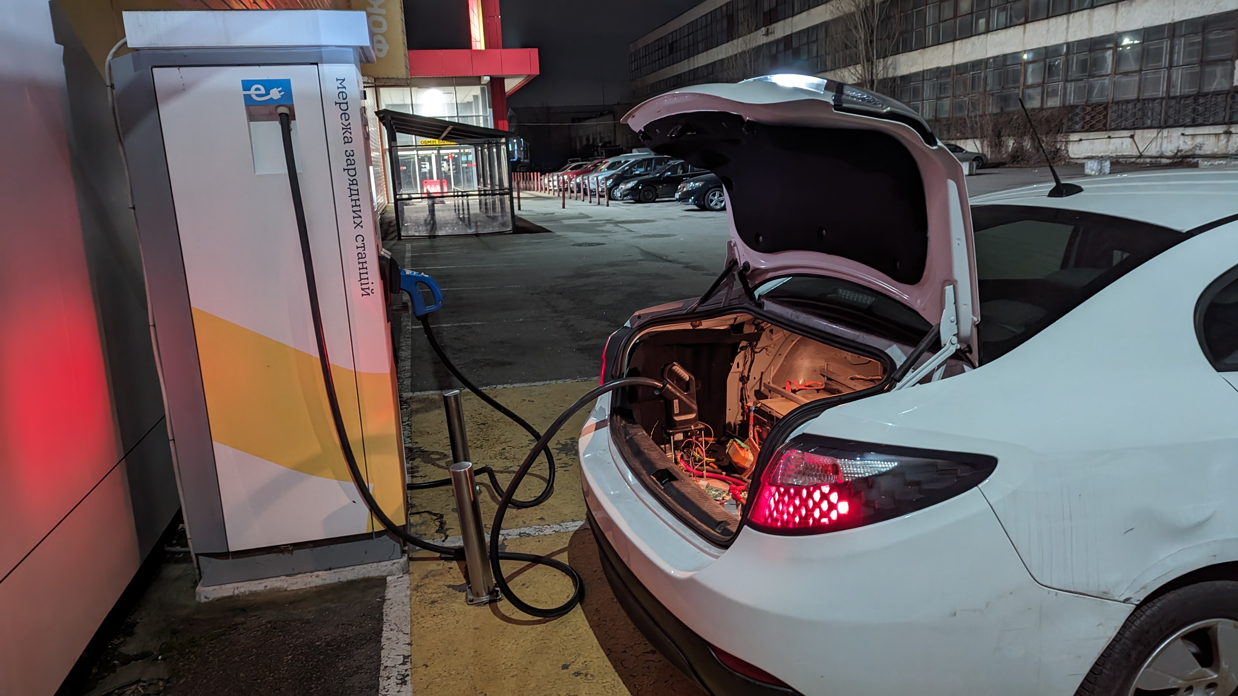

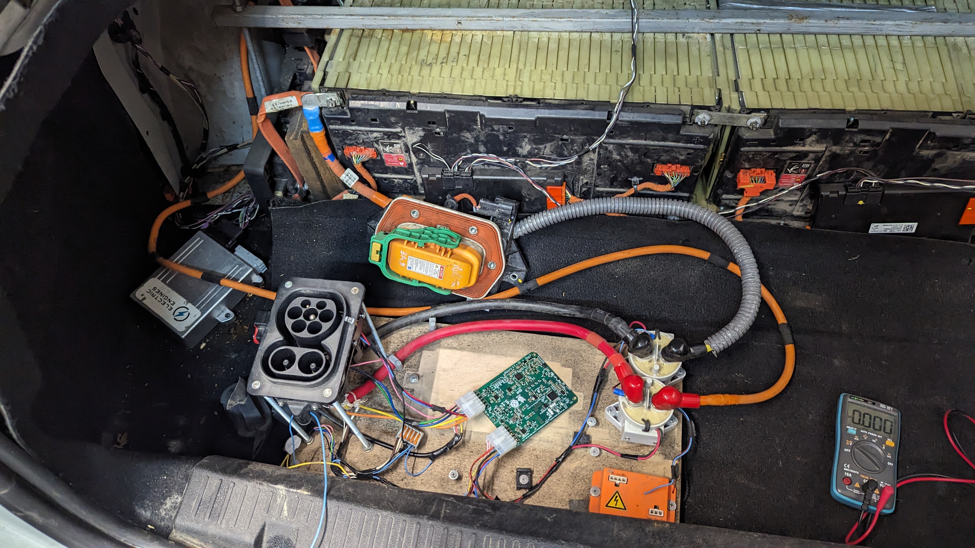

Hi! After long delay I am back to my Foccci.
Today I have first successful charging session!))) It is first Foccci in Ukraine!!)
I have project to implement ccs in Fluence ZE with custom battery (bms custom too). Now install Foccci without CAN connection with car, but next step implement it fully like OEM.
I delete one original charging port type 1, and install there type 2 combo. But think about best solution, for control OBC. I can emulate it by CAN, and make for car fake charging session, car close battery contactor. But I need to off OBC, one way is break 12v, or using relay for disconnect OBC from CAN.
I think about add new module CAN relay for realize it.

Great, congratulations. Surprisingly you found well matching connectors, seems to be a good alternative to the expensive Deutsch connectors. Where to obtain these, which partnumber do they have?

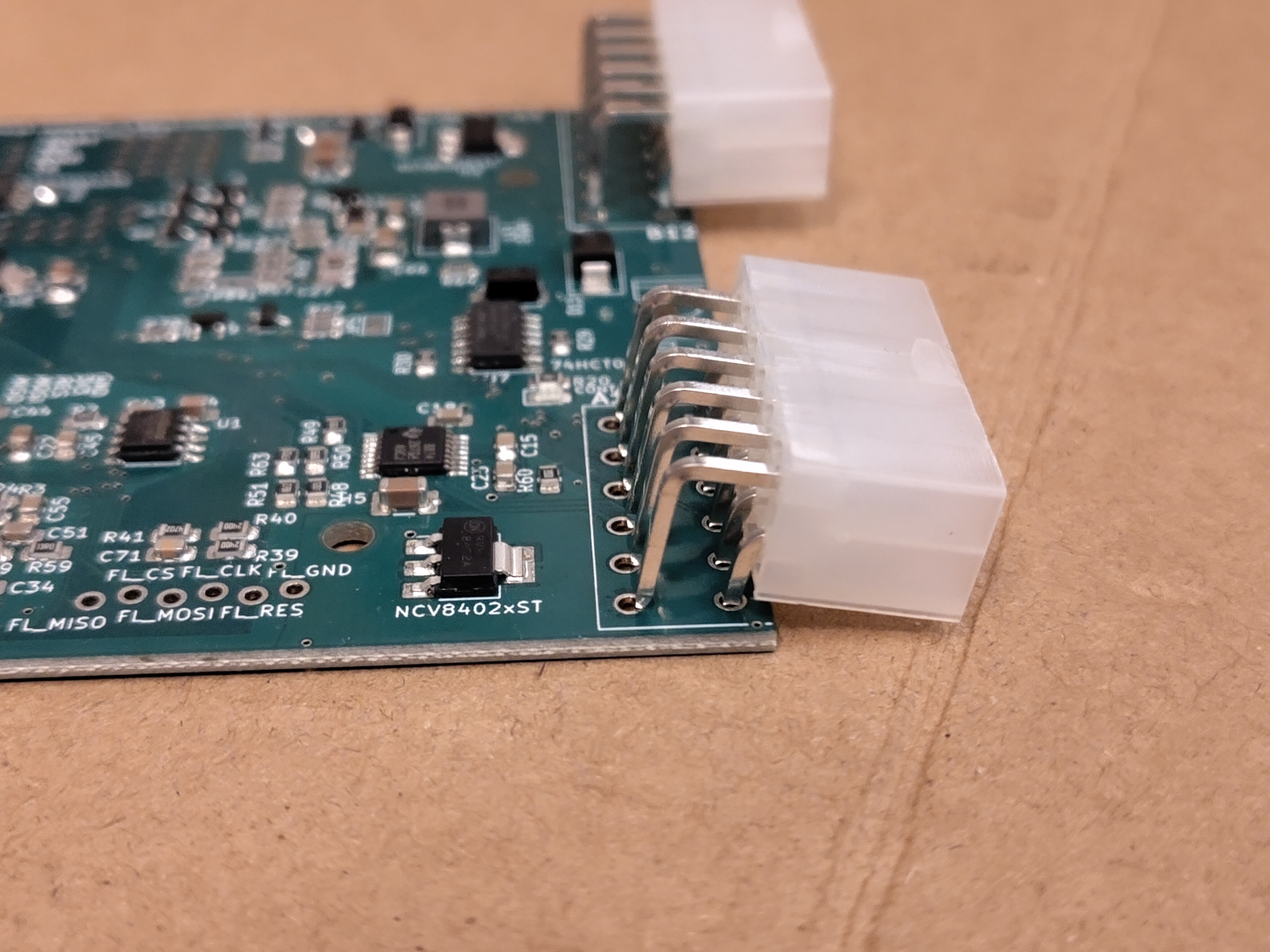

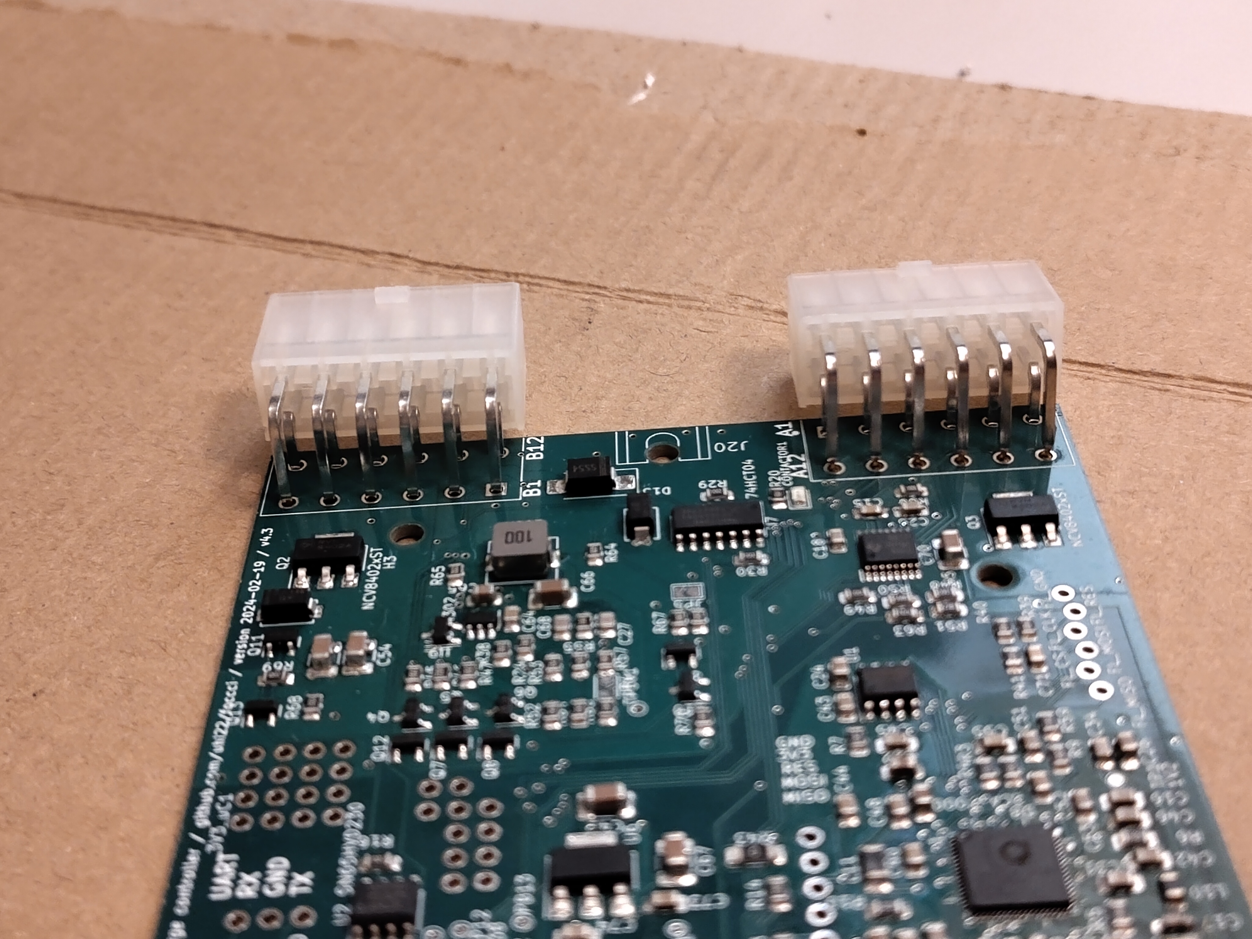

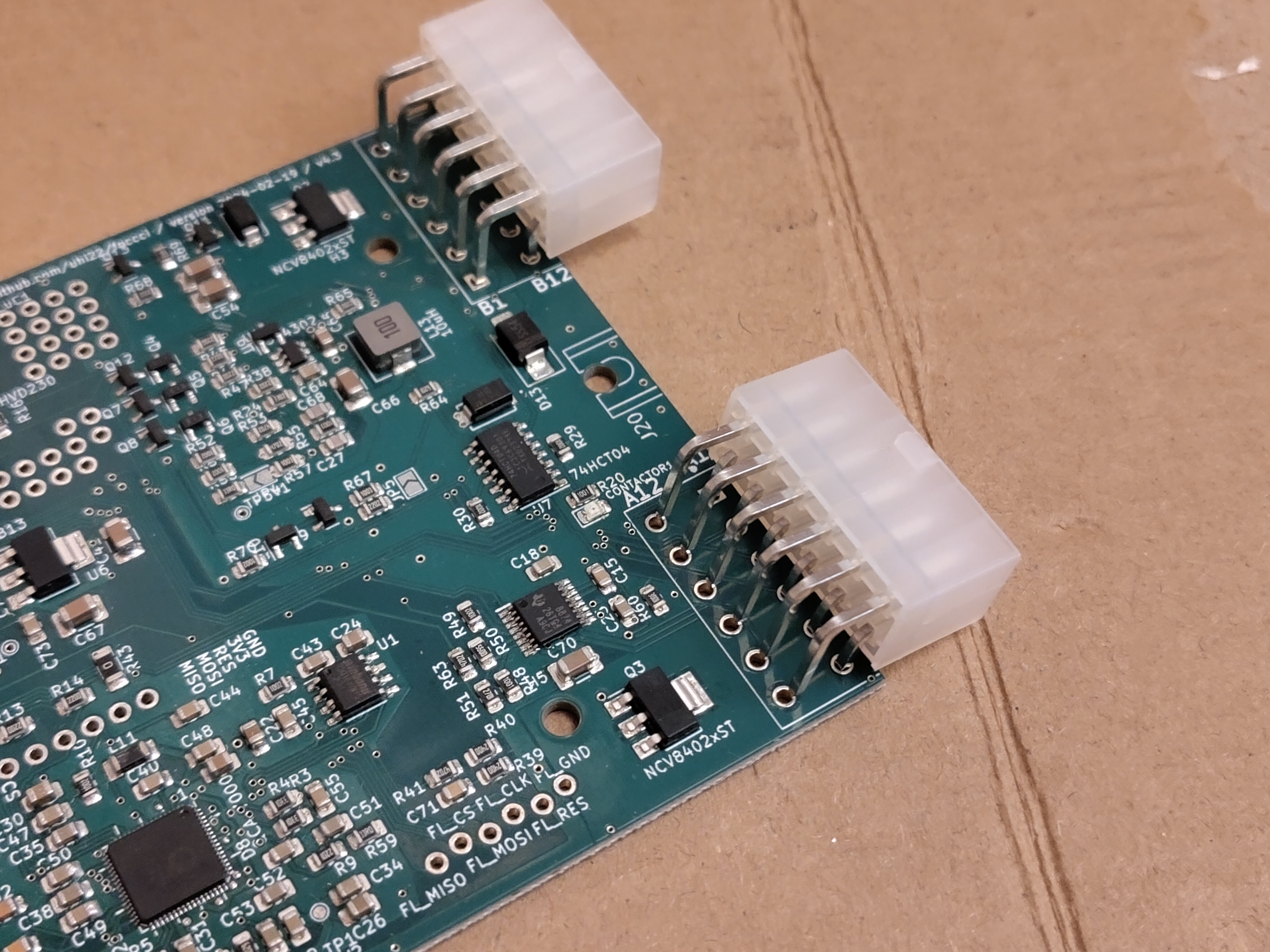

Those connectors are definitely Molex Mini-Fit (or one of the Chinese clones).
I have some, and an old spare Foccci. Here are some photos
EDIT: Part number is 35318-1220. And the female wire side header is 39-01-2120, and you need contacts also of course (I don't have those listed on my notes).
EDIT: The holes are very tight for these particular Chinese clones, I'm not sure I can push these fully in without damaging the board. It might make sense to enlarge the holes a bit.

^ that ^ looks more like the row spacing is off connector to footprint from the last 2 images.
If that is a common issue between 2 brands you could make one row or the other slotted holes so it's compatible with either.

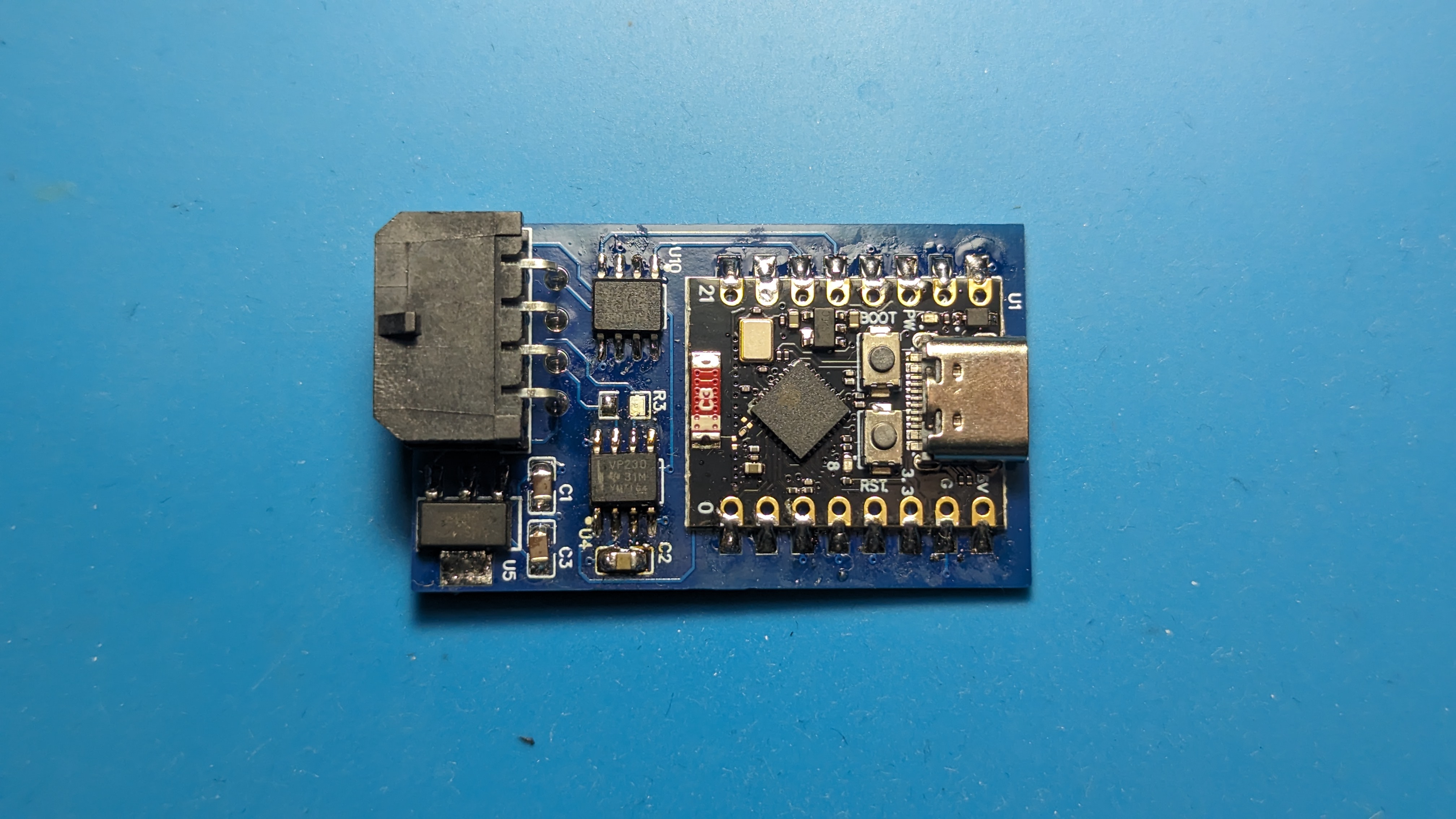

I am using molex minifit, but hole in pcb is small and connector not fully insert. I think about make next pcb for china cheap ECU box. What I don't like in this minifit, that 2 connector is the same and possible to confuse. Need use connector that have key.
I portable Johu Web interface to ESP32-C3, and delate native SD card support because this esp is not supported it. And also I make small board only for web ui
Is it possible to make Foccci send fixed CAN message, like example, id 423 data: 10 20 30 40 50 60 70 80, with delay 100 Ms?
I want to add one more digital output for off OBC.

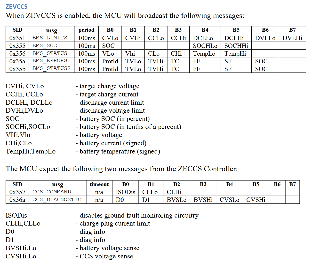

Working on my CAN mapping and I think I need some help, please. My BMS (Thunderstruck MCU) supports the ZEV/Fellten CCS controller so that's what I'm trying to emulate. I have most of it mapped but there are some messages in each direction that have me stumped.
Here's a snip of the BMS CAN data (And I did compare against what's in the Orion BMS software to grab scaling values etc). The first table shows everything the BMS broadcasts. Does anyone see something in here that I could map as the 'enable' message? Is there a way to link that to the BMS_ERRORS message so if the errors are false, that will serve as the 'enable' message?
The second table shows the messages the BMS is expecting back from Foccci.
For 0x357 / CCS_COMMAND I don't know if I need to send anything in byte 0 for ISODis. I DO have an isolation monitor but it's not part of the BMS (And for that matter, do I NEED to disable it during charging or can it keep running?).
For 0x36a / CCS_DIAGNOSTIC, this doesn't appear at all in the Orion software so I can't begin to guess at D0 and D1. Battery Voltage Sense seems to be taken downstream of the CCS contactors so if I just send back its own BatteryVoltage value it might think they are welded. What if I send EVSEVoltage for both Battery Voltage Sense and CCS Voltage Sense? Can I even do that?
If anyone else is using Foccci with the Thunderstruck MCU I would appreciate seeing your can mapping. If not, I will of course be happy to put my map on the wiki once it's verified working.

Nope there is none. You also need to keep in mind how you layout your contactors and such. (The Zero EV CCS/Fellten CCS system is designed to control all contactors) You could just have an external logic that does the contactors and checks there are no errors on the BMS or if a physical output of the MCU for charging is enabled.
Yes
Are you also looking to have the Thunderstruck MCU control the Onboard AC Charger? The Fellten CCS system auto starts AC charging sessions and lets the BMS handle the current limiting and voltage limiting of the Onboard AC Charger. The sent current limit over CAN form the ccs controller is the cable current limit.
Re: QCA7000 Foccci+Clara User thread
Okay, thanks for confirming those things. Yes I'm planning to have the MCU control the OBC. From what I understand, I need to configure Foccci to pull the wakeup line high when plugged in, which connects to an input on the MCU. Foccci sends the AC current limit via CAN and the MCU takes it from there.
So it sounds like the things I'm missing are:
-An isolation monitor disable message while charging
-An enable message to Foccci (that sets true as long as the errors are all false)
-Unknown diagnostic information back to the MCU
I suppose there's no way to do that with the hardware I've got, but a simple Arduino sketch should do the trick.

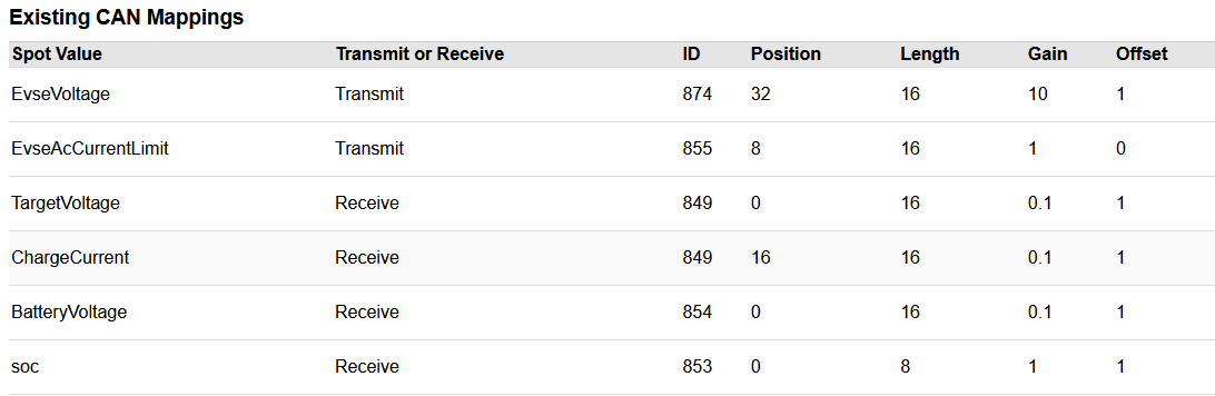

I'm still at the early stages of learning CAN stuff. So hopefully I understand this correctly.. opmode has two possible states, 0 and 1 (?), and the gain is applied as a multiplier, then offset adds to that?
So if it's 0.. 0 x -1[the gain]= 0, then 0 + 1[the offset] = 1
And if it's 1... 1 x -1 = -1, then -1 + 1 = 0?
- Posts: 6969
- Has thanked: 455 times
- Been thanked: 1771 times
Mathematically it's canVal = trunc(gain * spotVal) + offset
So if you want to use opmode you can choose where to make the cut. E.g. state CableCheck has numerical value 10. If you want your bit to become 1 when CableCheck (and the states thereafter) are reached you go
canVal=trunc(0.1 * opmode). At state 10 (CableCheck) this will evaluate to 1, before CableCheck to 0.
If you'd rather invert it you can pull the same trick as above
canVal=trunc(-0.1 * opmode) + 1
non-inverted
inverted
non-inverted

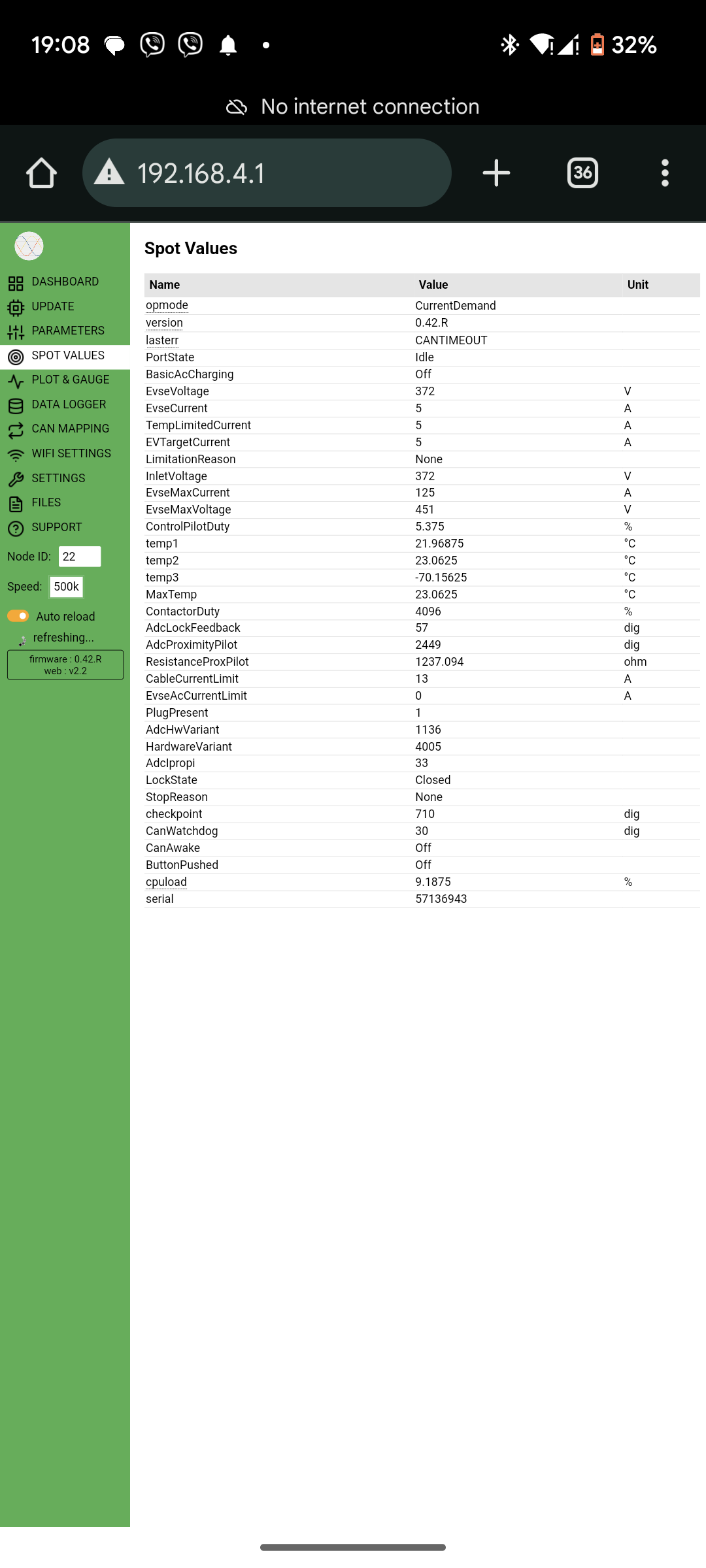

can tx opmode <id> 0 1 0.1Code: Select all
can tx opmode <id> 0 1 -0.1 1Support R/D and forum on Patreon: https://patreon.com/openinverter - Subscribe on odysee: https://odysee.com/@openinverter:9
Oh, very cool! Thanks for that, I never realized you could do it with a spot value with had more than two states!
