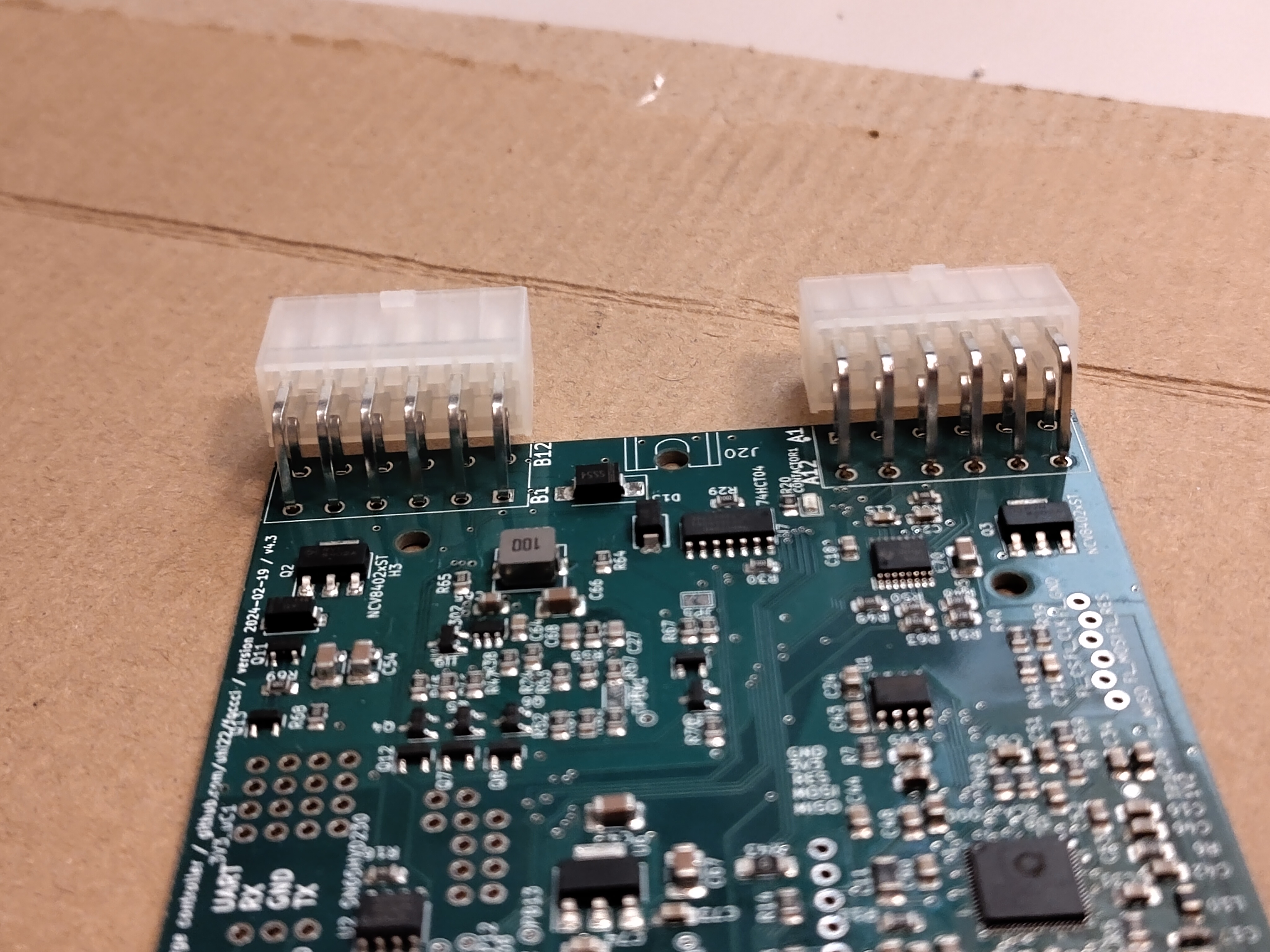

Those connectors are definitely Molex Mini-Fit (or one of the Chinese clones).
I have some, and an old spare Foccci. Here are some photos
EDIT: Part number is 35318-1220. And the female wire side header is 39-01-2120, and you need contacts also of course (I don't have those listed on my notes).
EDIT: The holes are very tight for these particular Chinese clones, I'm not sure I can push these fully in without damaging the board. It might make sense to enlarge the holes a bit.

^ that ^ looks more like the row spacing is off connector to footprint from the last 2 images.
If that is a common issue between 2 brands you could make one row or the other slotted holes so it's compatible with either.

I am using molex minifit, but hole in pcb is small and connector not fully insert. I think about make next pcb for china cheap ECU box. What I don't like in this minifit, that 2 connector is the same and possible to confuse. Need use connector that have key.

Molex minifit connectors are something I'd never use based on my history of the female terminals going bad in a short amount of time in a medium vibration product.
These seem to be extremely sensitive to crimping technique and even perfect looking machine made crimps are susceptible. Molex crimped cables seem better but still might be susceptible, i never got to test them fully.
I believe a large part of the issue i saw was less than ideal strain relief on the wires close to the connectors, so it put the load on the crimps and weakened / stretched them over time which led to bad connections.
So at the very least i'd recommend good strain reliefs close to the connector. Might be worth swapping out the connector if you guys start seeing issues or consider a dual footprint soon so it's an easier swap.

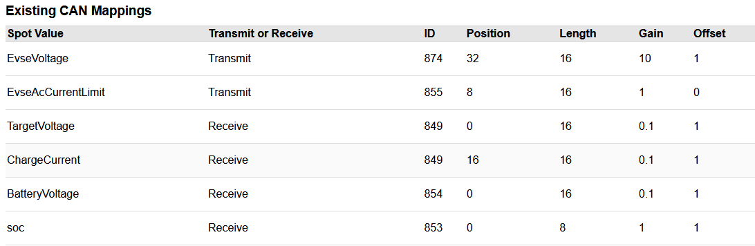

Working on my CAN mapping and I think I need some help, please. My BMS (Thunderstruck MCU) supports the ZEV/Fellten CCS controller so that's what I'm trying to emulate. I have most of it mapped but there are some messages in each direction that have me stumped.
Here's a snip of the BMS CAN data (And I did compare against what's in the Orion BMS software to grab scaling values etc). The first table shows everything the BMS broadcasts. Does anyone see something in here that I could map as the 'enable' message? Is there a way to link that to the BMS_ERRORS message so if the errors are false, that will serve as the 'enable' message?
The second table shows the messages the BMS is expecting back from Foccci.
For 0x357 / CCS_COMMAND I don't know if I need to send anything in byte 0 for ISODis. I DO have an isolation monitor but it's not part of the BMS (And for that matter, do I NEED to disable it during charging or can it keep running?).
For 0x36a / CCS_DIAGNOSTIC, this doesn't appear at all in the Orion software so I can't begin to guess at D0 and D1. Battery Voltage Sense seems to be taken downstream of the CCS contactors so if I just send back its own BatteryVoltage value it might think they are welded. What if I send EVSEVoltage for both Battery Voltage Sense and CCS Voltage Sense? Can I even do that?
If anyone else is using Foccci with the Thunderstruck MCU I would appreciate seeing your can mapping. If not, I will of course be happy to put my map on the wiki once it's verified working.

Nope there is none. You also need to keep in mind how you layout your contactors and such. (The Zero EV CCS/Fellten CCS system is designed to control all contactors) You could just have an external logic that does the contactors and checks there are no errors on the BMS or if a physical output of the MCU for charging is enabled.
Yes
Are you also looking to have the Thunderstruck MCU control the Onboard AC Charger? The Fellten CCS system auto starts AC charging sessions and lets the BMS handle the current limiting and voltage limiting of the Onboard AC Charger. The sent current limit over CAN form the ccs controller is the cable current limit.

Okay, thanks for confirming those things. Yes I'm planning to have the MCU control the OBC. From what I understand, I need to configure Foccci to pull the wakeup line high when plugged in, which connects to an input on the MCU. Foccci sends the AC current limit via CAN and the MCU takes it from there.
So it sounds like the things I'm missing are:
-An isolation monitor disable message while charging
-An enable message to Foccci (that sets true as long as the errors are all false)
-Unknown diagnostic information back to the MCU
I suppose there's no way to do that with the hardware I've got, but a simple Arduino sketch should do the trick.

That might not even be used by the MCU, I believe its for the Orion 2 tool debug info.
Only while CCS charging

Proposal:
- Foccci shall provide a signal "DisableVehicleSideIsolationMonitoring".
- The purpose of this signal is, to turn off the vehicle side isolation monitoring while the CCS charging station is connected to the battery. Because the charging station contains also an isolation monitoring, and having both isolation monitorings active at the same time will lead to unexpected isolation fault reports.
- Foccci shall set this signal to 1 during the PreCharge state. Because, after the precharge Foccci will close the contactors, and we want to give some time to distribute the signal to the receiver, BEFORE closing the contactors.
- Foccci shall keep this signal at 1 during CurrentDemand.
- Foccci shall set the signal to 0 as soon as it opens the contactors.
Does this make sense? Any other ideas?

Yeah, that would be awesome! Is it possible to invert that as well? I think my monitor (Bender ISO165c-1) needs a 1 when it's supposed to be active and 0 for inactive.

In this case we name it EnableVehicleSideIsolationMonitoring. Or stick to the first proposal and use the CAN mapping with gain -1? Would this work?

Could send both signals with 1 having inverted output logic and give people the ability to choose. That makes it a bit more confusing though. Something like
and
DisableVehicleSideIsolationMonitoringInverted
The inverted makes it a bit clearer not to use it except special cases.
Gain -1 also need abs to work?
and

Re: QCA7000 Foccci+Clara User thread
In my opinion Foccci shouldn't target specific peripherals but rather output it's own state and other devices can choose to act on that. With opmode this already happens.
In addition a ContactorState variable could be added
So offset 1, gain -1 would invert
y=1-x

Hmm, if it works with an existing spot value then so much the better.
I'm still at the early stages of learning CAN stuff. So hopefully I understand this correctly.. opmode has two possible states, 0 and 1 (?), and the gain is applied as a multiplier, then offset adds to that?
So if it's 0.. 0 x -1[the gain]= 0, then 0 + 1[the offset] = 1
And if it's 1... 1 x -1 = -1, then -1 + 1 = 0?

Mathematically it's canVal = trunc(gain * spotVal) + offset
So if you want to use opmode you can choose where to make the cut. E.g. state CableCheck has numerical value 10. If you want your bit to become 1 when CableCheck (and the states thereafter) are reached you go
canVal=trunc(0.1 * opmode). At state 10 (CableCheck) this will evaluate to 1, before CableCheck to 0.
If you'd rather invert it you can pull the same trick as above
canVal=trunc(-0.1 * opmode) + 1
non-inverted
inverted
non-inverted
can tx opmode <id> 0 1 0.1
can tx opmode <id> 0 1 -0.1 1

Oh, very cool! Thanks for that, I never realized you could do it with a spot value with had more than two states!

To avoid confusion of the integrator by such kind of calculations, just added a new spot value which can be mapped to CAN directly (or inverted). With a name which hopefully helps to understand the purpose: VehicleSideIsoMonAllowed. This is normally 1, to allow the isolation monitoring, and is turned to 0 during PreCharge and back to 1 at the end of the session.
Commit: https://github.com/uhi22/ccs32clara/com ... 4e3928e30d
Binaries (CI#92): https://github.com/uhi22/ccs32clara/act ... 3561848940
Wiki updated: https://openinverter.org/wiki/Foccci#Spot_values
