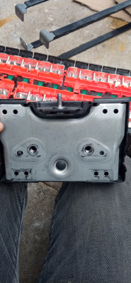

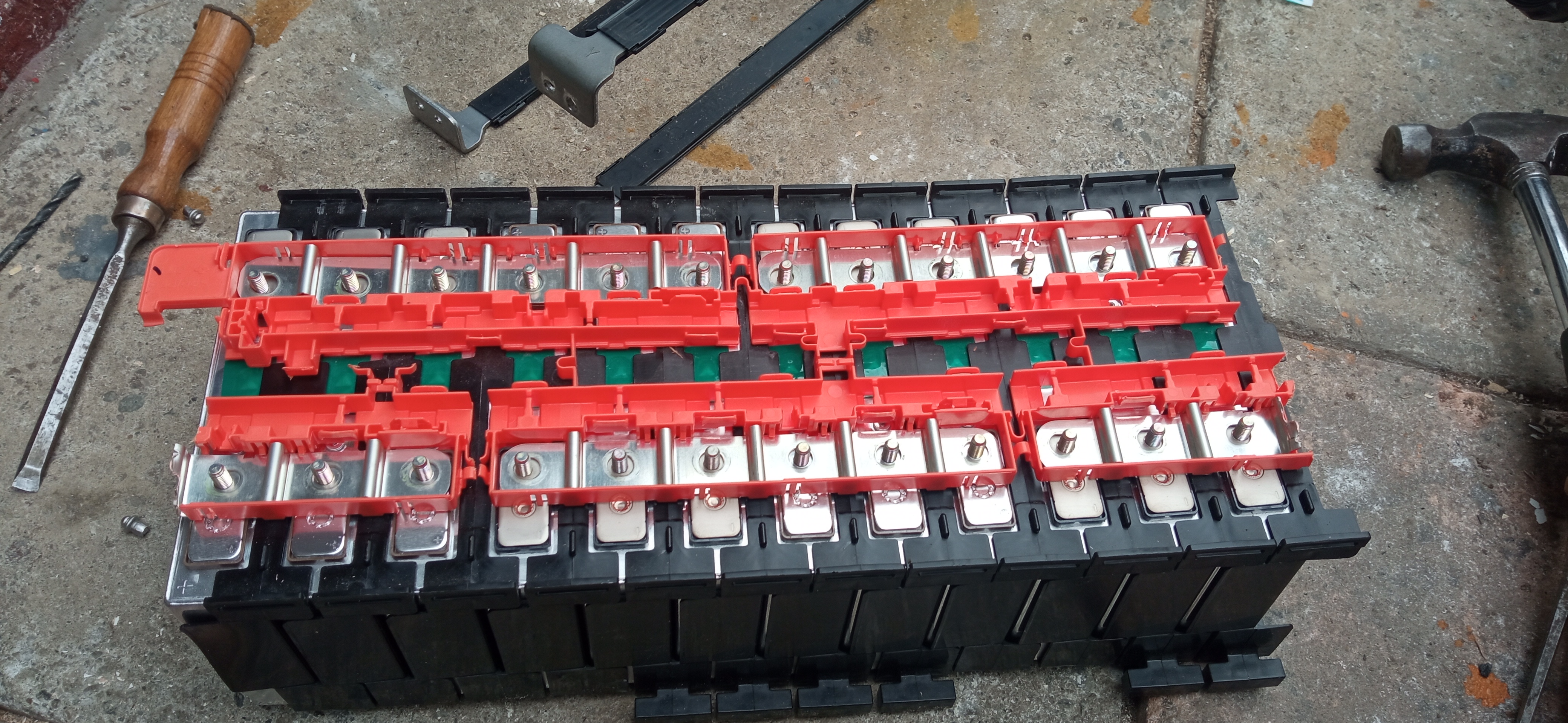

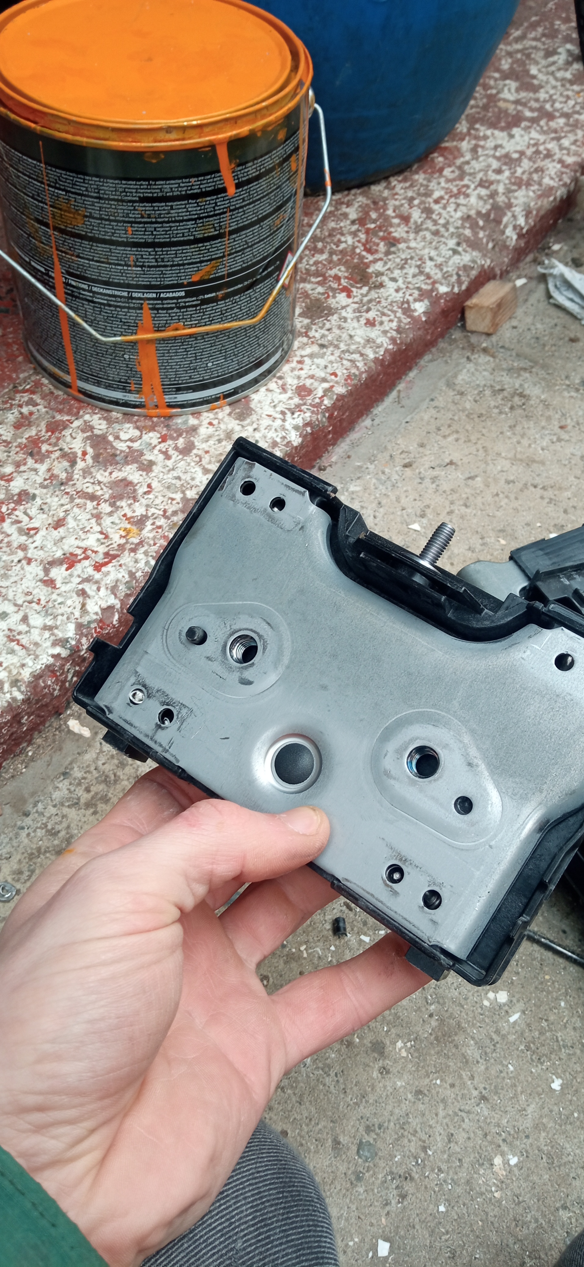

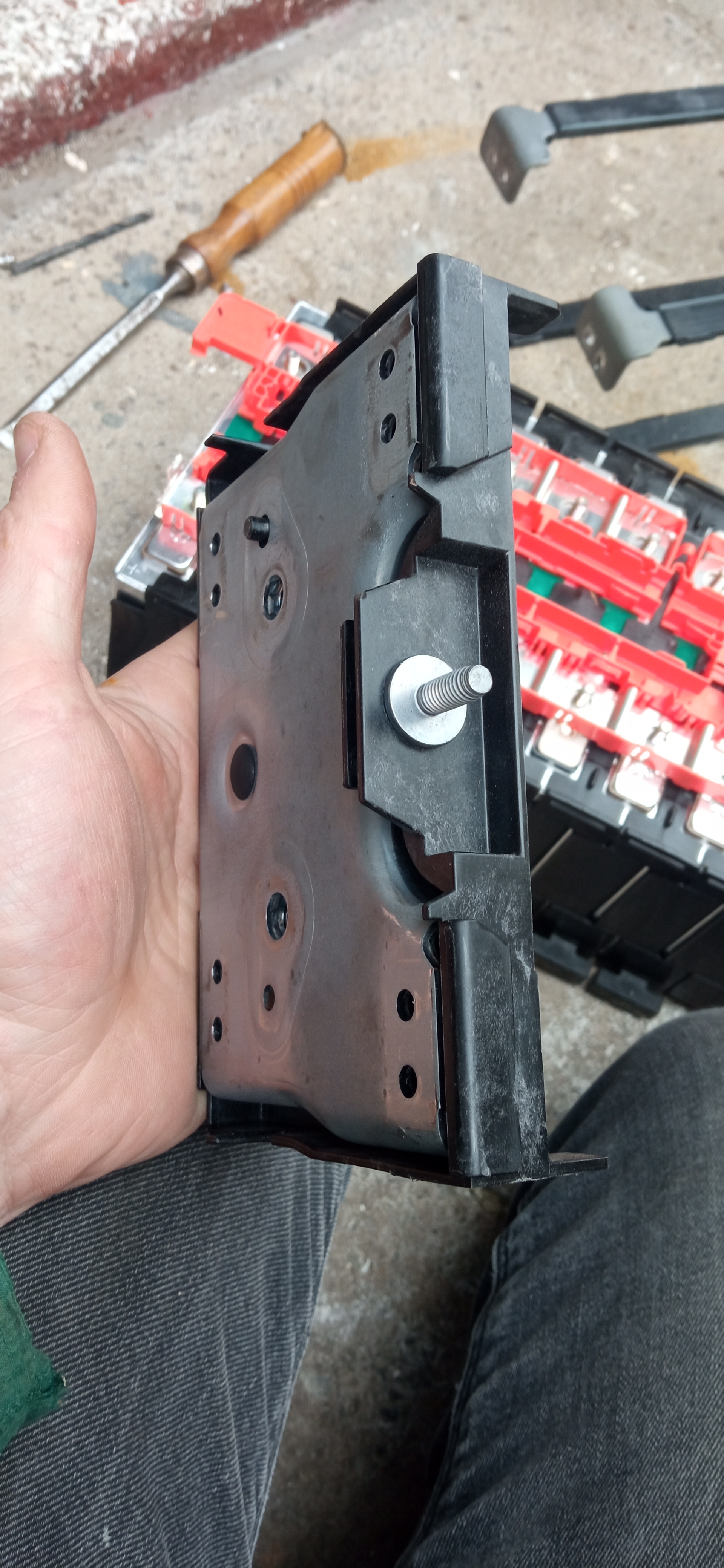

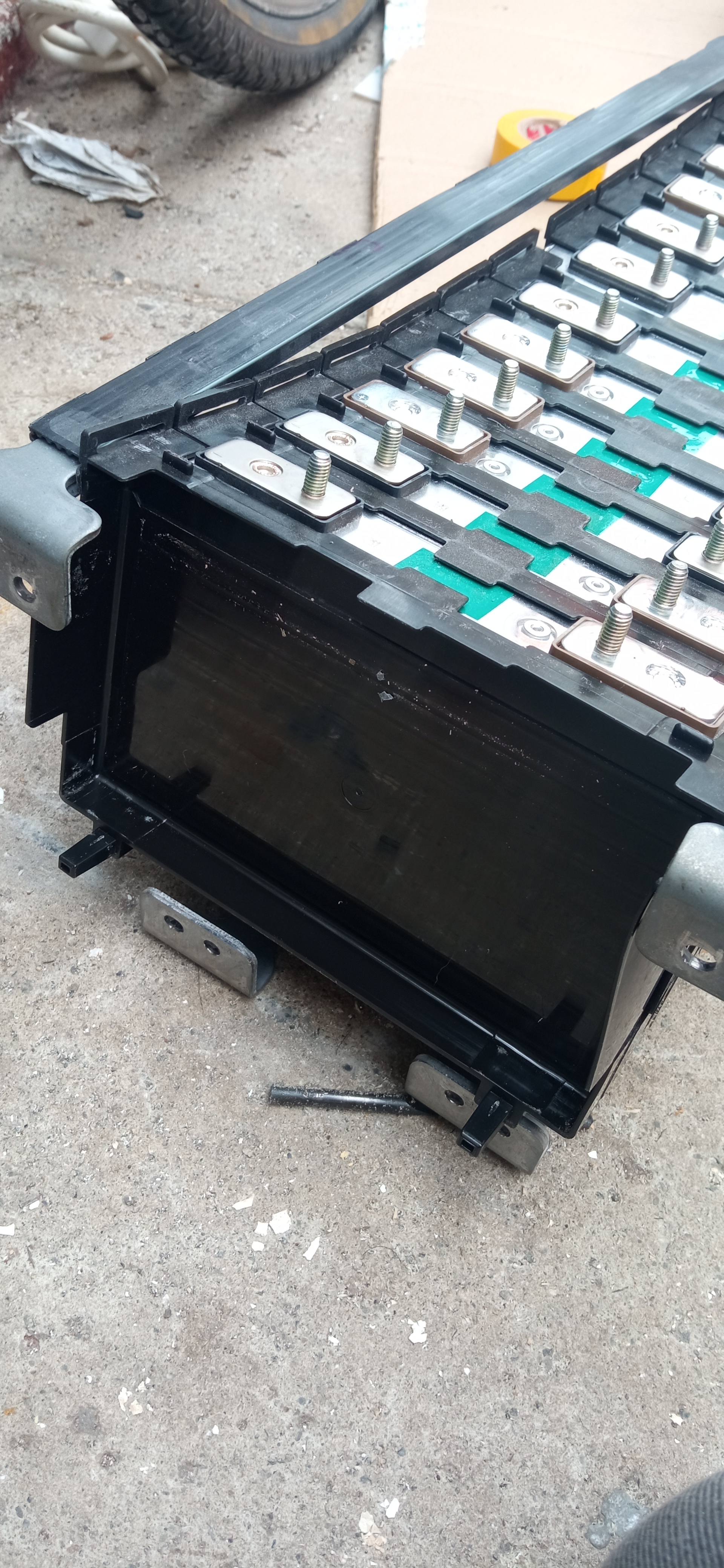

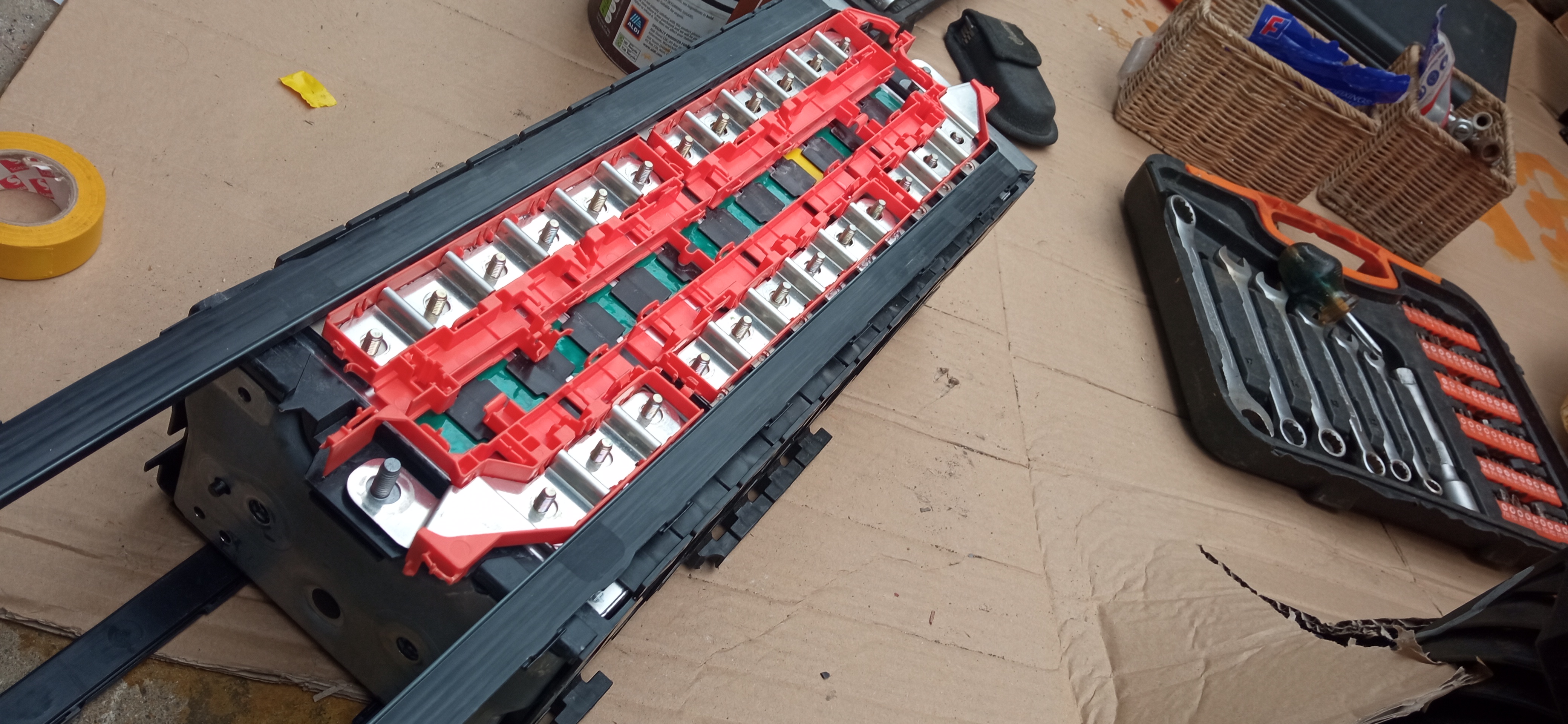

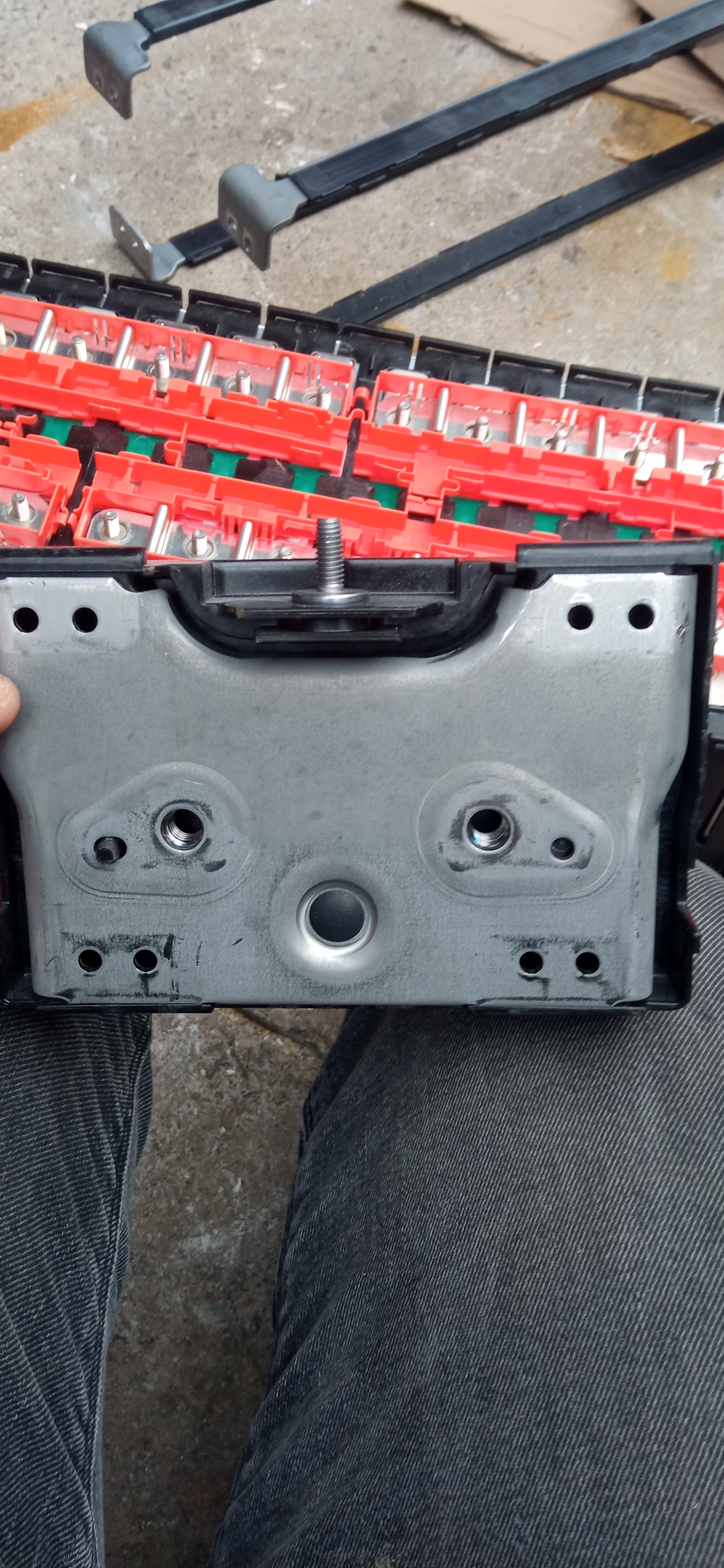

So, whilst waiting on the 40kWh leaf BMS to turn up (that may not work due to split battery boxes and needing to extend cell tap lengths....) I've finally committed to a battery box design. I've got for a mirrored pair either side of the prop shaft. To do this I can keep all the battery modules as they are with one of the small 8S3P modules being split between into 2no. 4s3p modules.
This meant drilling out 8 rivets on the end plates which allowed the removal of the end plate and thus breaks the modules into separate 24no. cells
With a bit of cutting I've managed to make the original plastic routing and cell tap connectors work for both of the mini modules and if I can get someone to show me how to 3d scan the plastic end plates I can then 3d print those and fabricate the metal parts to mimic the existing setup with some metal bar rivetted or screwed in to tie the modules back together. It does make me consider breaking the modules down completely and trying to make them fit somewhere else but in order to keep things simple and move forward I'm going to stick with this arrangement.
The battery boxes will be made up of a separate bottom piece with structure to hold the modules in place. This will hold 3 long modules next to one another and the mini module to the rear at 90 degrees as the bottom layer, then an upper tier of 1 long module module and 1 short module next to one another. I think there should be enough room for a BMS, Shunt and contactors in the box in dead space. There will then be a lid that is comprised if the top and sides which will sit on top and be fastened around the bottom.

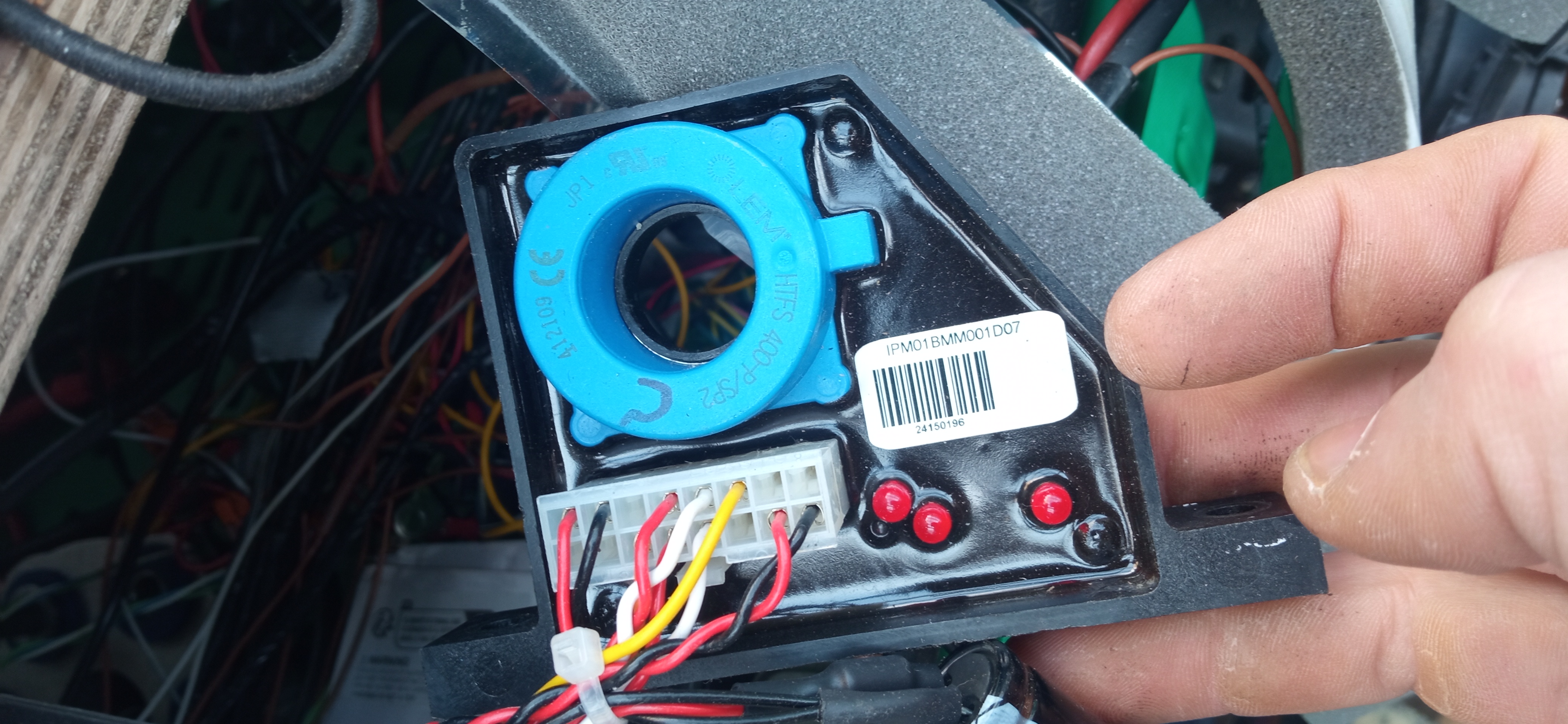

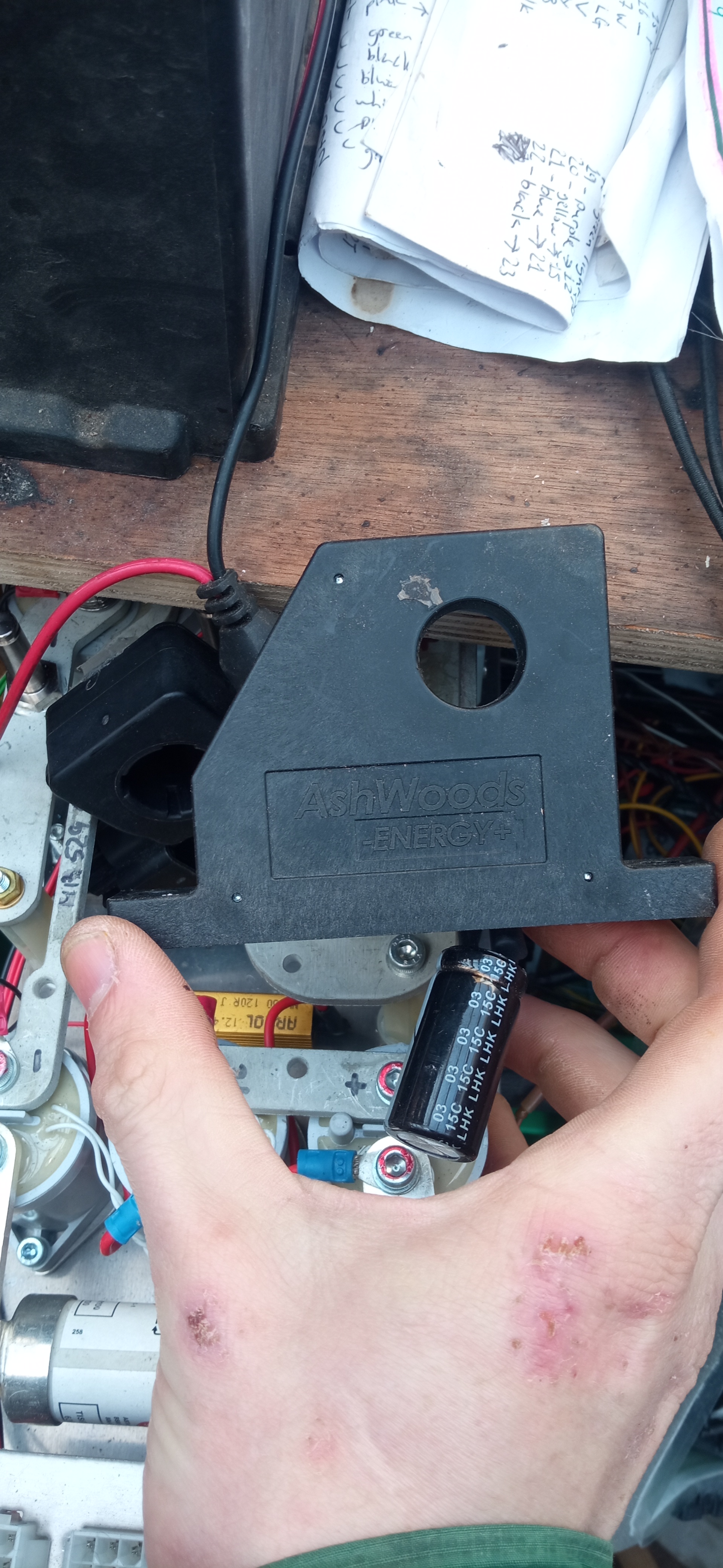

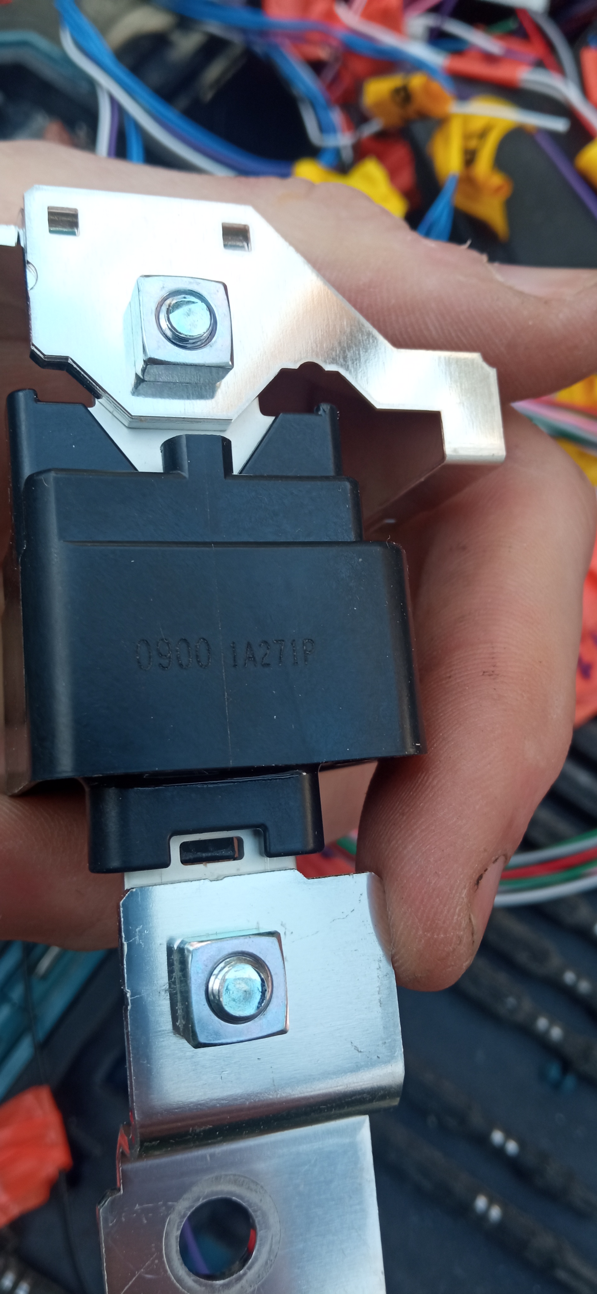

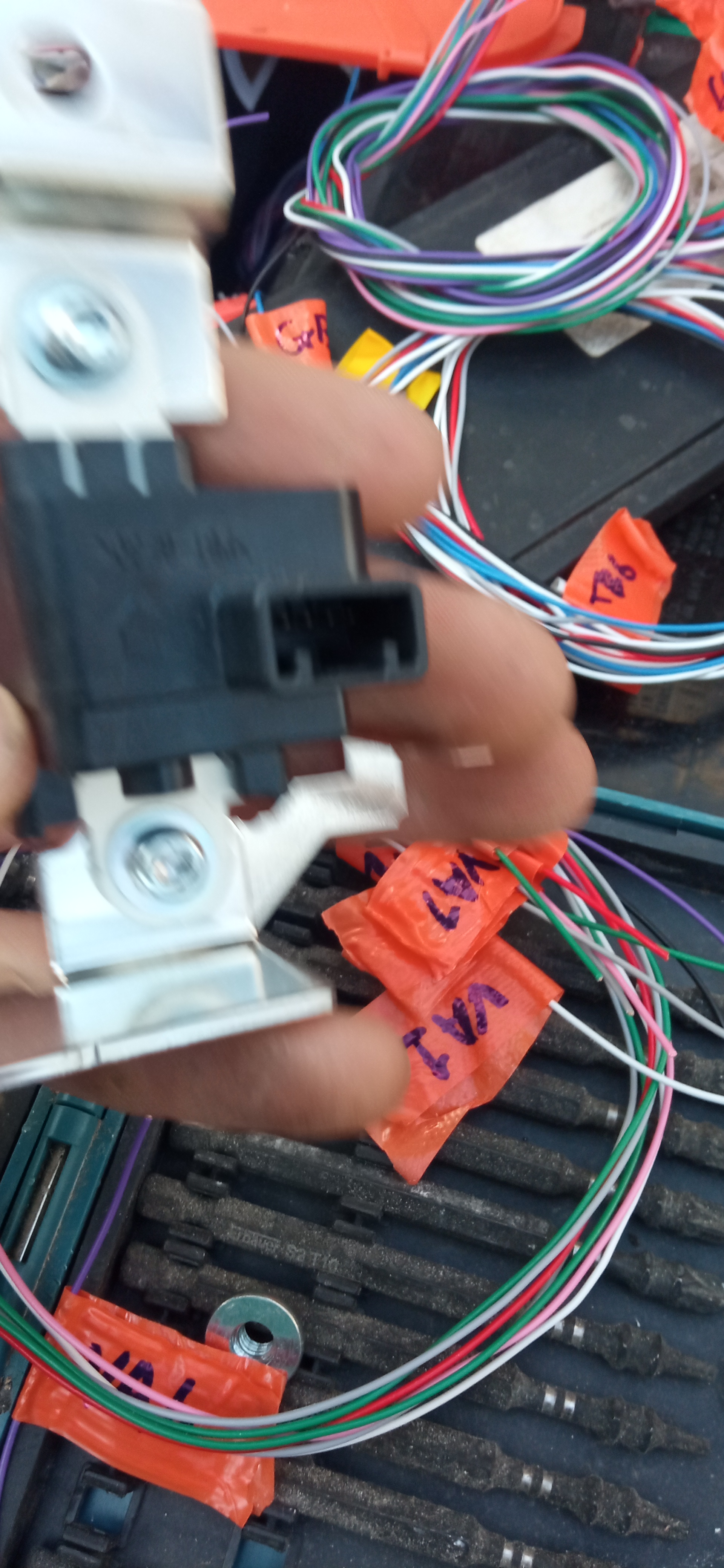

On another note, current sensors. Are they easy to reverse engineer? I've got my hands on 3, one from the Lexus UX300E pack and another 2 from a random contactor setup I bought for cheap one of which is a low voltage LEM one. I don't know the parameters for any of them but it'd be nice if I could reuse them. Any guidance?
Been thanked: 1913 times
Re: [WIP] Mercedes 310E (310D campervan) - GS450H/GS300H
The blue one is the LEM HTFS, 5V supply, output centered at 2.5V. The other ones I don't know. You need to figure out which are the supply voltage pins, e.g. with a 50 mA current limited 5V supply. When a third pins spits out around 2.5V you've nailed it. Some are asymmetrical centered at 3V or something. Some need 15V or even +/-15V. Search for the part number if readable

johu wrote: Thu Apr 25, 2024 1:39 pm You need to figure out which are the supply voltage pins, e.g. with a 50 mA current limited 5V supply. When a third pins spits out around 2.5V you've nailed it.
Is this likely applicable to both sensors or just the LEM hall effect one? From the data sheet the LEM one is only suitable for 300V so no good for me but the other is the Lexus one, a Google of the number doesn't bring anything up unfortunately but I'll search further. It's also a 5 pin sensor, I've got the pin out from the lexus wiring diagram, pins are as follows...
1 - IBL
5 - IB1
3 - IB0
4 - GIB
5 - VIB

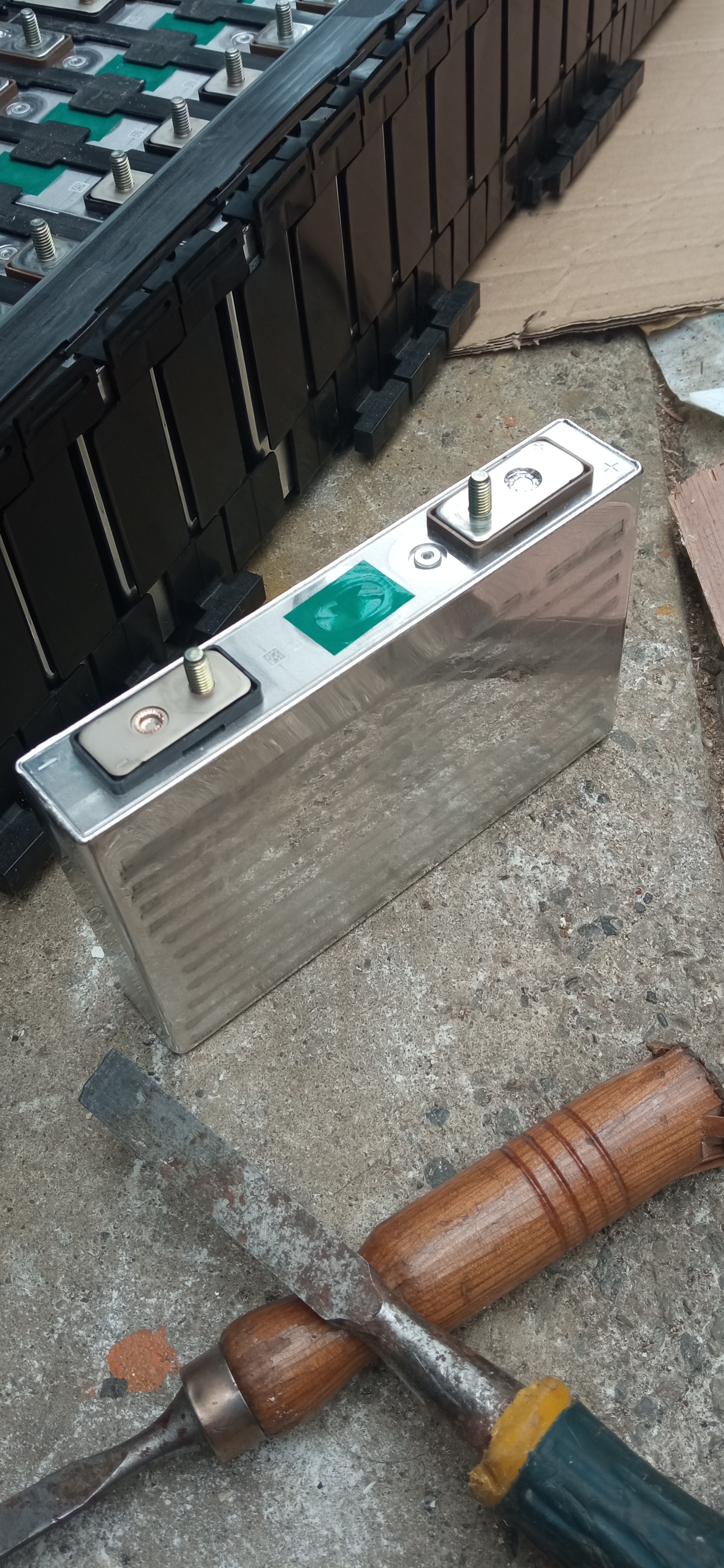

I'm currently rigging up some form of compressor to squeeze some cells back into their original packaging after disassembling one of the UX300E modules to explore alternative battery back options and in waiting on some threaded bar to turn up to do so.

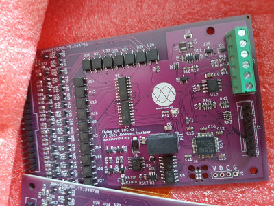

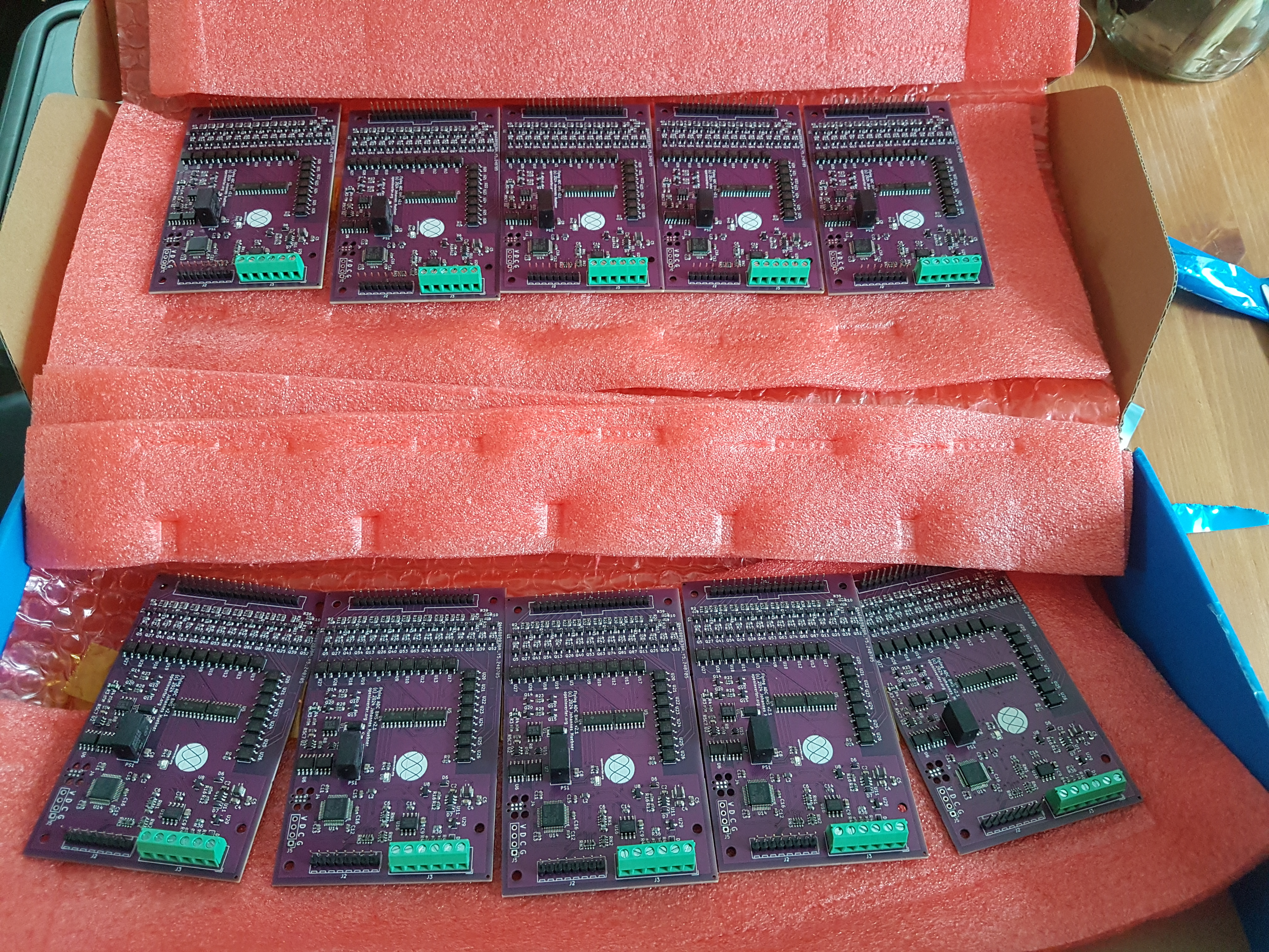

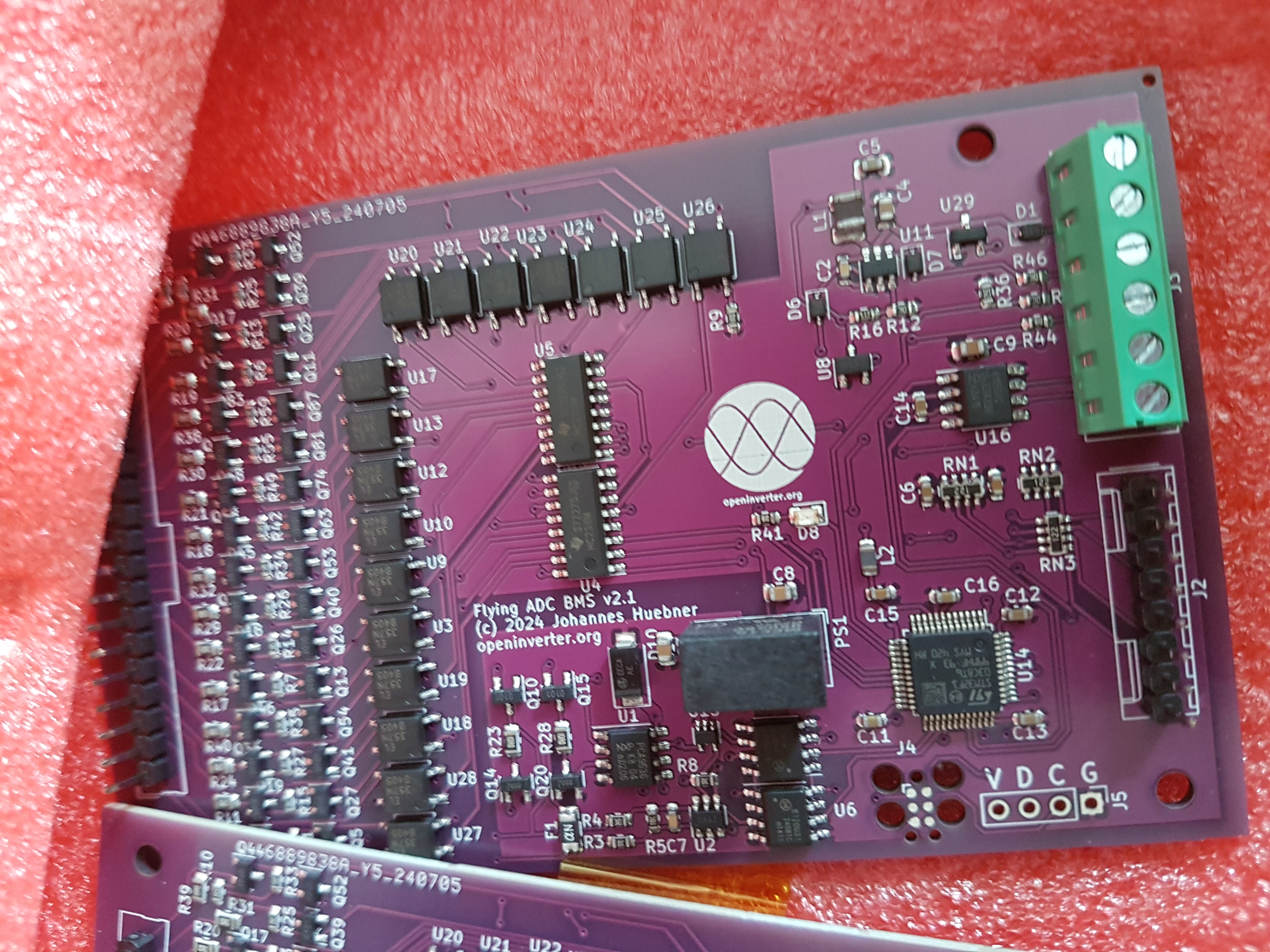

10 of Johus finest 16 channel Flying BMS boards turned up from JLCPCB. I did need to tweak the manufacturing files a little bit as some components weren't placed correctly on the CPL file I had for some reason and I added male headers and a screw clamp to the board but they look pretty good I think.
Once I've got them all flashed and working I'll probably sell off the 4 I don't need if anyone is interested.
Headers are quite shit connectors for automotive applications. No real way of retaining the connector and ensuring a good connection.

Post by Jacobsmess »
tom91 wrote: Fri Jul 12, 2024 2:06 pm Headers are quite shit connectors for automotive applications. No real way of retaining the connector and ensuring a good connection.
Sure but for now they'll work, they cost very little and they won't be difficult to swap for something better. I was going round in circles trying to find something that had the right spacing, connection type and number of pins that was available from JLC. If you've any recommendations on options that would be great. Ideally I'd have something that wired direct to the board with the male receiving connector in the BMS housing or some sort of solid pin connection.
