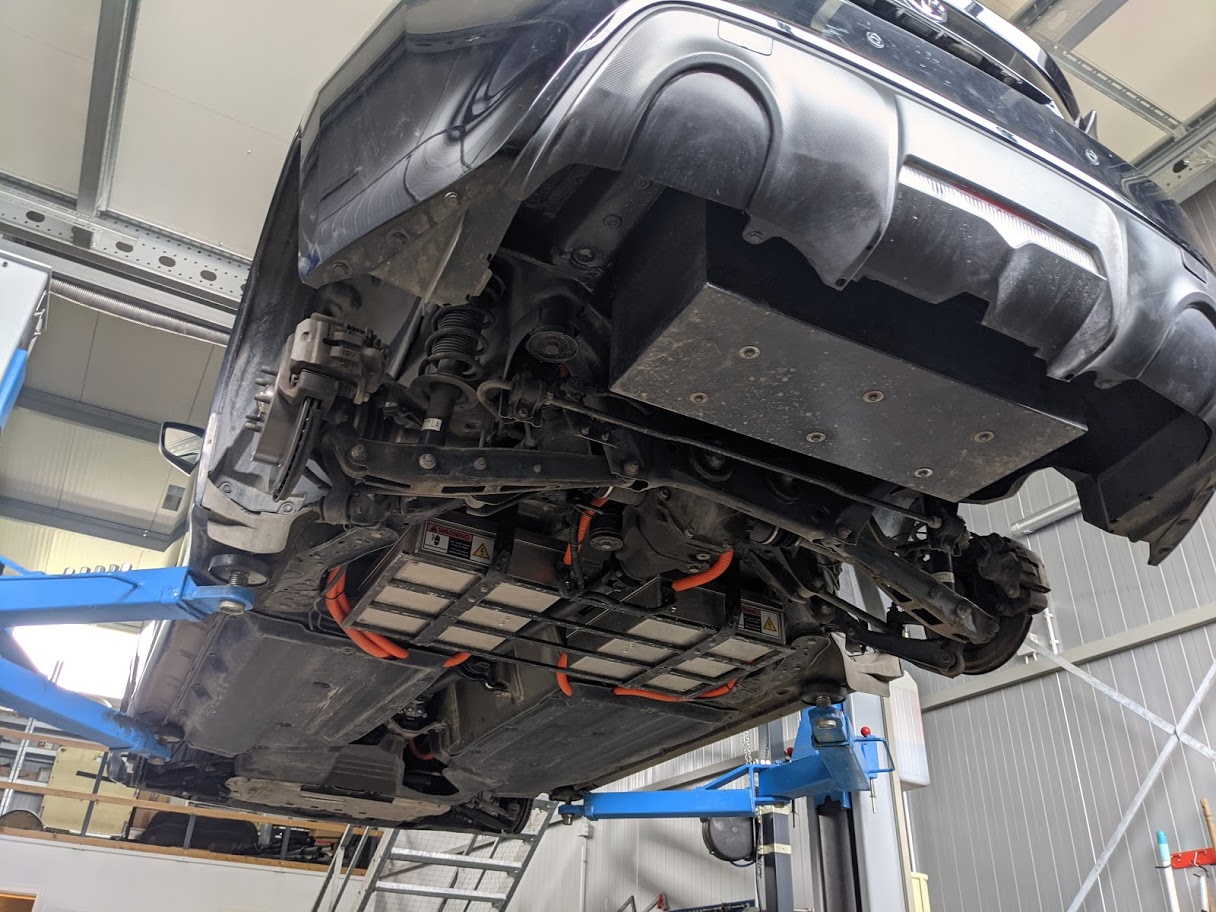

So I am just reading through this project and really admire your battery boxes.
I am curious, what did you use material wise/thickness and what is your heaviest box. I am just about to build my own boxes and have been going back and forth between aluminum and steel and thickness I need. Would love to hear specifics on yours.
- Zapatero
- Posts: 457
- Location: Germany, Ulm
- Has thanked: 27 times
- Been thanked: 58 times
Re: Toyota GT86 with Nissan Leaf Motor
Hi, it is AlMg3 Aluminum in 3mm thickness. My heaviest box consists of 6 Modules / 12 Cells
The box in the rear where the spare wheel was is 1,5mm steel with 24 Modules / 48 Cells.

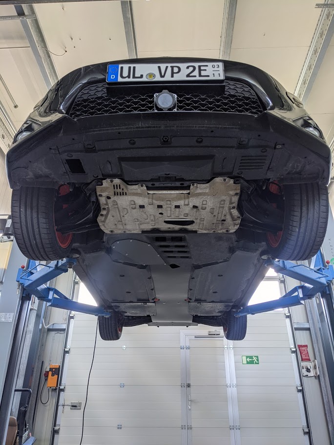

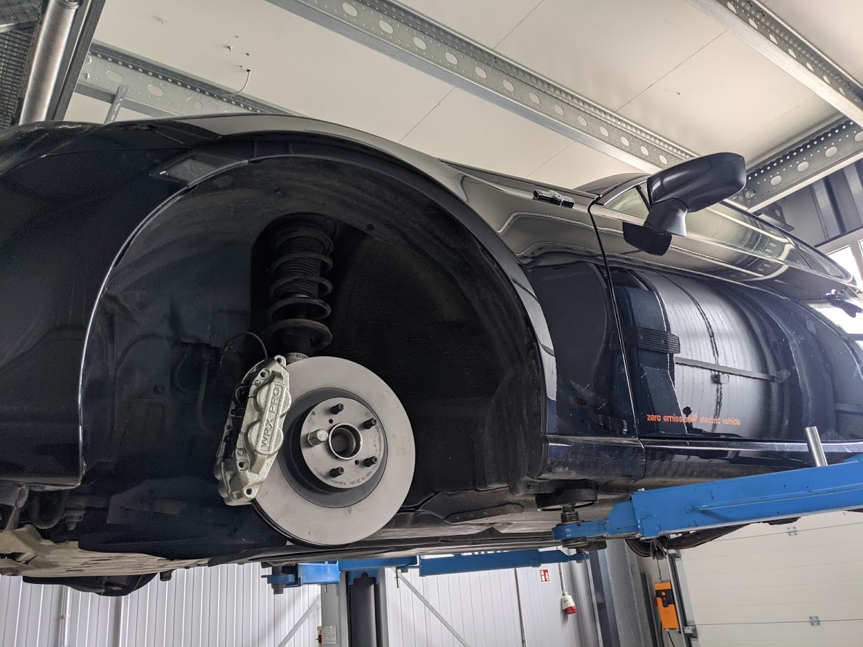

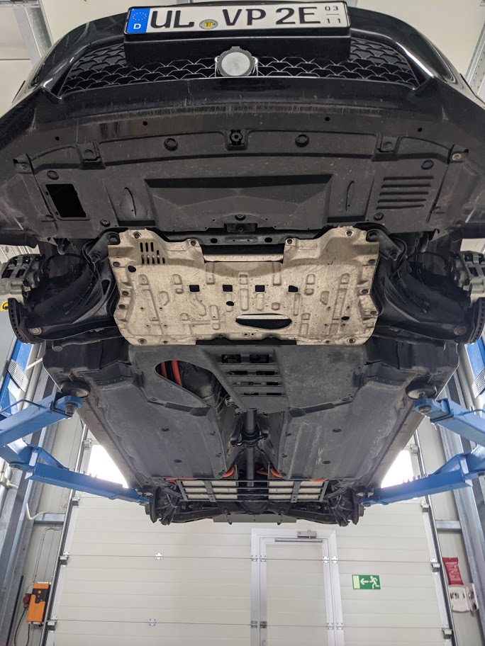

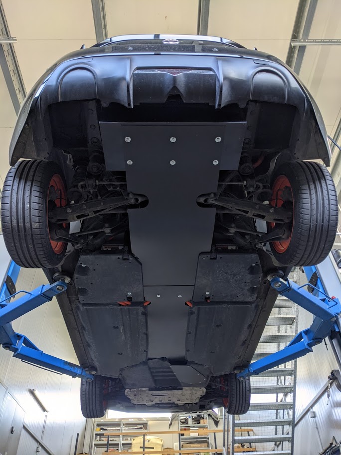

I upgraded the brakes to a 4 pot caliper - non relatet EV-Stuff
Also i changed the tires to Dunlop BluResponse. As i had UHP-Tires before this makes a big difference in range.
To raise efficiency further i covered the underbody as good as i could. Goas was to improve airflow and reduce the drag.
Before: After:
Before: After:

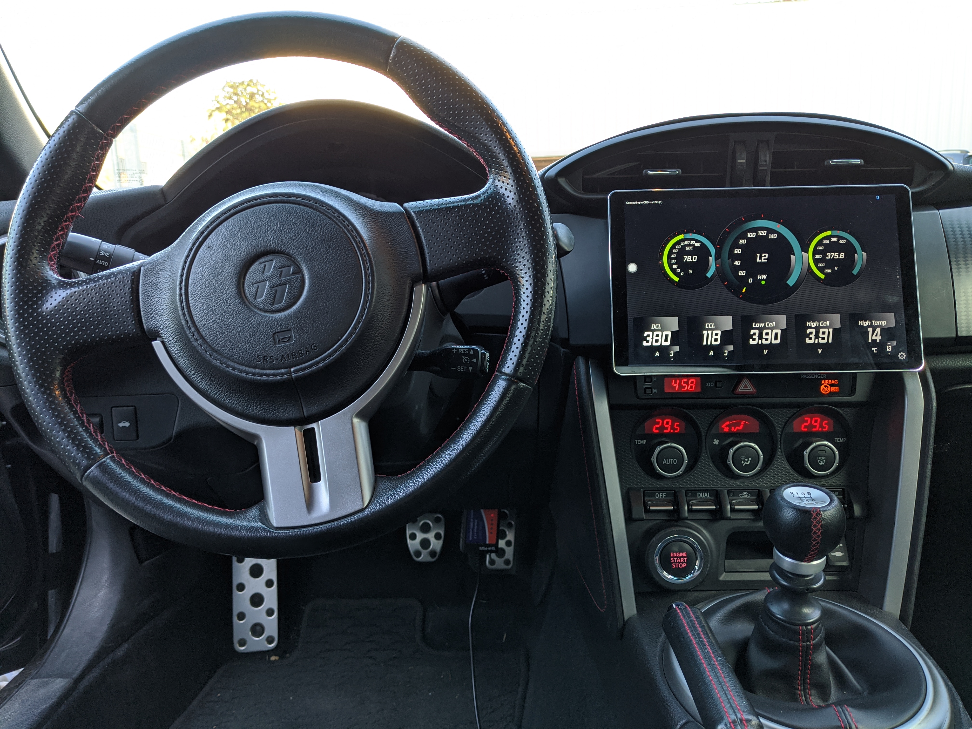

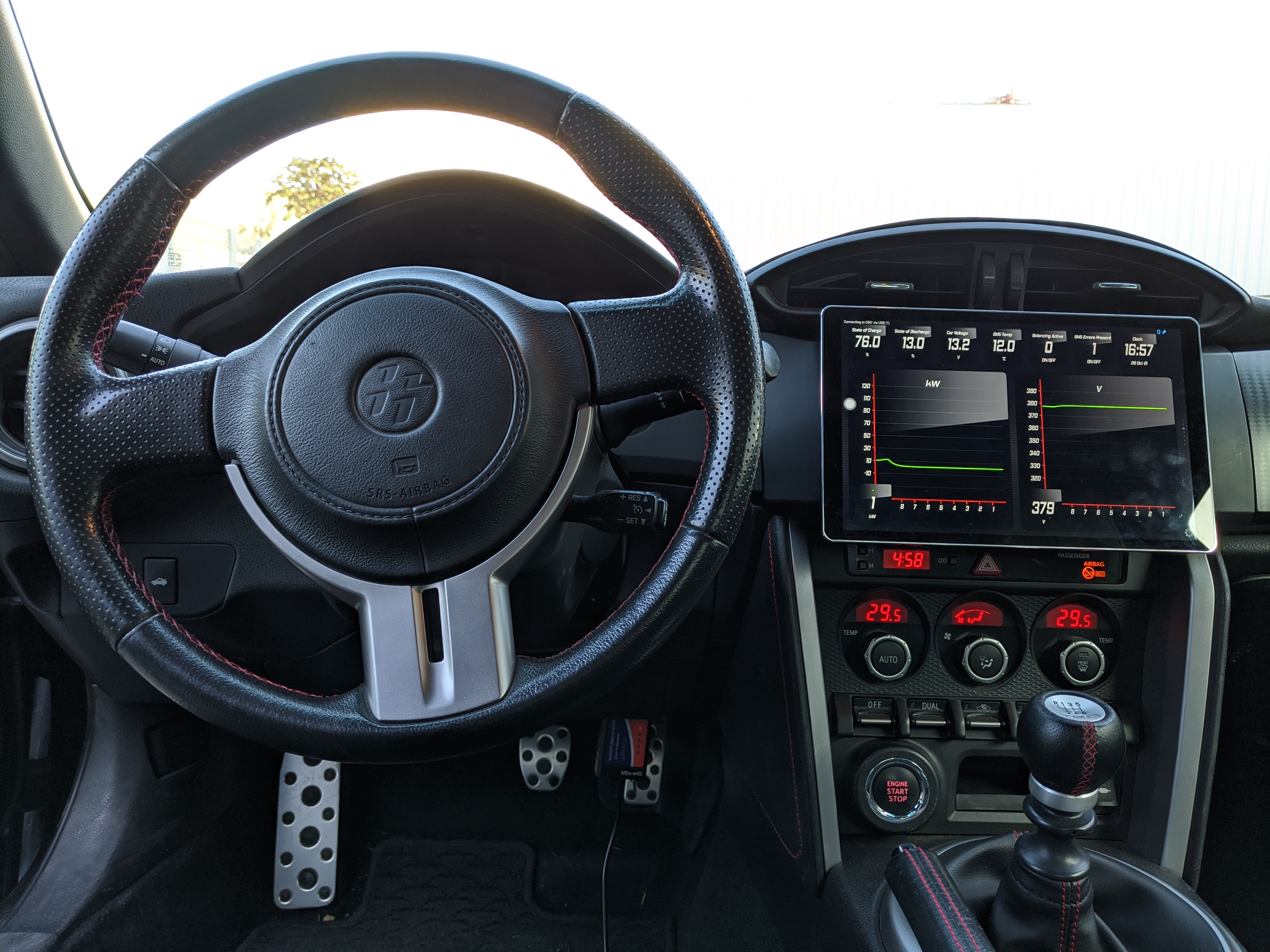

I added a new gimmick to my car: A new head unit. I think it looks awesome and finally I've got that data displayed
I'll driving my car for two years now, almost daily. Still love the car. The last issue I have is the sudden Regen and the traction control tripping out when the steering angle exceeds a certain limit. Other than that it feels like a factory car. A wish would be to implement a CCS charging ability, but it's not really necessary.

I'm at the Moment in the process of installing a 160Kw Inverter and controling it by CAN to skip the custom software in the inverter.
I tried for a long time but i coudln't resolve it. If you're not so power hungry like me it doesn't bother so much.
