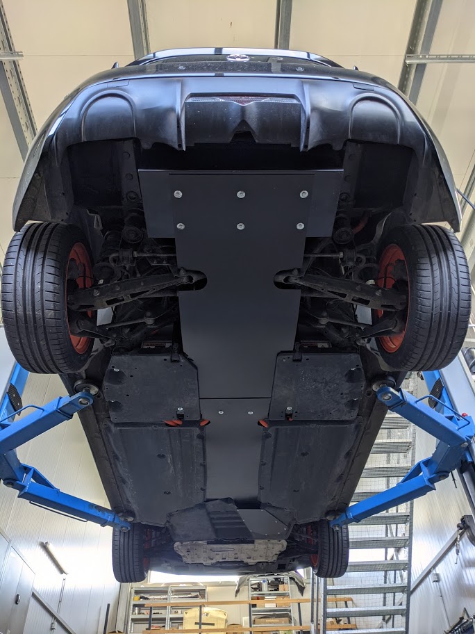

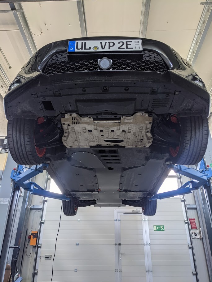

I upgraded the brakes to a 4 pot caliper - non relatet EV-Stuff
Also i changed the tires to Dunlop BluResponse. As i had UHP-Tires before this makes a big difference in range.
To raise efficiency further i covered the underbody as good as i could. Goas was to improve airflow and reduce the drag.
Before: After:
Before: After:
