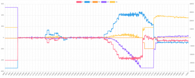

Just went on a test drive with just some minor mods:
- 3 ADC samples, 1.5 clocks S&H time
- syncadv changed to 0.5
- your anti-windup mod
Accelerated up to 7500 rpm then let the throttle snap - nothing! No transients, no unwanted regen. Will test a little more with more throttle, was just very light on it. Binary here: viewtopic.php?p=44944#p44944
I think your anti-windup fix actually plays a large role in this.

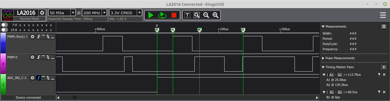

With that fixed I've got some promising results, latency down to 70us (A1-A2 is the period, B1-B2 the latency):
It does involve a fair few changes to the code though. Might update the simulator to better reflect the way the hardware works, add in some ramps on the throttle and see whether it's justified.

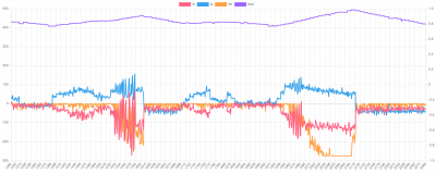

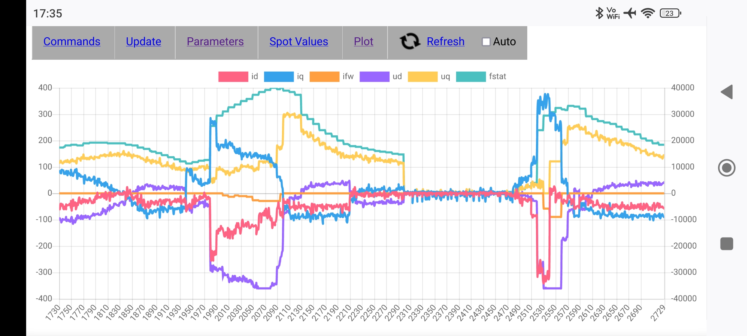

And here are two test runs. Still couldn't provoke any unwanted things.
You do see the currents are quite shaky now with less averaging. Also quite some ringing when entering FW, this might need tuning of fwkp.
Performance has suffered a bit from lowering syncadv from 12 to 0.5. So I guess this is where MTPA tuning comes in

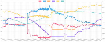

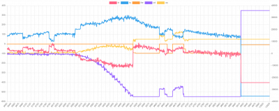

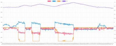

Quite a lot of code and test driving produced today.

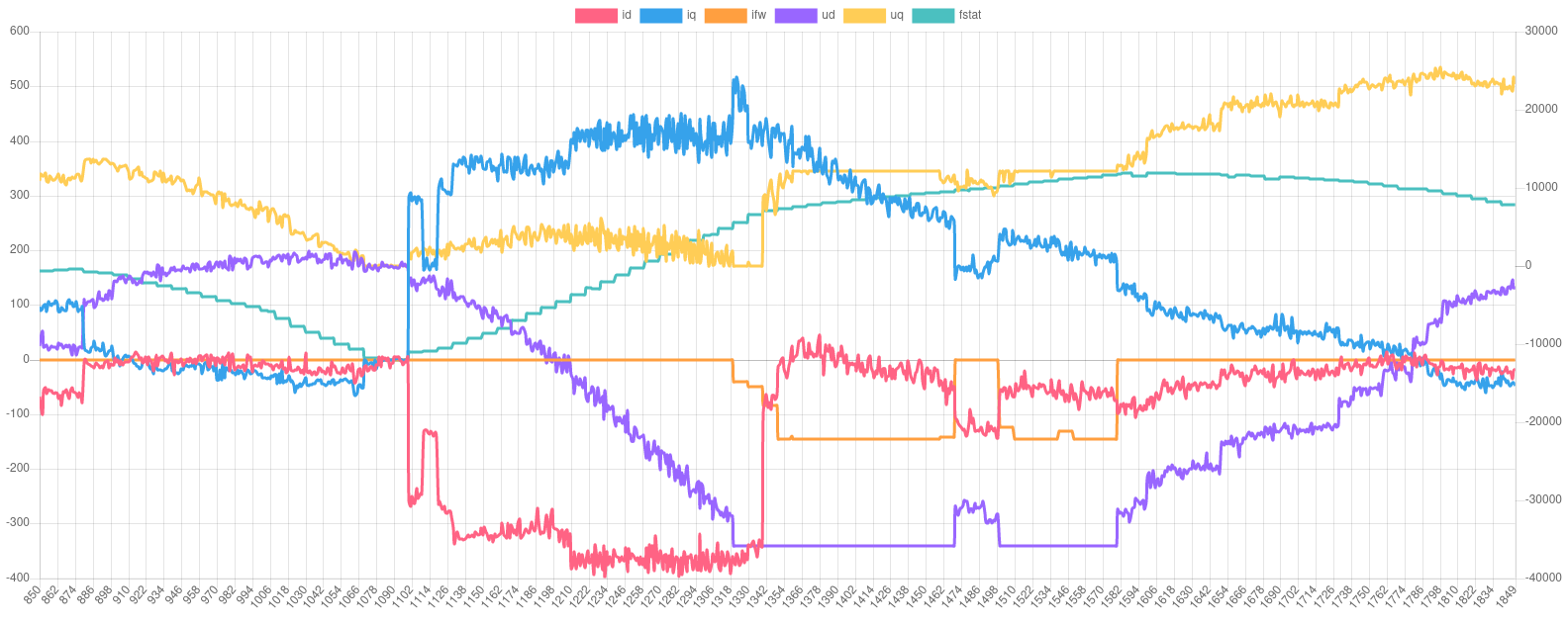

Unfortunately I was able to trigger an over current event, I had set ocurlim to 600 and throtcur to 4:
Then I did a full acceleration run with ocurlim=900A and throtcur=5.5A
Acceleration drops off sharply at 4500 rpm. FW controller becomes active but there is no more amplitude left to follow its command. But thats because I'm stupid, d-controller is limited to maxAmplitude-2000 and I set fwMargin=2000 as well. So it kicks in way too late. Will correct that and try again tomorrow.
As for your syncadv theory we should keep it in the back of our head. Traditionally though you see the same angle going into the forward and reverse transformations.

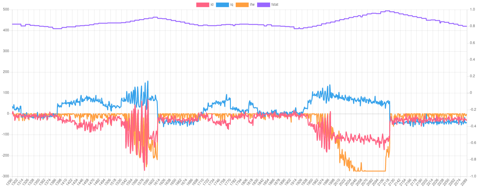

If you get a chance could you log a run with Mtpa disabled? There is something going on with the currents in the plots that I don't understand and it would be easier to see what's what without Mtpa. It would also be interesting to know how much of a performance boost it actually gives.

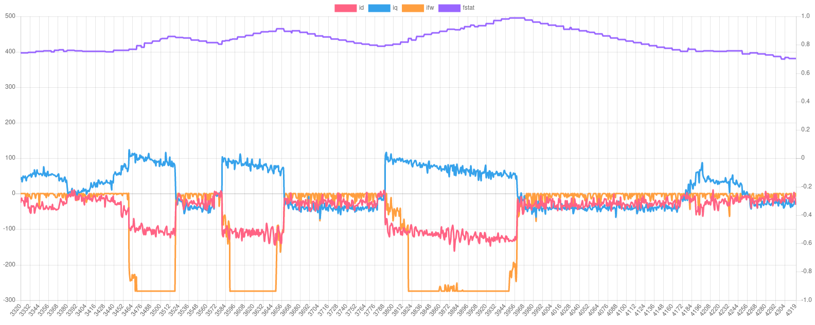

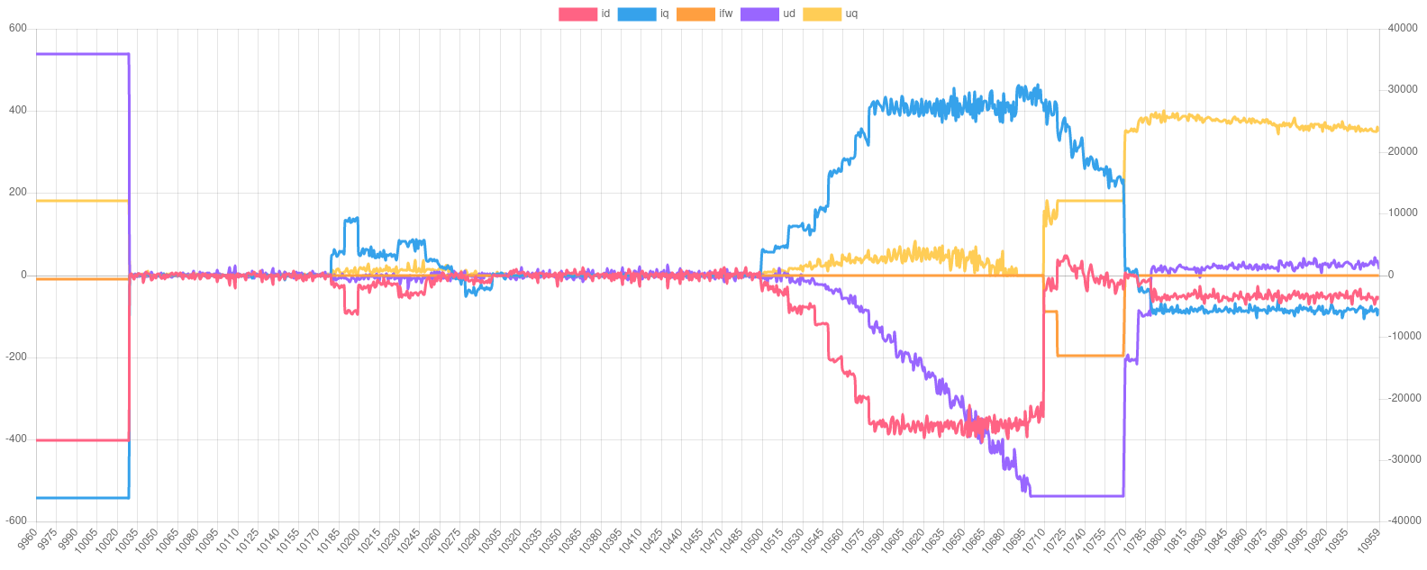

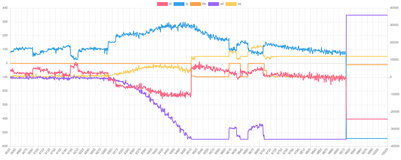

Did another test run today with fwmargin raised to 3000. It means:
- Maximum total amplitude is 37837 digits
- d-controller amplitude is limited to 35837 digits
- fw controller starts adding d-current at a total amplitude of 34837
Still, it does not work as expected. The moment FW comes in d-voltage has already topped out and d-current completely collapses and of course can no longer implement the added d-current. This already happens at 250 Hz as not even the d-current from MTPA can be held.
I felt when coming off throttle that power increased. You can see that at time 1486.
What is also strange is that d-voltage rises proportional to frequency while q-voltage seems to be just above 0. I think it even wants to go below 0 at time 1318 but that is not allowed.
Before, with high syncadv it was the opposite: d voltage was almost constant and q-voltage frequency dependent. I would sort of expect them both to be frequency dependent.
The attached binary has d-voltage limited to 37637, I will try that later.
stm32_foc.bin
(48.02 KiB) Downloaded 263 times

Interesting!
Could you do a run with Mtpa disabled? I think it would be useful to isolate the contribution it is having to Id.
Are you sure the voltages are logging/plotting right, it doesn't seem to make sense.
If you could update your code on github (complete with the parameters values you are using) I can try to reproduce the effect tonight?
One other thought, is it possible to capture the throttle to a text/csv file? If so it could be played back into the simulator and the settings tuned to see how close it can be made.
Edit - that almost looks like uq and ud are swapped, could the q and d variables have got crossed anywhere?
Been thanked: 1918 times
Pete9008 wrote: Wed Sep 07, 2022 2:23 pm Interesting!
Yes, can do that now by setting ldminuslq=0
Pete9008 wrote: Wed Sep 07, 2022 2:23 pm Are you sure the voltages are logging/plotting right, it doesn't seem to make sense.
Never noticed weirdness in the plotting so far.
Code is on github, parameters attached.
Pete9008 wrote: Wed Sep 07, 2022 2:23 pm One other thought, is it possible to capture the throttle to a text/csv file? If so it could be played back into the simulator and the settings tuned to see how close it can be made.
Yes, datalogger would allow that.
Pete9008 wrote: Wed Sep 07, 2022 2:23 pm Edit - that almost looks like uq and ud are swapped, could the q and d variables have got crossed anywhere?
Just checked, they are alright.
Just went for another test drive with fwmargin set to 6000 and fwkp=50 (which is really 50/32 because of scaling). Now we come alive! Unfortunately the FW controller oscillated strongly but when it oscillated towards much field weakening I could feel how much power is in there. Reducing fwkp leads to the controller outputting too little FW current (fwkp=5 on the left side, 15 on the right side). So I think adding fwki might help here.
Leaf 2022-09-07.json
(1.4 KiB) Downloaded 222 times
