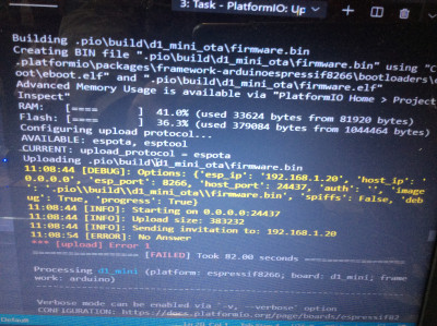

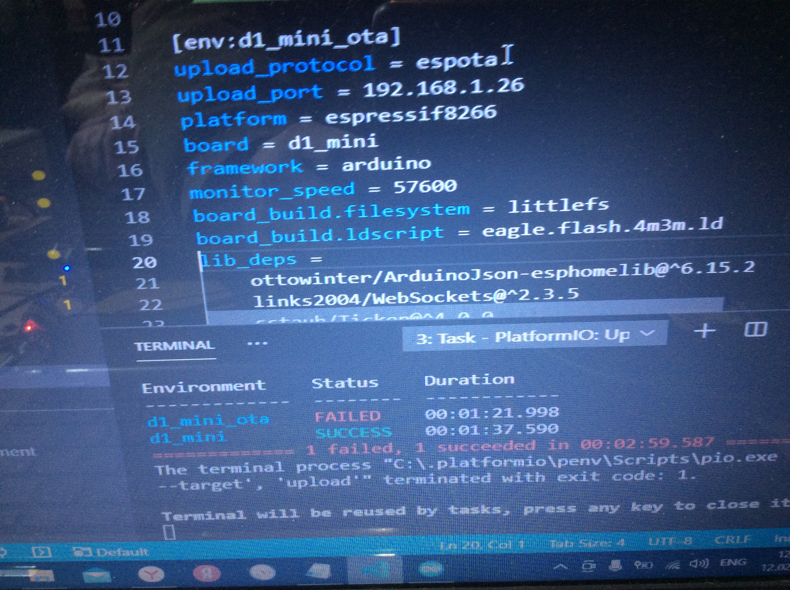

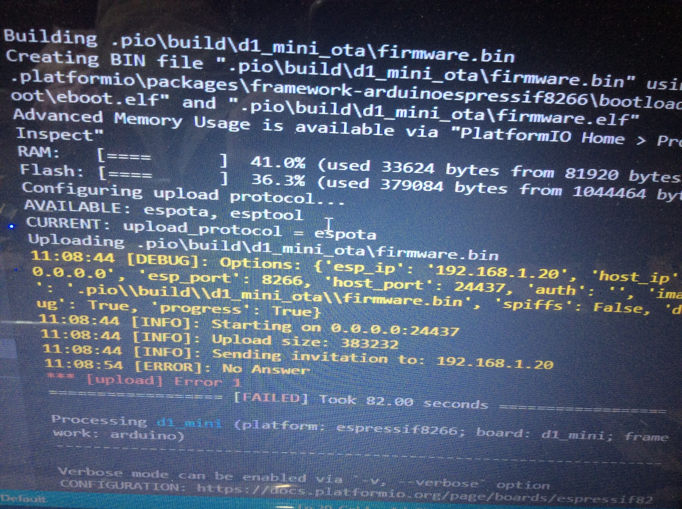

he second day I try to compile the Interfax WEB file (((constantly gives an error (((I tried to build it in arduino - and also failed (((please re-upload the files...
Posts: 1884
Has thanked: 91 times
Been thanked: 517 times
Re: Gen 3 inverter converter control software
Whats your error?
Leo M
Posts: 91
Joined: Fri Oct 30, 2020 9:48 am
Post by Leo M »
No connection d1_mini_oto
Leo M
Posts: 91
Post by Leo M »
Leo M
Posts: 91
Post by Leo M »
Posts: 1884
Yea, your esp ip address wont be 192.168.1.20, that'll need changing to match your ISP, unless you've told it to join your network you will need to change to connect to the module wifi network and uss the 192.168.4.1 ip look in platform.ini you could also upload via the cable.
Leo M
Posts: 91
Post by Leo M »
The photo shows a trial address ))) that's what you have to offer I also tried...I tried it -- the error is the same(((

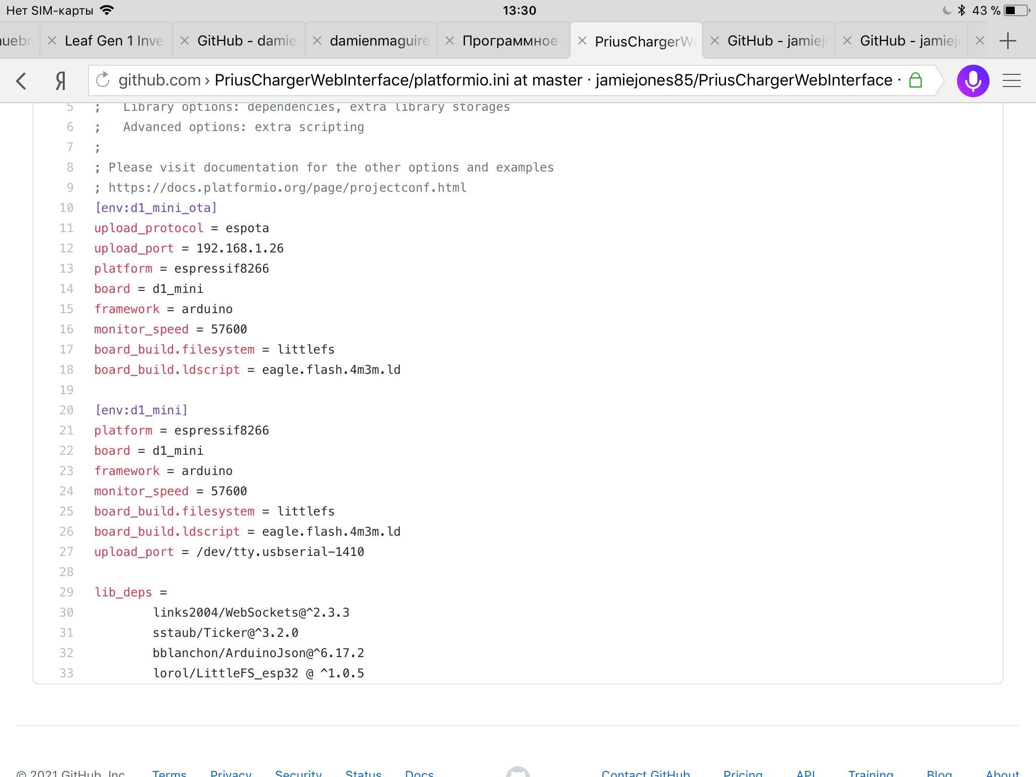

Leo M
Posts: 91
Post by Leo M »
platform.ini, 192.168.1.26
Leo M
Posts: 91
Post by Leo M »
This is your code from the file )))

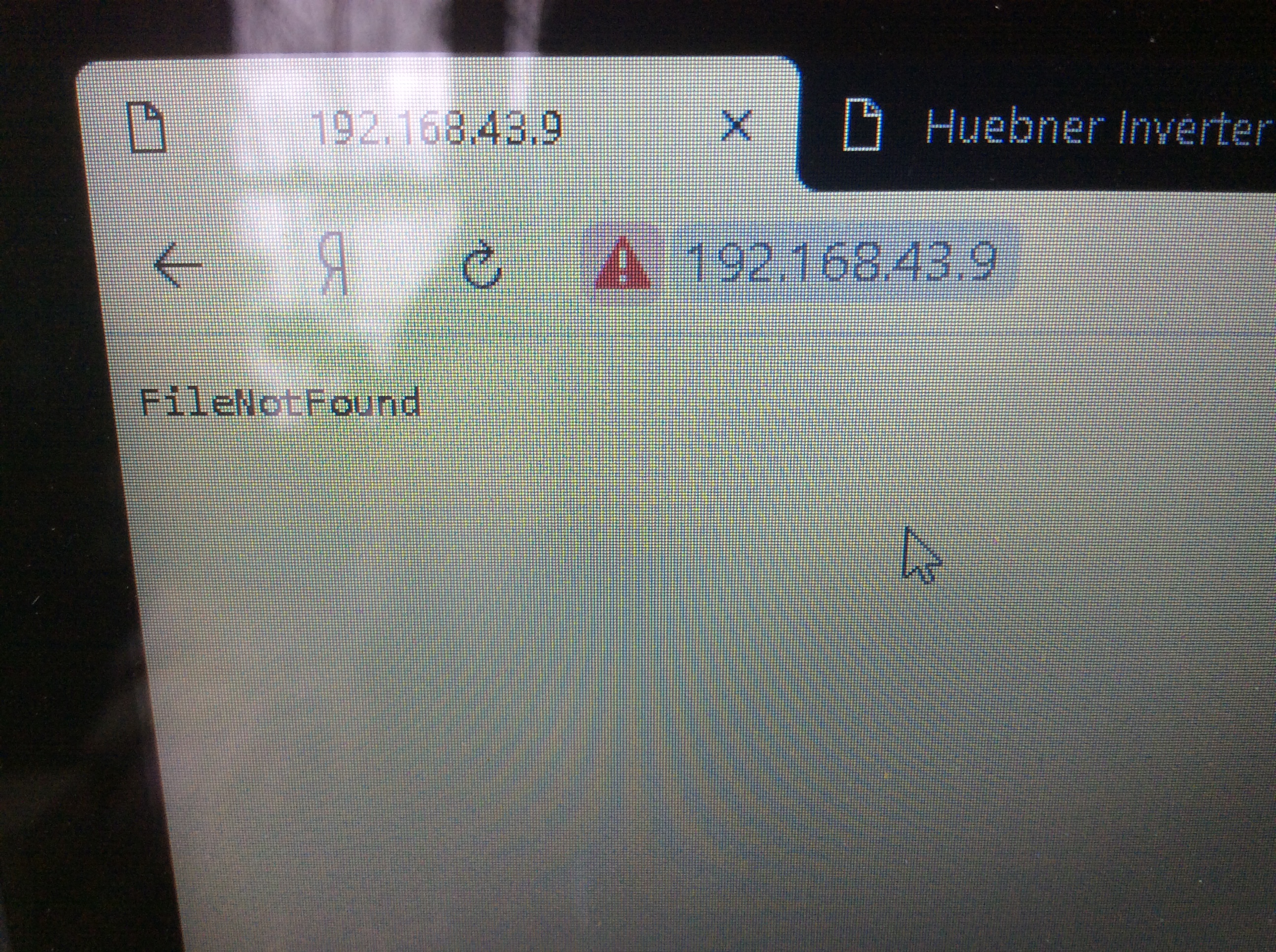

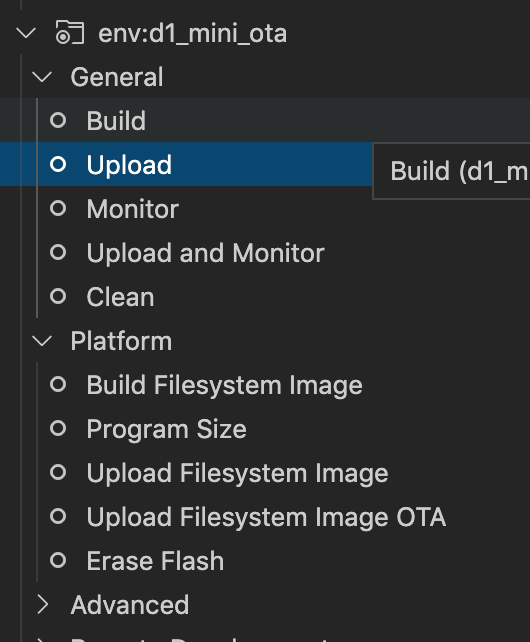

Everything loaded normally) but does not work( what is the problem?

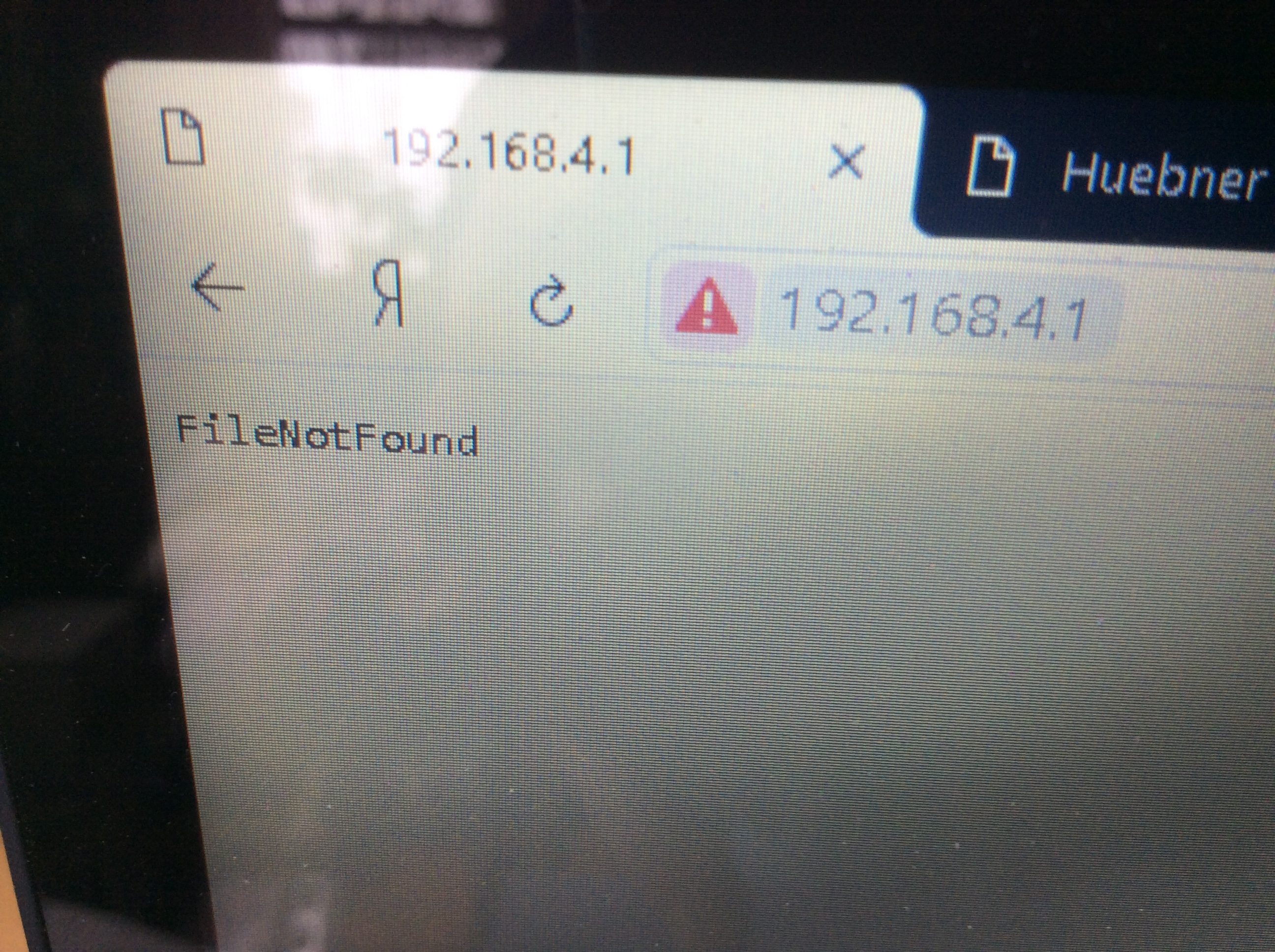

Posts: 1884
You also need to upload the filesystem.
Leo M
Posts: 91
Post by Leo M »
:D ok.thanks.we will try)
Leo M
Posts: 91
Post by Leo M »
Yes!!!! It worked.thank you so much for your help . Waiting for the updated files)))

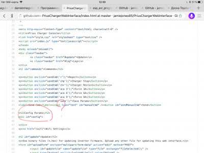

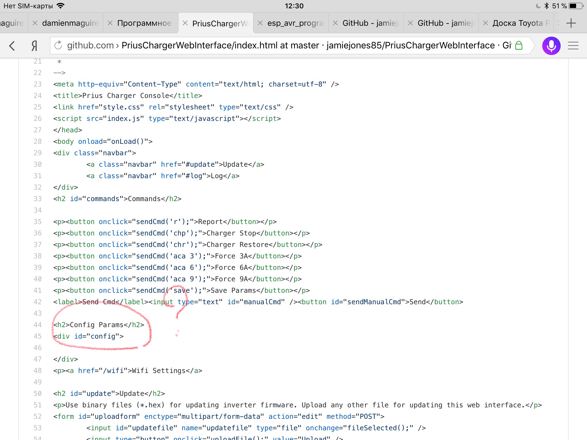

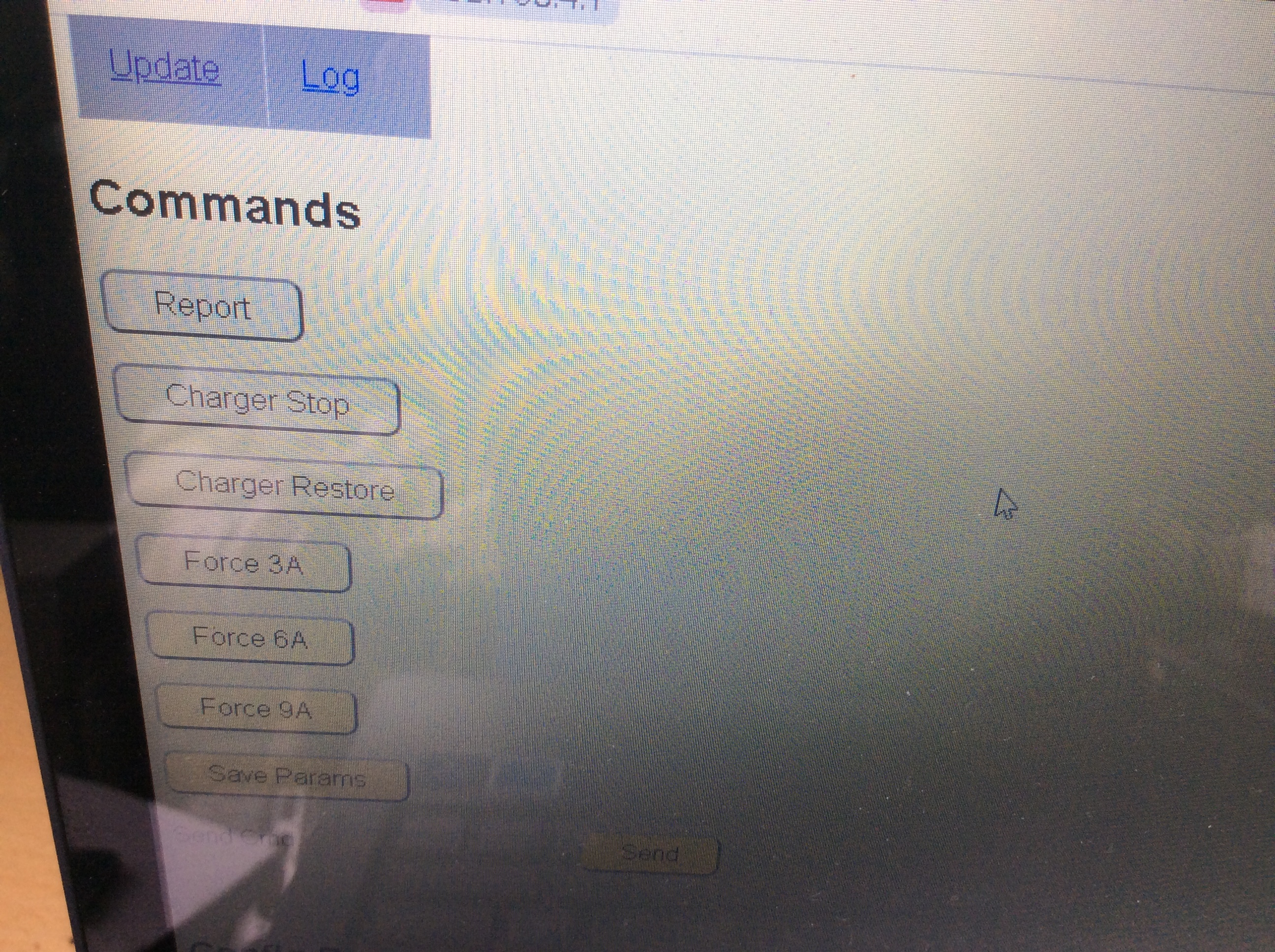

Post by Leo M »

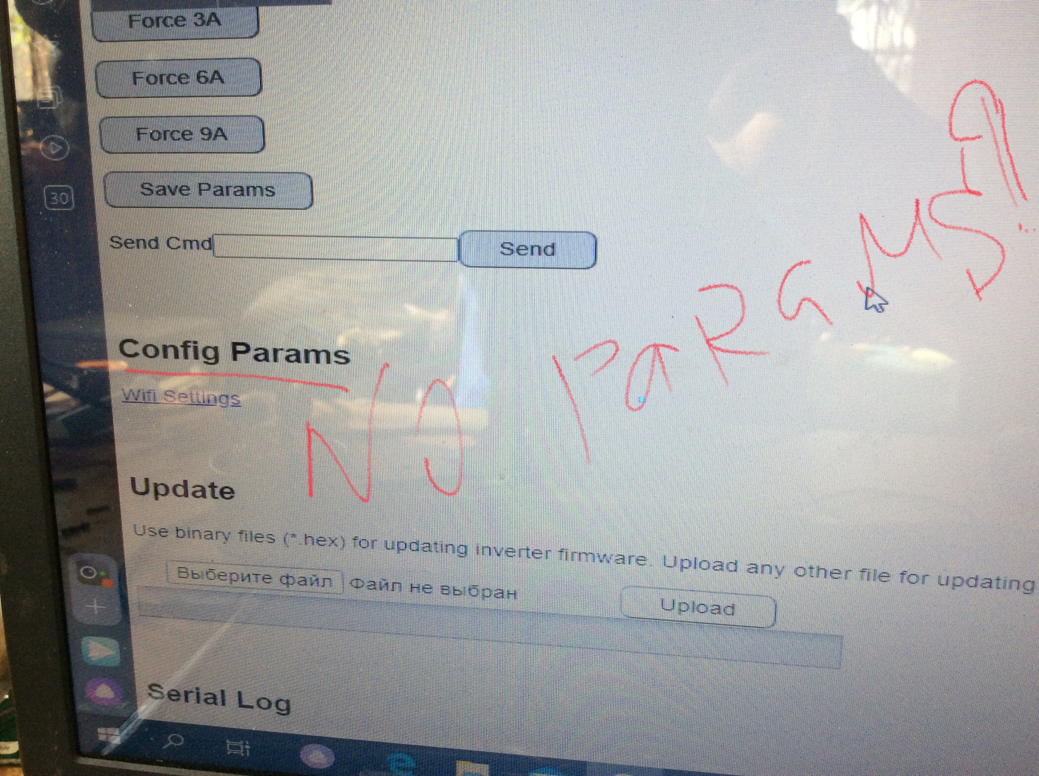

Hi! I attach a photo .why there is no output of parameters . The board is not yet connected to the inverter...Should the parameters be output from Atmega when the inverter is not connected? Or am I in trouble?)))
Posts: 1884
It loads them from the Atmega, try typing 'params' without quotes, and hitting send, see if that loads them. It should issue that on loading.

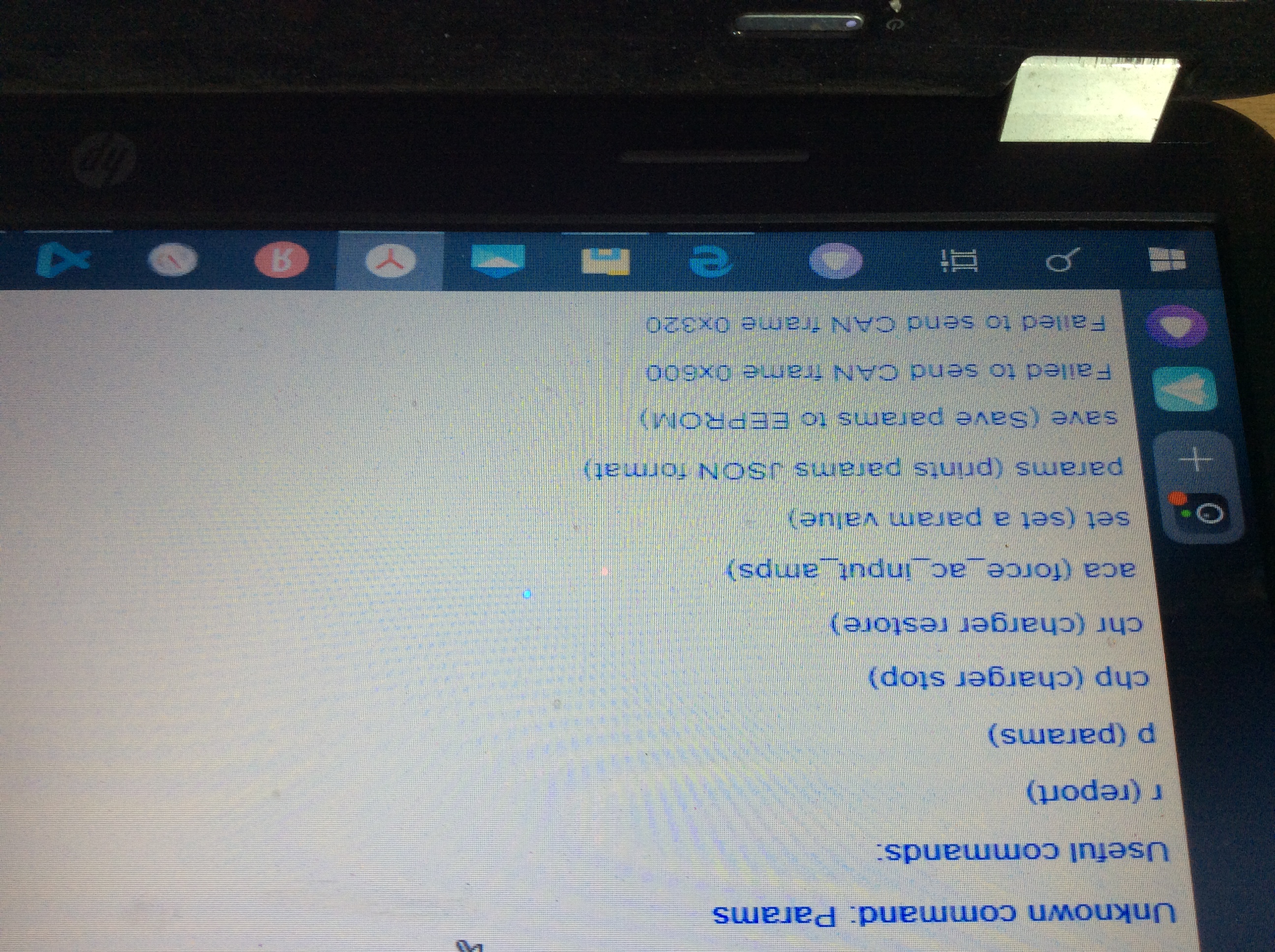

Leo M
Posts: 91
Post by Leo M »
Tried it) parameters are not loaded(((
Posts: 1884

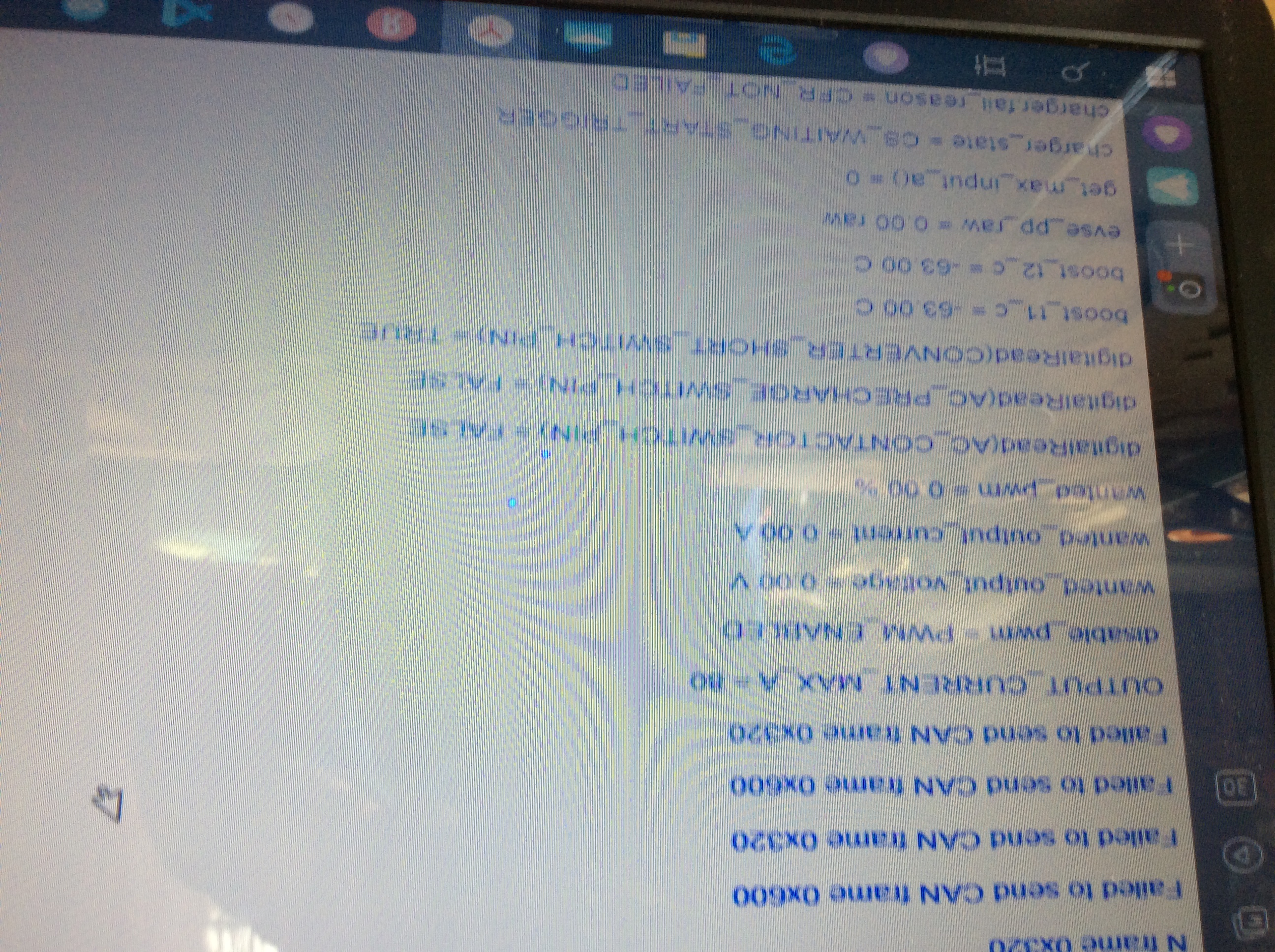

Do you see the message come from the ESP in the browser developer tools? If you look at the web socket messages.
Leo M
Posts: 91
Post by Leo M »
In the browser, here is the information after sending the command
Posts: 1884
no capital p.
I'm busy with some other stuff for a while, but I'll try and get set back up to make this more robust asap.

So what about the output of the parameters? What's my problem? I am interested in the charging varian in two versions-both from 3 phases and from one. And I am interested in this project .so fill in the updated files if you don't mind. Maybe there are Arduino files, it's easier for me to work with them, so to speak, more familiar. In any case, thank you for your hard work...
Posts: 1884
try typing params, all lower case and hitting send, I've noticed it not always loading them correctly when the page first loads.
