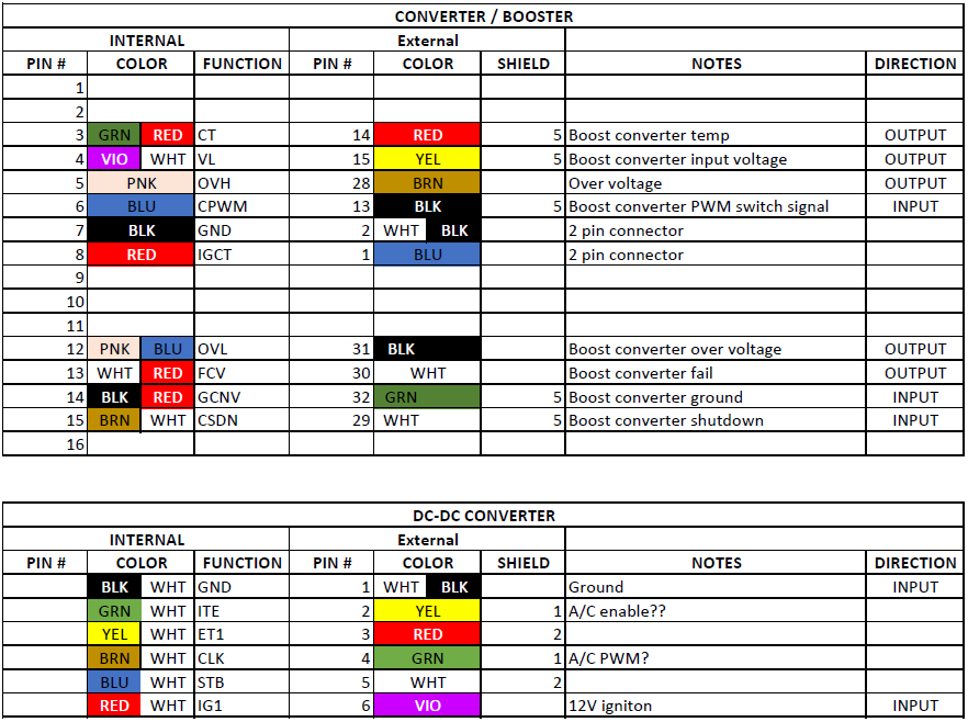

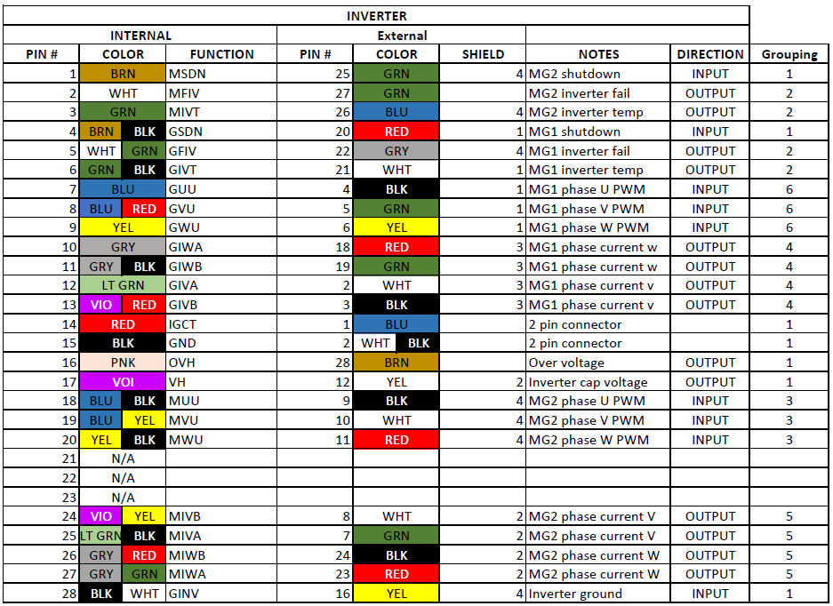

So i recently came across a gen 2 thats been sitting on a body shop lot that i have been in the process of pulling apart (perk of the job). I went ahead and pulled the factory service information for the inverter and made a nice pinout diagram and figured i would share it.
Im hoping to get a blue pill programmed and see if i can get this the to power up. still working on getting the transmission but i did pull the MG2 stator and rotor.
This is for a 2007 prius.
Note that the internal pinouts are the pinouts on each component. External is for the 32 pin connector on the inside of the inverter which connects to the vehicle. note that the DC-DC converter does not have the internal pinout as i haven't pinned it out.
prius pinout.pdf
Pinouts for inverter
(146.29 KiB) Downloaded 328 times

That's awesome thanks. Might have to go in the wiki link...

That's what I was hoping. I've been trying to make it sortable in excel but it doesnt like the wire color columns.

Pikoko wrote: Tue May 12, 2020 8:28 pmmade a nice pinout diagram and figured i would share it.
Great stuff! I'll see if I can get around to adding it to the wiki later today.
I'm not sure how to do color coding the way you've done it, using wiki markup, I'll have to do some studying.

MattsAwesomeStuff wrote: Wed May 13, 2020 7:08 pm Nope, I always edit the code directly in wiki, so, I'll pick it up as soon as I see it.
What i ment was i converted the excel tables to wikimedia tables.
This is the table for the inverter

| colspan="2" style="text-align: center; background-color:#c0c0c0;" | GRY
| style="text-align: center;" | GIWA
| style="text-align: center;" | 18
| colspan="2" style="text-align: center; background-color:#fe0000; color:#ffffff;" | RED
| style="text-align: center;" | 3
| MG1 phase current W
| style="text-align: center;" | OUPUT
| style="text-align: center;" | 11
| style="text-align: center; background-color:#333333; color:#ffffff;" | BLK
| style="text-align: center;" | GIWB
| style="text-align: center;" | 19
| colspan="2" style="text-align: center; background-color:#32cb00;" | GRN
| MG1 phase current W
| style="text-align: center;" | OUTPUT
| style="text-align: center;" | 12
| colspan="2" style="text-align: center; background-color:#9aff99;" | LT GRN
| style="text-align: center;" | GIVA
| style="text-align: center;" | 2
| colspan="2" style="text-align: center;" | WHT
| MG1 phase current V
| style="text-align: center;" | 13
| style="text-align: center; background-color:#6665cd; color:#ffffff;" | VIO
| style="text-align: center;" | GIVB
| colspan="2" style="text-align: center; background-color:#333333; color:#ffffff;" | BLK
| MG1 phase current V
| style="text-align: center;" | 14
| style="text-align: center;" | IGCT
| colspan="2" style="text-align: center; background-color:#3166ff; color:#ffffff;" | BLU
| 2 pin connector/12v IG
| style="text-align: center;" | INPUT
| style="text-align: center;" | 15
| style="text-align: center;" | GND
| 2 pin connector
| style="text-align: center;" | 16
| colspan="2" style="text-align: center; background-color:#ffccc9;" | PNK
| style="text-align: center;" | OVH
| style="text-align: center;" | 28
| colspan="2" style="text-align: center; background-color:#cd9934;" | BRN
| Over voltage
| style="text-align: center;" | 17
| colspan="2" style="text-align: center; background-color:#6665cd; color:#ffffff;" | VIO
| style="text-align: center;" | VH
| colspan="2" style="text-align: center; background-color:#fffe65;" | YEL
| Inverter cap voltage
| style="text-align: center;" | MUU
| style="text-align: center;" | 9
| style="text-align: center;" | 4
| MG2 phase U PWM
| style="text-align: center;" | MVU
| style="text-align: center;" | 10
| MG2 pahse V PWM
| style="text-align: center;" | 20
| style="text-align: center;" | MWU
| MG2 phase W PWM
| style="text-align: center;" | 21
| colspan="2" style="text-align: center;" | N/A
| style="text-align: center;" | 22
| style="text-align: center;" | 23
| style="text-align: center;" | 24
| style="text-align: center;" | MIVB
| style="text-align: center;" | 8
| MG2 phase current V
| style="text-align: center;" | 25
| style="text-align: center;" | MIVA
| style="text-align: center;" | 7
| MG2 phase current V
| style="text-align: center;" | 26
| style="text-align: center;" | MIWB
| MG2 phase current W
| style="text-align: center;" | 27
| style="text-align: center;" | MIWA
| MG2 phase current W
| style="text-align: center;" | GINV
| Inverter ground
