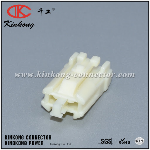

It's not exactly an expensive connector to replace, I'd just buy a matching plug and socket.

SciroccoEV wrote: Fri May 01, 2020 6:57 pm It's not exactly an expensive connector to replace, I'd just buy a matching plug and socket.
My first thought exactly :) Why bother with OEM when you can replace it with any aftermarket. I consider I'm lucky to have piece of OEM harness with sealant.
Anyway I've got number 11717 on my connector, so google shows it correctly: 90980-11717

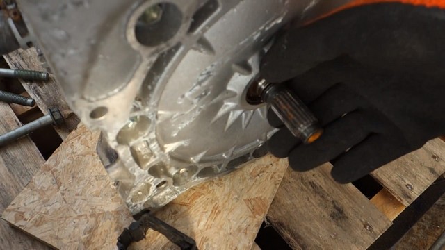

I might have to go locking up a planet gear set whilst I await 'the cure'. Will post in the transaxle post as I go....

RetroZero wrote: Mon May 04, 2020 7:25 am I might have to go locking up a planet gear set whilst I await 'the cure'. Will post in the transaxle post as I go....
"the cure" is a simple chunk of metal produced with the lathe. All you need is do some measurements maybe with a micrometer, and a good lathe operator. Unfortunately, I went by the way of MGR, and have got no free money to purchase prius gearabox to disassmle it. Yet I've got micrometer and a good lathe operator=)
