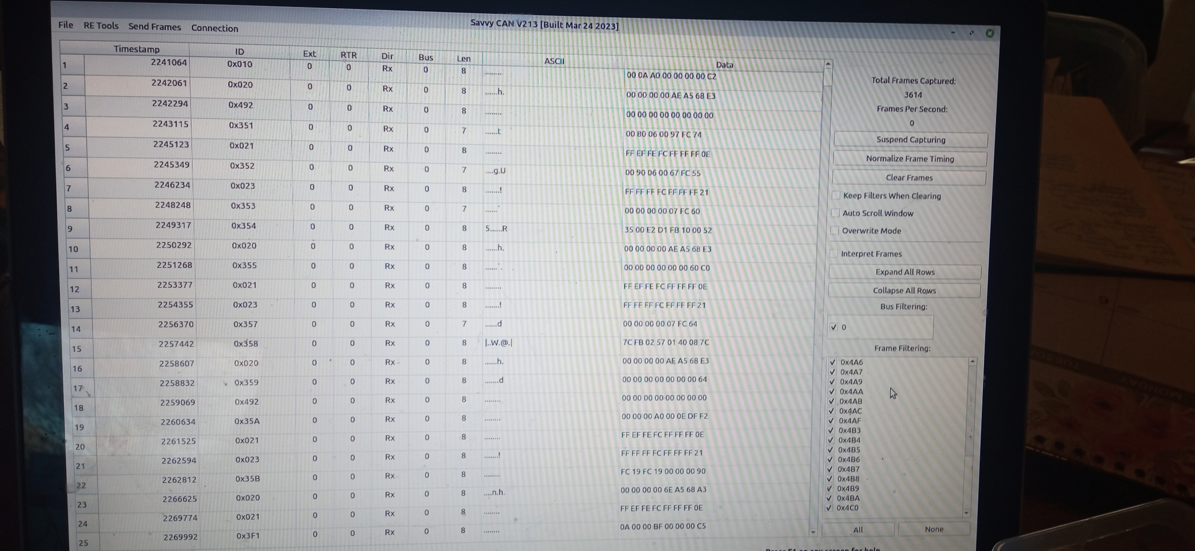

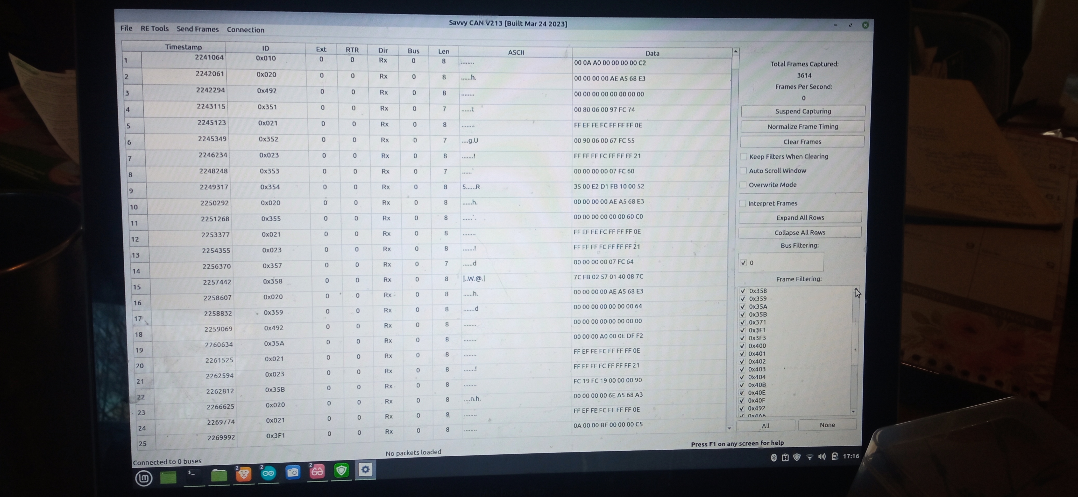

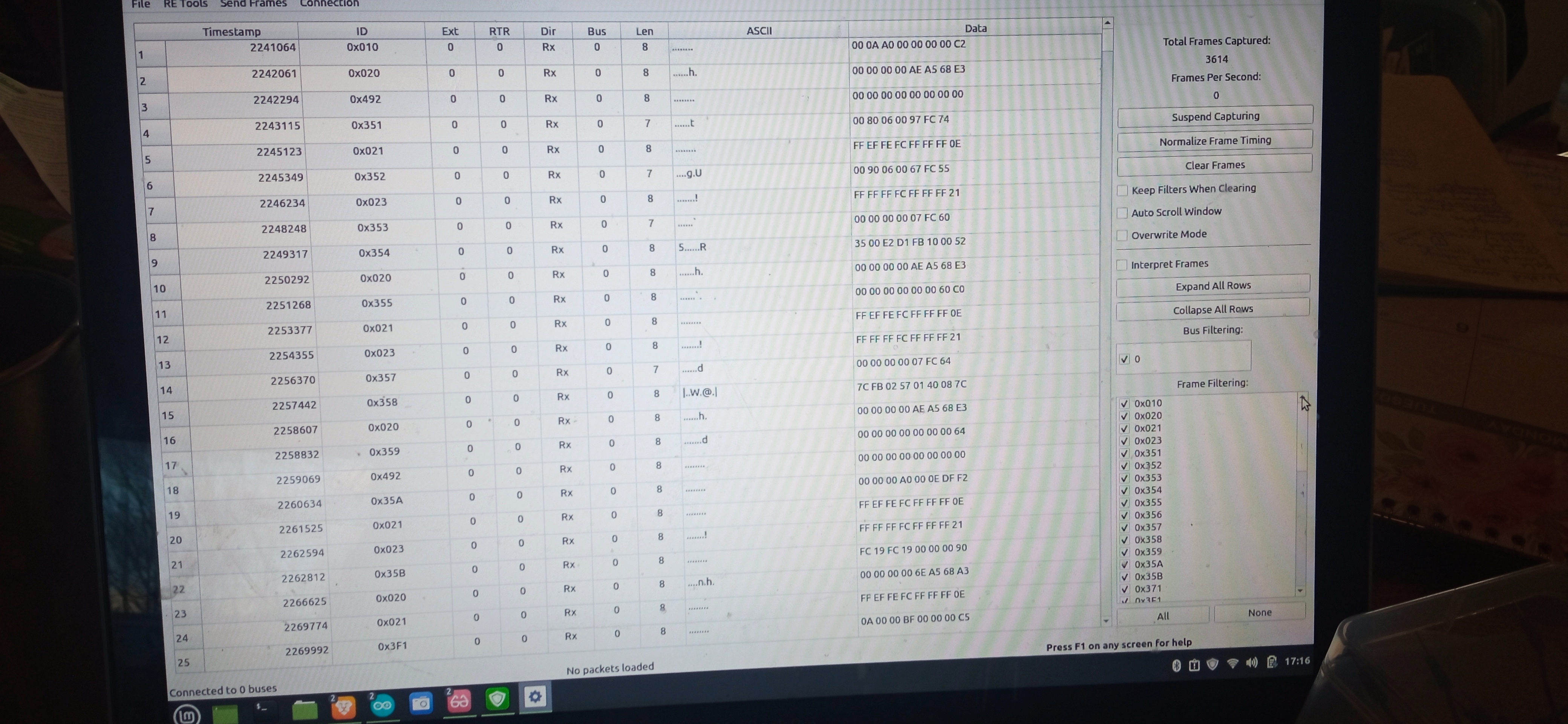

So I've got family visitng so I did what most others here would do and took over the living room table to work on my CANbus logging setup. Again with help from BigPie, I managed to get Savvycan logging with Uhis wifican (ESP32RET) tool. I verified my canbus network was working by giving a heartbeat to the mitsubishi outlander charger then plugged in the Lexus UX300E BMS (both units) and did some wire tracing to see what was required to get them to power up. After a lot of scouring the wiring diagrams I found the main BMS needs 2 +12V ignition signals and 3 ground signals and it starts firing out CAN messaged.
CAN1 has a lot more IDs then CAN2, the BMS unit controls all the pack cooling as well as precharge and AC charge relays, battery heating pads, takes input from the current sensor and a few other bits...
I tried saving the log file but Savvycan crashes when I try to save, I'll have to sort that later but for now, I'll upload some photos of the logging. Nothing was hooked up at the time but I'll add some modules and do some more logging and see what changes.

Okay, but why so many pictures of the laptop screen?
Did you note down what state the BMS was in when the log was taken? I presume you have not yet connected back up any of the cells.

Re: [WIP] Mercedes 310E (310D campervan) - GS450H/GS300H
To show all the can IDs in the "frame filtering" section I'm not sure if they mean anything to anyone or if they can be familiar to other Toyota can IDs. But the 3 images capture all the CAN1 IDs.
Nothing connected as of yet, I'll look to add the modules next and see if things change on the logs.
Here is CAN2 logs showing a lot less IDs....
Please just post the CAN log. No point squinting at grainy screen pictures.
Best would be to create a github repository.

Anyway, my current thinking was I could just log can data whilst unplugging and plugging in modules and other things but I'm not 100% if this is the best appraoch.
I'm also logging all the can data from the main BMS atm, but I'm going to change tact and just log on the Voltage Sensor Unit as that only has inputs for the module cell taps and temp sensors and so should hopefully have a much simpler can network and make it easier to then understand whats doing what.
I'll attach what I have so far in case anyone wants to have a look and maybe give me a point in any direction.
- Lexus UX300E BMS Can 2 Log - nothing connected.csv
- (4.35 KiB) Downloaded 250 times
- Lexus UX300E BMS Can 1 Log - nothing connected.csv
- (965.02 KiB) Downloaded 174 times
- Lexus UX300E BMS Can 1 Log - connecting and disconnecting Module 30 3 times ended unplugged.csv
- (1.64 MiB) Downloaded 225 times
- Lexus UX300E BMS Can 1 Log - connecting and disconnecting AM 3 times ended unplugged.csv
- (1.07 MiB) Downloaded 269 times
