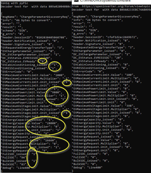

Looking at the Super Secret Charger Log (tm), it looks like:
- The charger receives the ChargeParameterDiscoveryReq as it should. It is decoded as {"EVRequestedEnergyTransferType":"DC_extended","DC_EVChargeParameter":{"DC_EVStatus":{"EVErrorCode":"NO_ERROR","EVRESSSOC":20},"EVMaximumCurrentLimit":{"Multiplier":0,"Value":100},"EVMaximumVoltageLimit":{"Multiplier":0,"Value":398}}}
- It says it's charging at 20% SoC
- There's a status report which mainly seems to be saying "state = stopped" and "insulation test = not started".
- There are lots of power, sensor and derating related readings which shouldn't matter at all at this point.
- 1.0 seconds after ChargeParameterDiscoveryReq, it says "connection closed", referring to the car's IPv6 address and port and the charger calls the session as ended.
Again I can't even pretend to have any idea what's happening. Why is there no response? Why 1.0 seconds? But I'm going to guess the charger has a good reason to not be happy once again. It's definitely not telling it in a way that I would understand. What does "Multiplier":0 mean? Multiplying by 0 seems weird? What are we multiplying here? Have we missed sending a required message before this one?

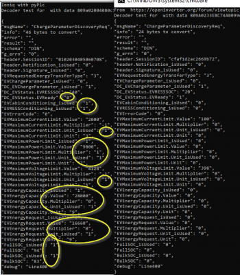

The multiplier means the exponent to the base of 10, which is used to scale the physical values. E.g. value 4000 and multiplier -1 would mean 4000*10^(-1) = 400, and in best case also a unit is provided, but this is optional.
Looking back to the topic with the sessionSetup, my impression is that "your" charger is very strict, and just ignores (or crashes?) if something is not exactly as it expects. I have logs from my original Ioniq car, and compared the one from your trace with the Ioniq. Conclusion: Much room for improvements :-)

You’re missing EVReady: True in DC_EVStatus.
uhi22
Posts: 1143
Location: Ingolstadt/Germany
Has thanked: 231 times
Been thanked: 638 times
Post by uhi22 »
CCSknowitall
Posts: 106
Joined: Fri Jun 04, 2021 1:47 pm
Been thanked: 29 times
Post by CCSknowitall »
Ok I misspoke, you might be missing EVReady entirely? Most vehicles send true but apparently some send false here. It must be set to true in cable check and beyond until end of charging. Since it’s not in the charger logs, and everything else seems to be decoded, it’s suspicious.
Really hard to work without a pcap. :)

Yeah, would be great to also note the charger types, then I would add the results into the charger-test-result-page https://github.com/uhi22/pyPLC/blob/mas ... results.md
I added some of the "missing" fields, and changed the EVReady to zero, as the Ioniq does. Maybe this helps. Let me guess: We will see similar issues in the next messages, but it should not take more than a week, if we fix one message each day :-)

You could run tcpdump on the interface, you don’t necessarily need a sniffer on the line.
You’ll need to set EVReady to true or 1 for cable check, pre charge, power delivery, and current demand.
uhi22
Posts: 1143
Post by uhi22 »
CCSknowitall wrote: Thu Mar 23, 2023 10:36 pm You’ll need to set EVReady to true or 1 for cable check, pre charge, power delivery, and current demand.
According to what I see in the code, this is fulfilled. Only for the ChargeParameterDiscovery, we set EVReady to 0, as the Ioniq does. Means: Happy testing and good luck :-)

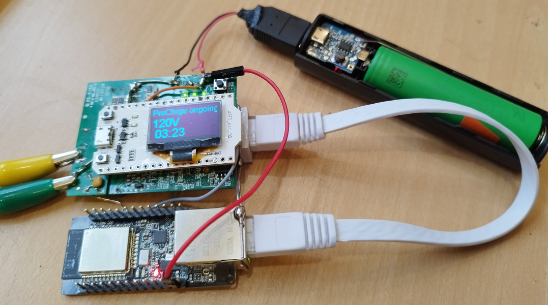

A WT32_ETH01 as controller, a TPlink TL-PA4010 rev 3.0 as modem and a WIFI_Kit_32 as display.
Running the Arduino sketch from https://github.com/uhi22/ccs32 on the WT32, and the display software from https://github.com/uhi22/SerialToOLED.
Stability issues are solved, demo-charging on EVSE-simulation from https://github.com/uhi22/pyPLC works.
Ready to hook it up to a real-world charger to see how far we can get.

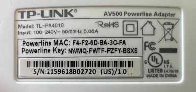

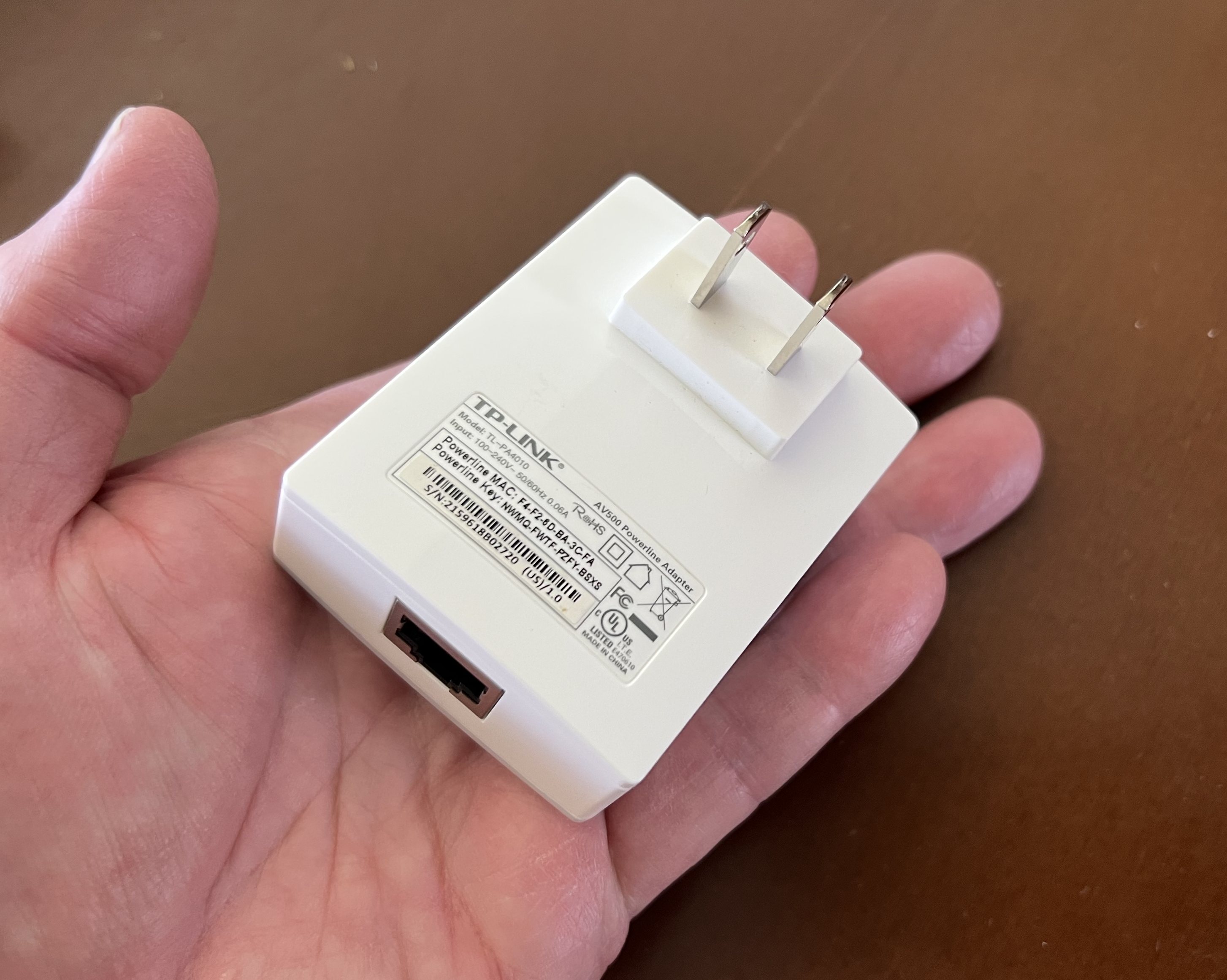

Got the tplink today now not quite sure how to continue. In hardware.md it looks like you used the entire stack of 2 boards but in your latest post it looks like you removed the lower one without the RJ45 jack. Is that the best way to do it, completely remove the lower one and connect 1nF and 150 Ohms to the output of that little transformer (or choke)?
uhi22
Posts: 1143
Post by uhi22 »

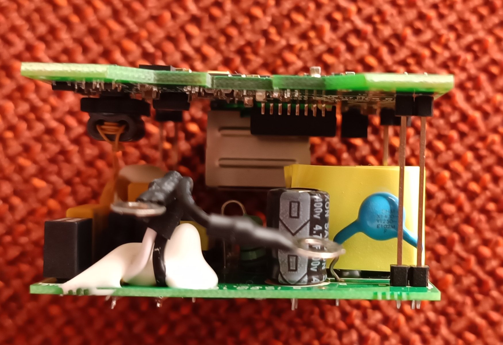

The single Board is from an other Variant, without the passthrough socket on the front. This is originally single board.
You can remove the second board, but loose the big elco on the supply, so this needs to be added again. And yes, the two wires from the transformer go to the 1nF and 150ohms.
asavage
Posts: 379
Has thanked: 366 times
Been thanked: 119 times
Post by asavage »
USD$12, eBay, 8 days to arrive . . .
TL-PA4010 (without passthrough)

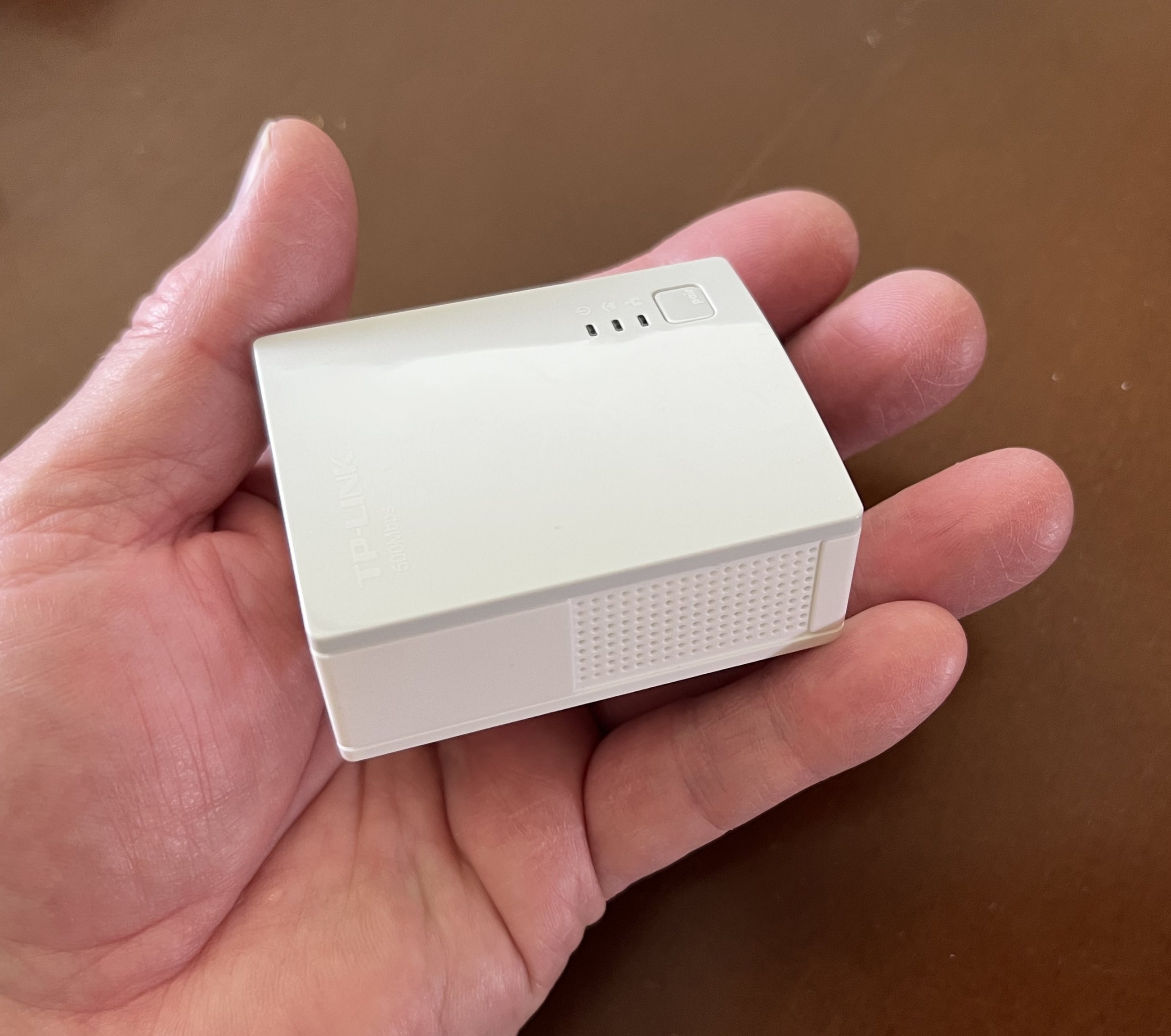

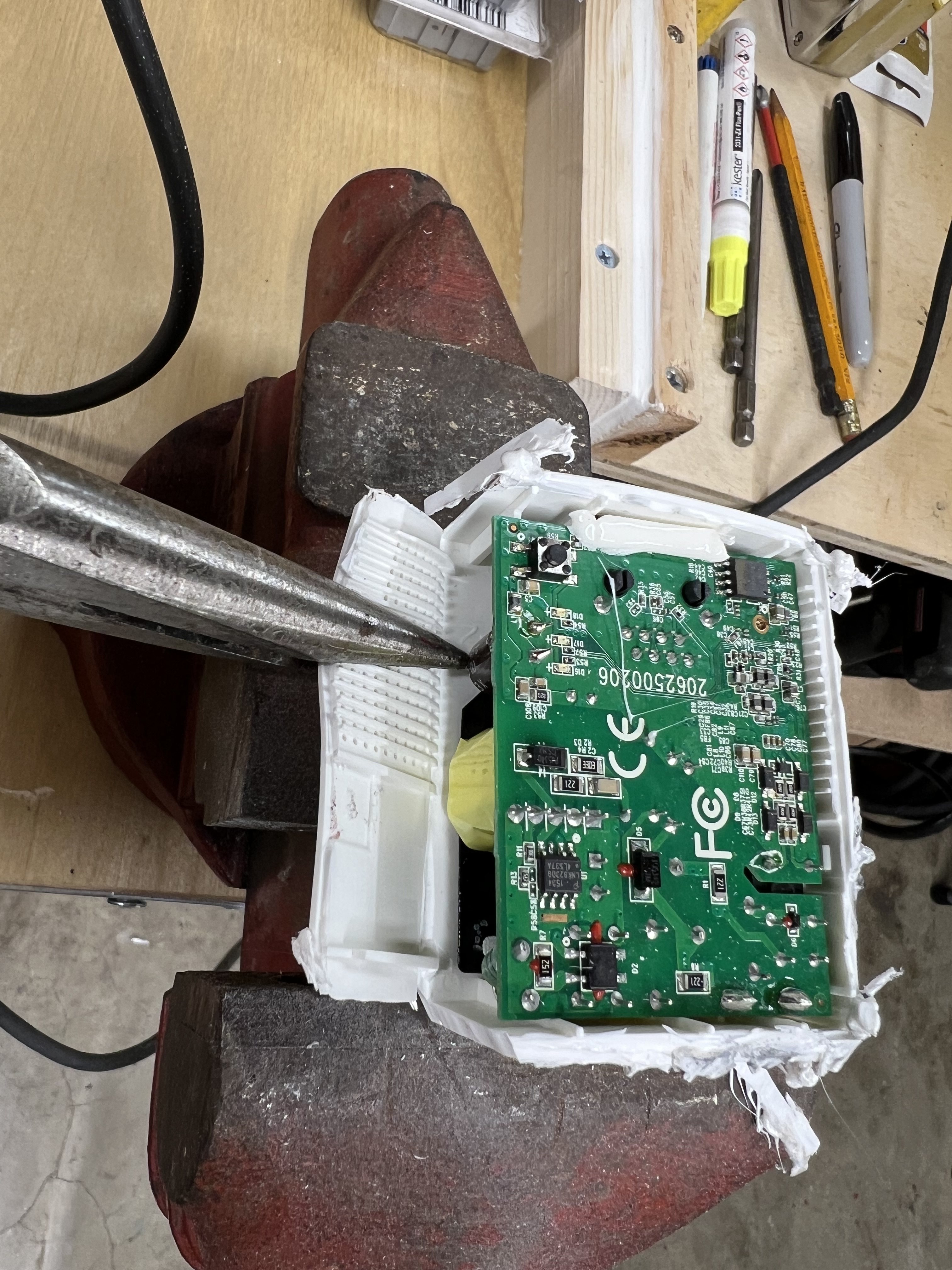

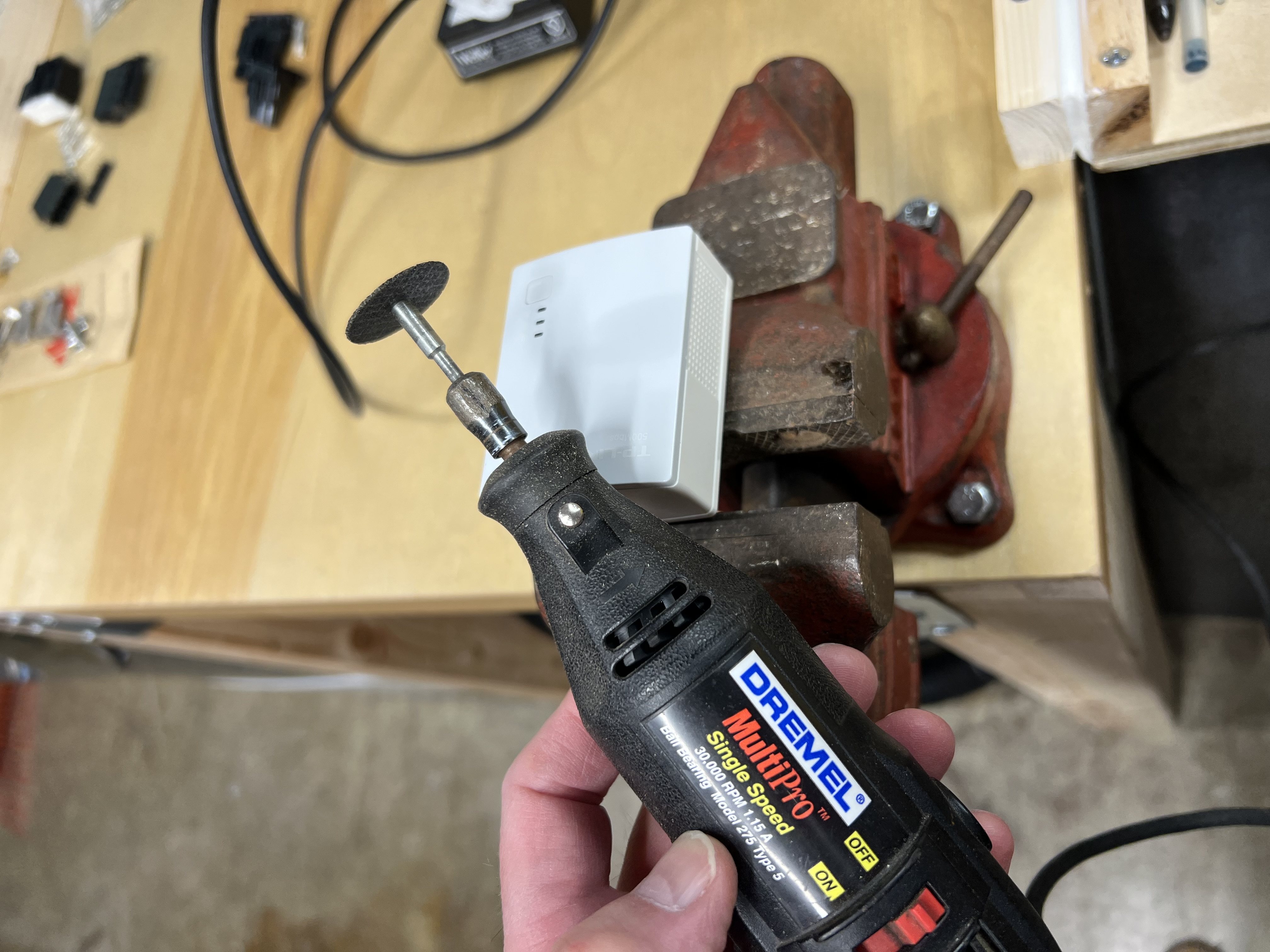

For a while, a couple of careers ago, I used to repair laptops for a living, but this thing does not disassemble gracefully. I leaned on it hard.

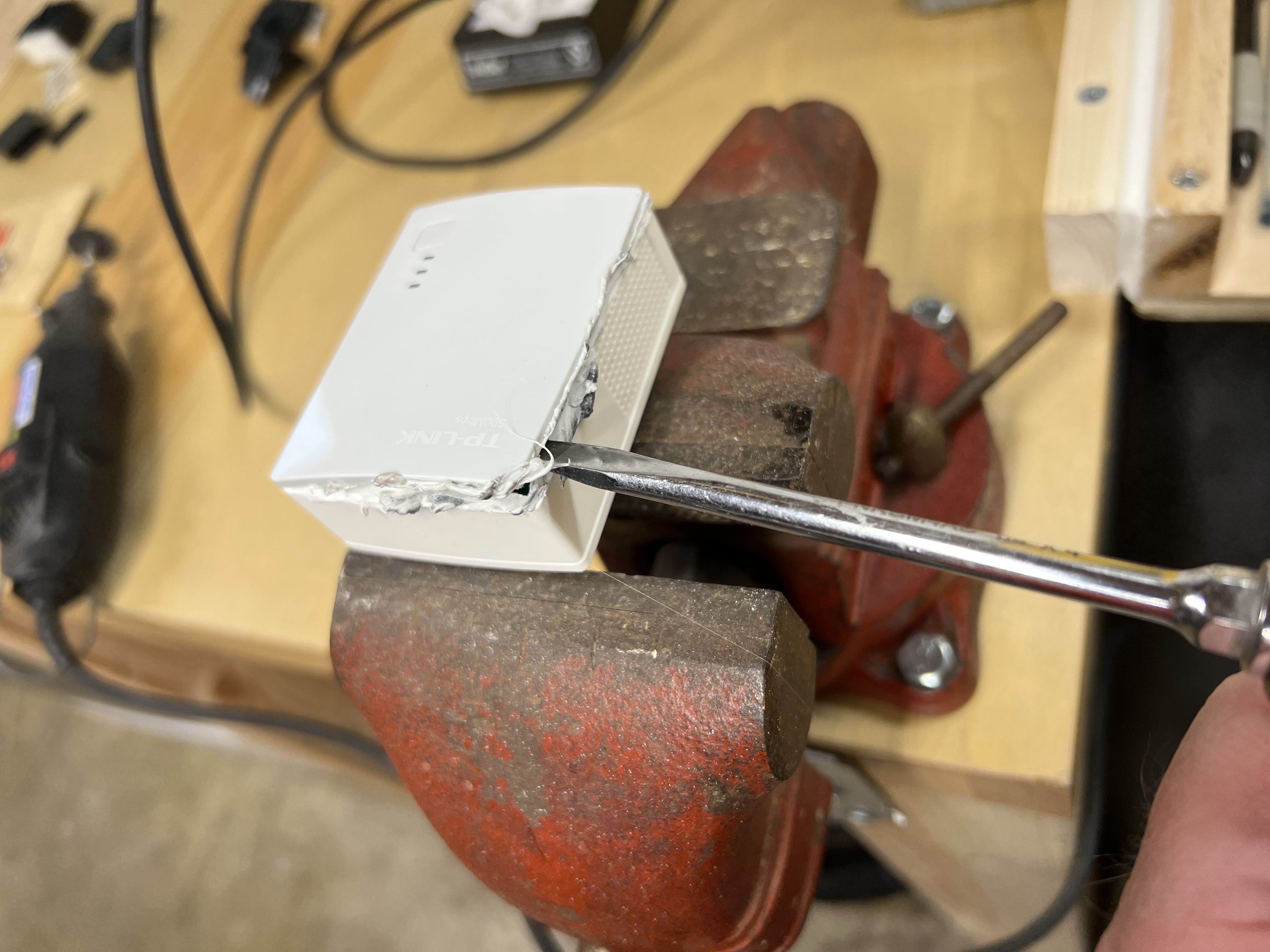

Well, in my other careers, I found few things can't be opened up by a judicious application of a Dremel (carbide burr, or #426 reinforced fibreglas cutoff wheel on a 420 mandrel). I sliced a couple of inches around a corner, very shallow, then pried a bit back . . .

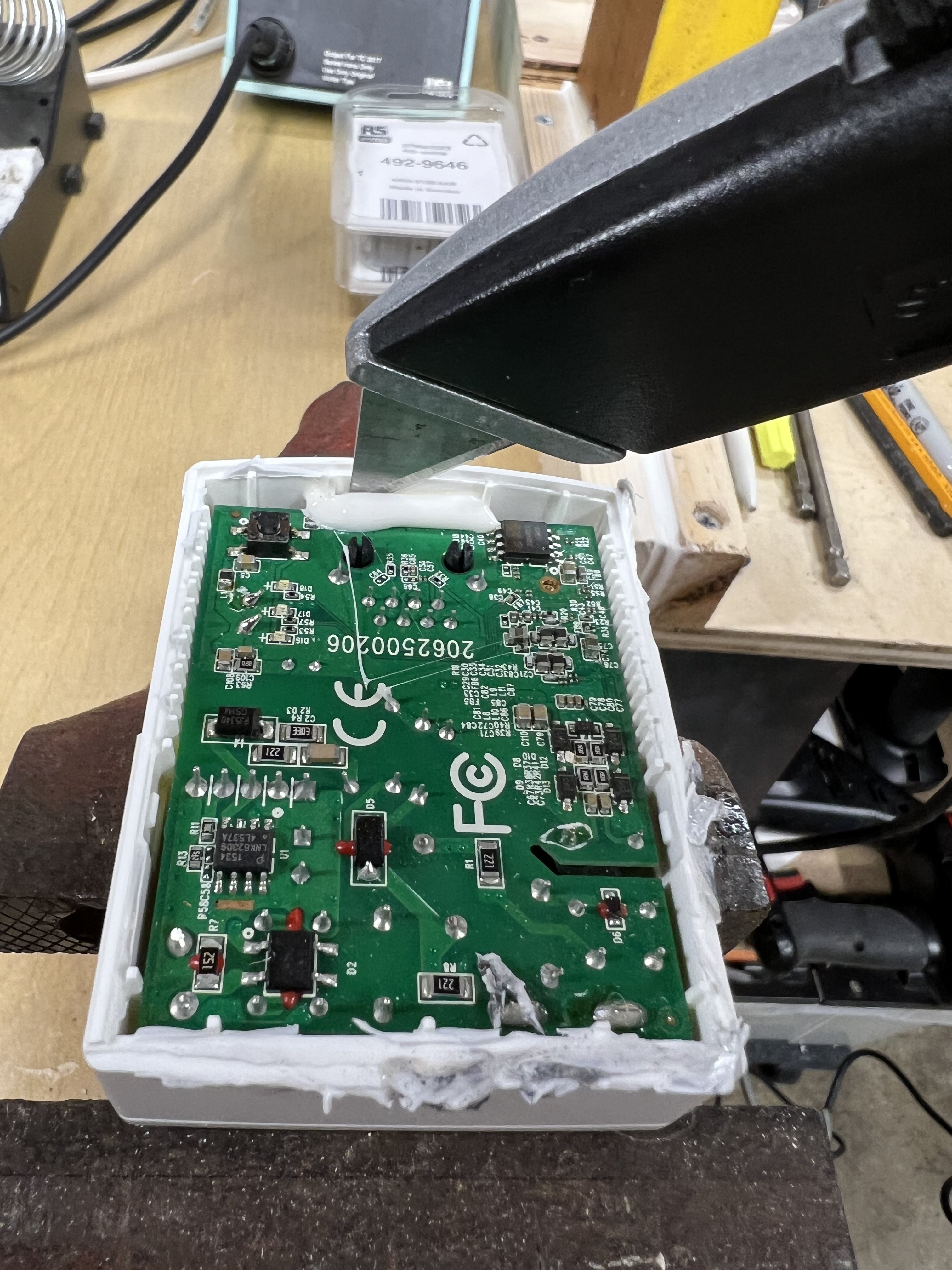

That revealed where I had room for more slicing . . .
There are cover catches, but I could not flex the sides enough to disengage them. I display these pics in case one of you wants to try to do better than I.

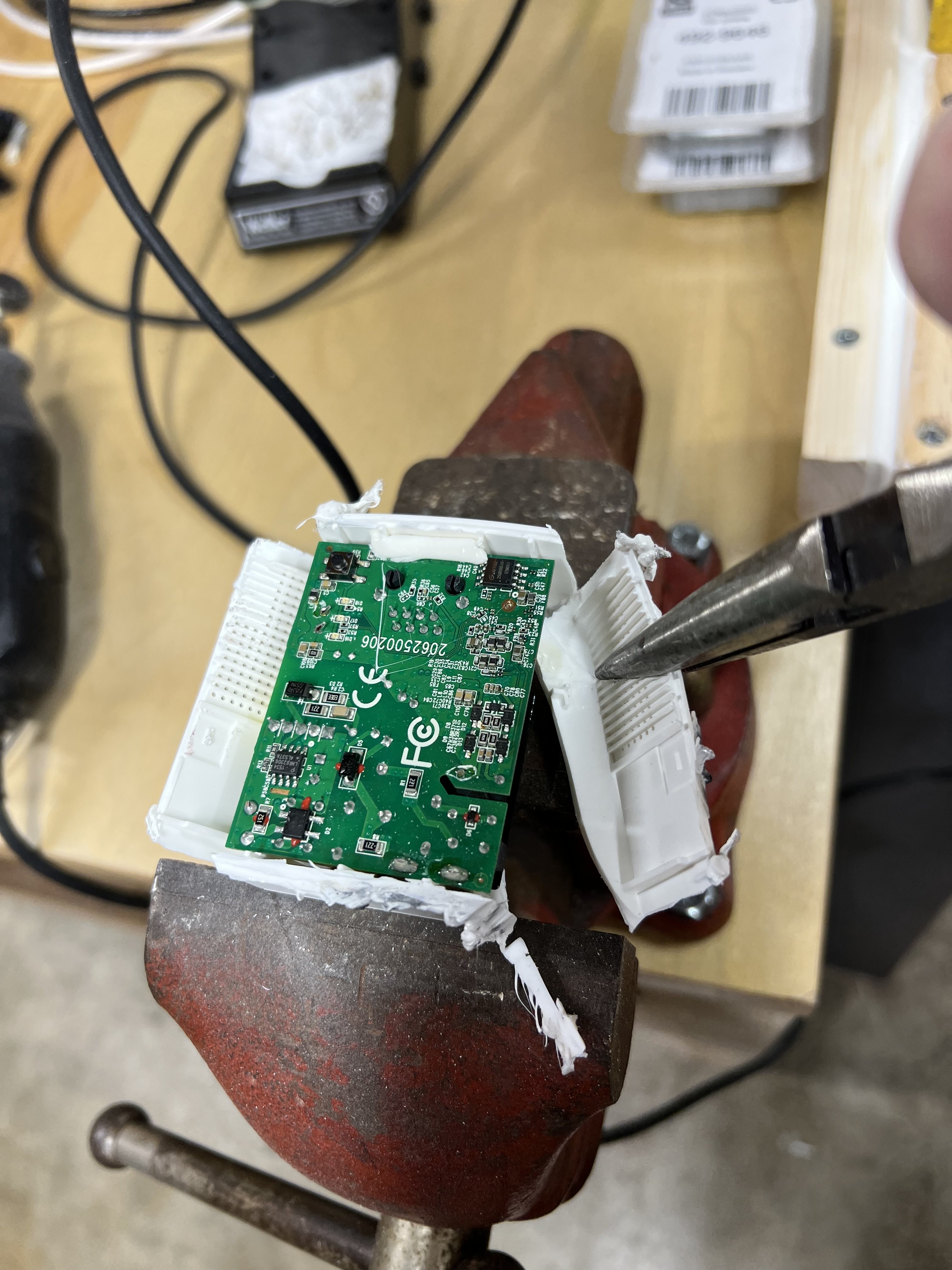

Dislodge a bit of glue . . .
Slice off the corners, then break off the sides . . .

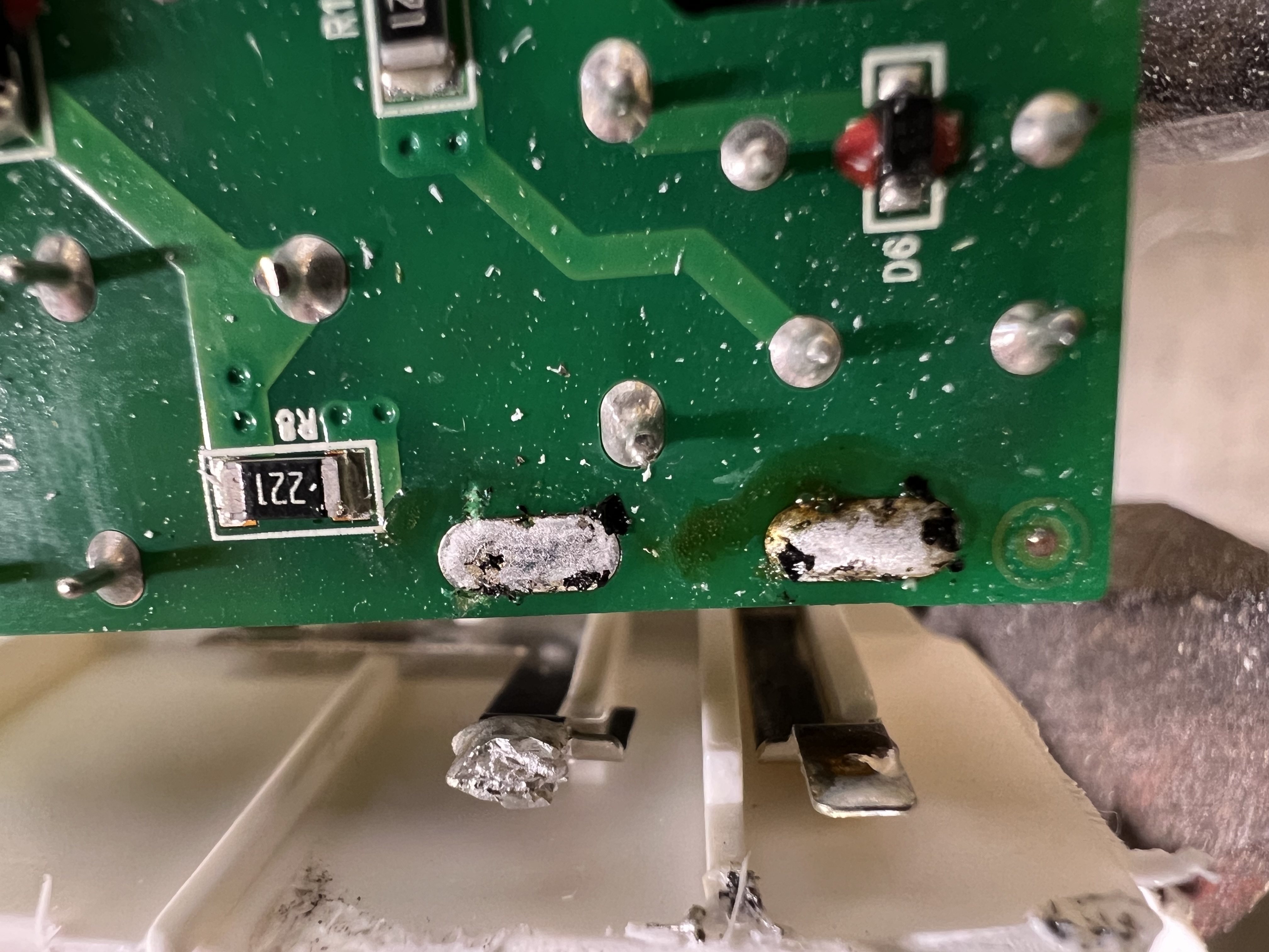

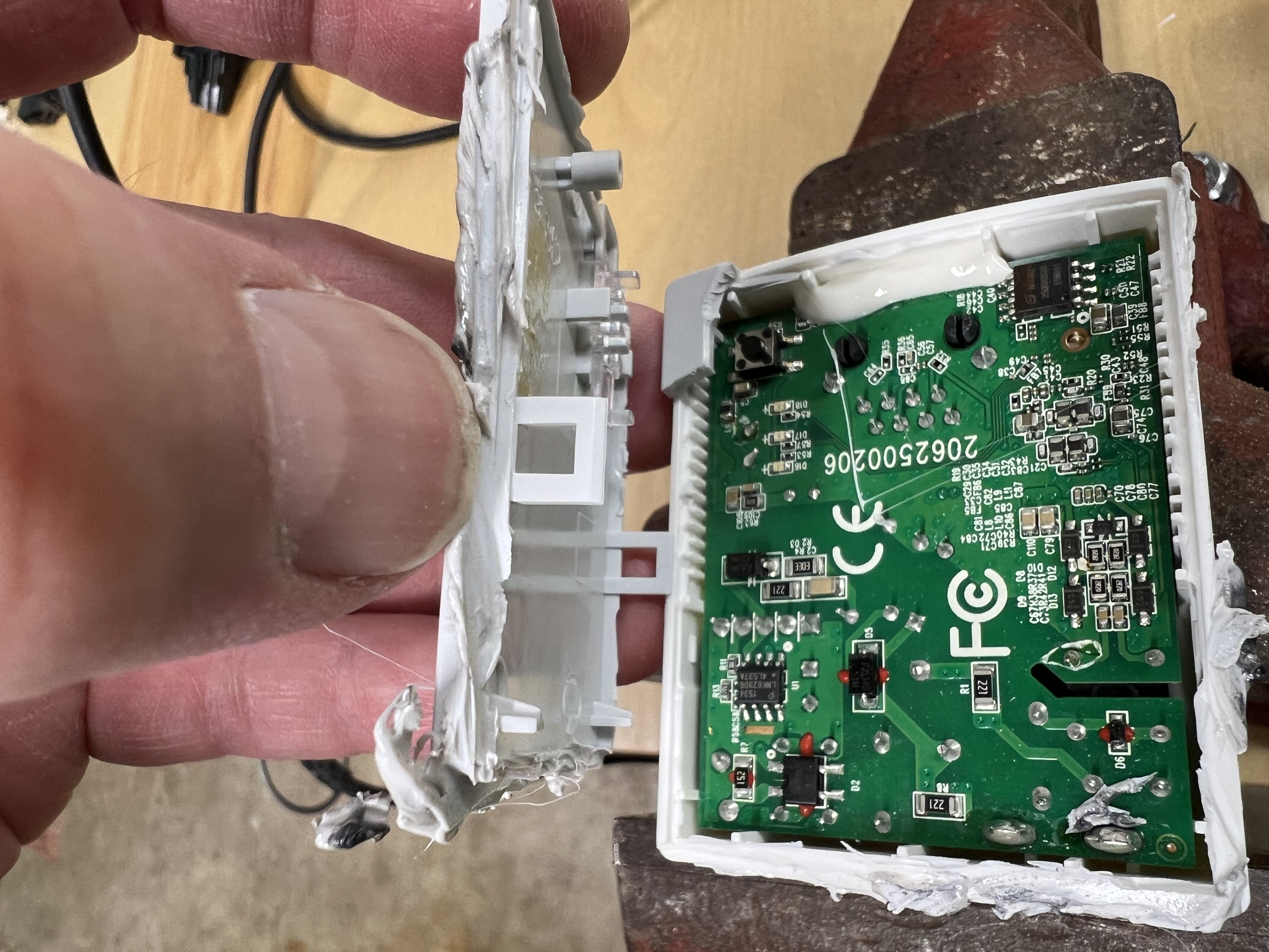

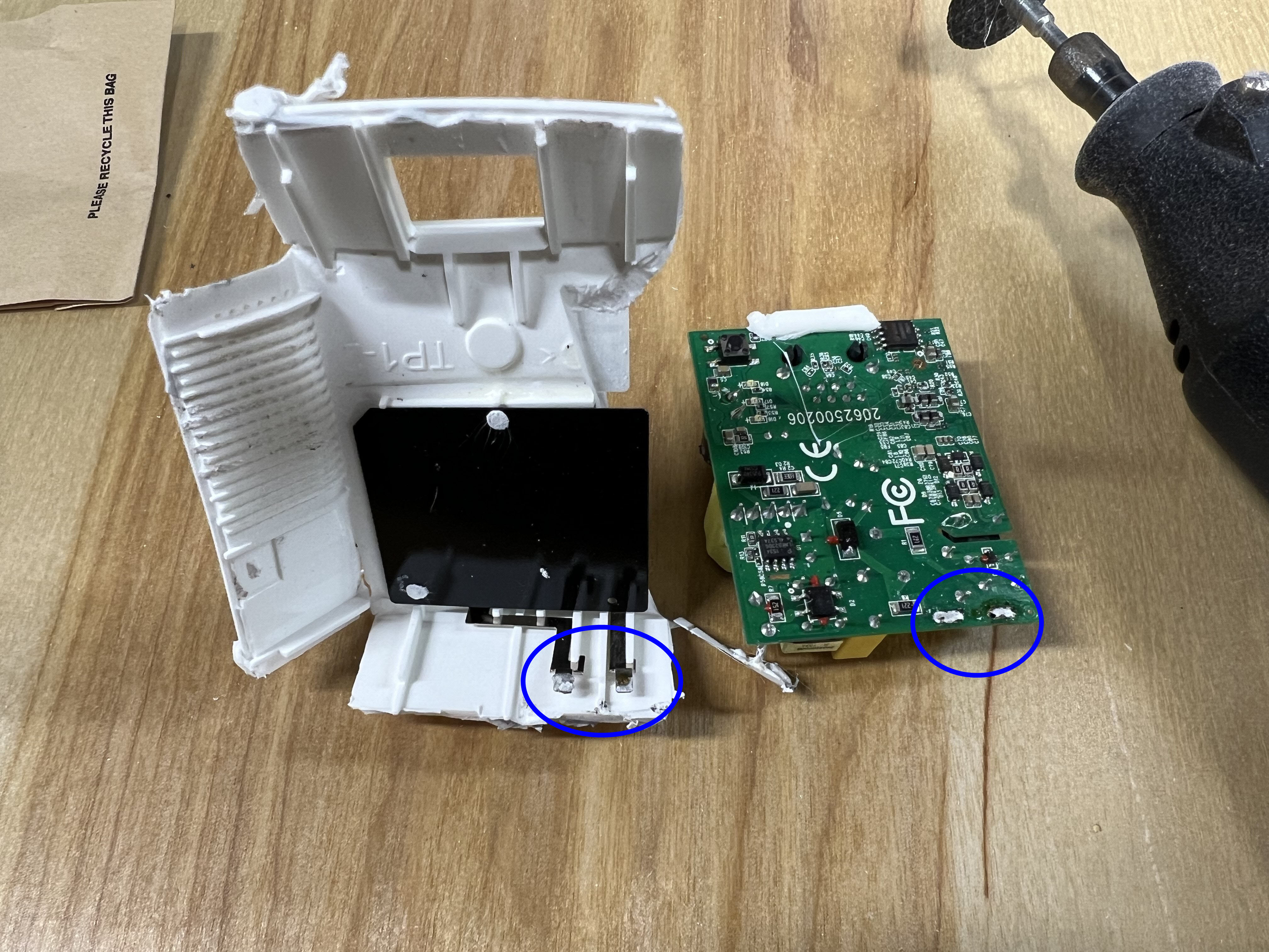

Only had to desolder the mains wrap-around leads:

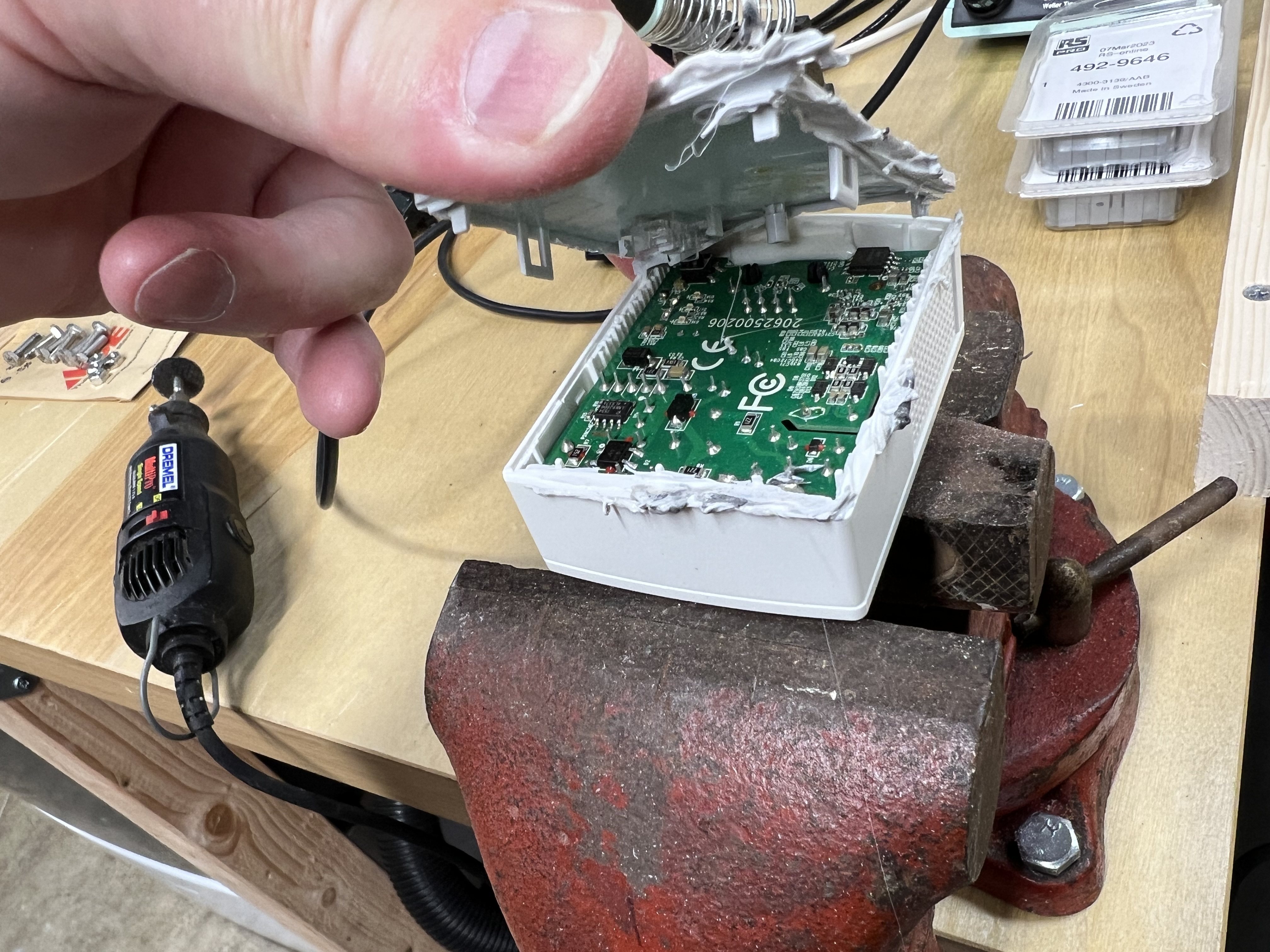

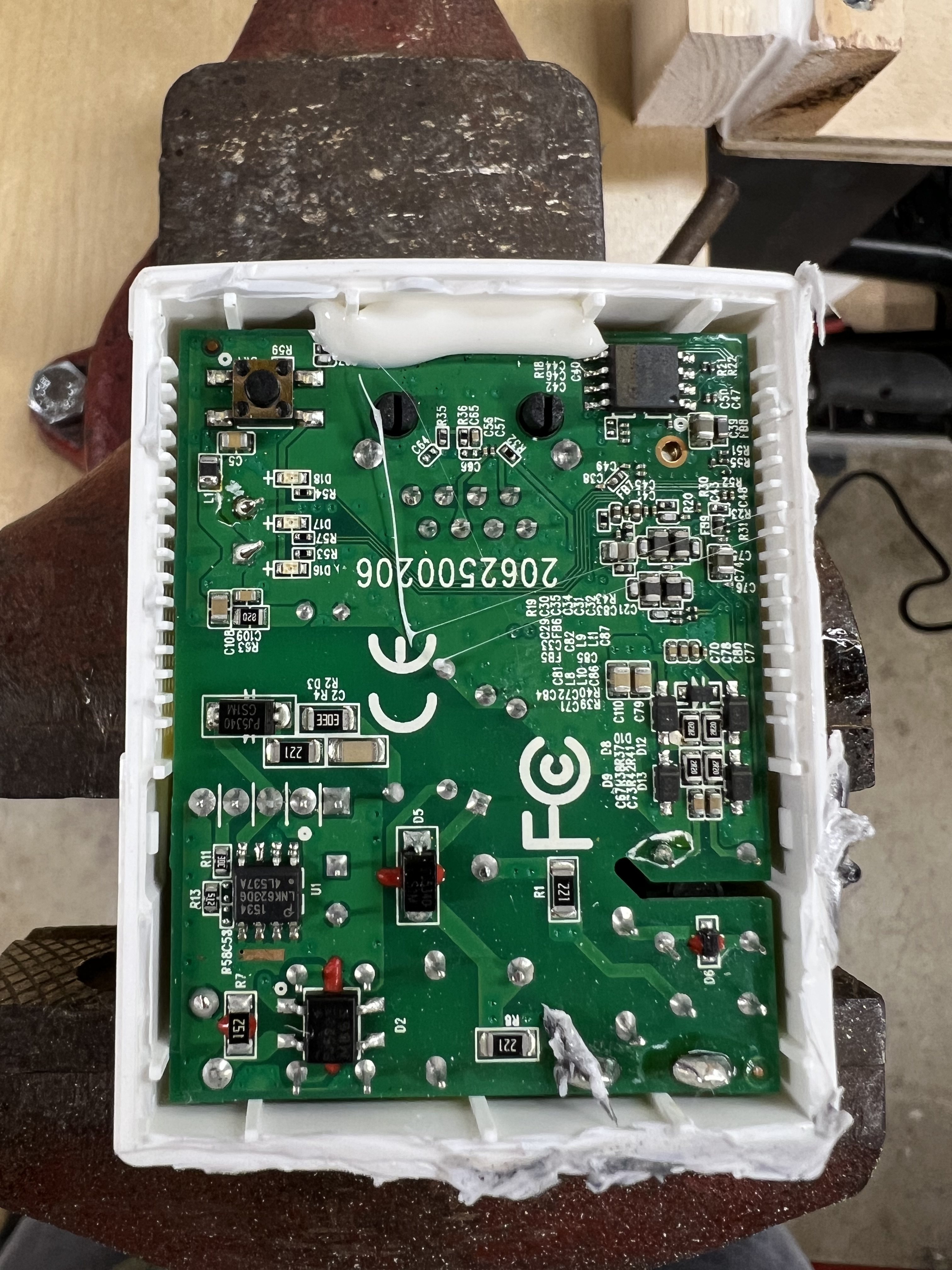

Here's a better shot at the bits that have to be separated permanently:
I'd continue removing the PS section, but I'll be darned if I can find my manual solder sucker -- I moved house recently, and it's not in with my solder station kit. I can find one of my automated solder removal tools but I inherited that one and I doubt its in working order, and my production desoldering set, which requires plumbing compressed air from one side of the garage to the other, is in storage 35 mi. south (and I don't really want to set it up).
Fighting the tools . . .
