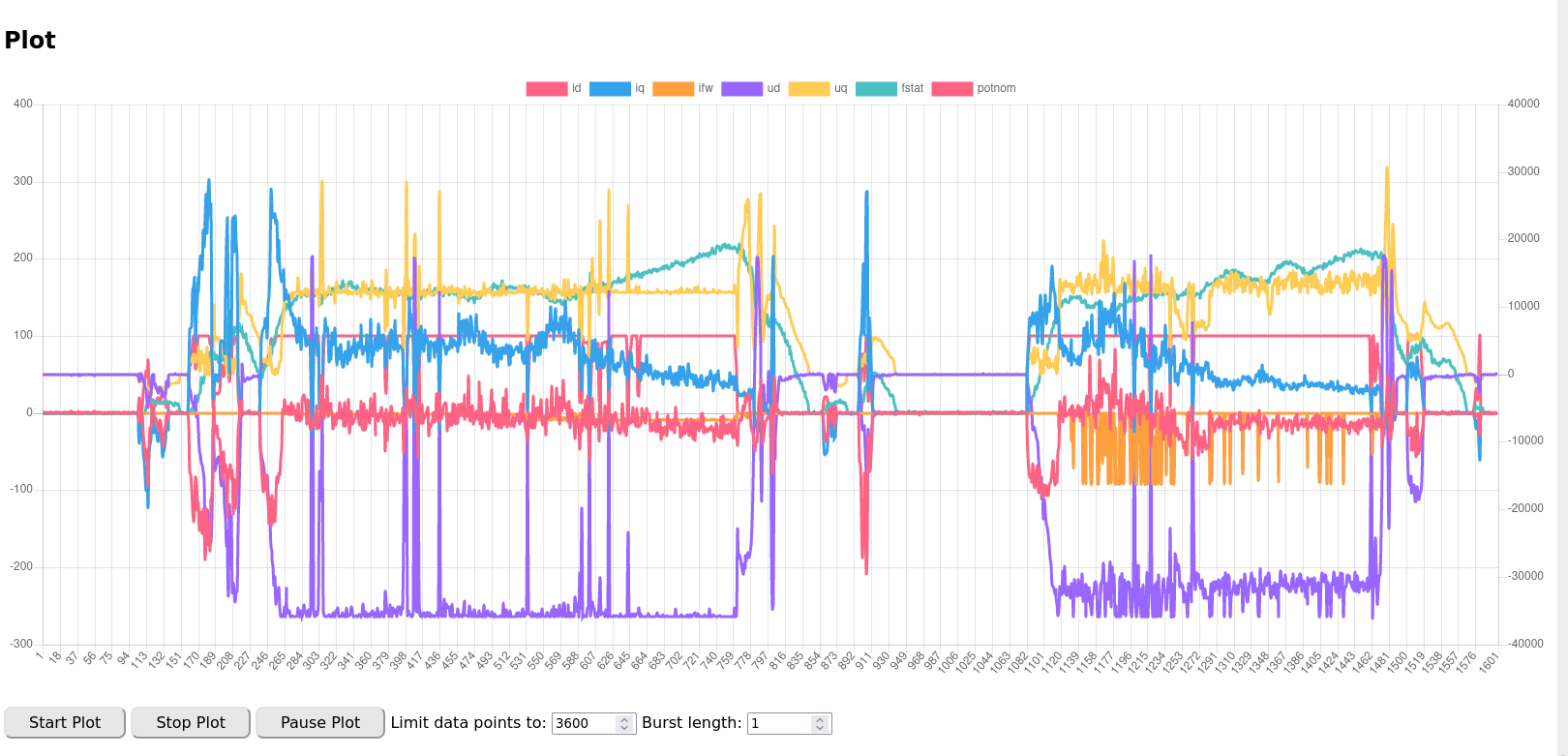

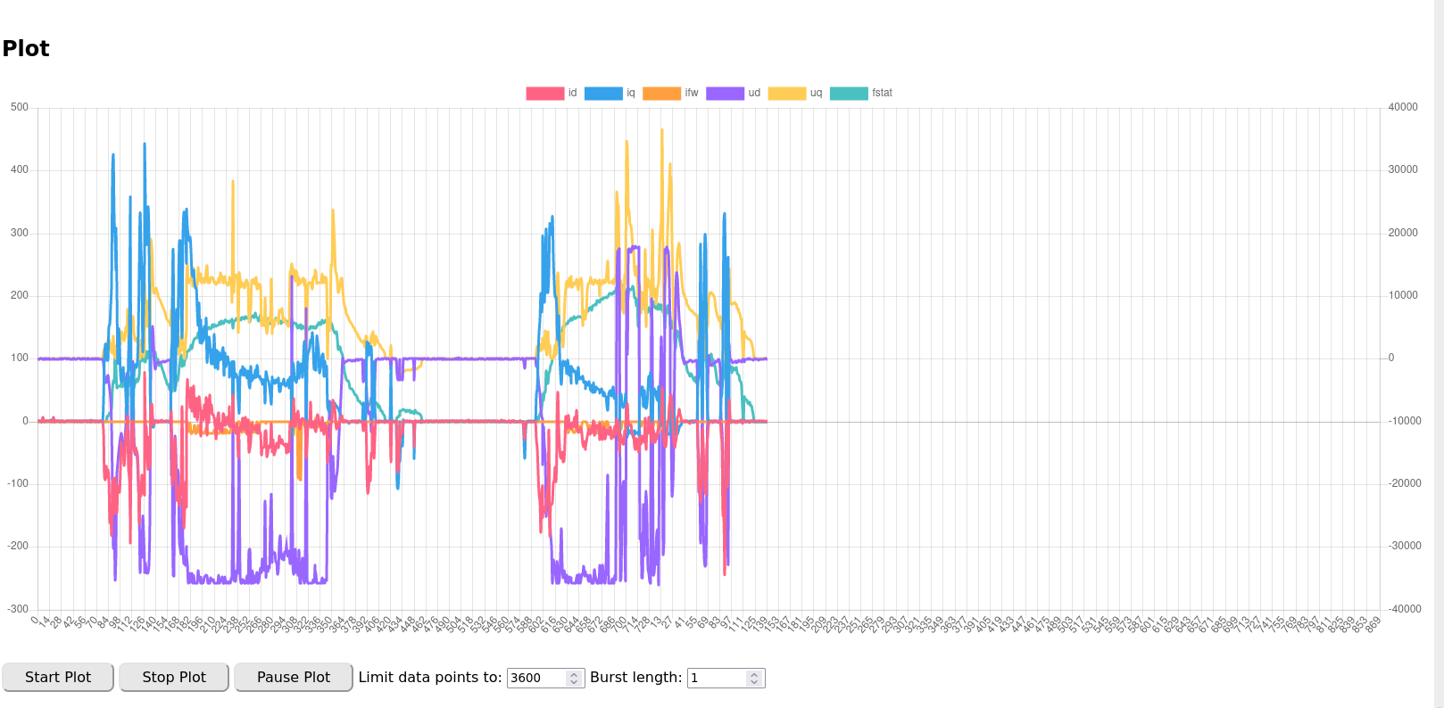

I went testing it, and it didn't really improve anything (didn't break anything either), but I think the idea is in the right direction. Here are two graphs that I took when driving using that firmware.
I should mention fwkp seemed to do basically nothing, but I played with throtcur. I would like to see the source to know what was actually happening.
Here throtcur was 3 for the entire drive. I think I might have changed fwkp from 1 to 10 halfway through, not sure. At the later portion I started testing whether varying the throttle would get me more speed, and I think it might have. Didn't plot the throttle though:
In the next drive fwkp was 5 or 1, whatever, it didn't really change anything, but I varied throtcur along the drive while keeping the throttle at 100%, and it changed the "high" speed performance (i.e. performance at around 40-50km/h or 150-200Hz). Near the end you can see the wiggly fstat line while potnom was maxed all the time. I was browsing throtcur values between 0 and 4 or so, and found out that about 0.7 gave me some acceleration, while values outside of that lost the acceleration. Of course once I stopped the car could barely move with throtcur=0.7 and I had to increase it again to something between 2 and 6.
Less current = more acceleration? Sounds like characteristic current to me. Now I need to somehow understand what was happening with the iq-id vector and what that might tell me.

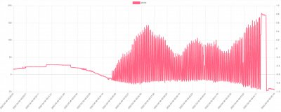

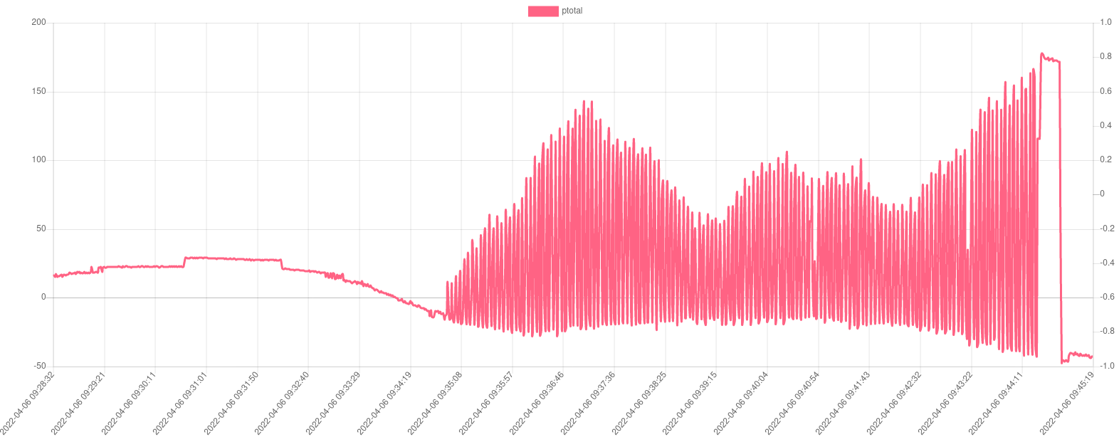

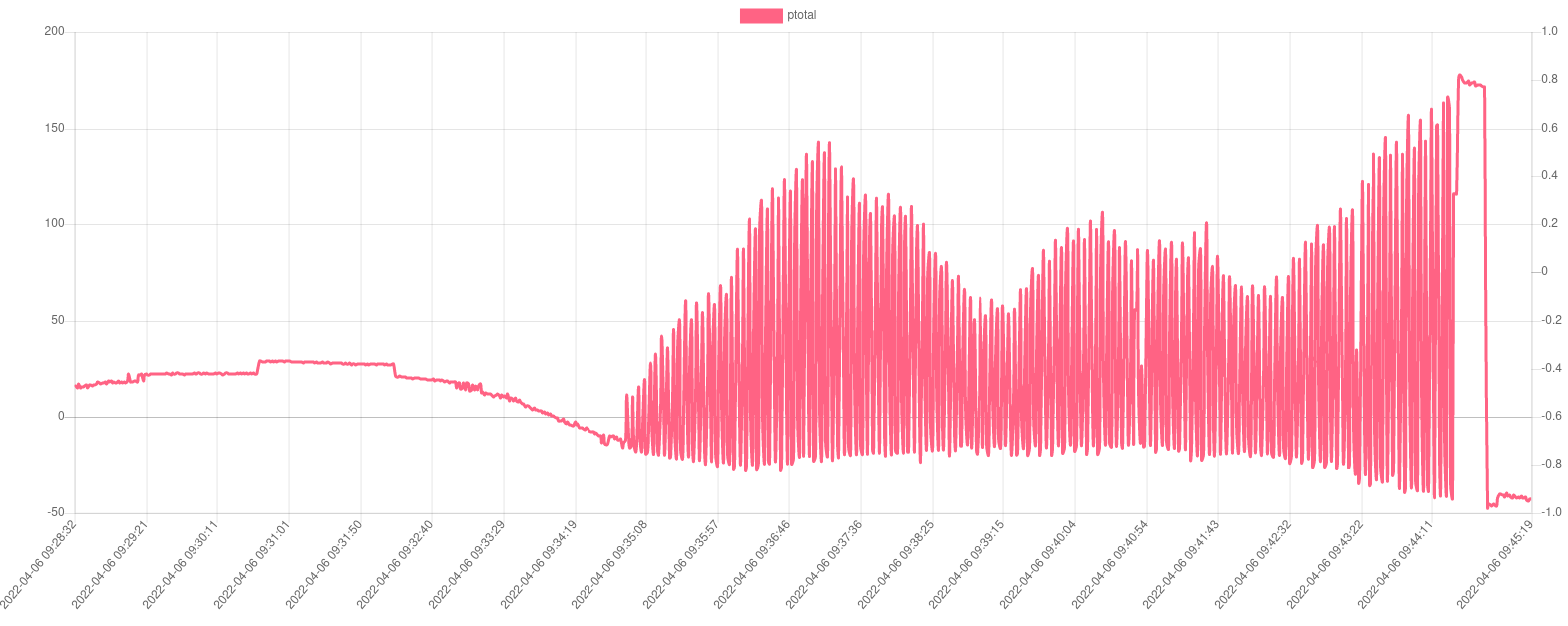

EDIT: speaking of which: looks what my zero export controller is currently doing:
So asked differently, you lowered throtcur while 100% on throttle. Likewise you could have just come off throttle and thereby increased power.
Trying to think how to detect that condition. Of course we could introduce some frequency parameter but I bet it will shift around with varying battery voltage. Can you do some more plots with the "other" software? Maybe add some notes where this spot is where current needs lowering

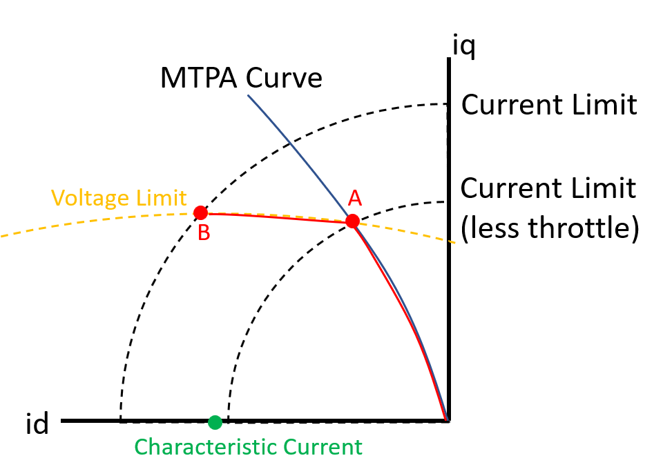

Here is another article which explains the topic of characteristic current, voltage ellipses and field weakening and also presents some formulas:
https://ieeexplore.ieee.org/document/6457462
Especially figure 8 and the related text are great for understanding what’s going on. They also come up with formulas and step by step explanations on how to calculate id and iq. The main difference being, that they are interested in constant torque and thus, have a torque as input which makes for some quite lengthy calculations. In our case, we command a current and thus, can save on a lot of the math.

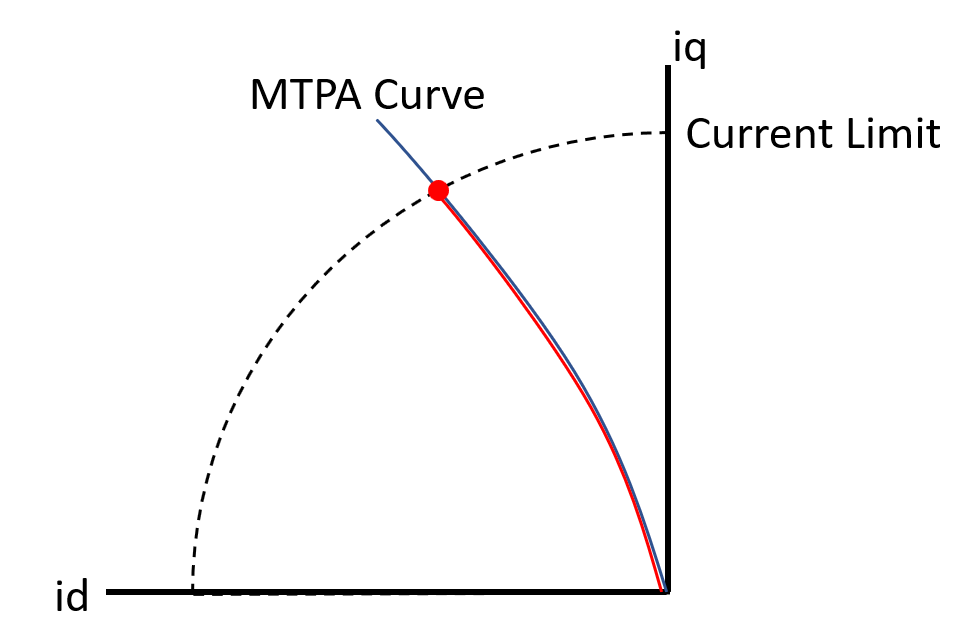

So, in a perfect world, an id-iq diagram would look like that:
The current limit is given by our throttle input Is:

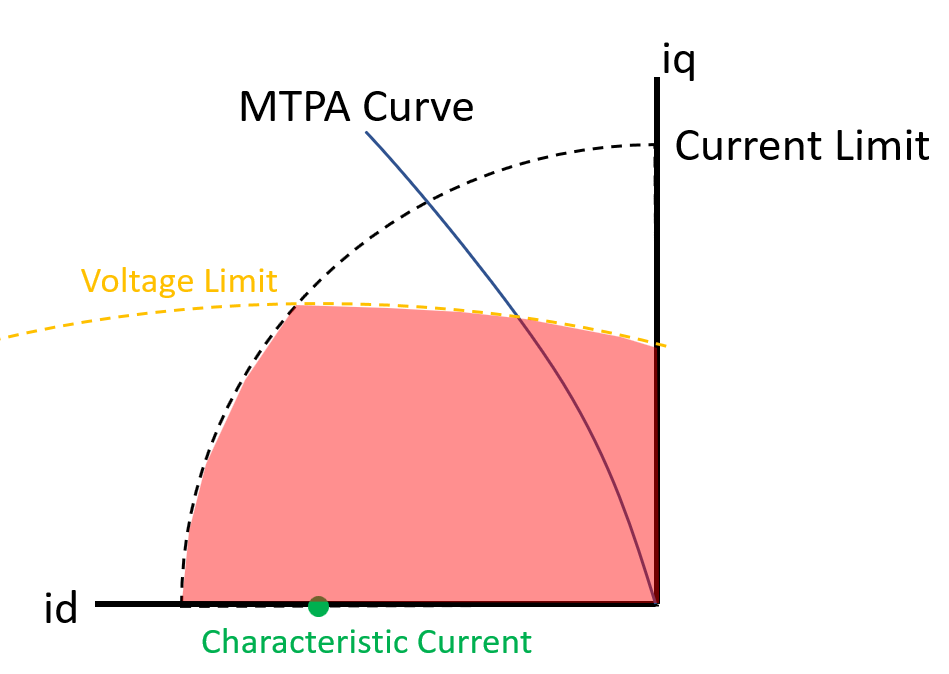

We can freely choose id and iq within this circle and in the best case, we would choose the intersection of the MTPA curve and current limit. However, there is also a voltage limit. Id and iq have to fulfill the following equation:
As the name suggests, it depends on the voltage Vs that is the peak value of the maximum phase voltage.
In the idiq diagram, this voltage limit is an ellipse with its center at the characteristic current:
Thus, the diagram would look like that:
Now id and iq have to lay within the current limit circle and the voltage limit ellipse (the red region). If one would hit the voltage limit and still keep requesting more and more current outside the allowed area, the resulting currents will not reach the requested values (ud maxes out..). One could just take back the throttle and reach the intersection between the MTPA curve, current circle and voltage ellipse (position A in the image below):
This probably explains celerons experience with lowering throtcur yielding more acceleration. However, this also decreases overall power. Instead, one could move along the voltage ellipse till one reaches the intersection between ellipse and current limit (position B). Not on the MTPA curve anymore and thus not as efficient, but more power and torque.
