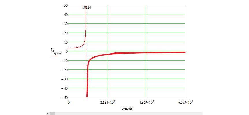

The recent OpenInverter FOC Tuning video (which is very helpful)
discusses a notch type curve. I think it might be a curve a bit like what i have sketched below. Wonder what other folk think.
I only show it because perhaps it will be helpful for discussion.

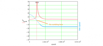

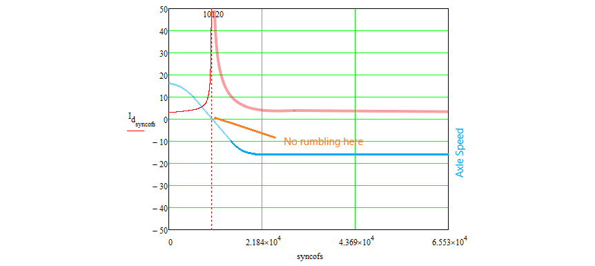

I think curves might be closer to this one...

Post by ZooKeeper »
I prefer the original representation of SO v RPM, especially since it uses scales but not numbers. Given how easily folks misunderstand what the goal is, I believe the less numerical specificity of the concept, the better.
