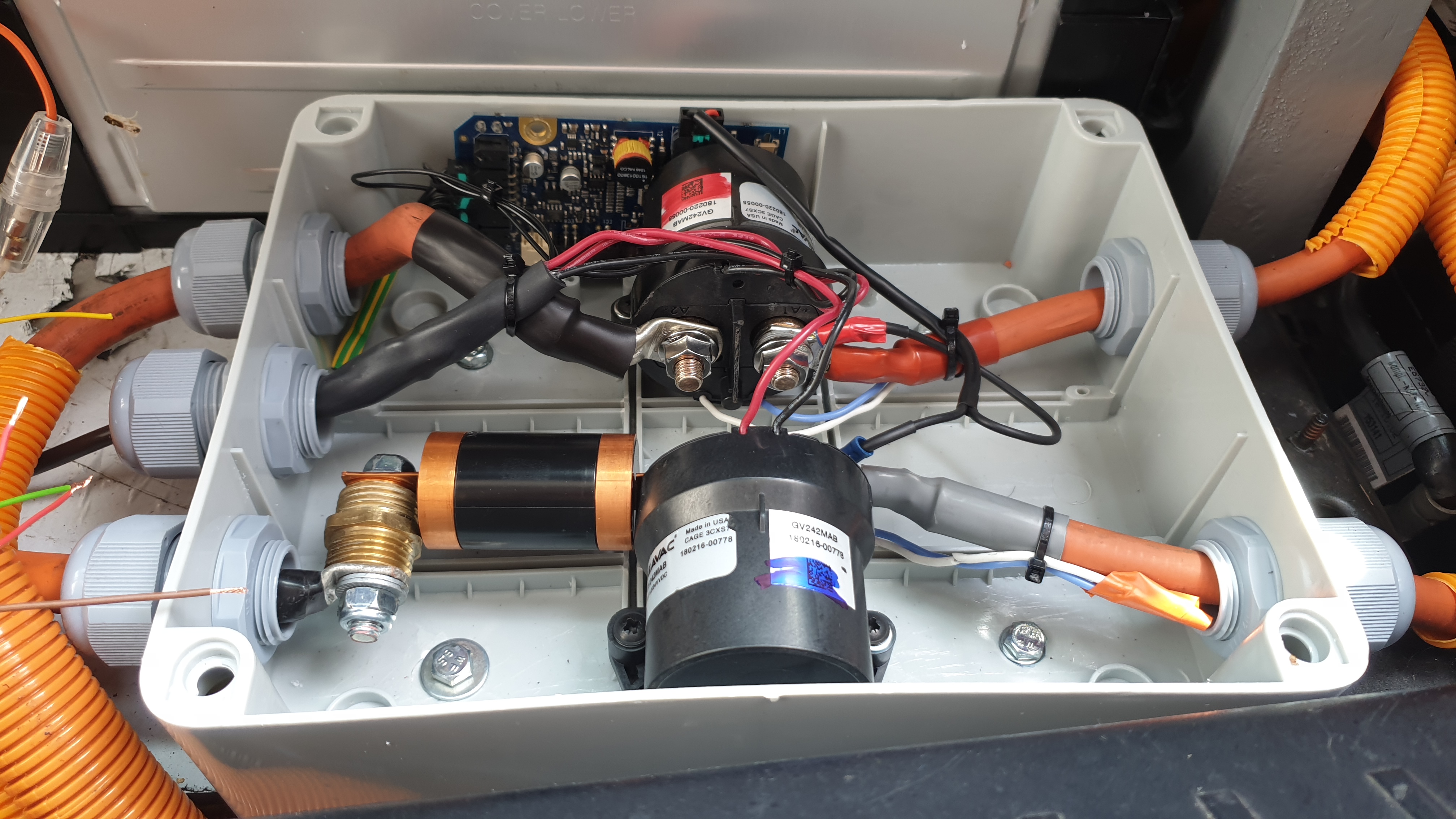

So a little bit of info. The LIM will engage AC charging if the DC contactors are missing but not if the signal from the HV voltage detect circuit is missing.

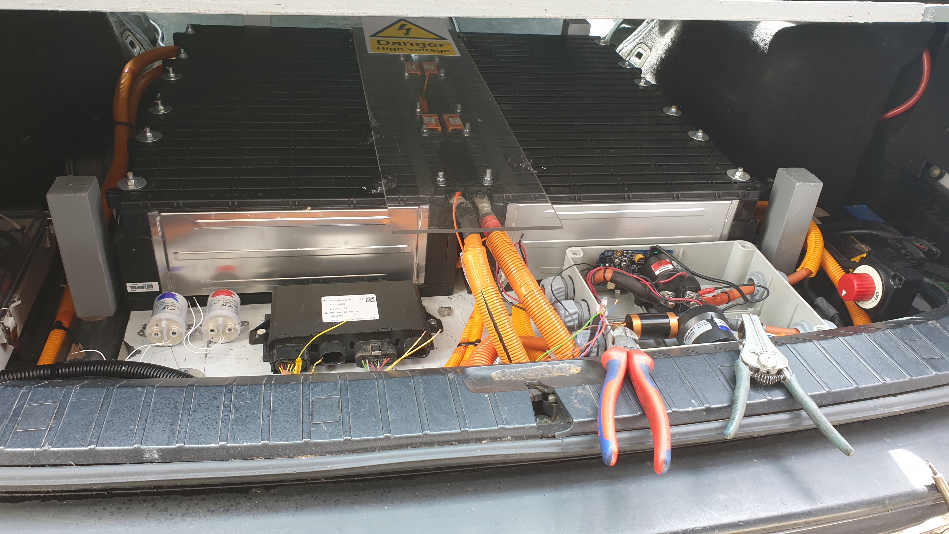

2017 LIM wired into the Grey Goose and tested working on AC. Next up integrating it into the VCU and canbus then DC experiments begin:)
